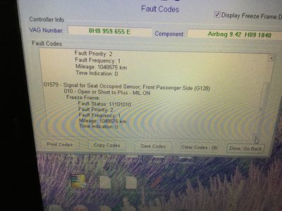

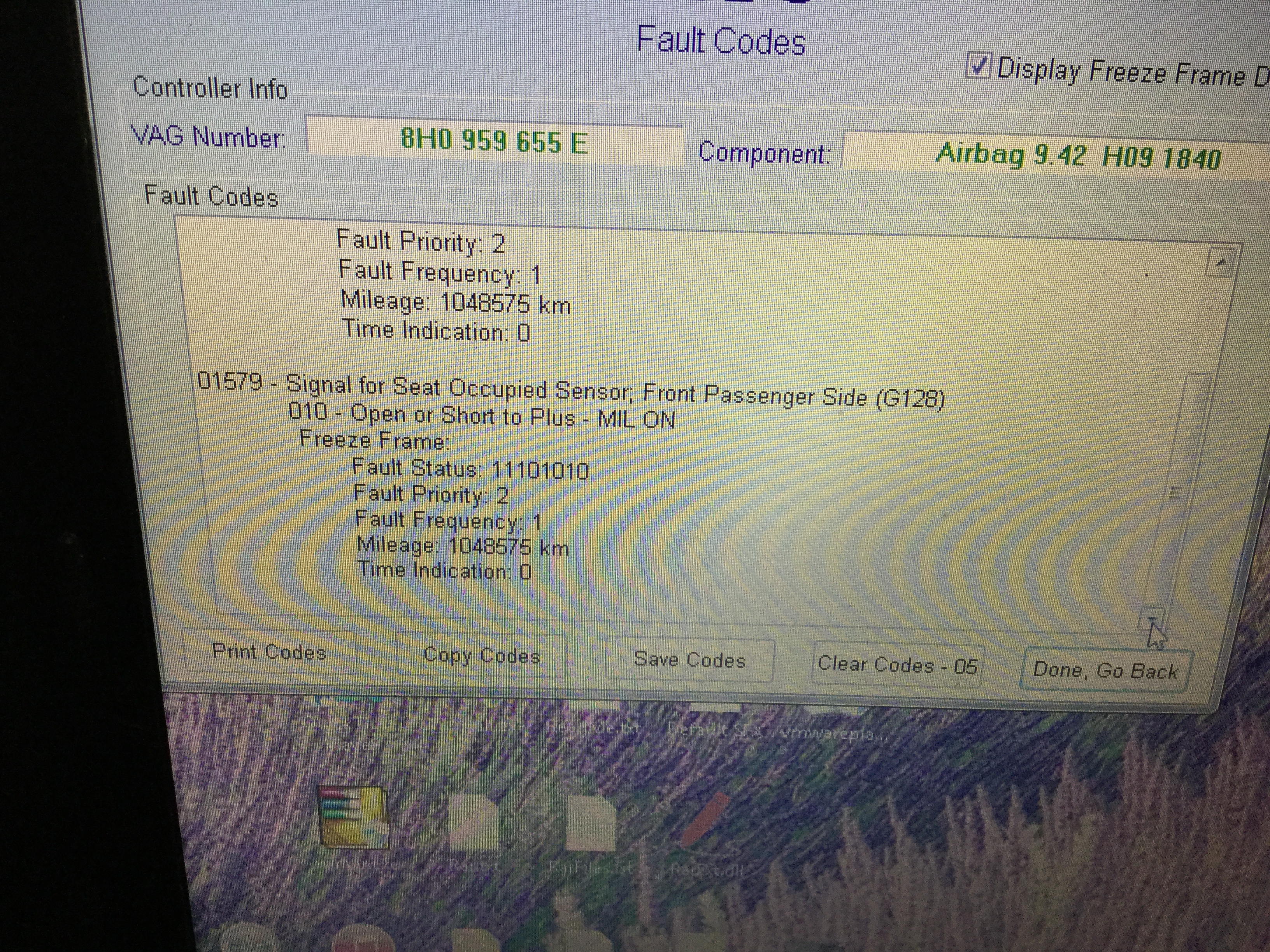

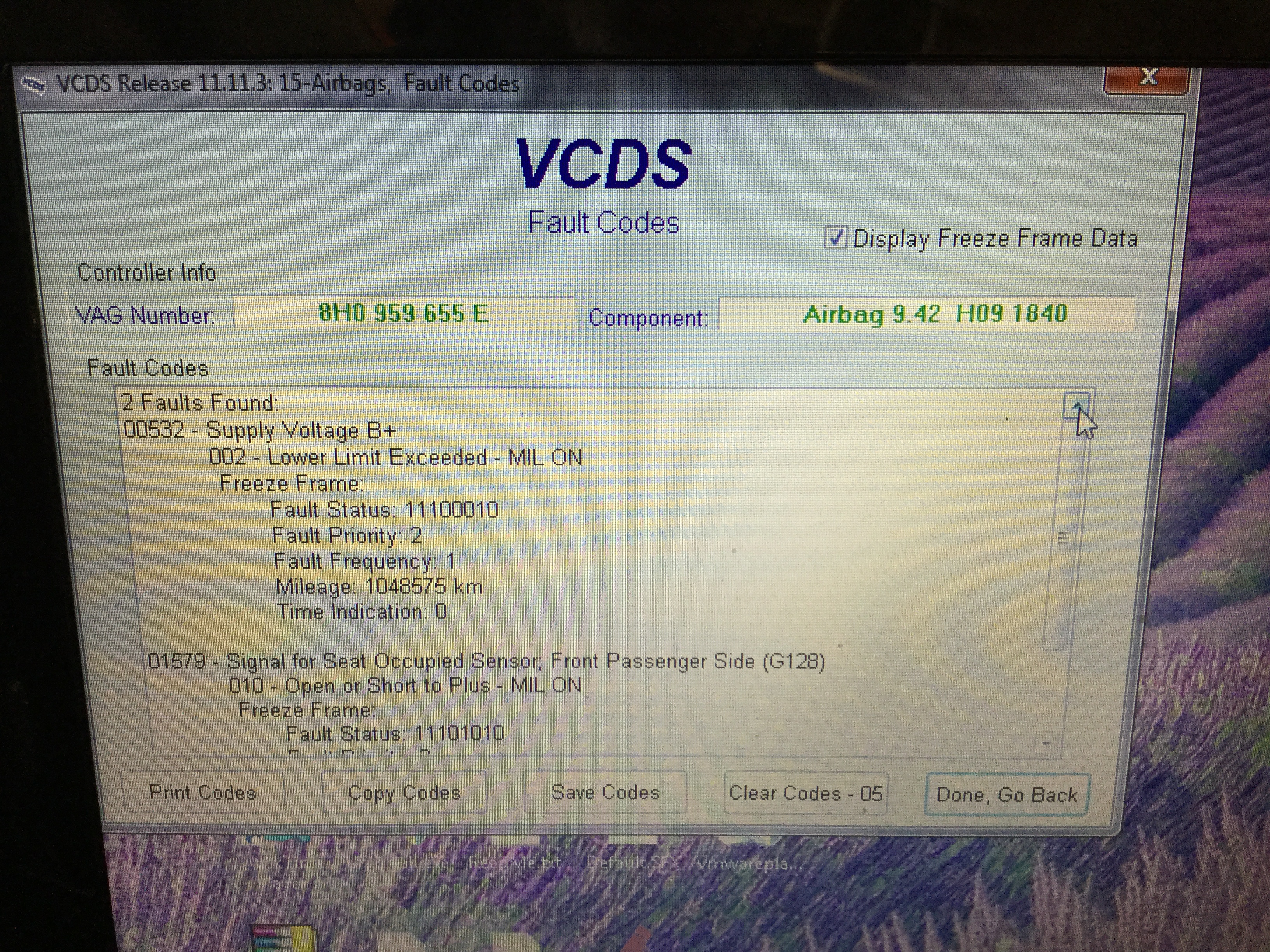

Coding for airbags on comfort seats
Re: Coding for airbags on comfort seats
With0473114
Try coding 0471114 (I understand this is the donor car's coding).
Then clear the DTC.
Reset the seat occupancy.
Do the basic settings for the seat occupancy.
See what happens.
Then clear the DTC.
See what happens.

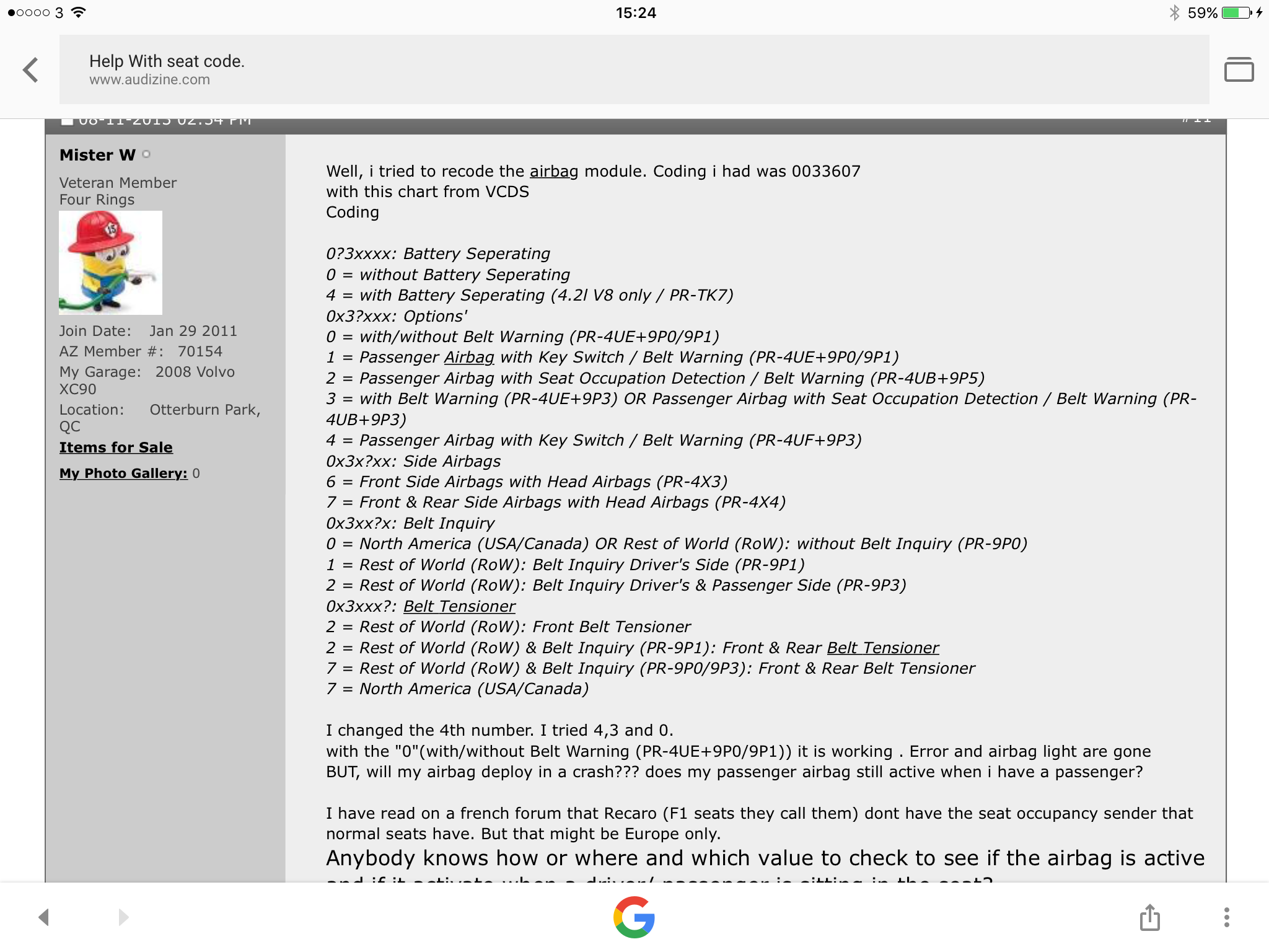

I think with 047114 the module is expecting a cut-off switch for the passenger side airbag. You know, the one you put your key in when you have a rear facing baby seat.
Do you have one?
Does the donor car?
Mine doesn't and I've pm'd the owner of the donor car to see if his does
Yeah, I saw that. Doesn't really give us much information. Doesn't seem to affect the occupancy issue. But might explain why you get the switch fault codes when you use the donor cars coding (assuming the donor car has one).
Hmm ok
That table doesn't make sense to me as for instance my code ends in 4 but unless I'm interpreting it wrong the only options for the 7th digit is 2 or 7?
Unfortunately the table isn't complete. Hence the limited usefulness. It's pretty much what you posted up.
I posted that link to show the basic settings.
Donor car had key operated passenger airbag mine hasn't got that.
That explains the difference in coding then. I now believe you need to keep your original coding.
