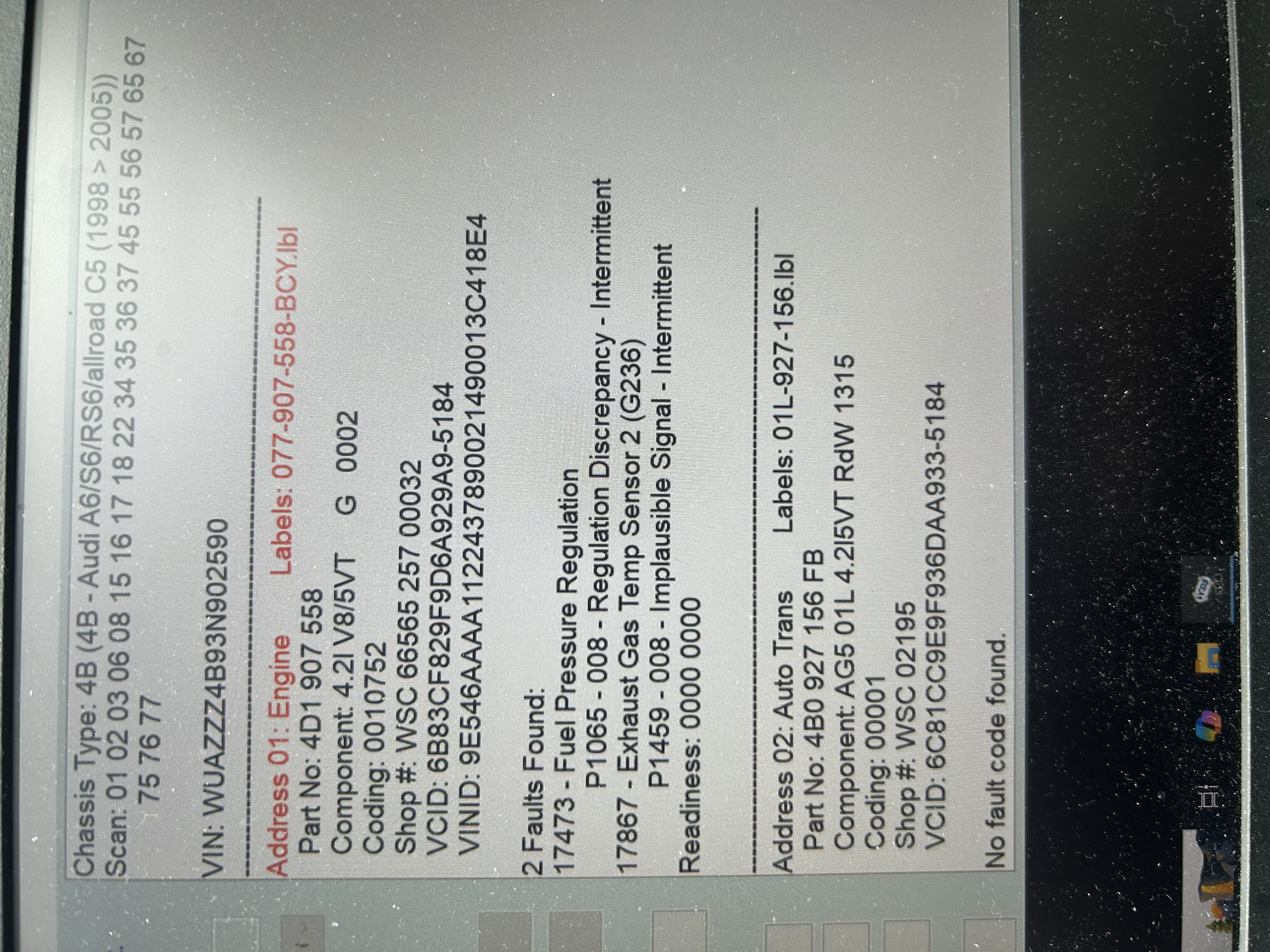

This came up today. Not worried about the fuel pressure as new pumps and regulator will be installed soon.
The EGT sensor error code is a new one which I have not seen before. Hence looking into buying new sensors.

Could the EGT sensors be flapping because there is a leak in the manifold? Is there the telltale noise that SuperRon identified in his engine drop video?
viewtopic.php?t=122944

A leak is very possible.
When at a standstill eg traffic lights.
I often get a smell of exhaust gasses.
Disappears when normal driving.
Initially I thought it was from the car in front of
Me.
But now thinking I have a leak. Also throwing a code for the Egt sensor.

I'm a bit concerned about the 17473 fault. The RS6 doesn't have a fuel pressure sensor so it's guessing that the fuel pressure is wrong based on other sensor readings (lambda, MAF, TPS, possibly EGT?, or possibly even current draw from the pump).
You have had / are having fuel pump issues, and there's a chance there is an exhaust leak. A defect with either of these could leak to this DTC.
If it was my car I would investigate the exhaust leak and test the fuel pressure at the injector rail. Or wait until the new pumps are installed and then test.
