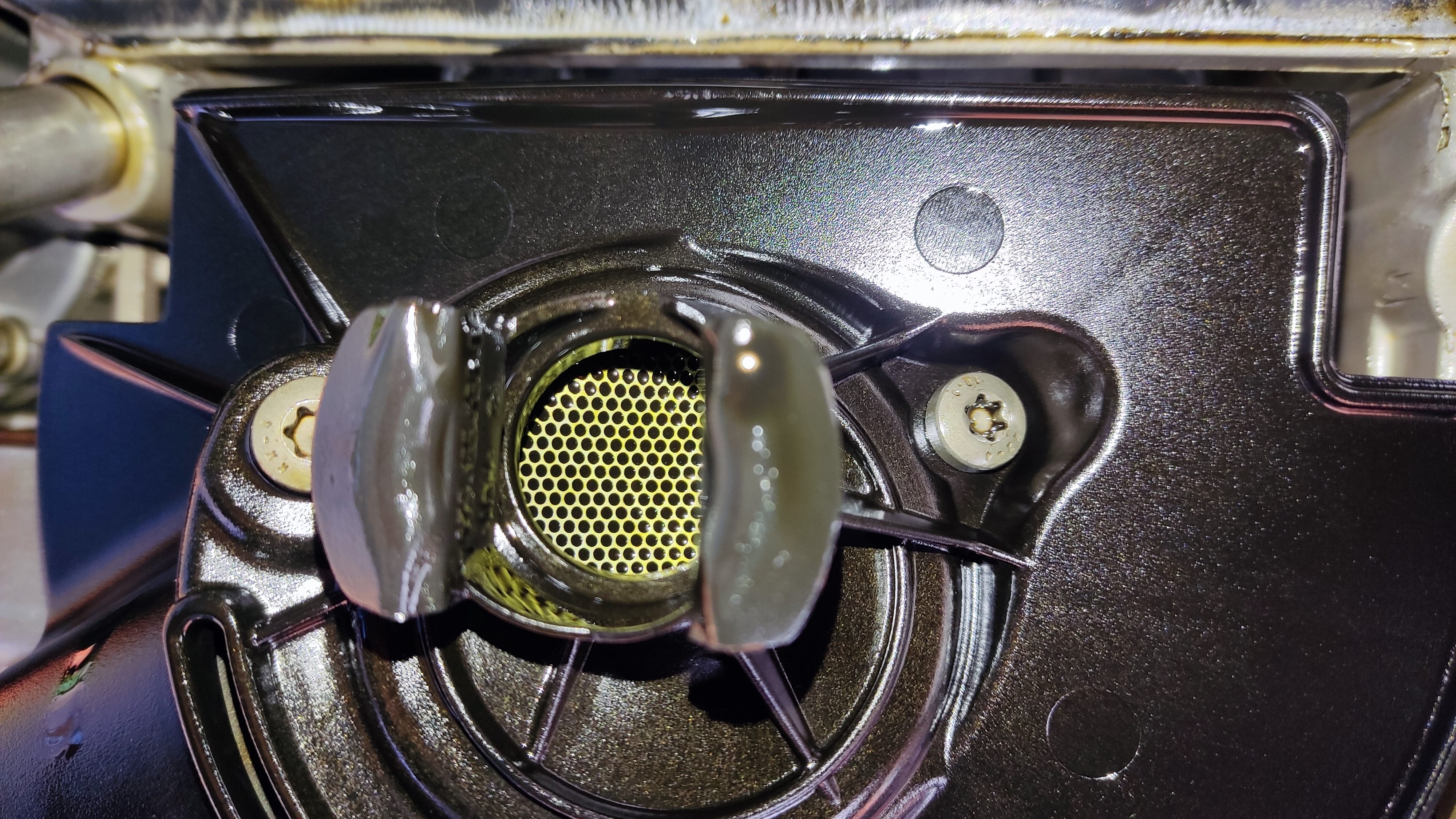

Managed to get the sump off, thankfully nothing hiding in the sump oil.
Inspected the Oil Pickup gauze, which looked pretty clean - certainly no sign of blockage

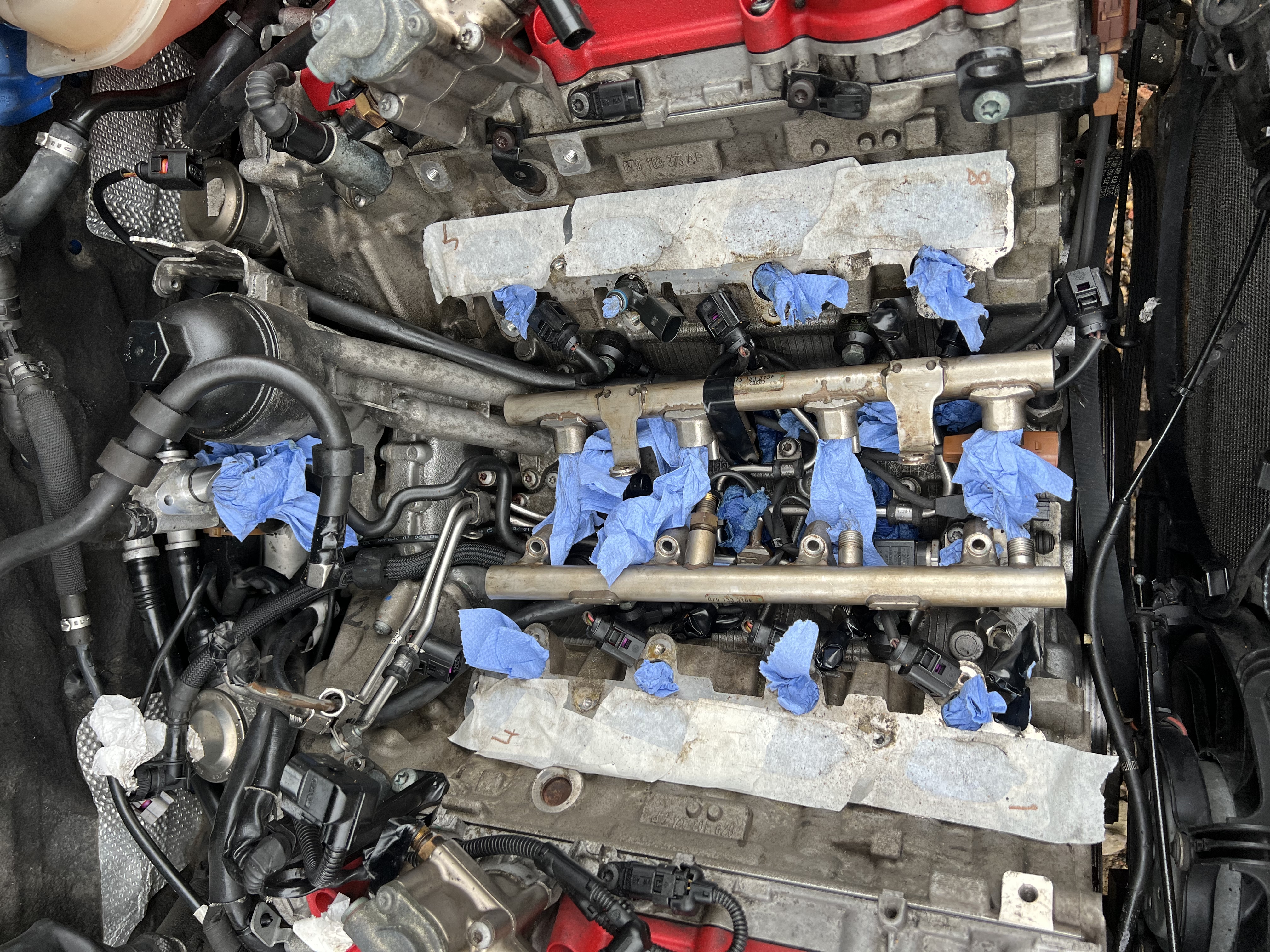

I see you can buy a seal kit for the injectors, 06E998907G:
GENUINE https://www.darksidedevelopments.co.uk/ ... 06e998907g
ELRING https://www.darksidedevelopments.co.uk/ ... 8907g.html
Also purchased a removal and seal mandrel kit from ebay for £28. One injector wont budge. Other came out Very easily. A bit on home cleaning:

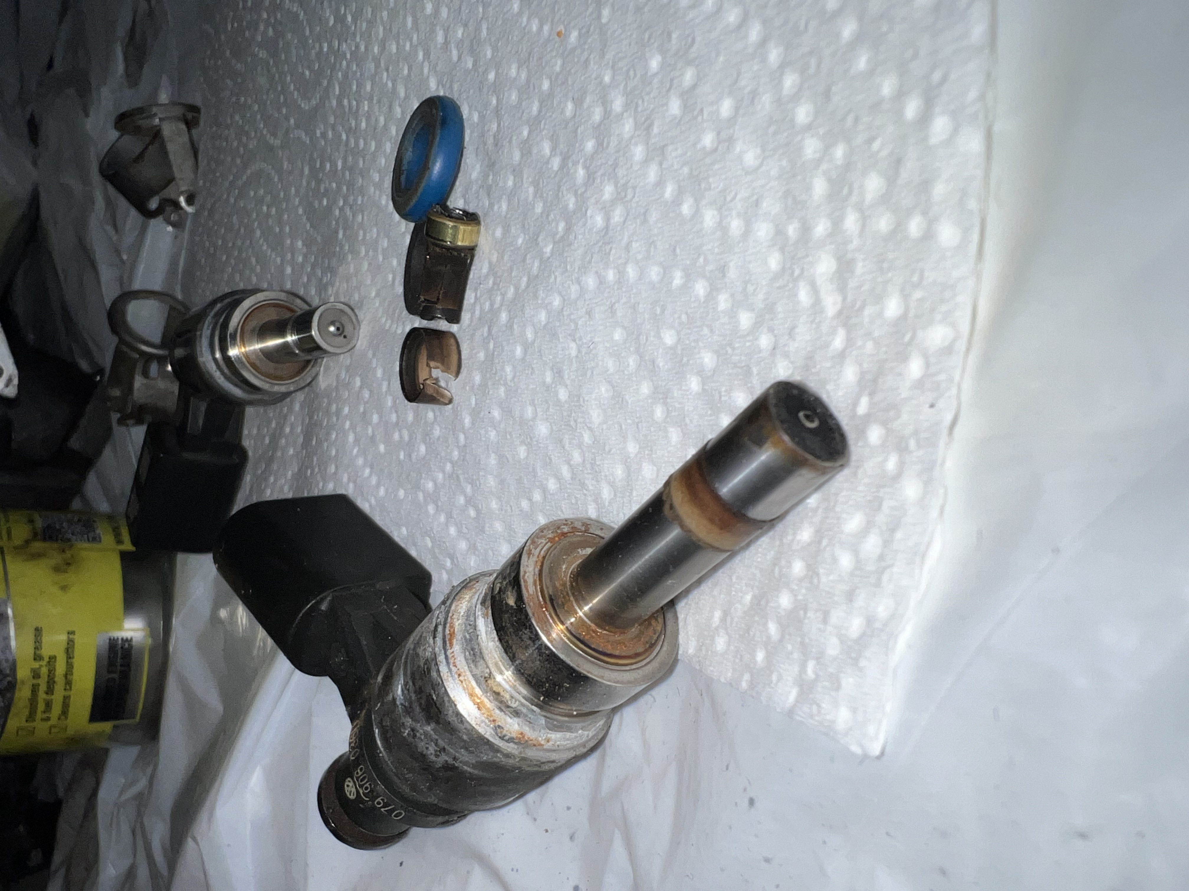

Injectors not looking bad, small amount of carbon on the tips, wiped off easily, 3rd photo shows one wiped clean and one as removed.
Will test them for spray pattern and take it from there.
Removed filters, will replace all seals and filters.
Filters came out with a screw and pliers, trick is to get a good fitting screw, tights enough to give a up and down motion as pulling hard, they come out fine.
Would benefit from beinf replaced by look of them, intact (ive heard the can break up), but not overly clean.
