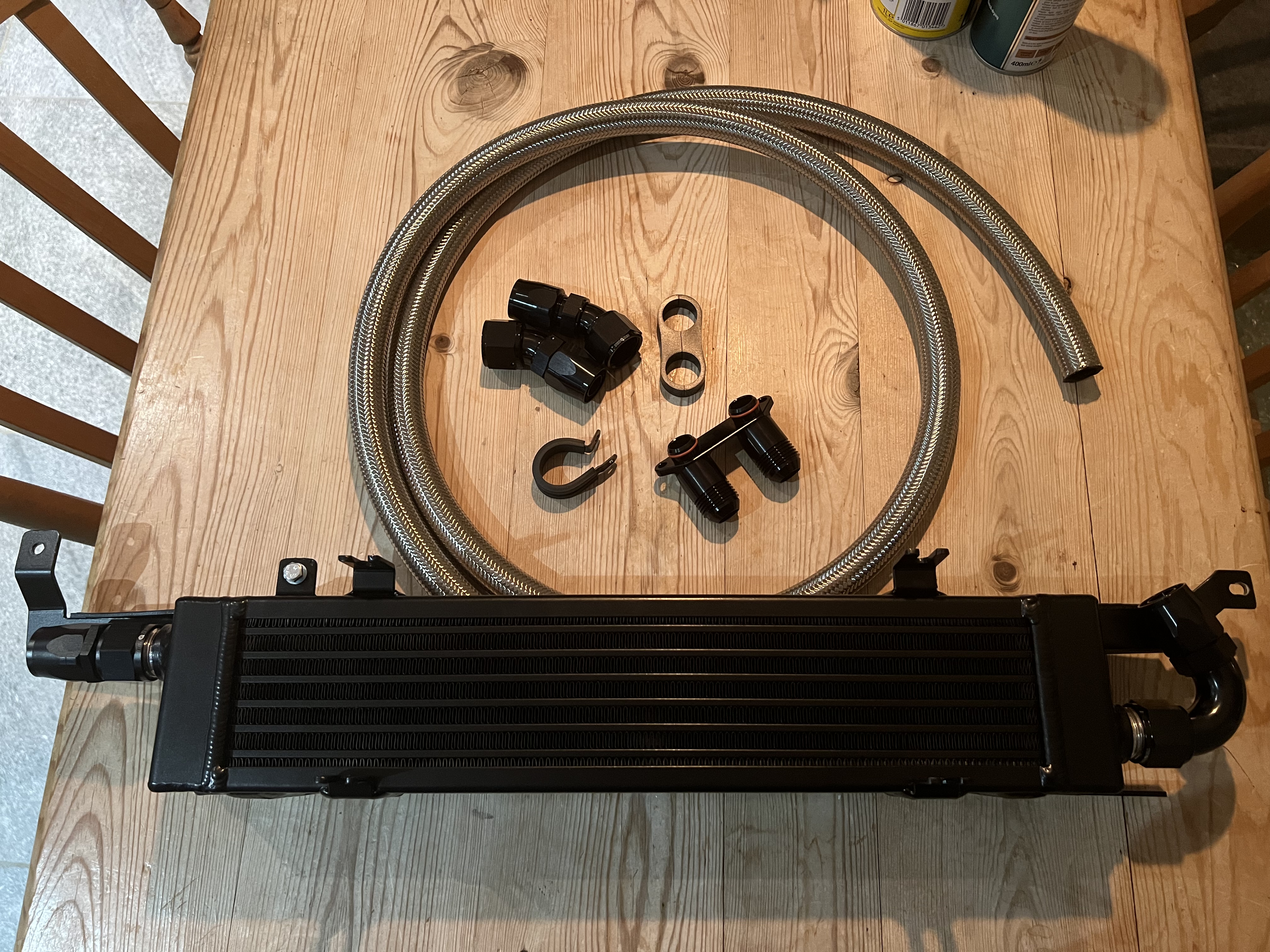

Radtec cooler arrived, very nice!

Agree Radtec looks very nice, post some install pics ..

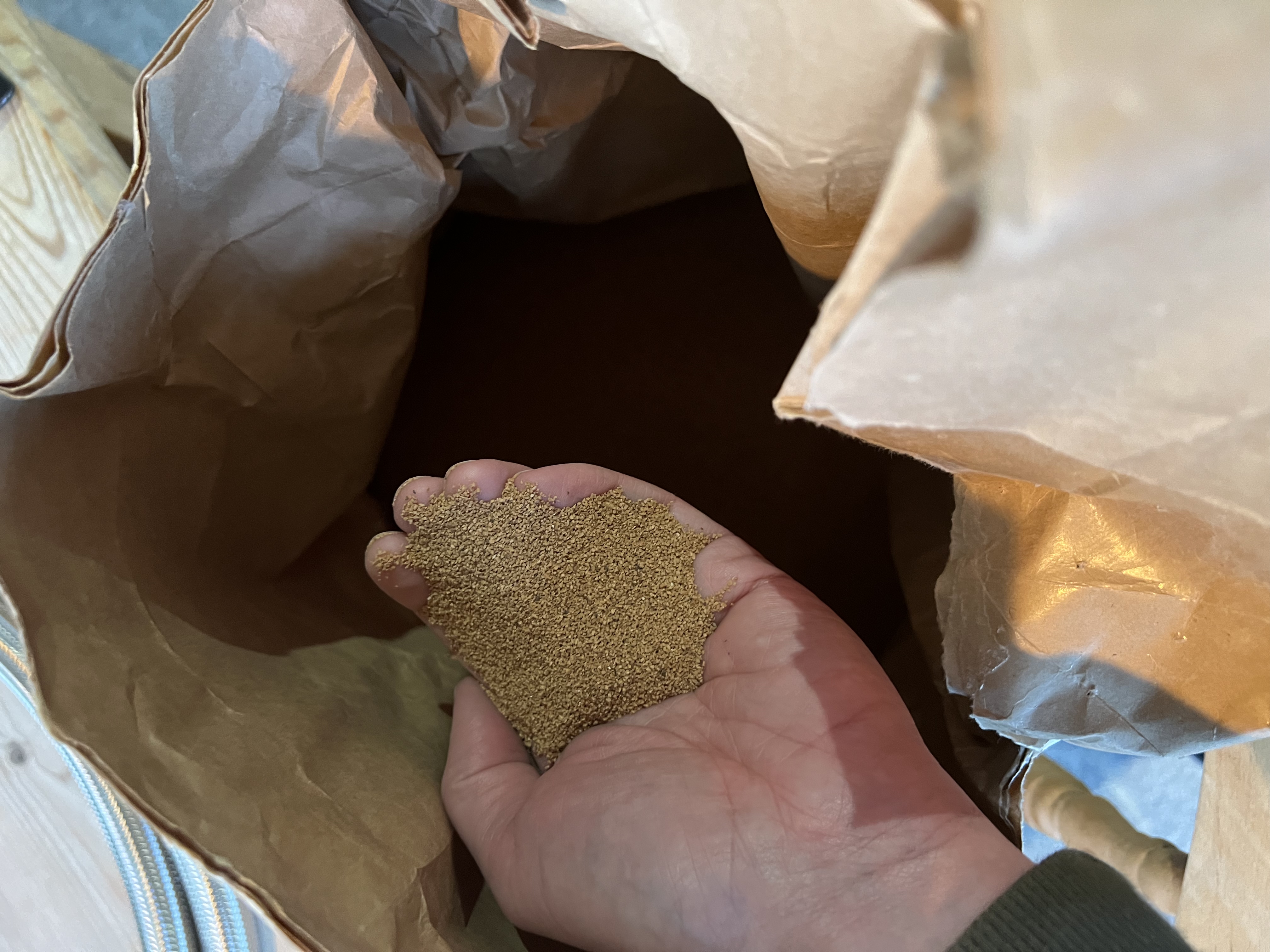

Sounds fun!, i plan to do a manual clean then final polish up with walnut on stubborn areas.
Shells arrive today. Quick delivery from https://www.sandblasters.co.uk/walnut-s ... 1020-p.asp
See how far 10kg goes, should be re-useable if it doesnt get too dirty from cleaning.

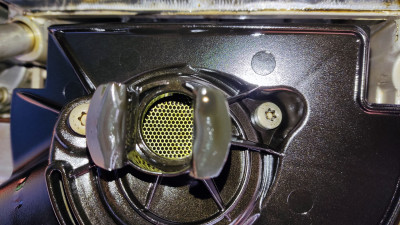

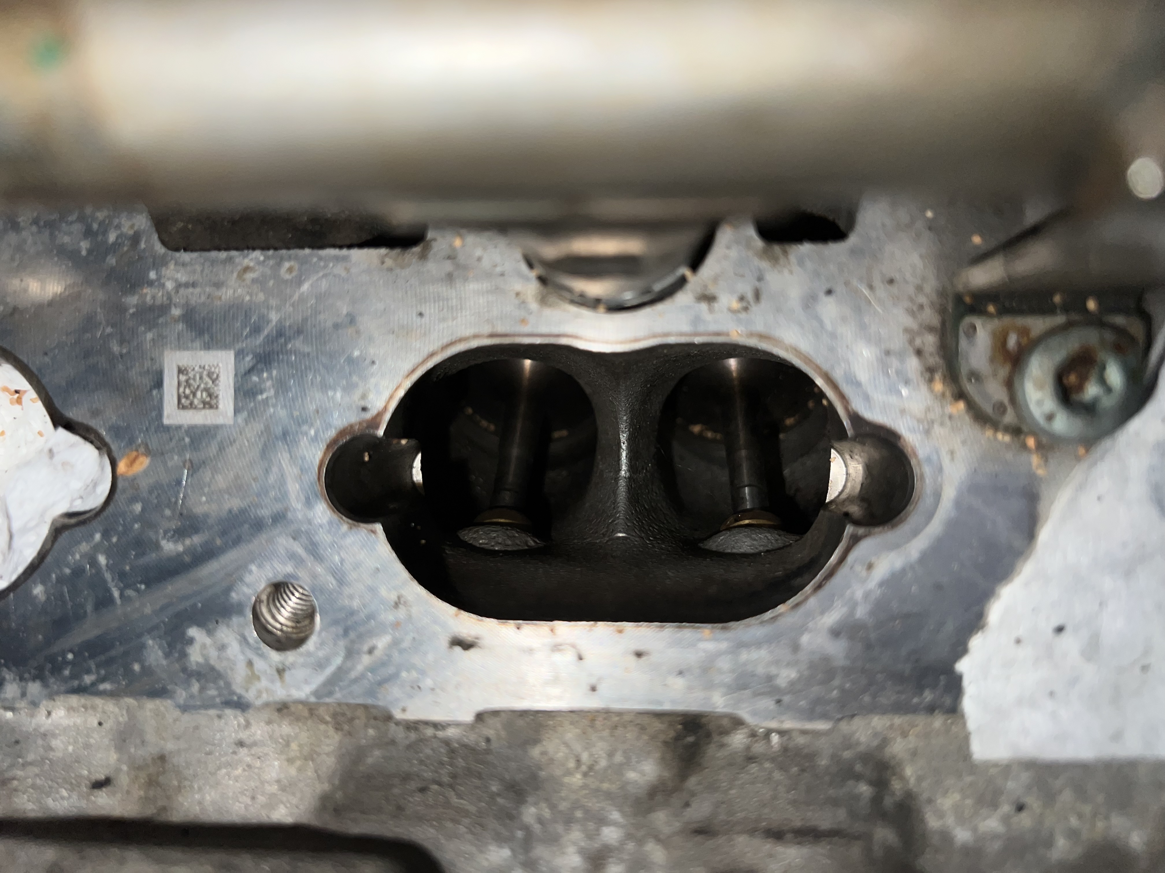

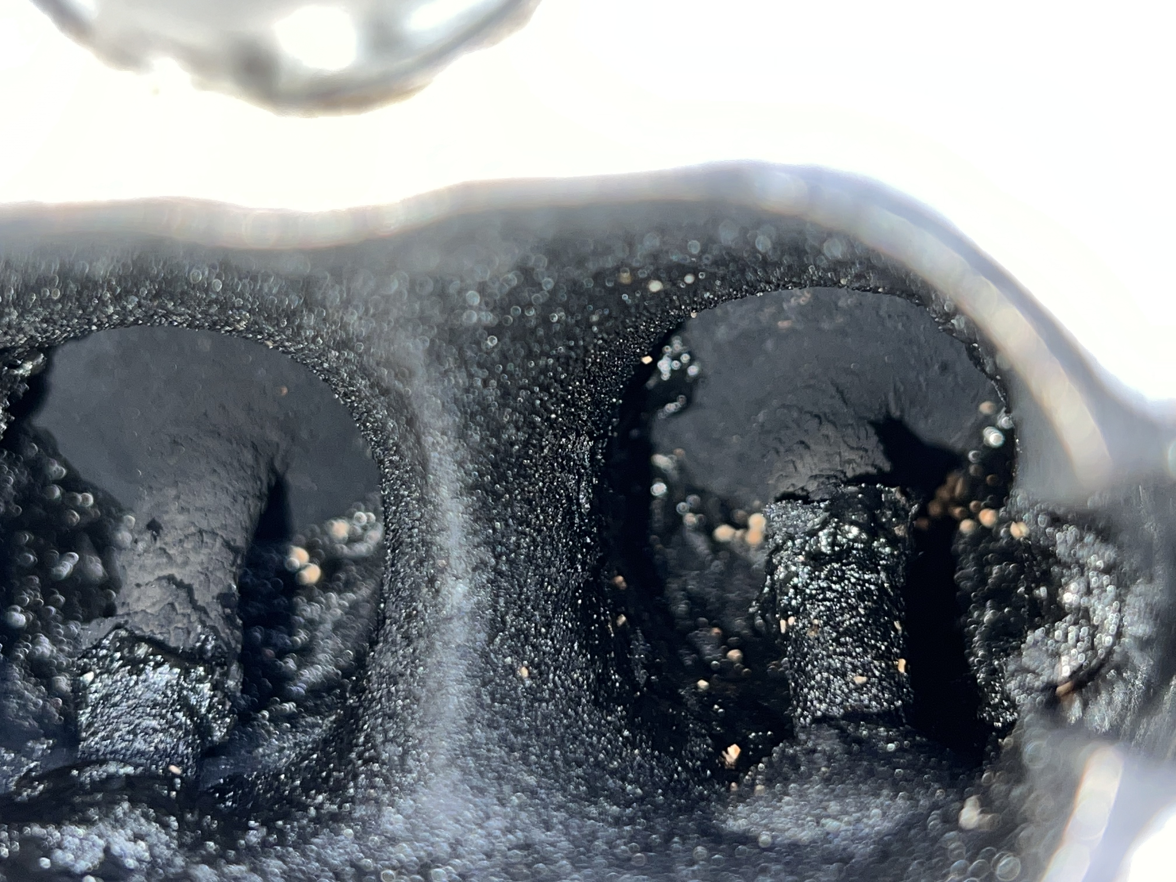

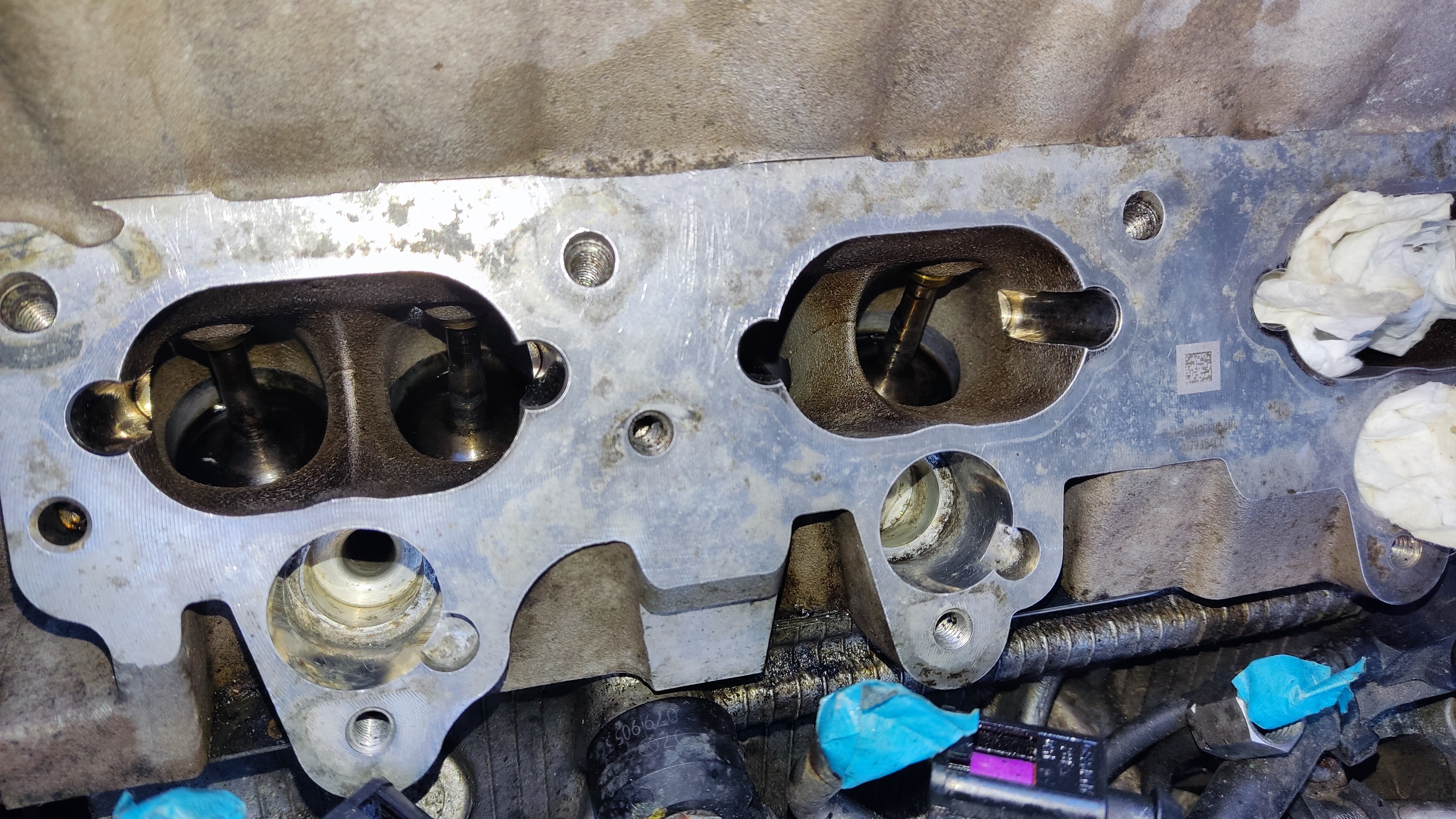

ok, well this is the result of my manual Carbon Clean.. I'd say pretty good success across all ports.. considering my back was aching like hell!
How did yours go?

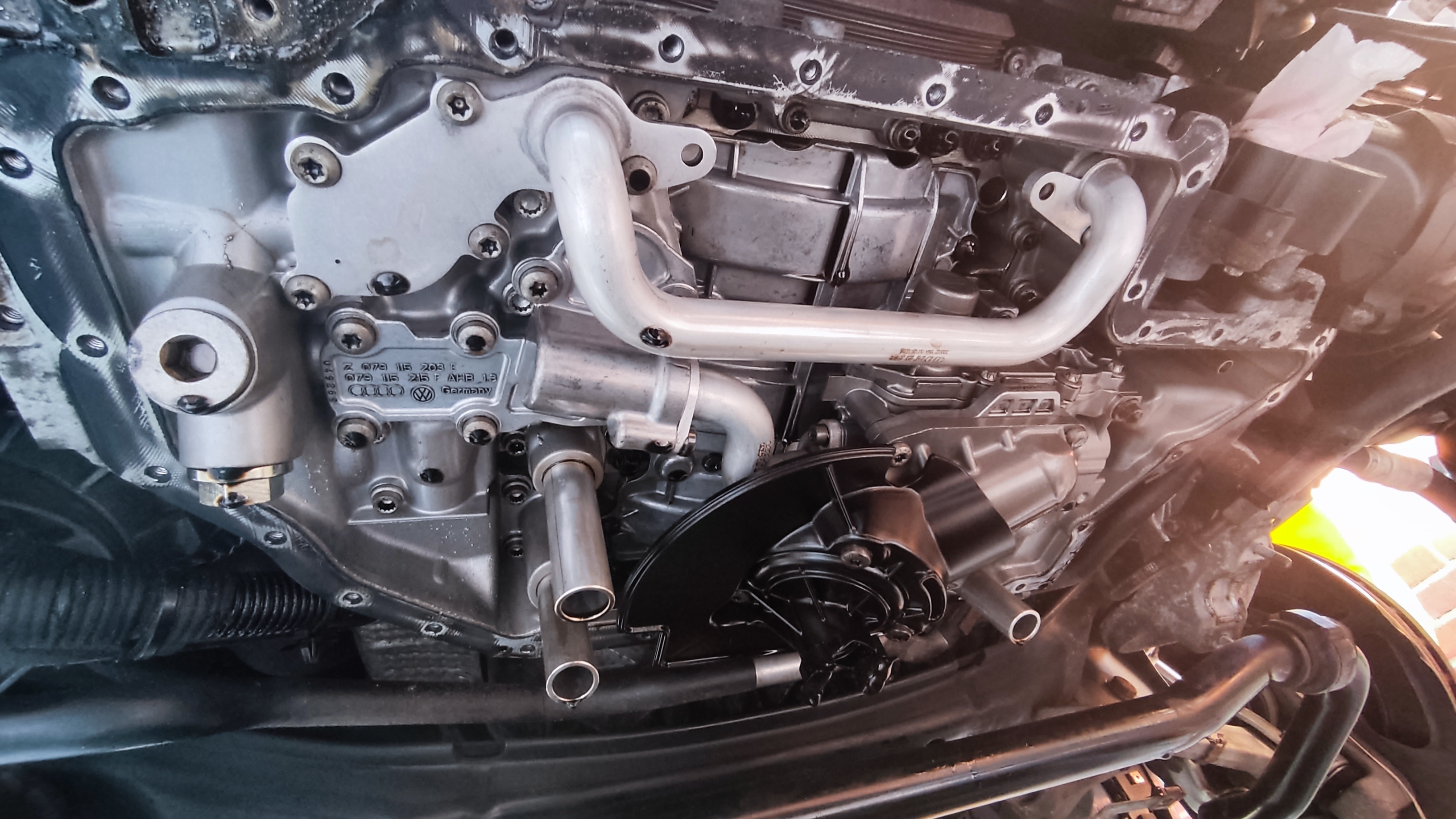

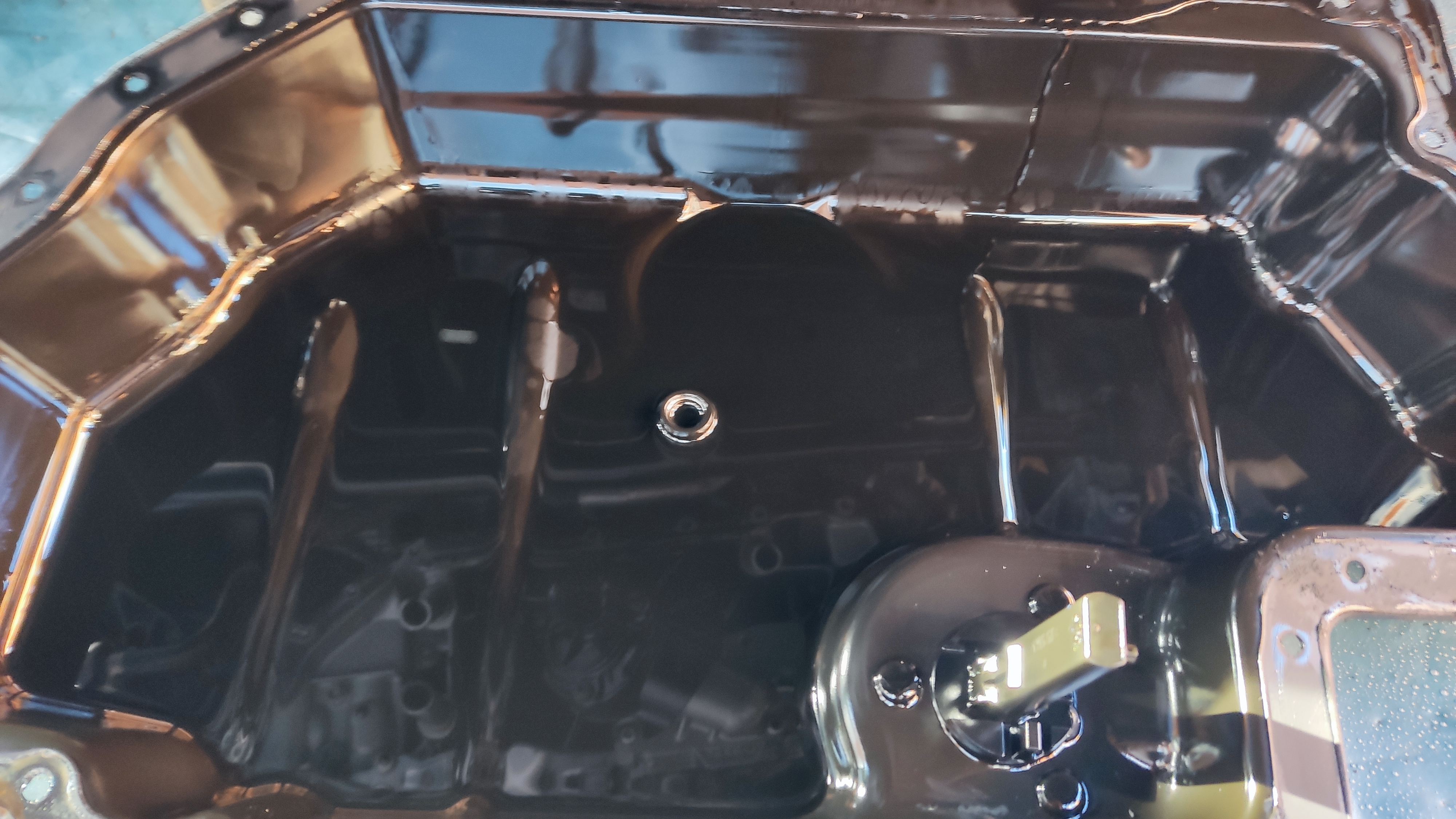

Managed to get the sump off, thankfully nothing hiding in the sump oil.
Inspected the Oil Pickup gauze, which looked pretty clean - certainly no sign of blockage

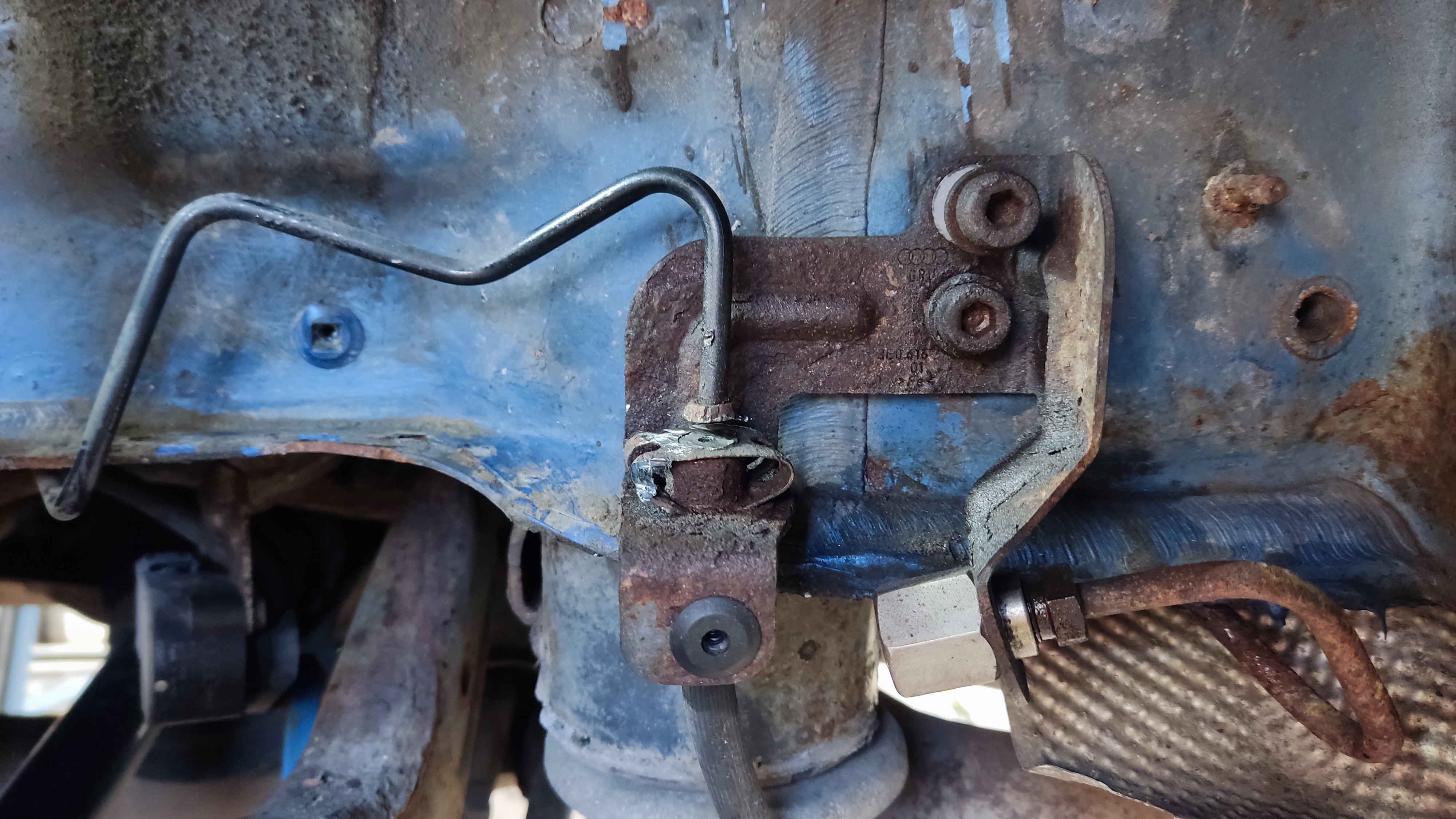

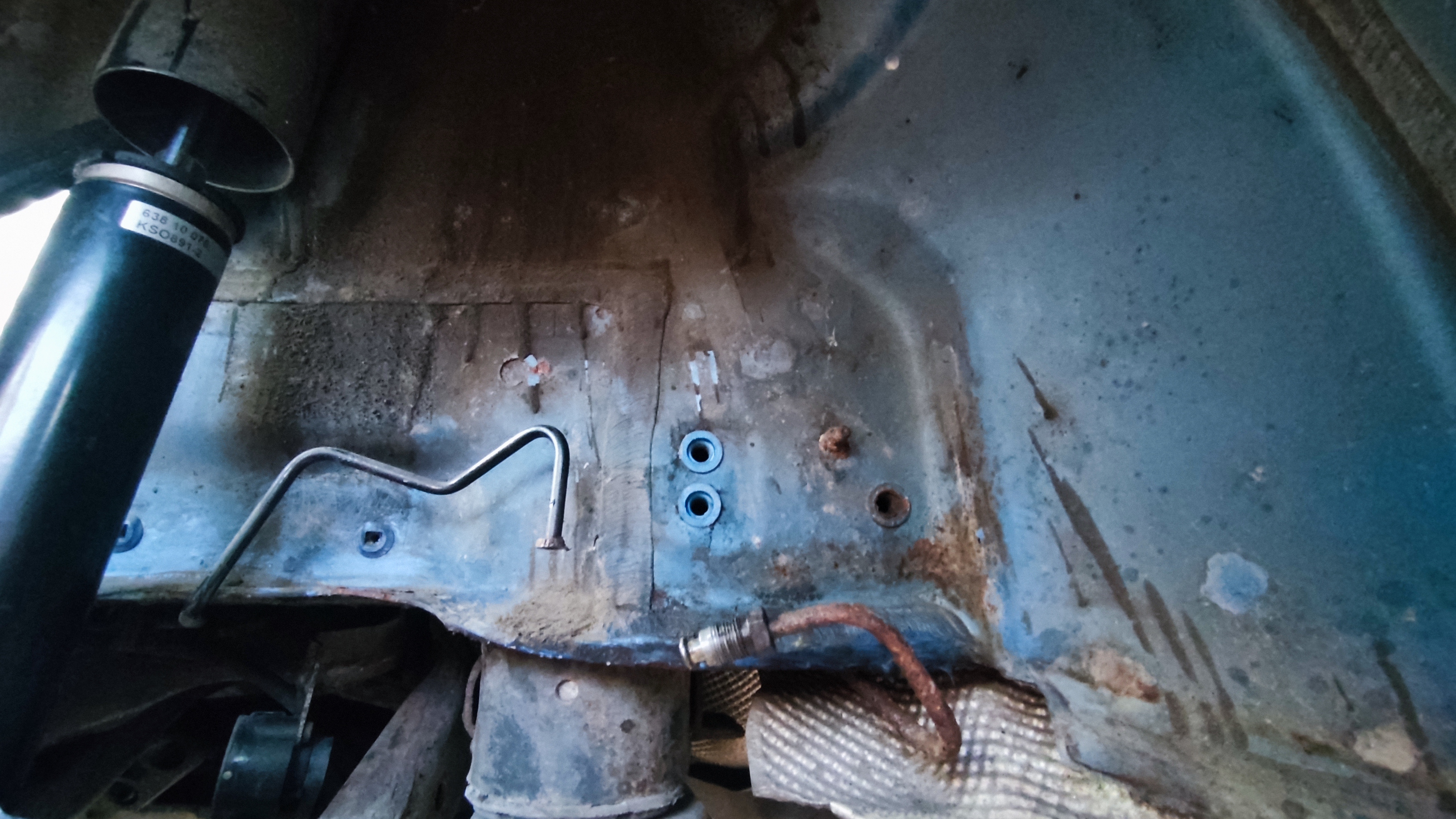

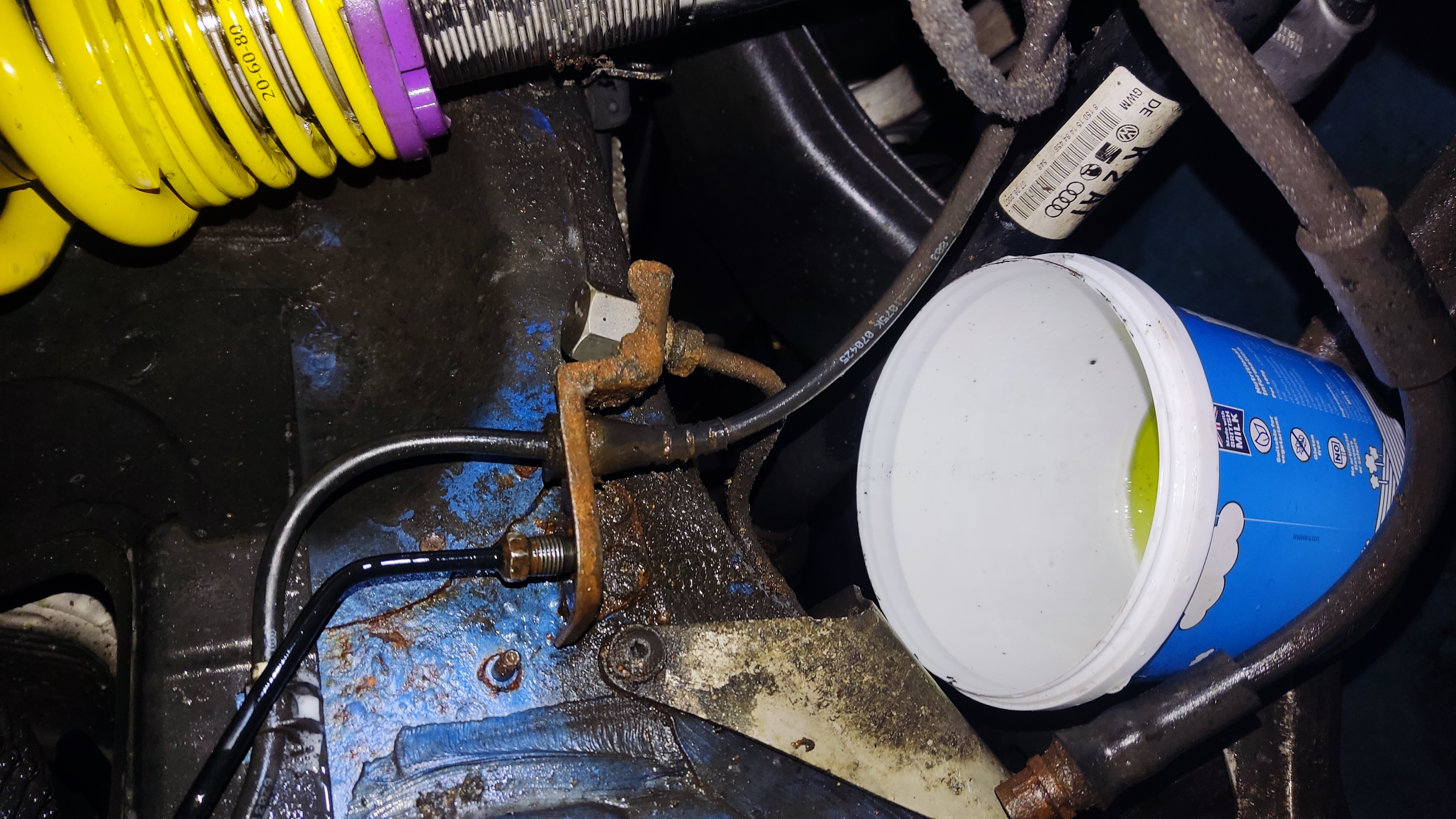

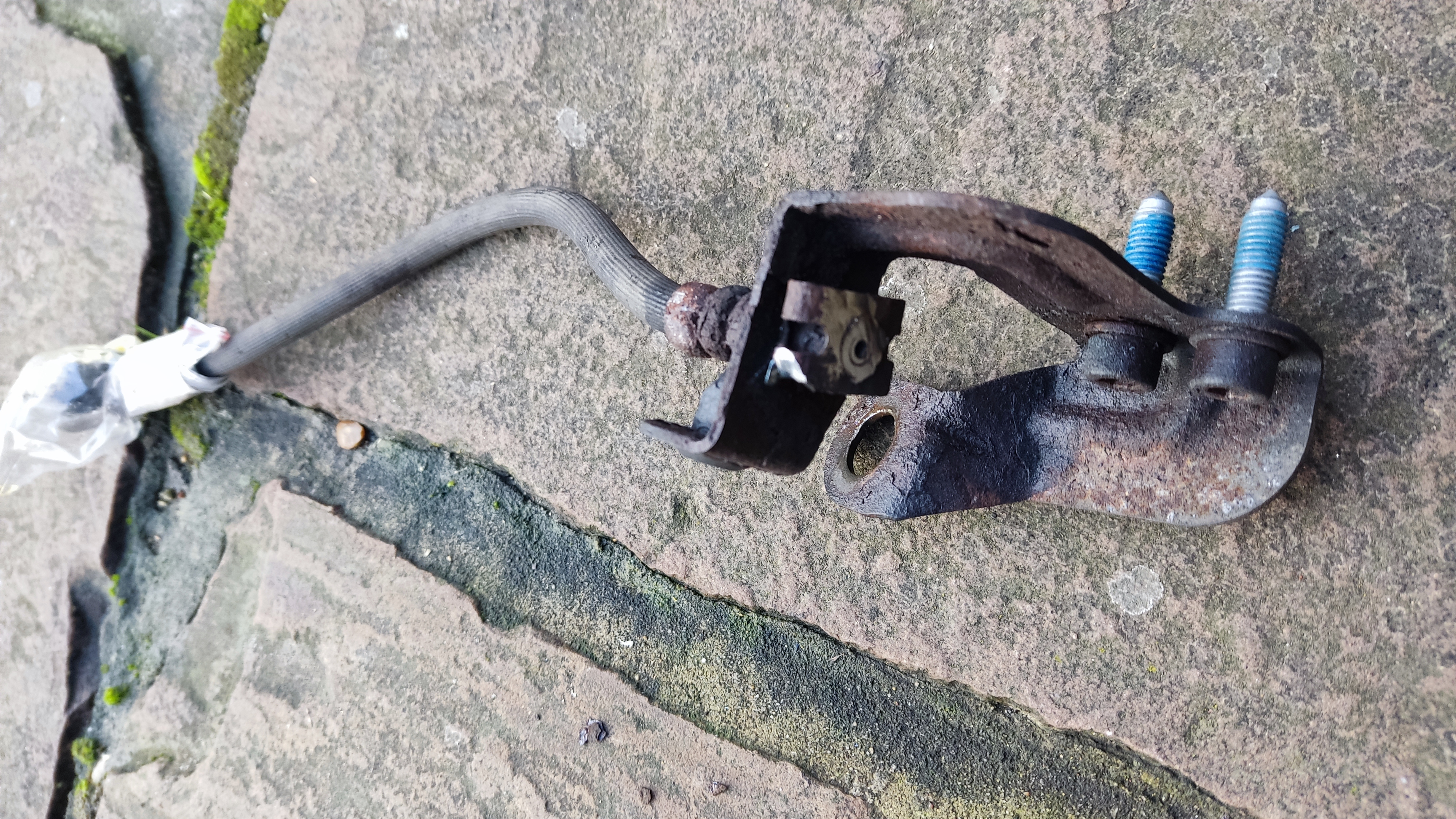

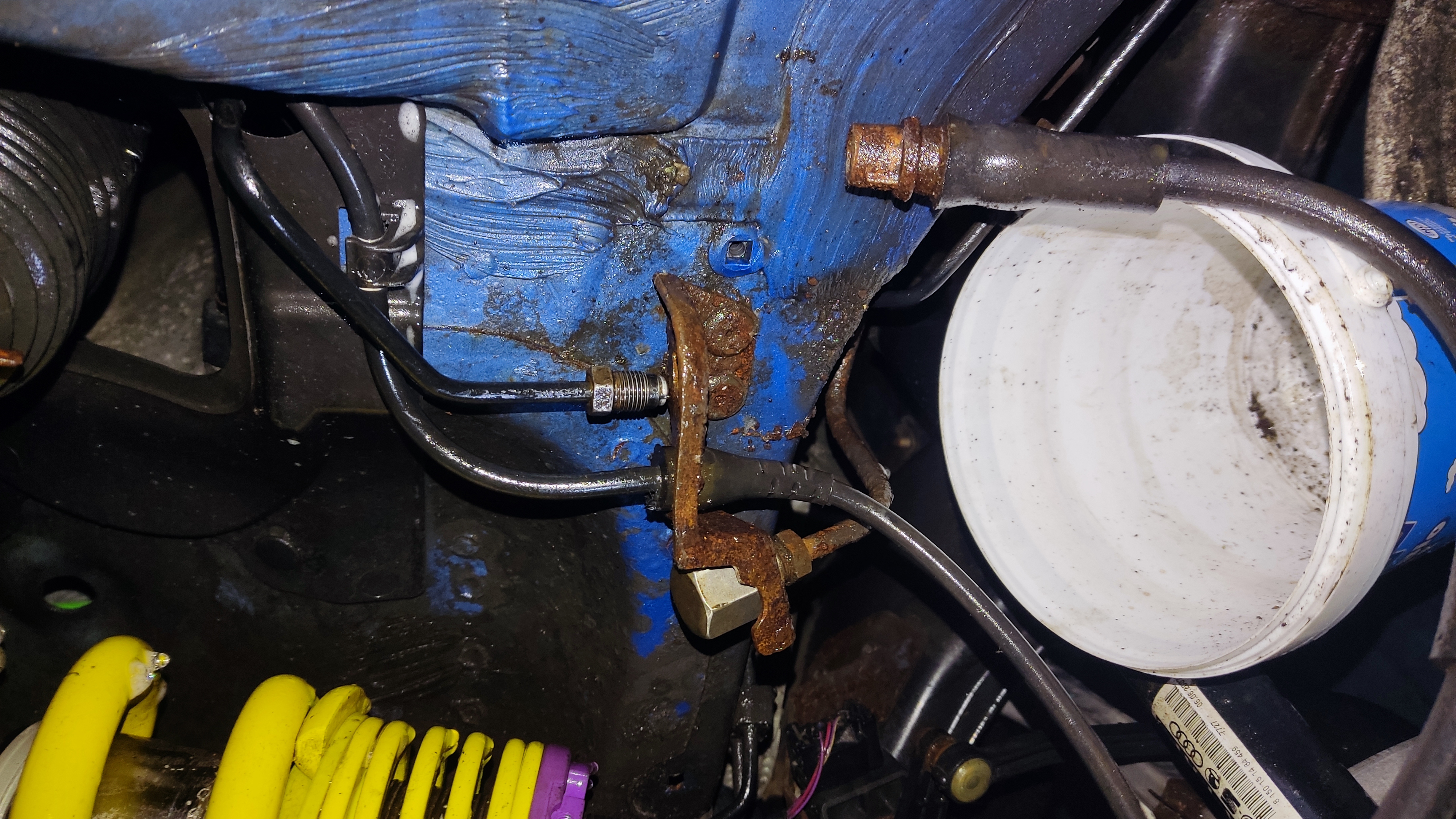

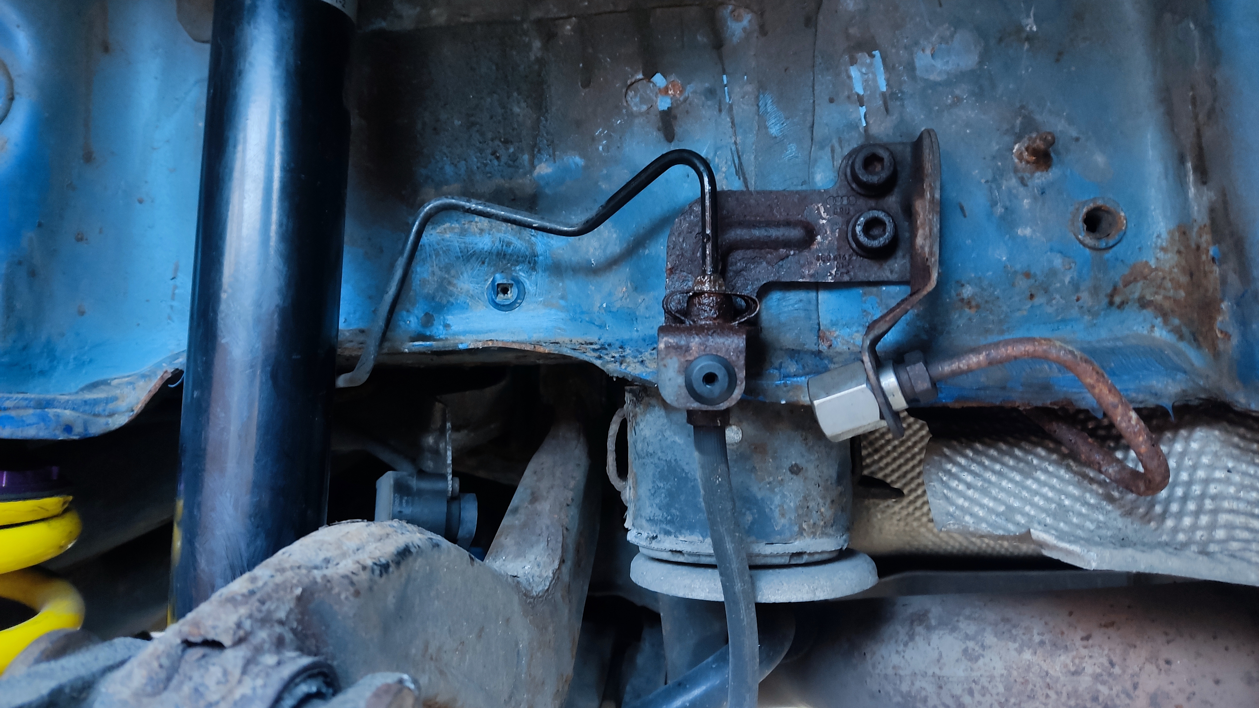

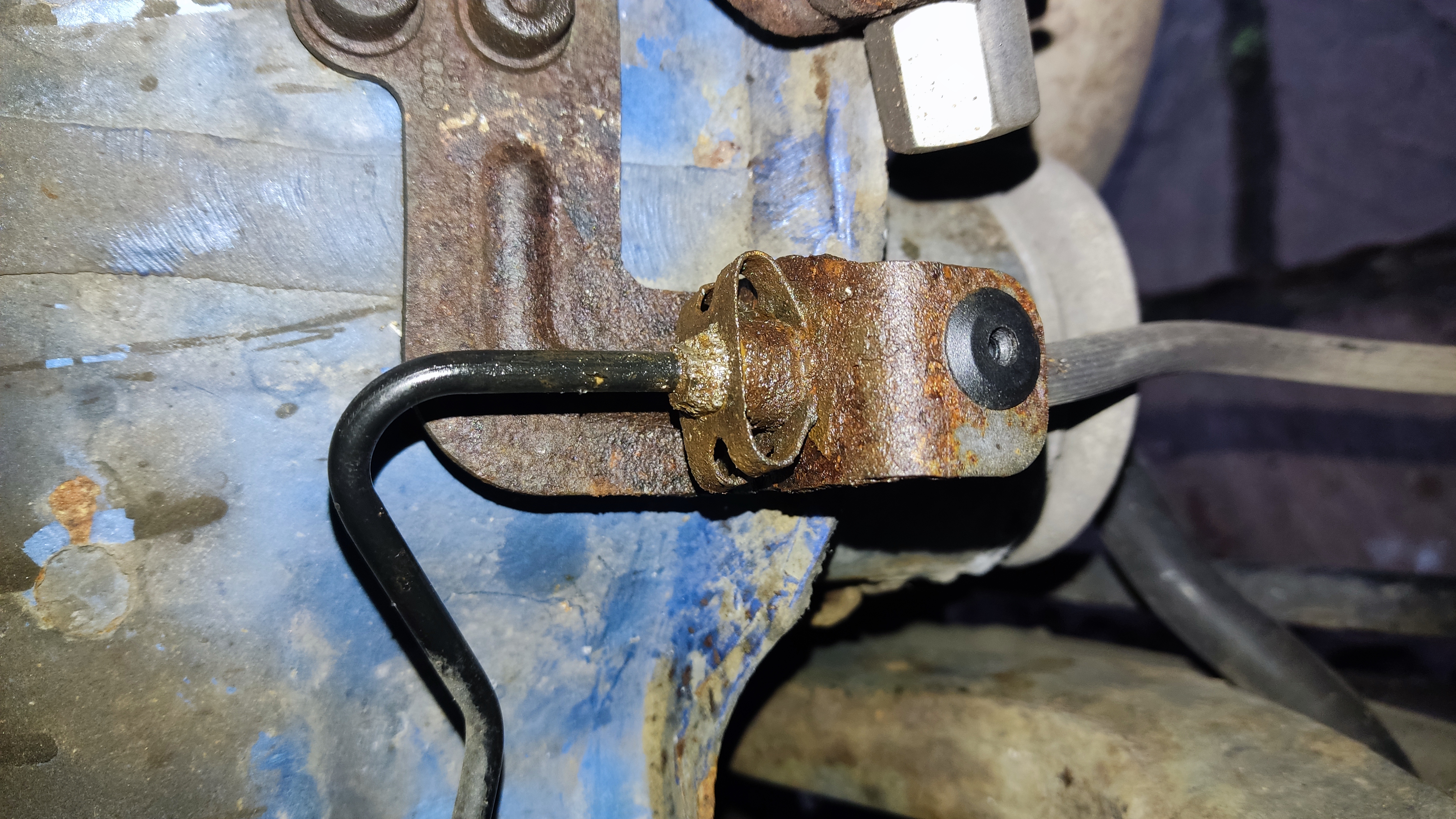

Moving onto the Brakes.. brake lines to the Front Brembo's were fairly rusty and highlighted in last MOT "...front brake pipes corroded."
Covered the unions in rust penetrating spray.. left overnight.
They were quite corroded and stiff - but very carefully working it back and forth..
got lucky and they finally opened up :

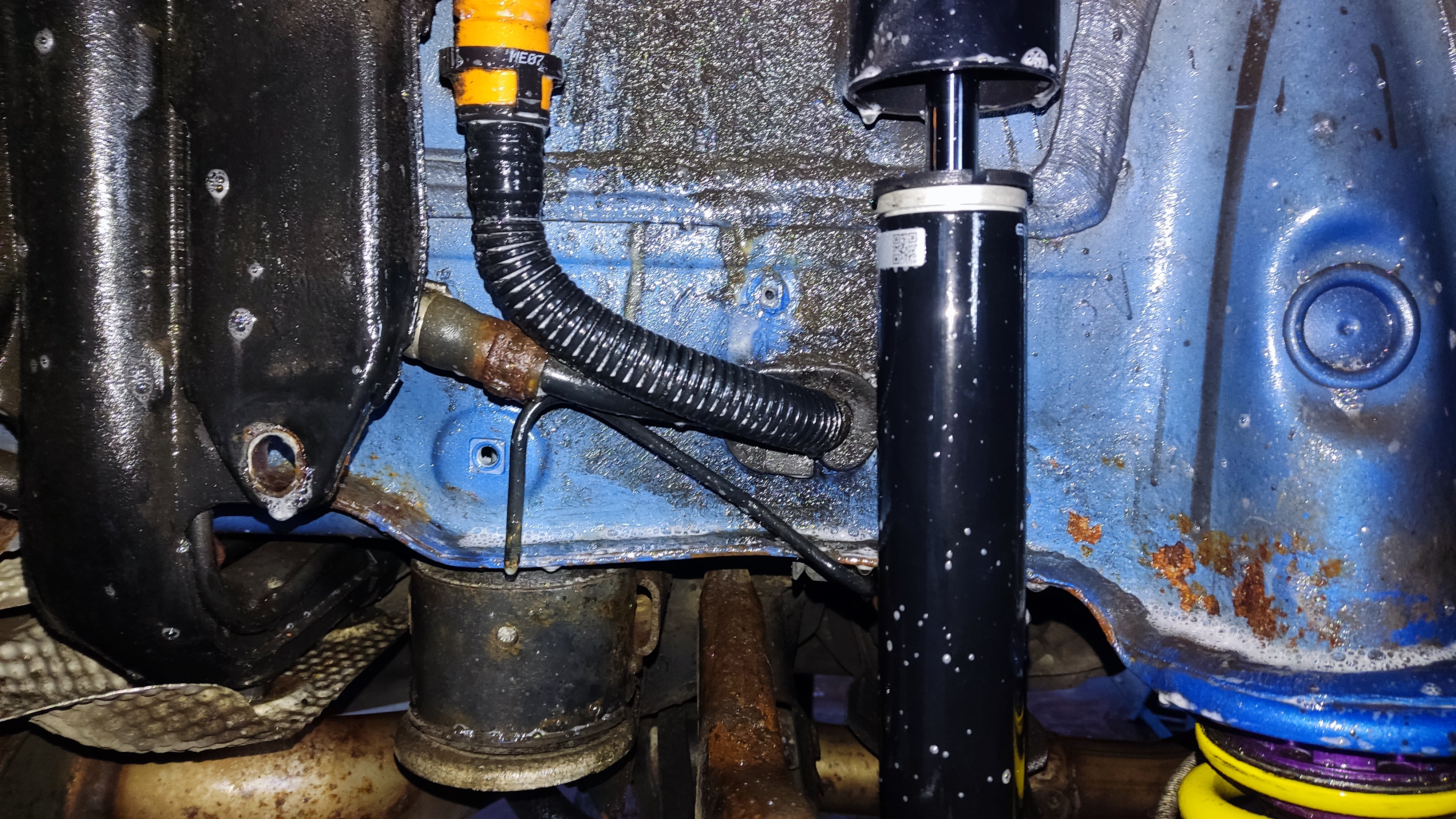

After it finished dripping brake fluid, I sprayed the entire area with hot soapy water.. brake fluid is not kind to bodywork!
As you can see, wheel arches are notorious spots for corrosion or bubbling .. unfortunately couple areas showing signs of light corrosion.
Will have to give it a good clean, sanding back to bare metal to remove the rust spots - brush on some 'Hammerite Kurust' then apply zinc / anti-rust primer, then further coat with some stonechip shield guard of some sort..
Any recommendations? Upol, isopon? Trick is I guess, is to match the Sprint Blue body-paint..

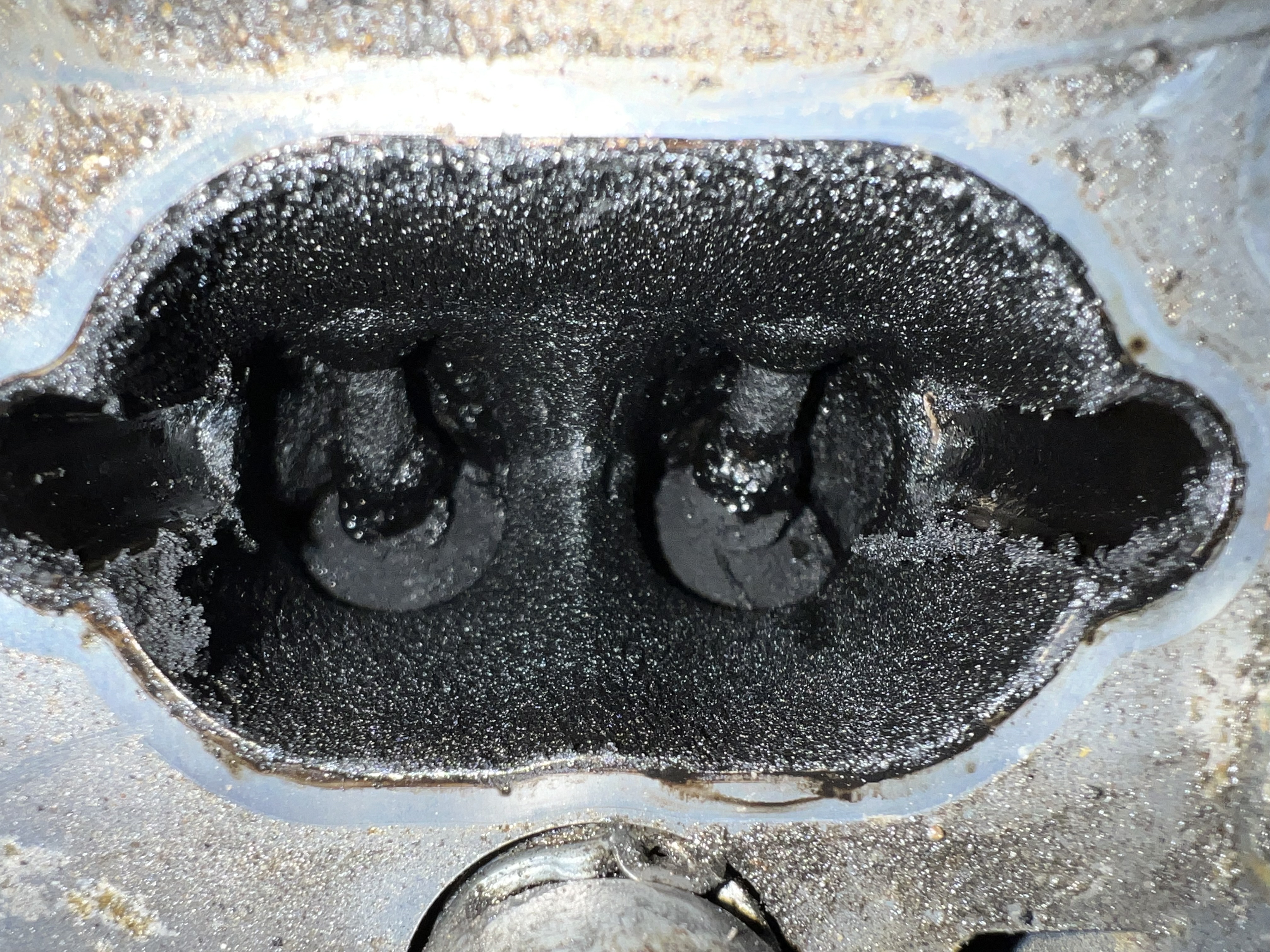

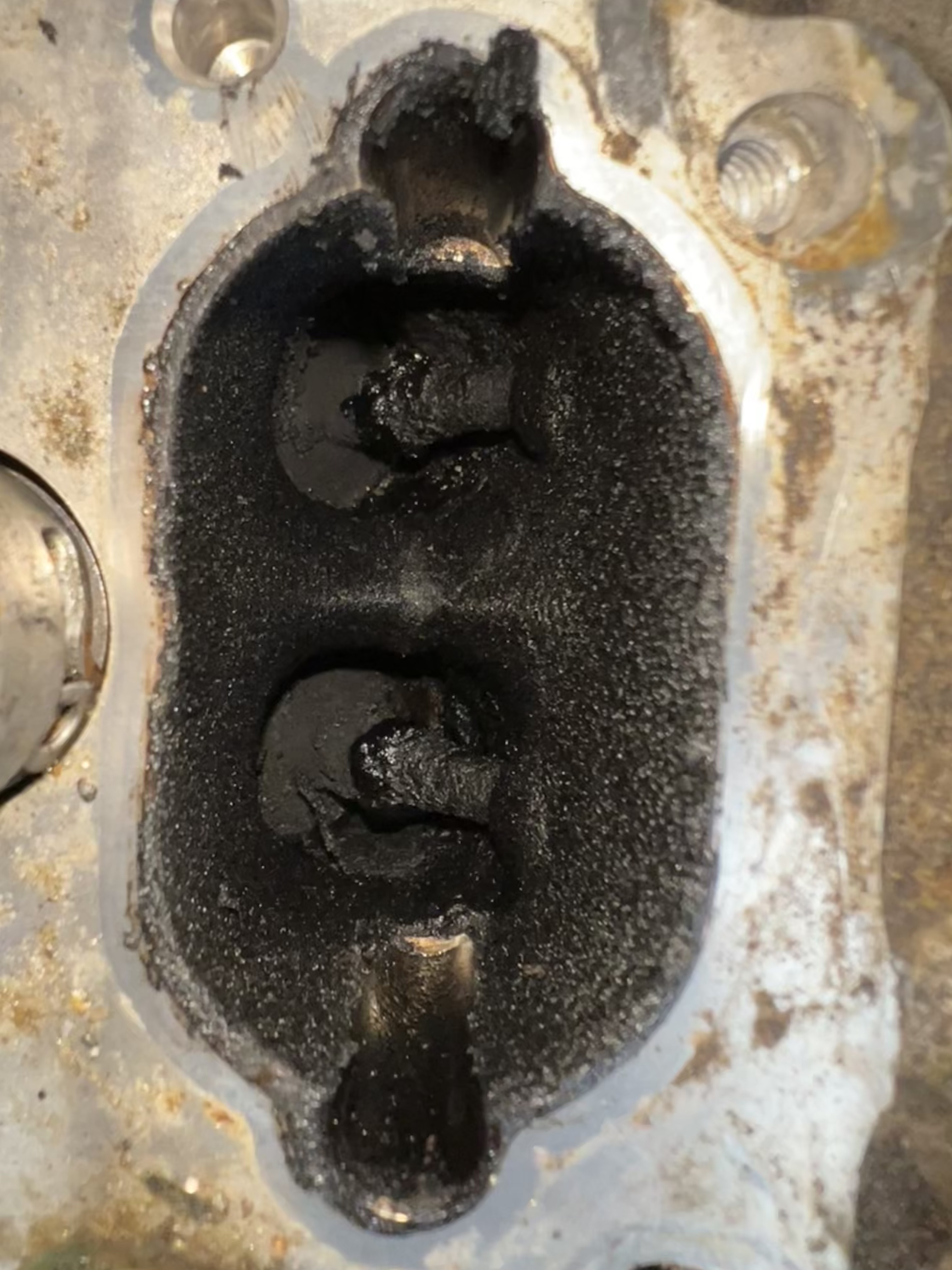

Update:

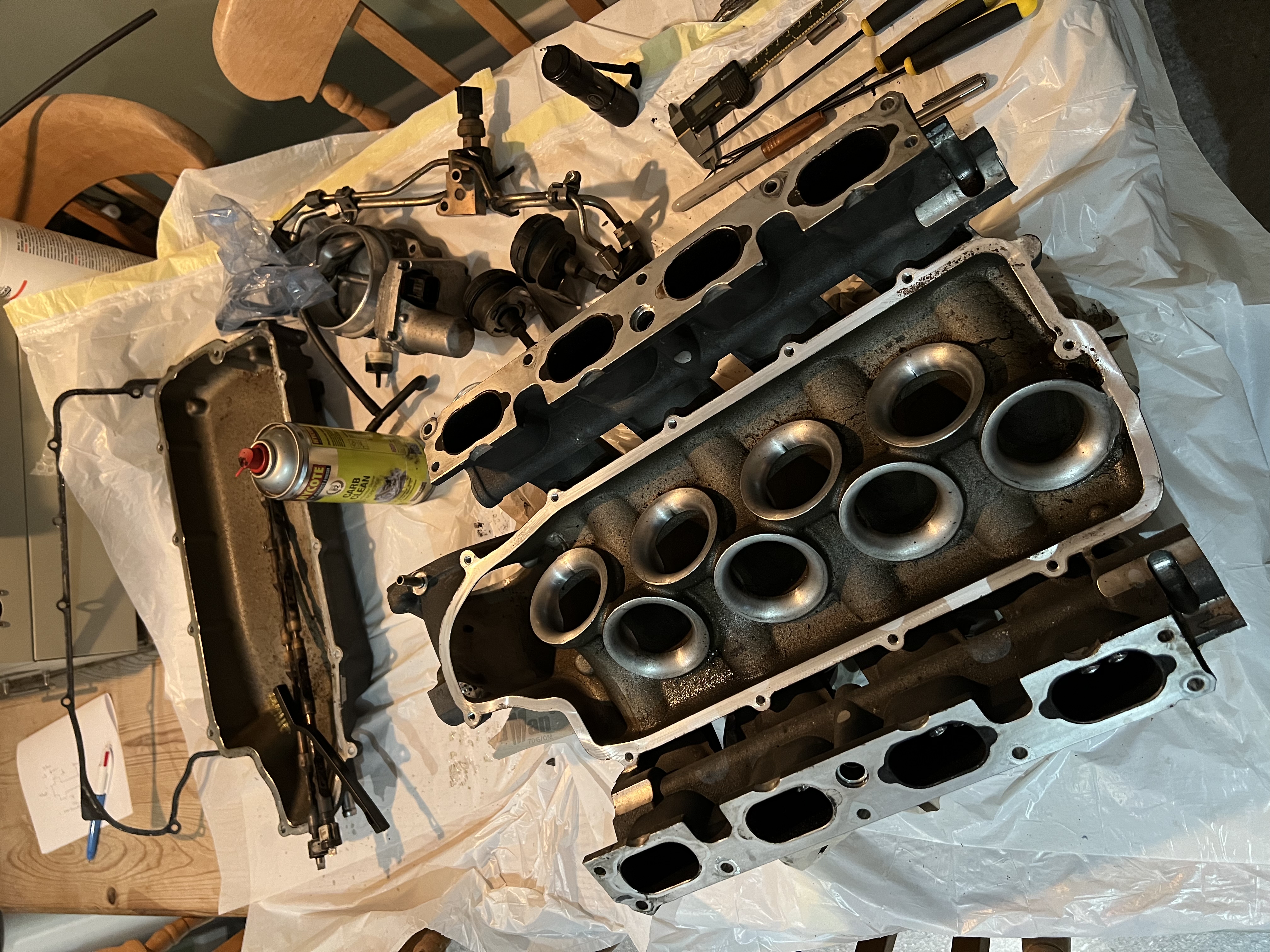

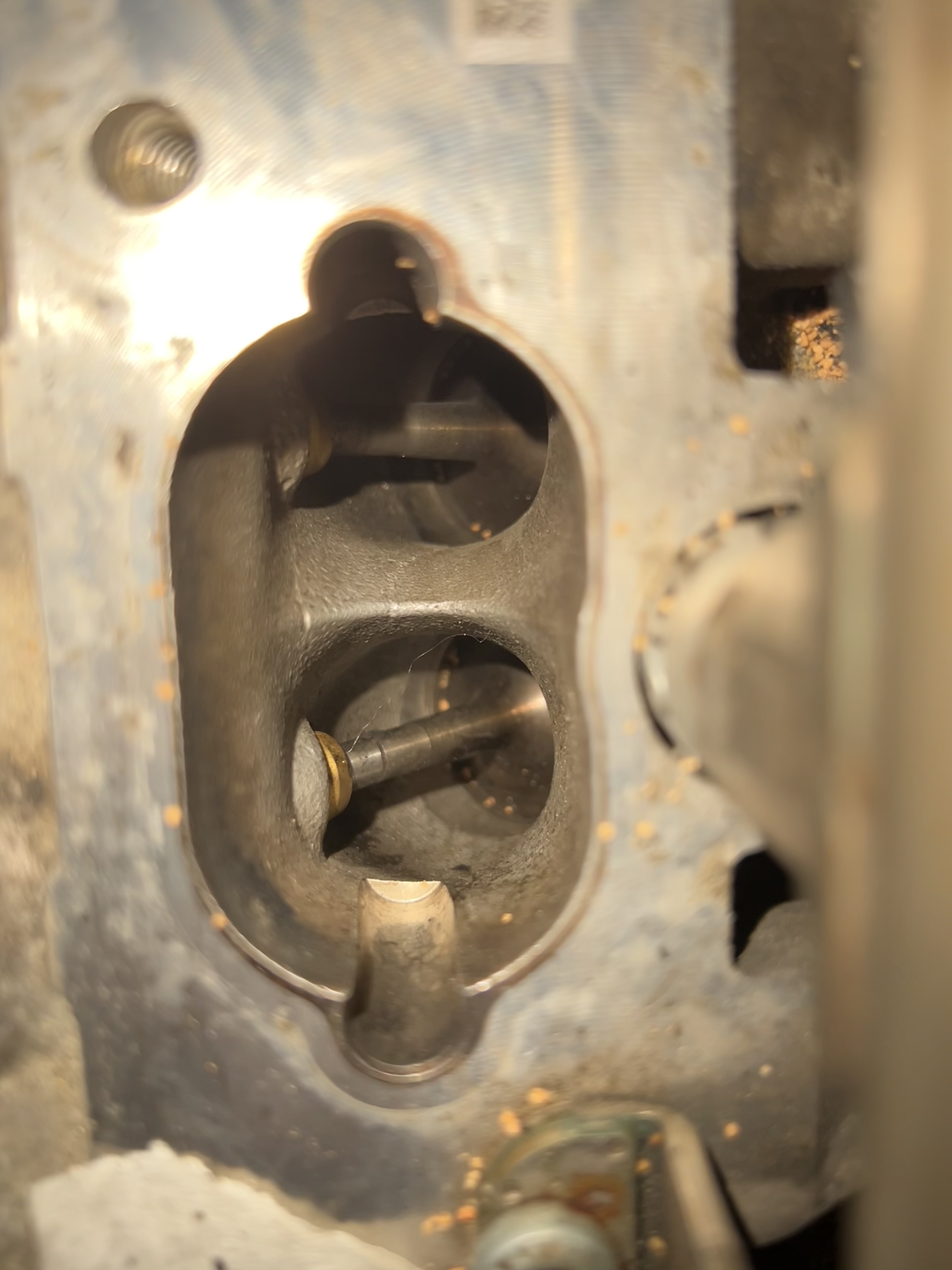

Carbon clean is well under way, was a Mess in there, looking forward to having it back on the road clean.
Decided to strip and clean the manifold, couldnt see a good way to clean it otherwise, will also look to fix the bit of play on the arms, not bad but will see what i can do. The gasket between the two halves is easily re-useable, its metal and comes off easilty.
Will loctite threadlock the screws on the manifold flaps! Have read a few thread of them coming loose!

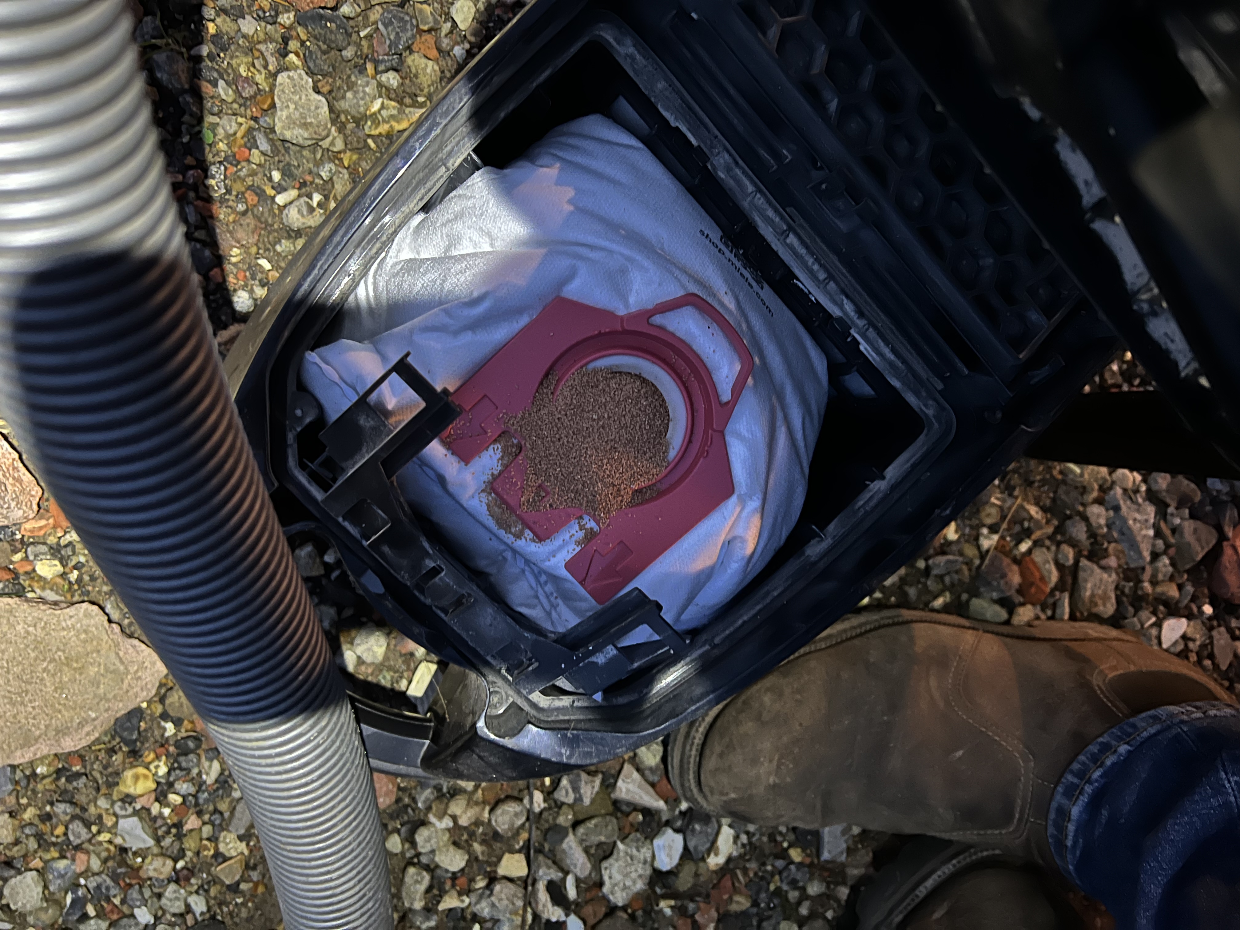

Walnut blasting made it a relatively easy task, used my old hoover and it collects the shells easily in a new bag for re-use, didnt use hardly and shells this way.

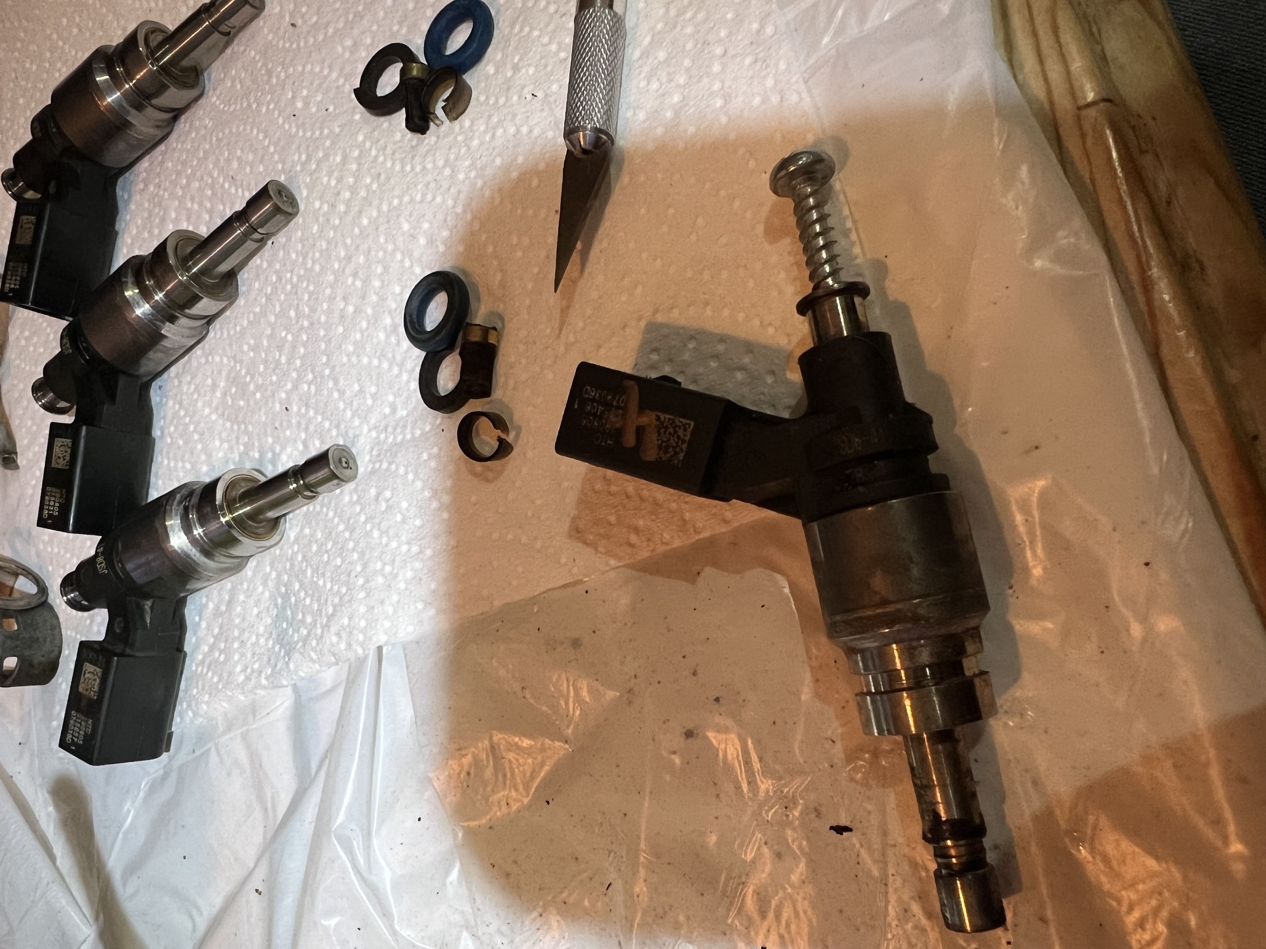

Also purchased a removal and seal mandrel kit from ebay for £28. One injector wont budge. Other came out Very easily.

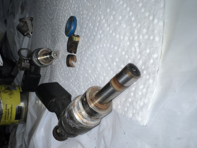

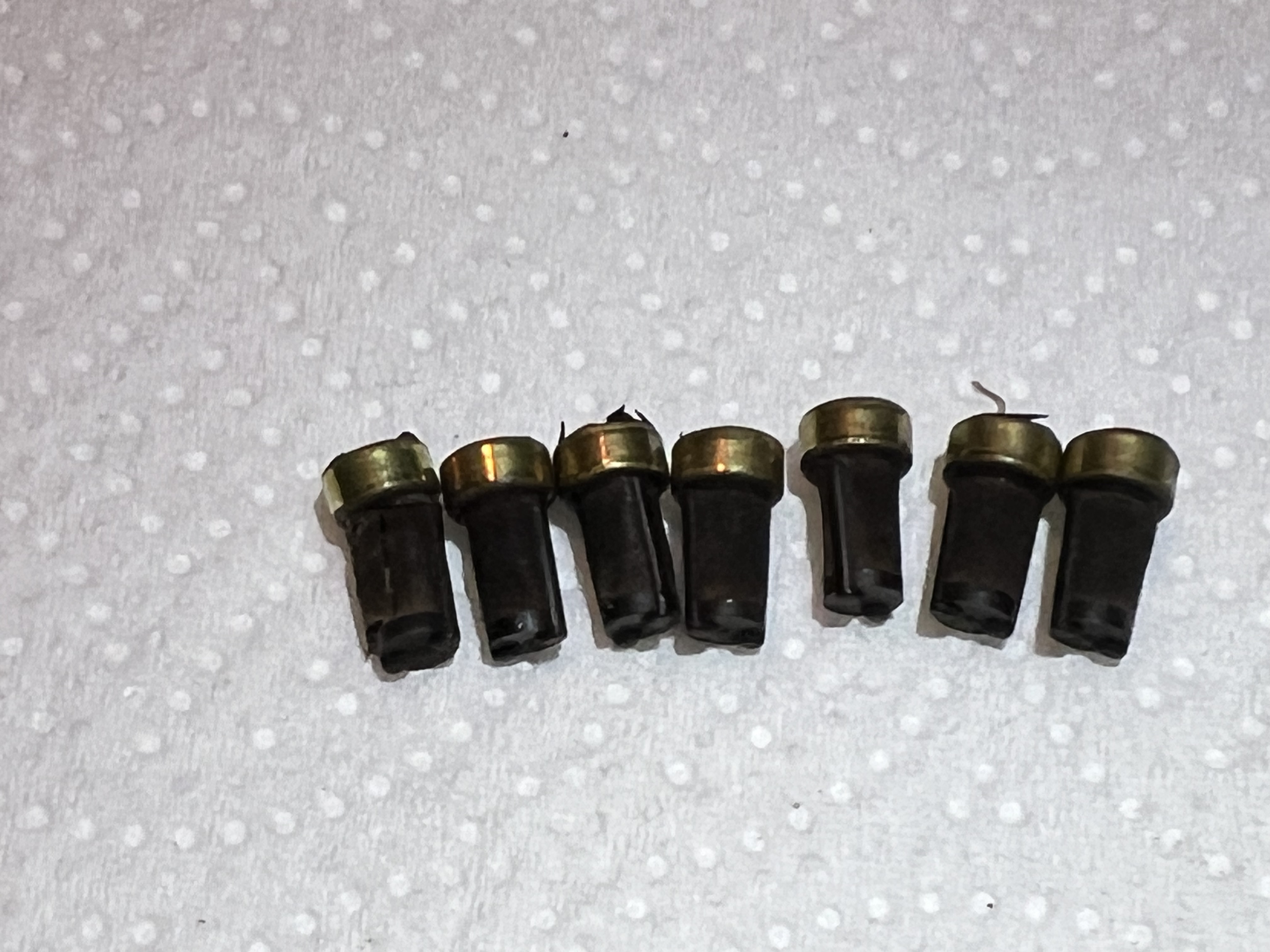

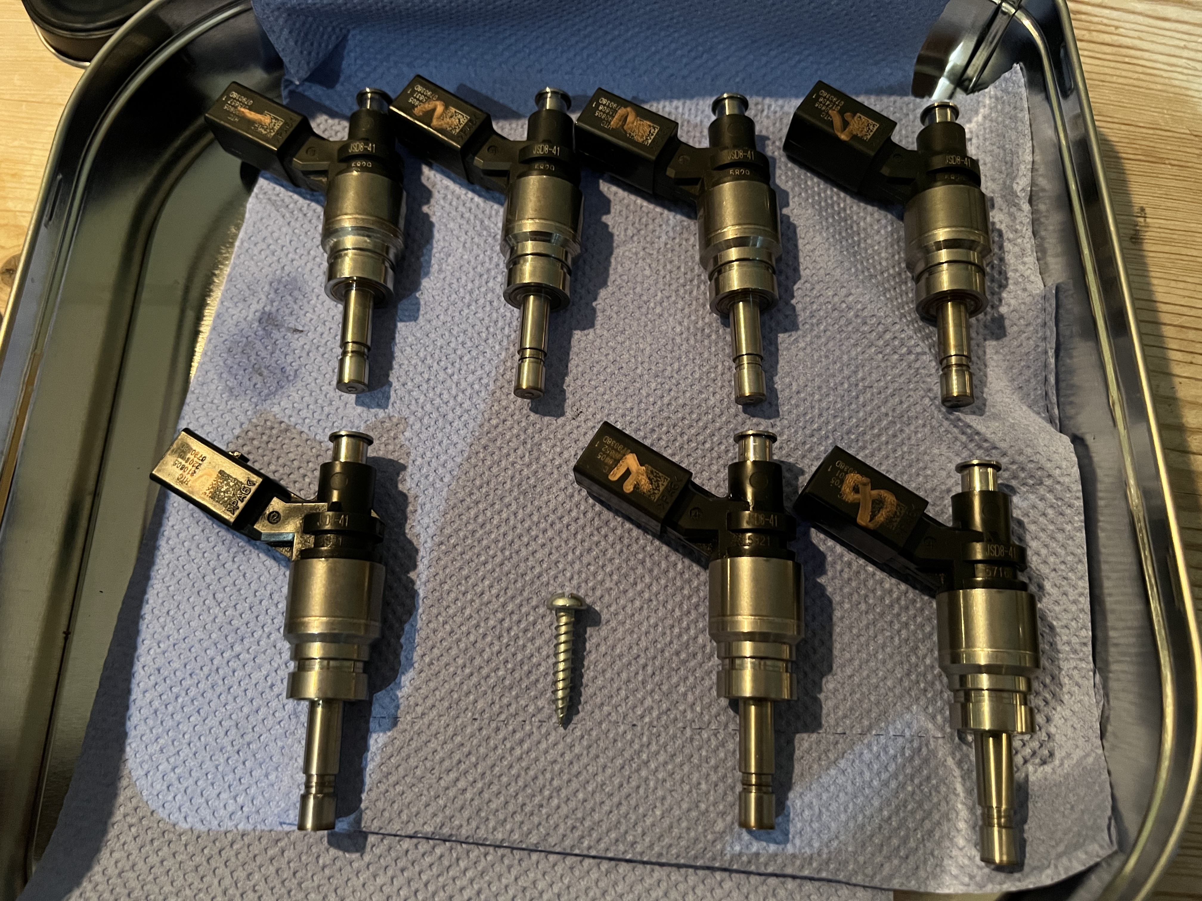

Injectors not looking bad, small amount of carbon on the tips, wiped off easily, 3rd photo shows one wiped clean and one as removed.
Will test them for spray pattern and take it from there.
Removed filters, will replace all seals and filters.
Filters came out with a screw and pliers, trick is to get a good fitting screw, tights enough to give a up and down motion as pulling hard, they come out fine.
Would benefit from beinf replaced by look of them, intact (ive heard the can break up), but not overly clean.

Moved onto rear brake lines.. and that's where I got a nice surprise:
Funny. None of my spanners seemed to fit :audibash:

Post by r8wut » Fri Jan 26, 2024 12:48 am
Time to bring out the Angle grinder:
