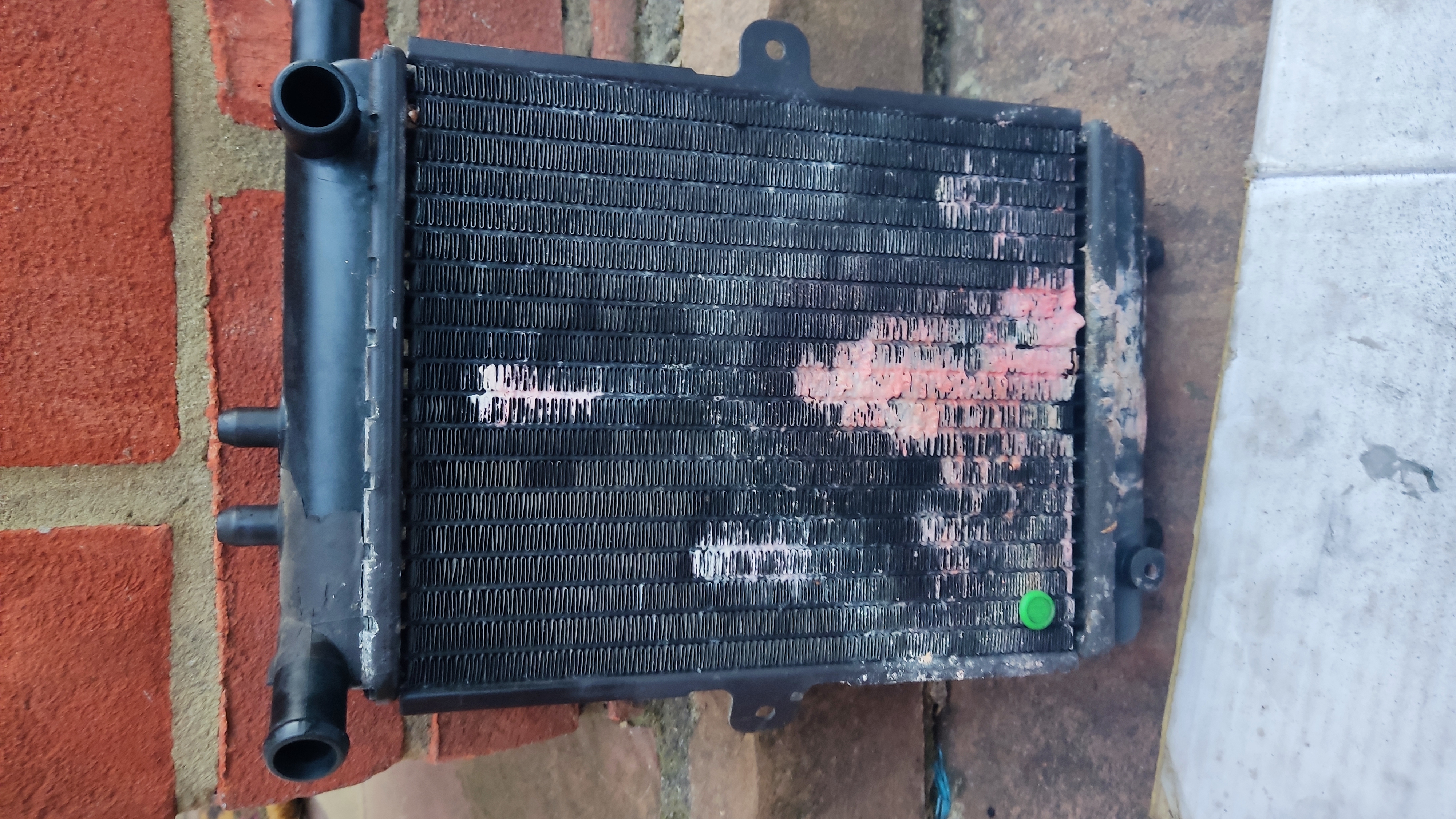

btw. Did you check your Driver's side / off side Aux Radiator whilst performing your overhaul..?
mines at 77k - so relatively low, but just slightly higher mileage than yours .. and this is the condition of it:
Want to keep OEM, as opposed to installing a CAI for example - but replacement Aux. Rad from Audi is .. £254.50+vat ! :audibash:

lucky your Aux Rad is still ok..

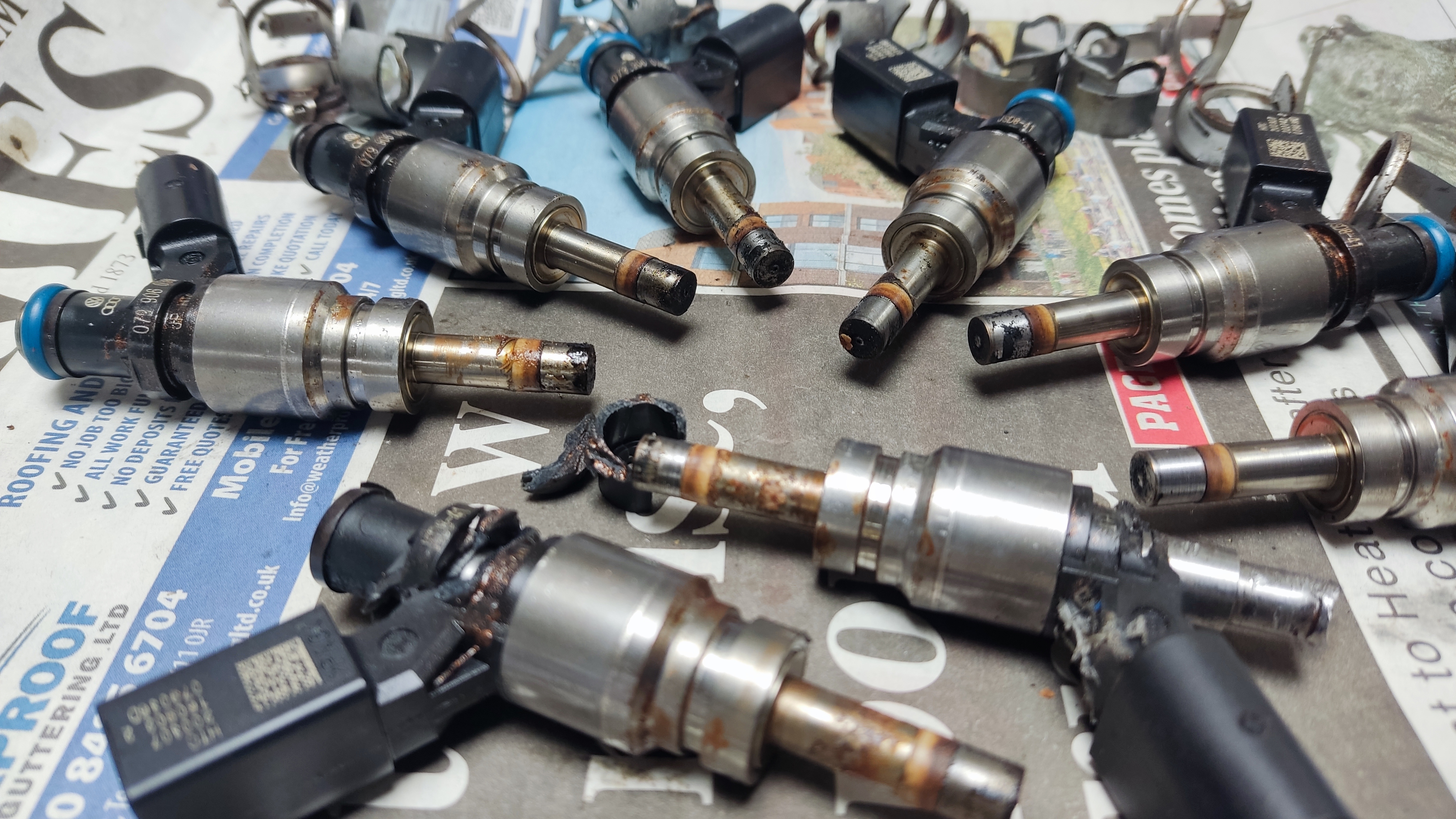

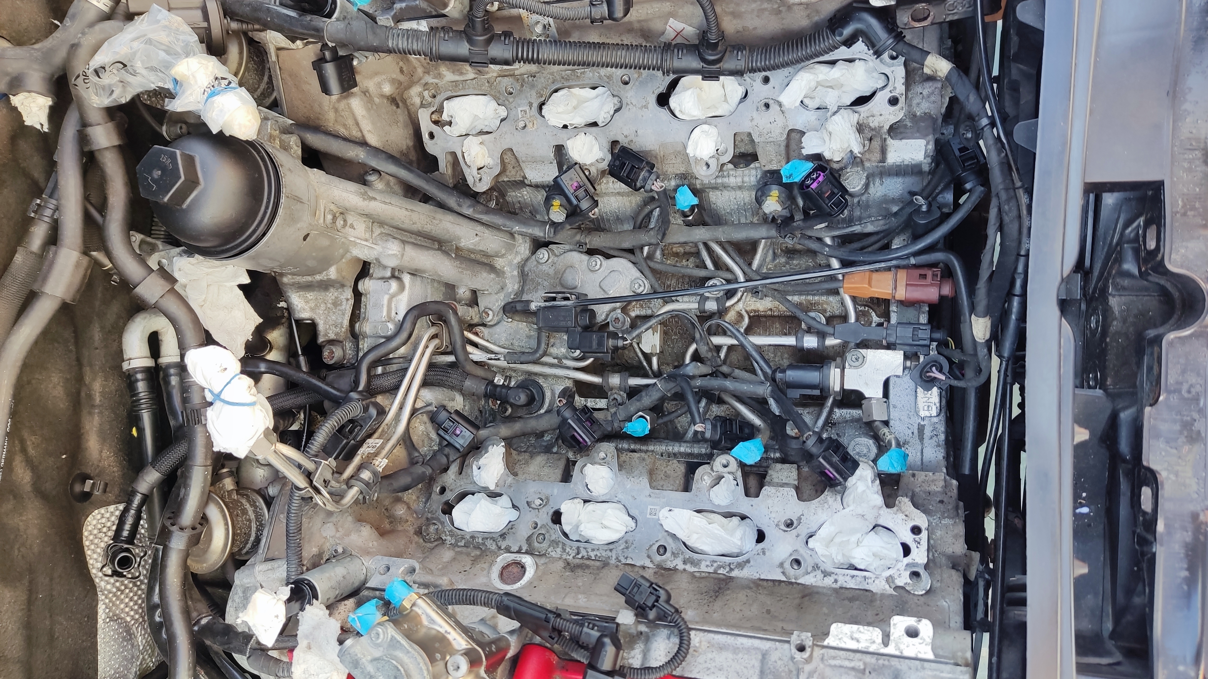

Pulled the 77k Fuel Injectors.. 2 of which were seized in there really nice .. and got out eventually.. but cracked :roll:

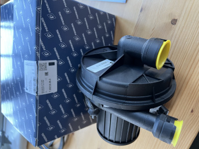

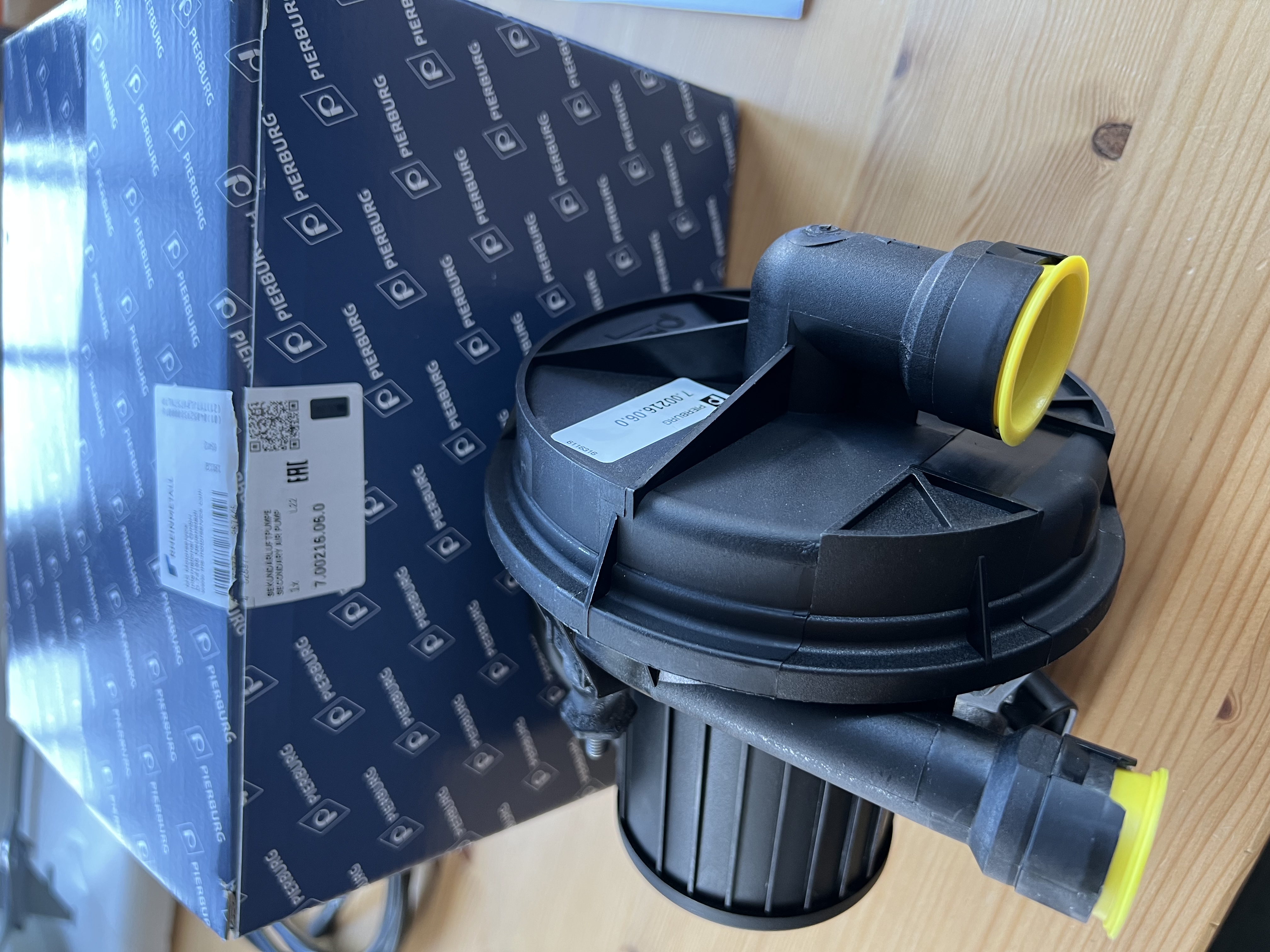

New Secondary Air pump arrived from KMotorshop in Czechia.
Fast delivery, £100 cheaper than any other source. Great for Pierburg OEM parts.
https://www.kmotorshop.com/en
For reference, a new good pump motor measures 2.3 ohms. Old was was open circuit.

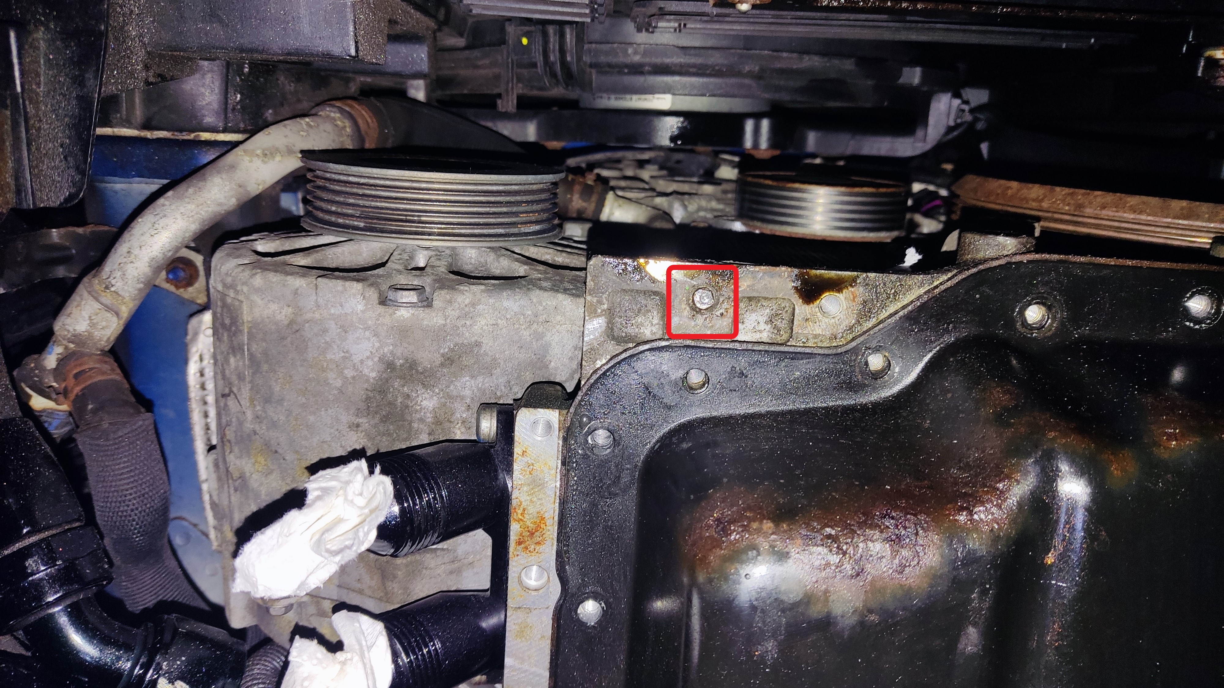

Access to and removing the sump (which is quite rusty) is a bit of a ball ache..
Firstly, as you have to remove the Coolant supply hardline pipe [079121481R] from the water pump to the engine block.. and I managed to strip one of the torx bolts in the process :oops:
Don't worry. Managed to partially drill out and remove the bolt .. thankfully without damaging the threads on the block..

Despite my various best efforts, the stupid Torx bolt for the Bracket for the Belt Tensioning Damper continued to be a ***** / impossible to remove ..
so now have the envious task of carefully tapping the hole with the remnants of bolt still stuck in the upper sump :rant:
You can also see why a new sump is required, and there are some even worse spots - So, please check your Sumps !
