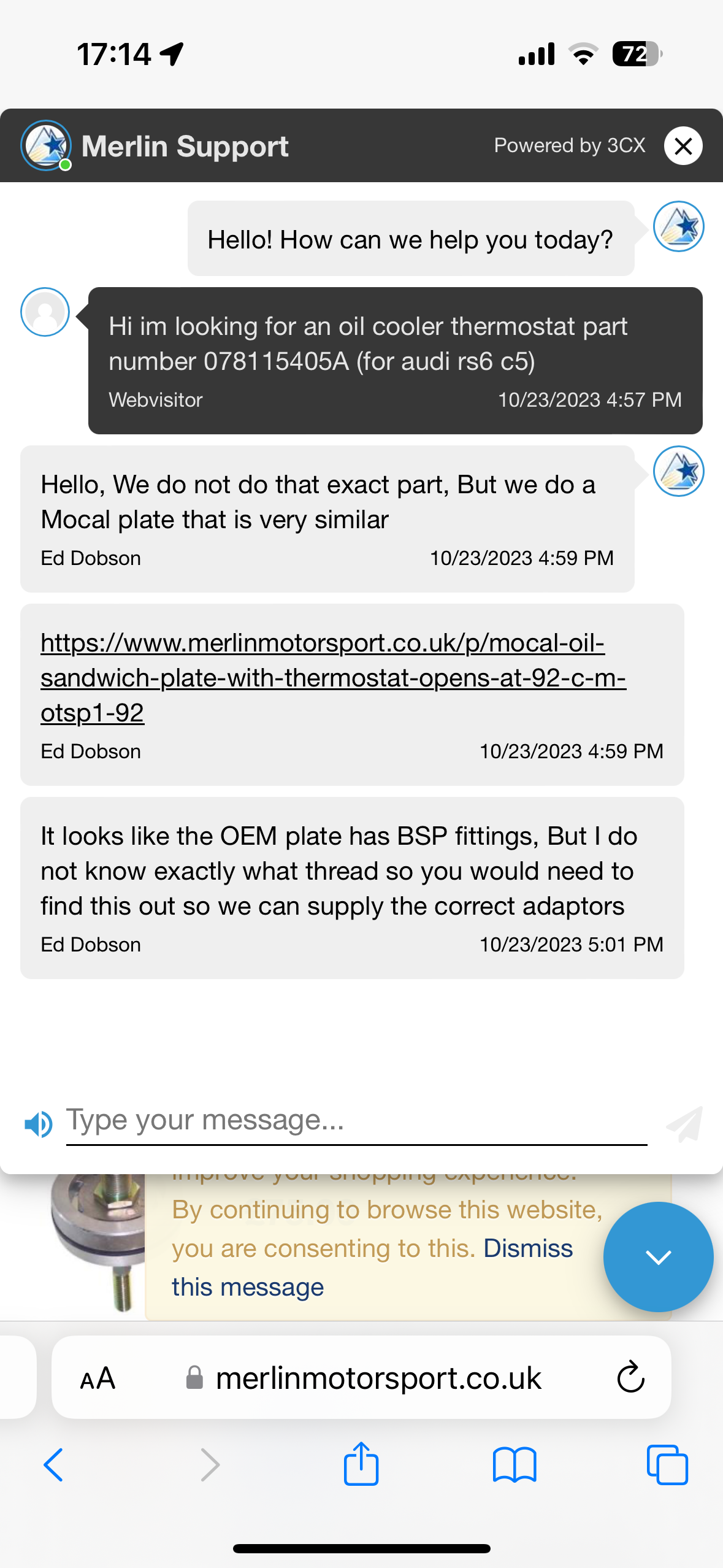

Re: Normal oil and coolant temperatures
Response from Merlin attached.
Anyone shed any light on the thread?
