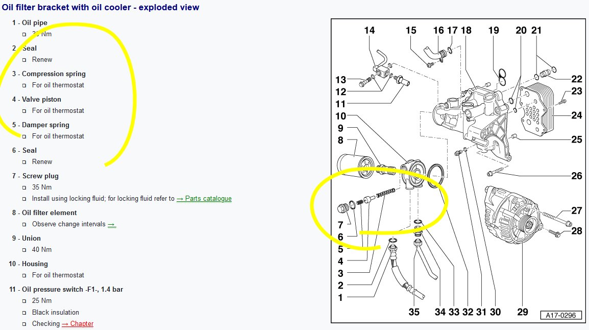

I would replace the oil thermostat. If it's not available separately, then get a whole new cooler. I bought one for my Golf once. Not very expensive:
Re: Normal oil and coolant temperatures
Agreed. And looks very accessible - it might fall into that small subsection of the workshop manual that does not start with "Remove Engine".

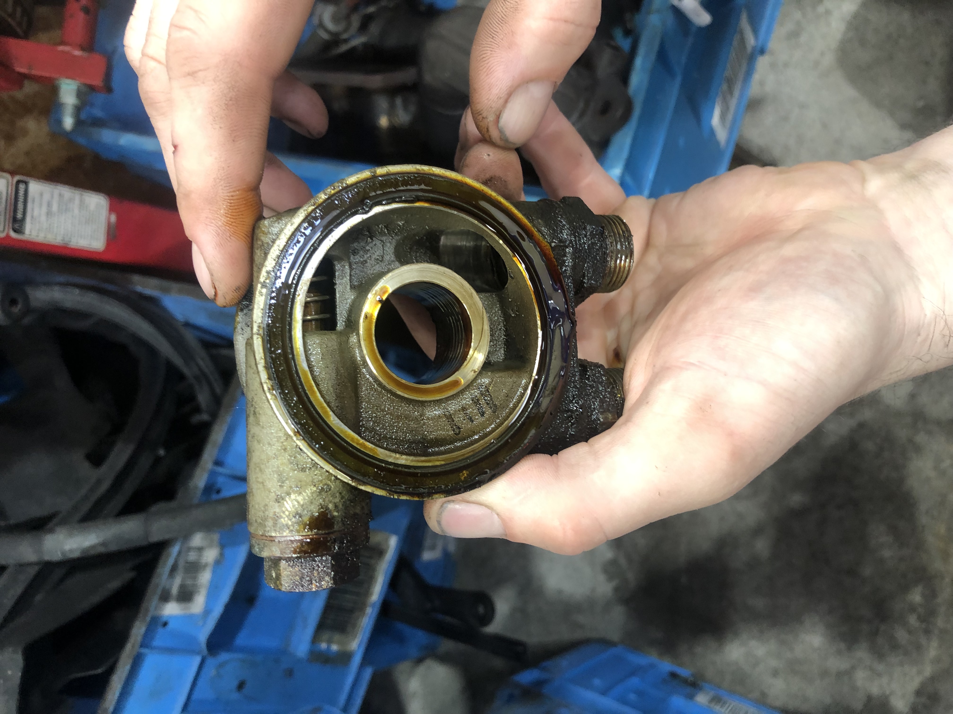

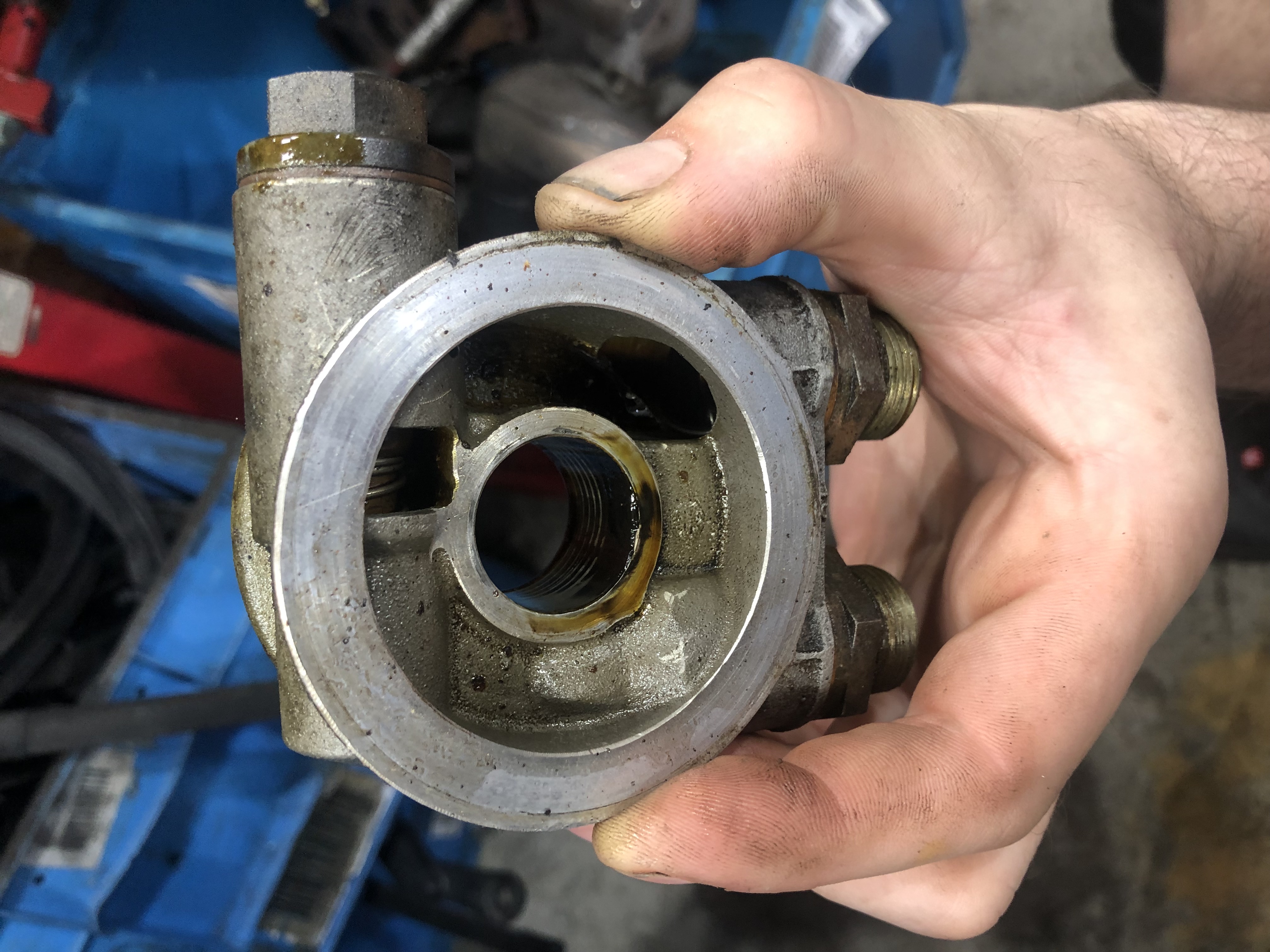

Had the seals replaced at unit 20 last time I was there.
The large seal had gone really hard over time. Took ages to persuade it out with a hammer and appropriate screwdriver. Eventually came out a small bit at a time. Thankfully lee had a spare seal.
