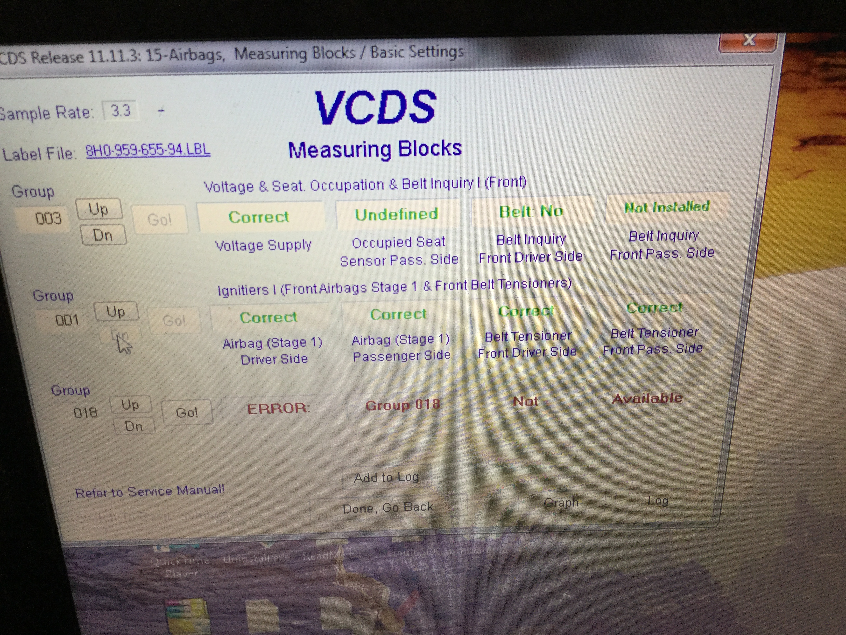

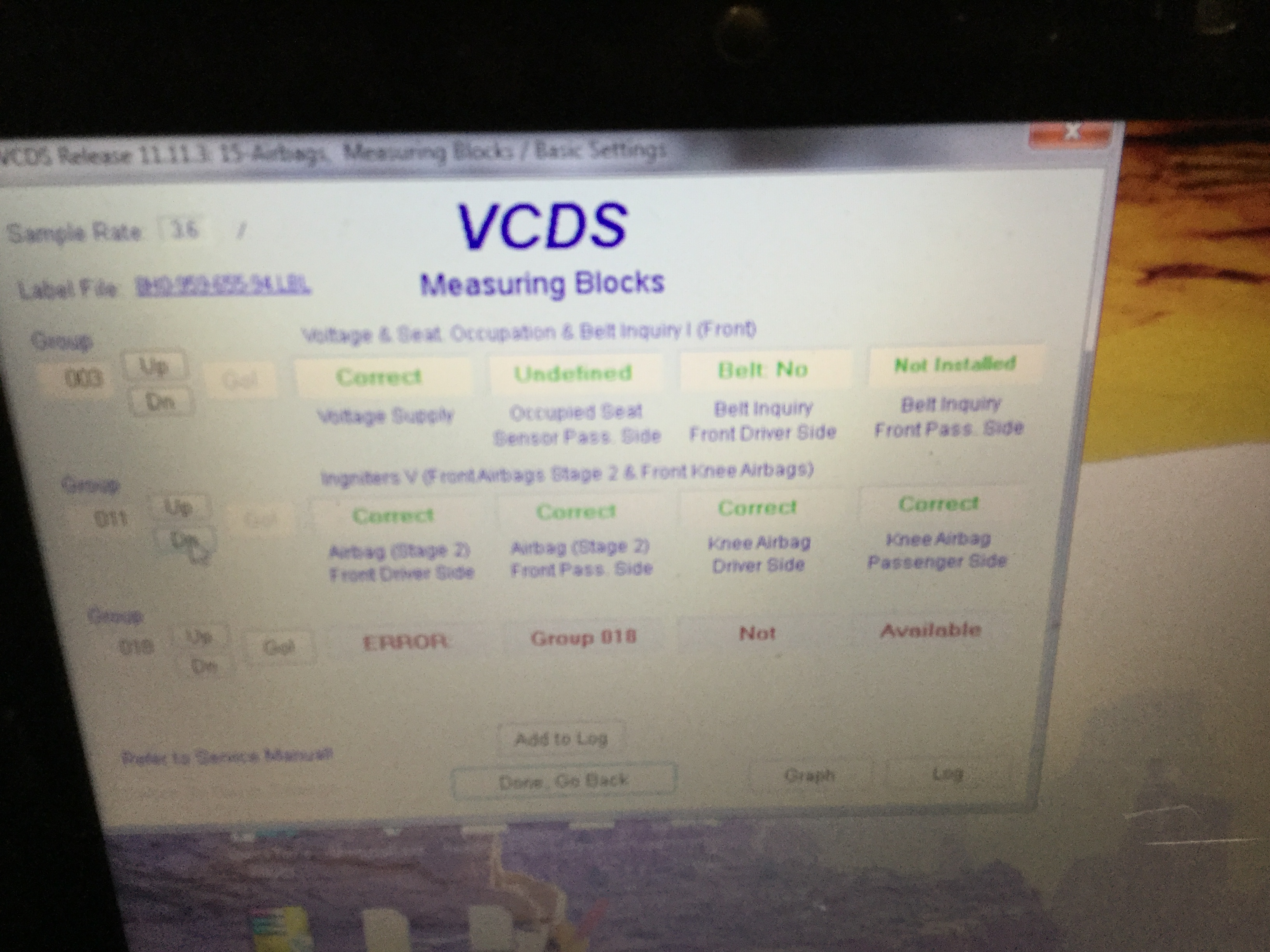

Can you go to measuring blocks and bring up blocks:
003
016
018
If you can.

Post by Shoppinit » Mon Mar 06, 2017 3:12 pm
It's weird that it says open circuit.
you definitely have to perform the occupancy sensor reset, but it's saying that it can't find it.
/I guess it wouldn't hurt to try at this stage.
