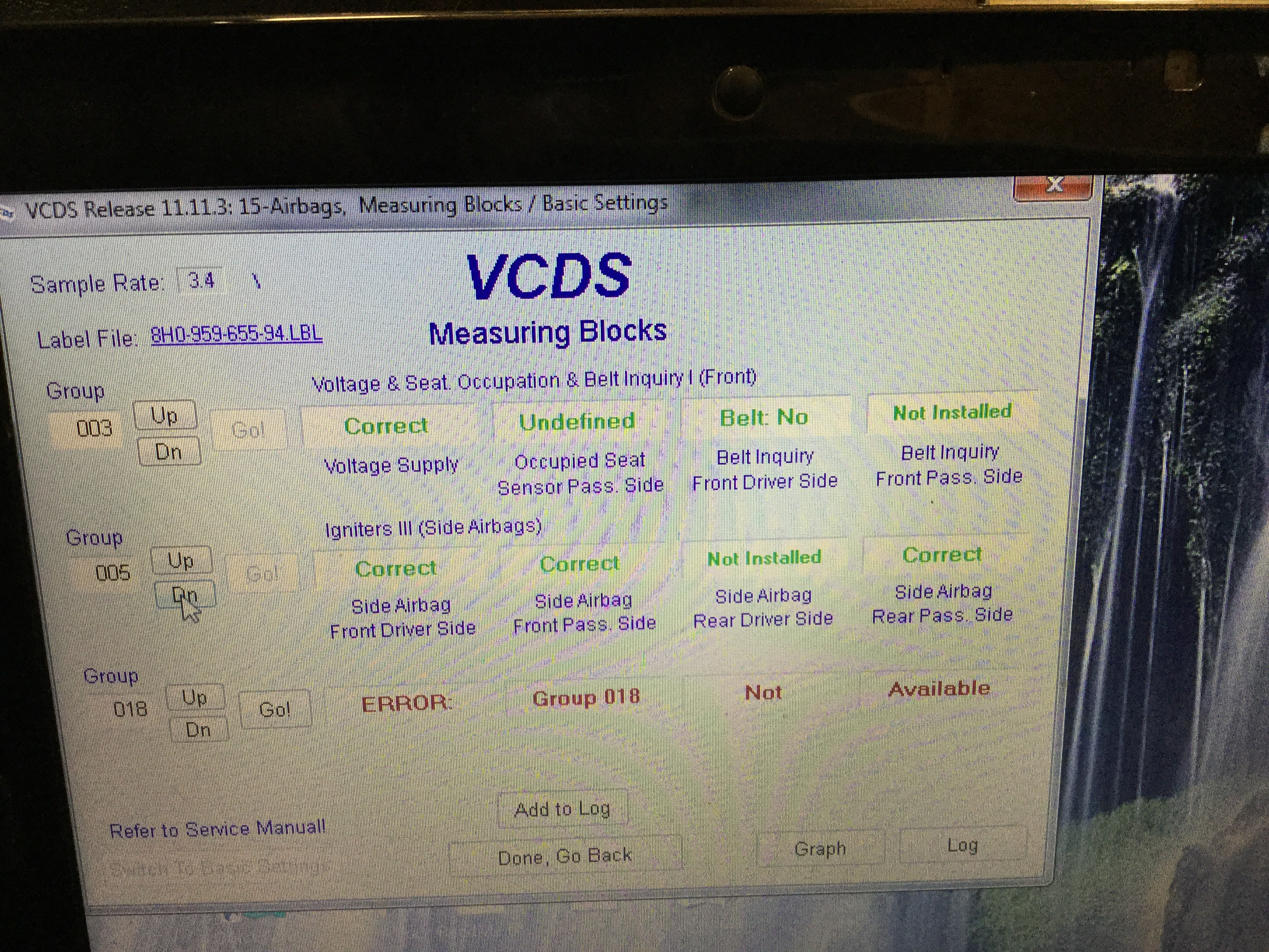

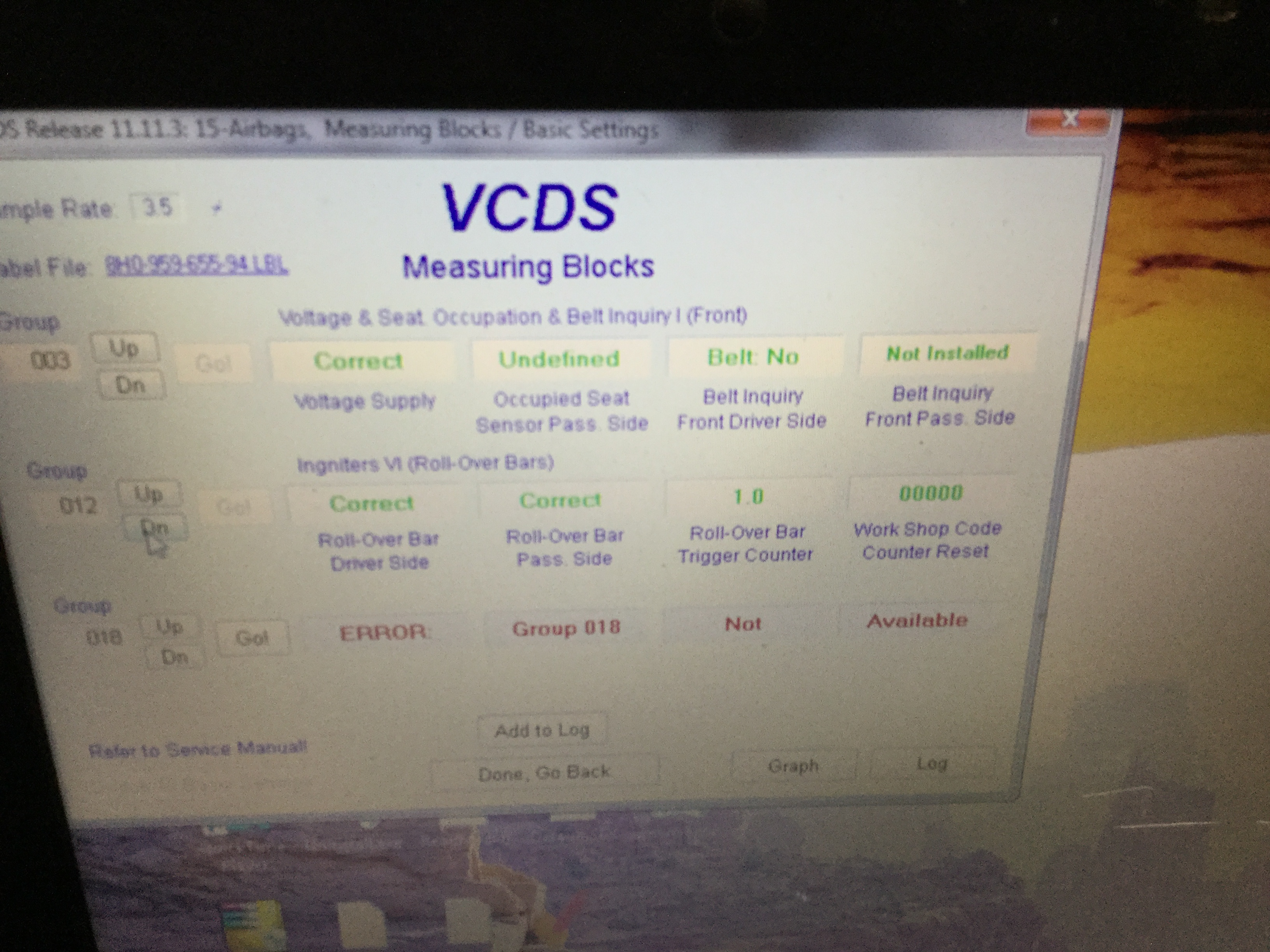

Can you go to measuring blocks and bring up blocks:
003
016
018
If you can.

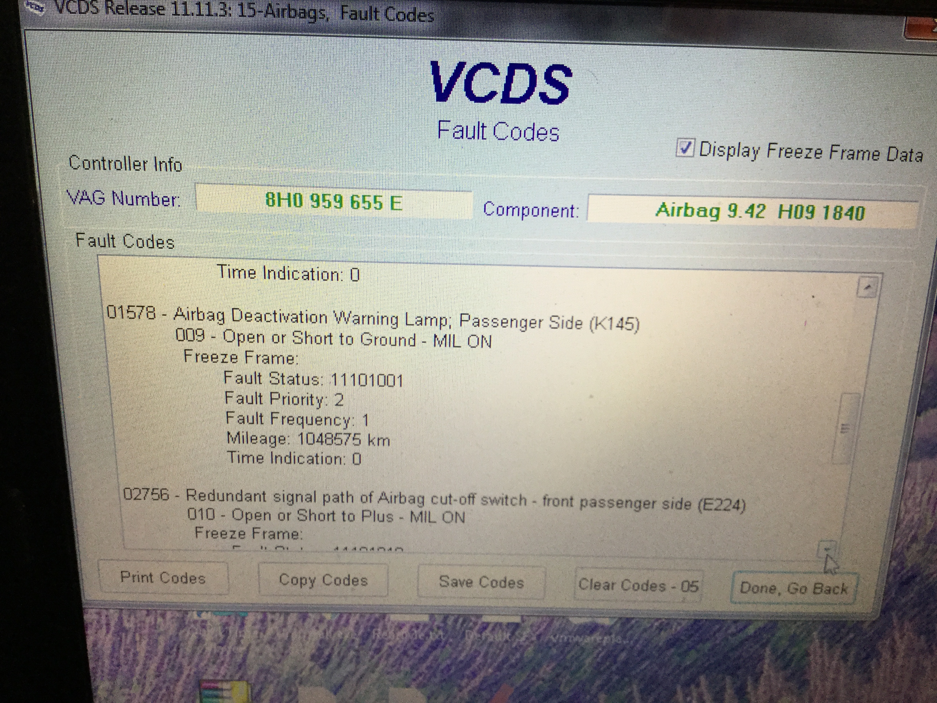

If you put your original coding in, does it give the same DTC as with the donor car's code?
Posts: 20345
Re: Coding for airbags on comfort seats
Post by Shoppinit » Mon Mar 06, 2017 2:56 pm
Remind me what the donor car's coding is please.

Post by Shoppinit » Mon Mar 06, 2017 3:12 pm
It's weird that it says open circuit.
you definitely have to perform the occupancy sensor reset, but it's saying that it can't find it.
/I guess it wouldn't hurt to try at this stage.

Post by pete62 » Mon Mar 06, 2017 3:31 pm
pete62
Posts: 524
Joined: Wed May 07, 2014 8:56 pm
Post by pete62 » Mon Mar 06, 2017 3:32 pm
0470114 I have entered 0473114 to get to just the one fault

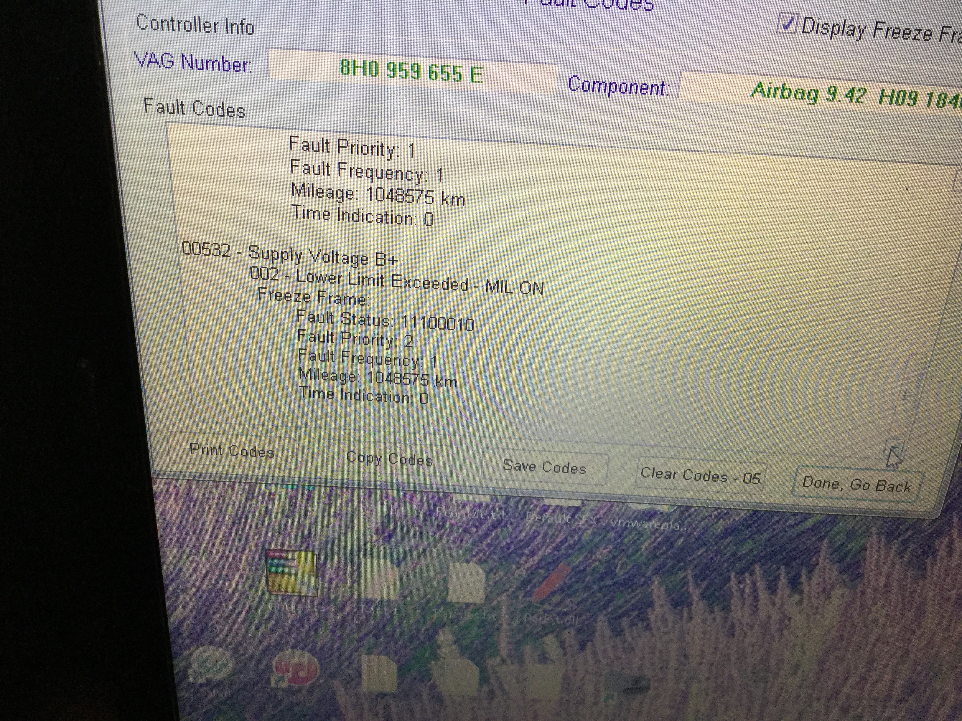

Post by pete62 » Mon Mar 06, 2017 3:38 pm
Reset hasn't made any difference

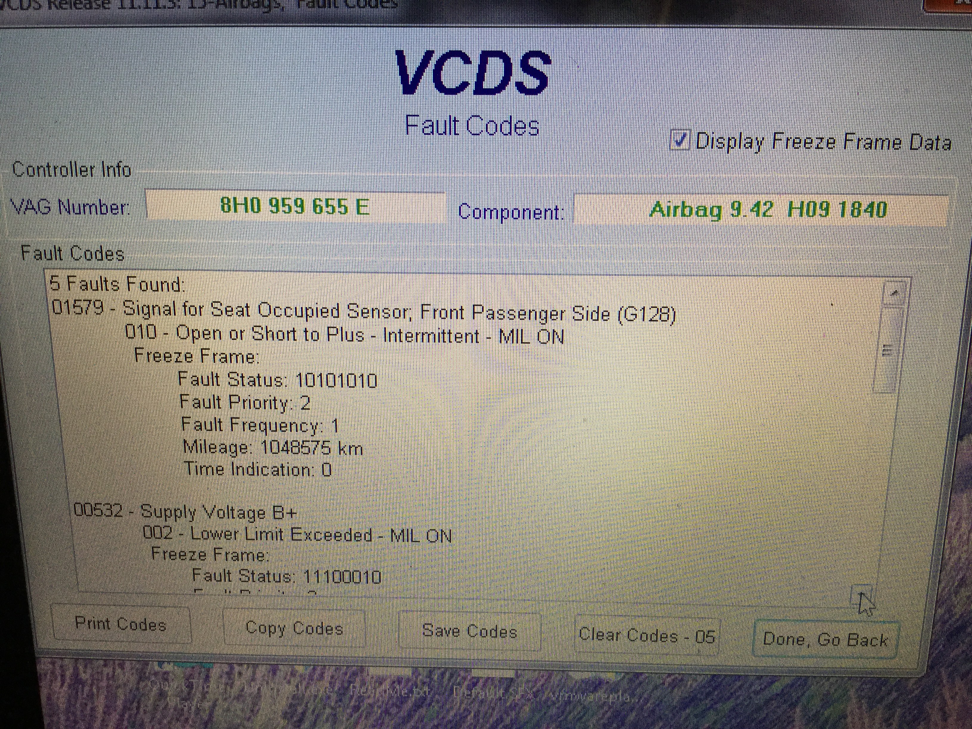

Post by pete62 » Mon Mar 06, 2017 3:42 pm
With047114
pete62
Posts: 524
Post by pete62 » Mon Mar 06, 2017 3:46 pm
With 0470114 (my cars original code)
