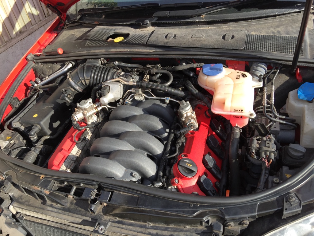

Just thermal cut out keeps going ! Every 5mins grrrrr , only done 4 ports !! 4 to go !!
Also blown oil cooler hose has gone ! I got warranty cover on it , maybe a claim on the oil cooler and hoses
ring them up today and see what what's !
Re: Carbon clean with DIY walnut shell blaster
Right I'm 6/8 done !
Is the normal bit of oil here !! In the manifold Is it the oil / cooling system breather separator faulty ???

Just back from hols. Yeah, the layer of oil in manifold is to be expected.
Now clean and rebuild her !!
Finally de coked done ! Spark plugs changed!
It should go out after a little while of driving.
Or you have a vak leak on her. Look under the front carbon fiber cover where they join up you have put the pipe back on?
All the pipes vacuum are on ! I re located the vacuum check value to under the small carbon cover ! I tackle that job soon
Oil hose off !! What a bag ball of a job that was !! Threads all gone on the oil cooler !!
So new cooler to buy now !!
first time I did it i left of one of the manifold flap position sensors. That lit up my EML. I'd lay money on a vac line or an unplugged flap sensor. I've had the manifold off 4 times in total and only had the light on the once.
