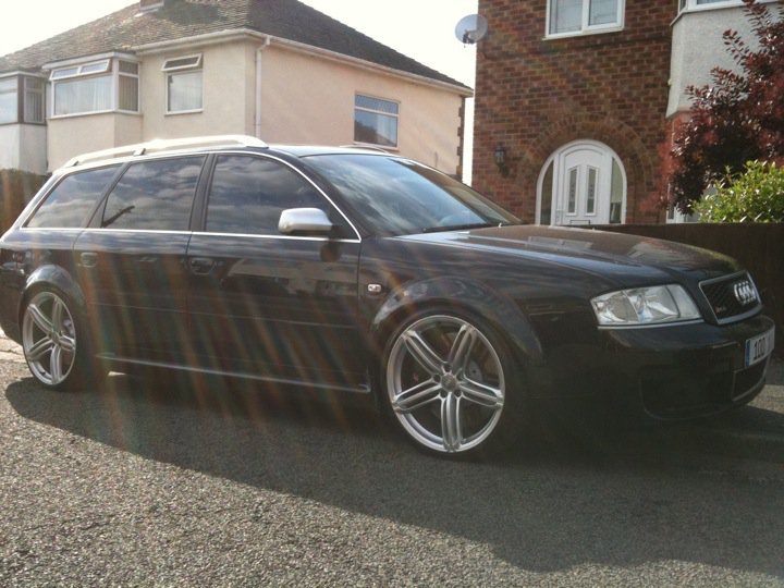

and mine...not put on this thread yet!
A small spacer on the front due to the 390mm discs .. No rear spacer ..

3mm shims so wheel still sits on the hub. Going to get the front brake caliper support trimmed so I can run without spacers soon.
