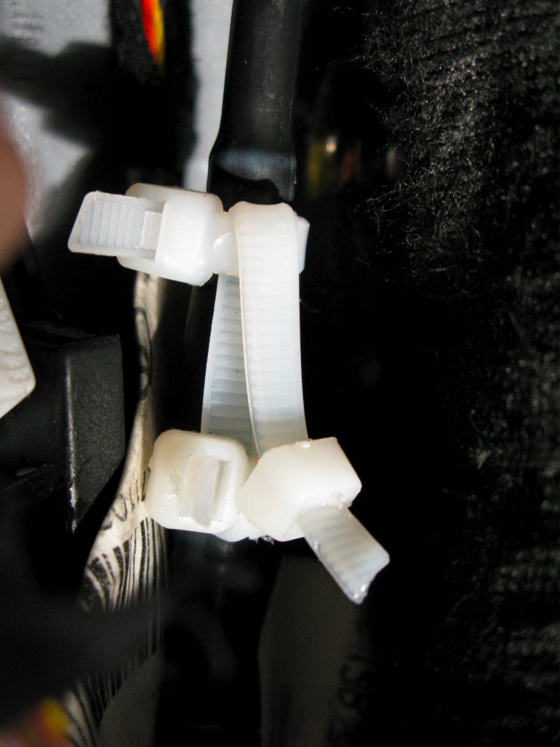

Okay A few pics for you and a short description.
Step one.
Remove the kick panel at the side of the passengers foot well, an easy job as it's just two philips self tappers holding it on.
Step two.
Once the panel is removed you'll see a mass of wires but pull them aside and in the corner you should find the black ribbed hose that feeds the rear wiper. The hose comes in sections and as you can see from the picture there is a join in the foot well. Obviously with the cold weather my rear washer has frozen up, by actuating the pump the pressure has built up and popped the two sections apart.
Step three.
I popped the two sections back together then to make sure they'd stay connected in future I used three zip-ties to pull the two sections together, a rough but 'hopefully' permanent fix.
Step four.
Keep the screen wash/ anti freeze concentration high in the washer bottle. Resist the temptation to use the rear wash wipe in sub zero temps.
Hope this helps
Gregor
Step one.
Step two.
Step three.
Step four.
Hope this helps
Gregor
