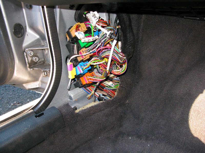

Okay A few pics for you and a short description.
Step one.
Remove the kick panel at the side of the passengers foot well, an easy job as it's just two philips self tappers holding it on.
Step two.
Once the panel is removed you'll see a mass of wires but pull them aside and in the corner you should find the black ribbed hose that feeds the rear wiper. The hose comes in sections and as you can see from the picture there is a join in the foot well. Obviously with the cold weather my rear washer has frozen up, by actuating the pump the pressure has built up and popped the two sections apart.

Remove the kick panel (two philips screws) to reveal a mass of wires.

Just had the kick panel off and couldn't find the mentioned pipe or any dampness. Where else could I look?
