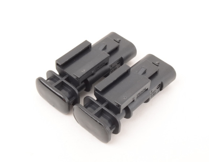

However, it does flag an alarm. It doesn't show on the dash or MMI but if you plug a laptop in it will show the error. But if you are happy with the sound then you can buy the Milltek valve delete modules that cancel the error.
Anyone knows the actual PN of the Milltek valve delete module ? I searched through their site but can't find it listed.
Some resellers in the US carry it but its odd not to find it on their website.
Milltek Part Code: SSXAU405
http://www.venommotorsport.com/product/exhausts/EX1729/

Thanks for the PN.
I made a test yesterday evening by disconnecting the flaps and protecting the terminals with duct tape.
I would not say that the result is outrageous, but at least, the clumsy transitions at low and mid revs are gone and there is a hint of V8 burble all the time. Definitely the way to go for me.

An additional question: does each part of the set include connection to the flap actuator body and to the cable, so that both terminals are neatly protected ?
It is hard to tell from the pictures where the shiny end is actually a cap.

Post by Bit_evl » Sat Jun 10, 2017 8:50 am
I watched the local kwik-botch fit mine and it appears to handle the cables but does not cover the connectors on the back boxes. Duct-tape is still your friend. I just gave them £20 and they did it on the ramp and cable tied the protected ends out of the way as well.
Re: Exhaust flap continually open findings
Post by MikeFish » Sat Jun 10, 2017 10:31 am
Yes the modules only protect the wire which is the hard bit to replace. Exhaust can be replaced easily if it did fill with dirt.

zeshark wrote:
Sat Jun 10, 2017 7:28 am
Genius! So simple! The Milltek equivalent of a condom
