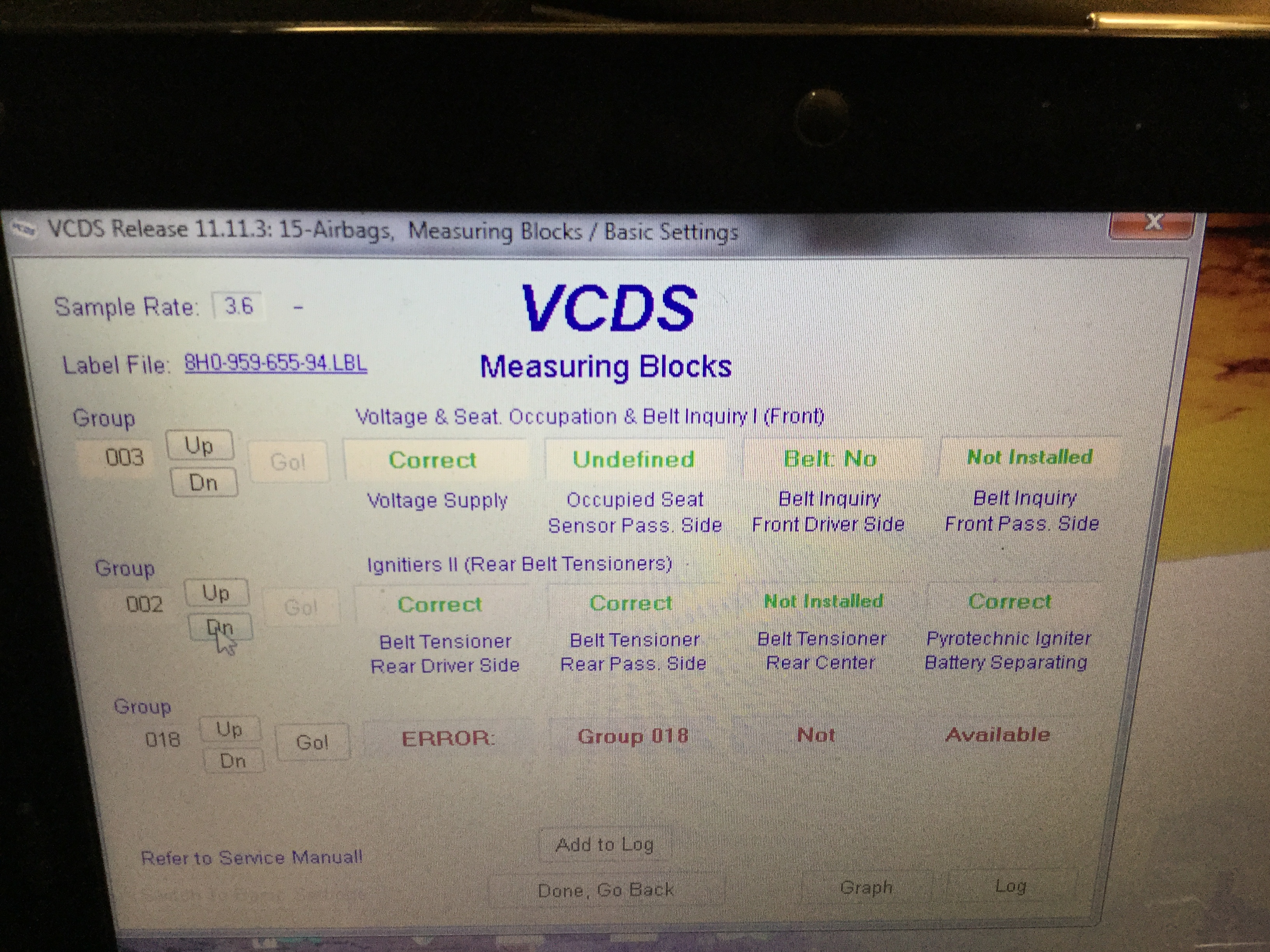

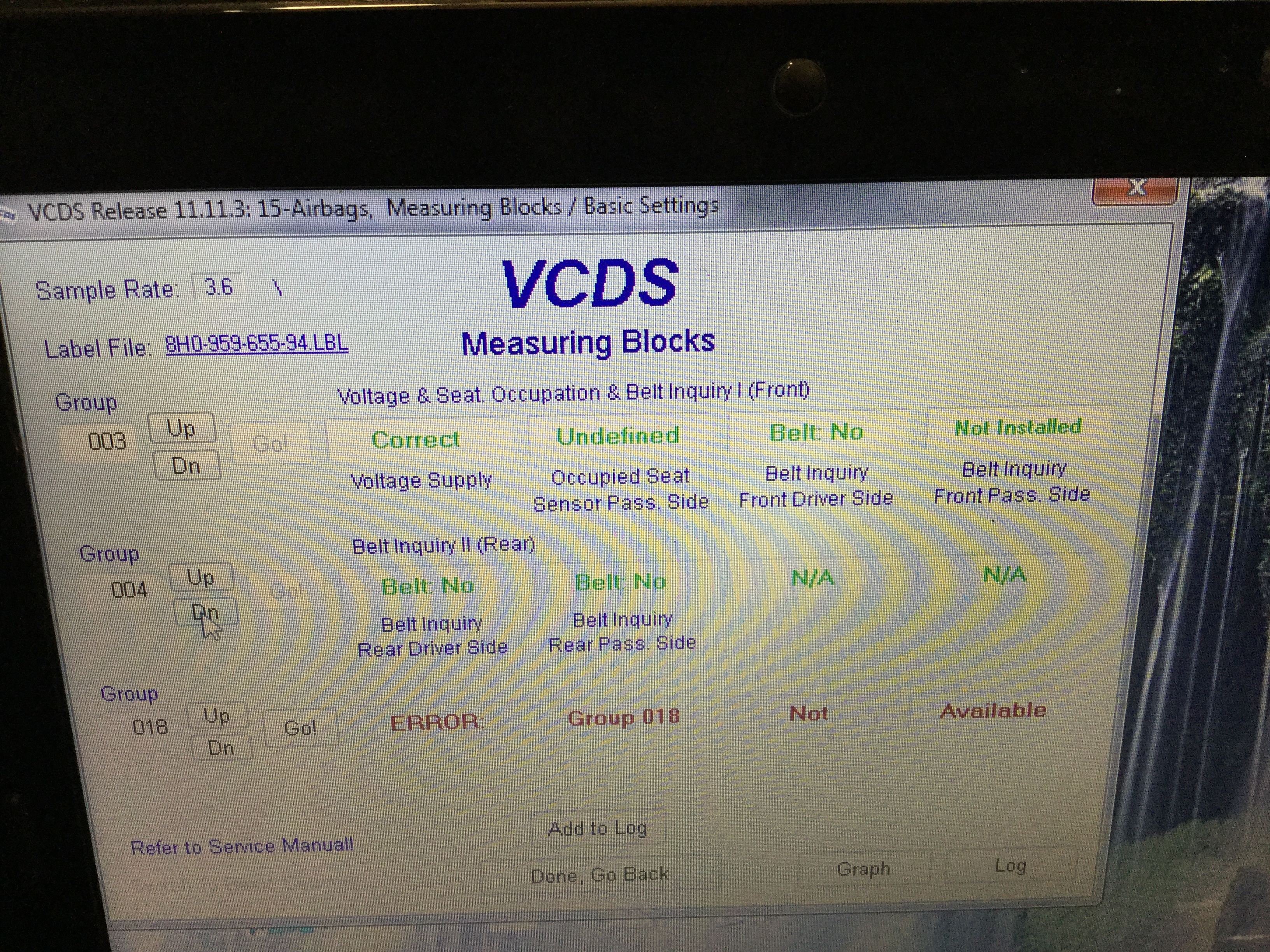

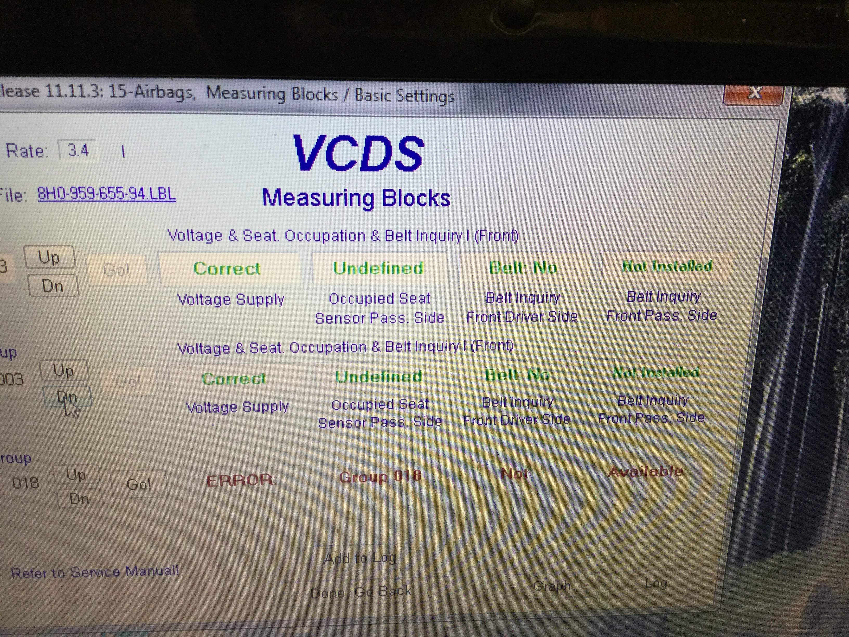

Post by Shoppinit » Mon Mar 06, 2017 2:49 pm
Can you go to measuring blocks and bring up blocks:
003
016
018
If you can.

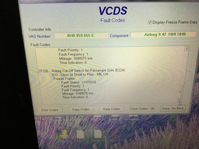

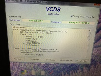

pete62
Posts: 524
Joined: Wed May 07, 2014 8:56 pm
Re: Coding for airbags on comfort seats
Post by pete62 » Mon Mar 06, 2017 2:58 pm
Posts: 20345
Post by Shoppinit » Mon Mar 06, 2017 3:12 pm
It's weird that it says open circuit.
you definitely have to perform the occupancy sensor reset, but it's saying that it can't find it.
/I guess it wouldn't hurt to try at this stage.

pete62
Posts: 524
Post by pete62 » Mon Mar 06, 2017 3:31 pm
pete62
Posts: 524
Post by pete62 » Mon Mar 06, 2017 3:32 pm
0470114 I have entered 0473114 to get to just the one fault

pete62
Posts: 524
Post by pete62 » Mon Mar 06, 2017 3:42 pm
With047114
pete62
Posts: 524
Post by pete62 » Mon Mar 06, 2017 3:46 pm
With 0470114 (my cars original code)
