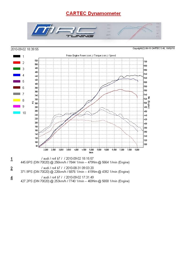

Well as most of you all know my B7 saloon was running a shocking 332bhp on a dyno dynamics a month back! Done a lot of research and decided to throw some money at her and take her to MRC to get sorted. What a difference :bigblink:
It was currently running at 350PS and 436Nm on their dyno machine.
It pulls like a bloody train now I cant believe the difference!
It had a Carbon Clean
Remap
Deflap inlet manifold
Remove precats
Undoubtably it did cost me a lot of money but in my eyes was worth it. Top fellas well done :audibash:
Currently now at 430PS and 474Nm
Image[/url]

wow nice torque just looking at my roller graph and I have around 100nm less than you despite having a decoke and a stage one.
Does pre cat removal and a stage two open up 100nm torques? I may invest if thats the case

Regy53 - I would say absolutely or very near that. The pre cats rob the 4 of any decent power. Stage 2 with the pre cats gone would give you easily or close to 100nm...
I was at 370nm with precats gone. Then Decoke, deflap and stage 2 took me to 483nm...
