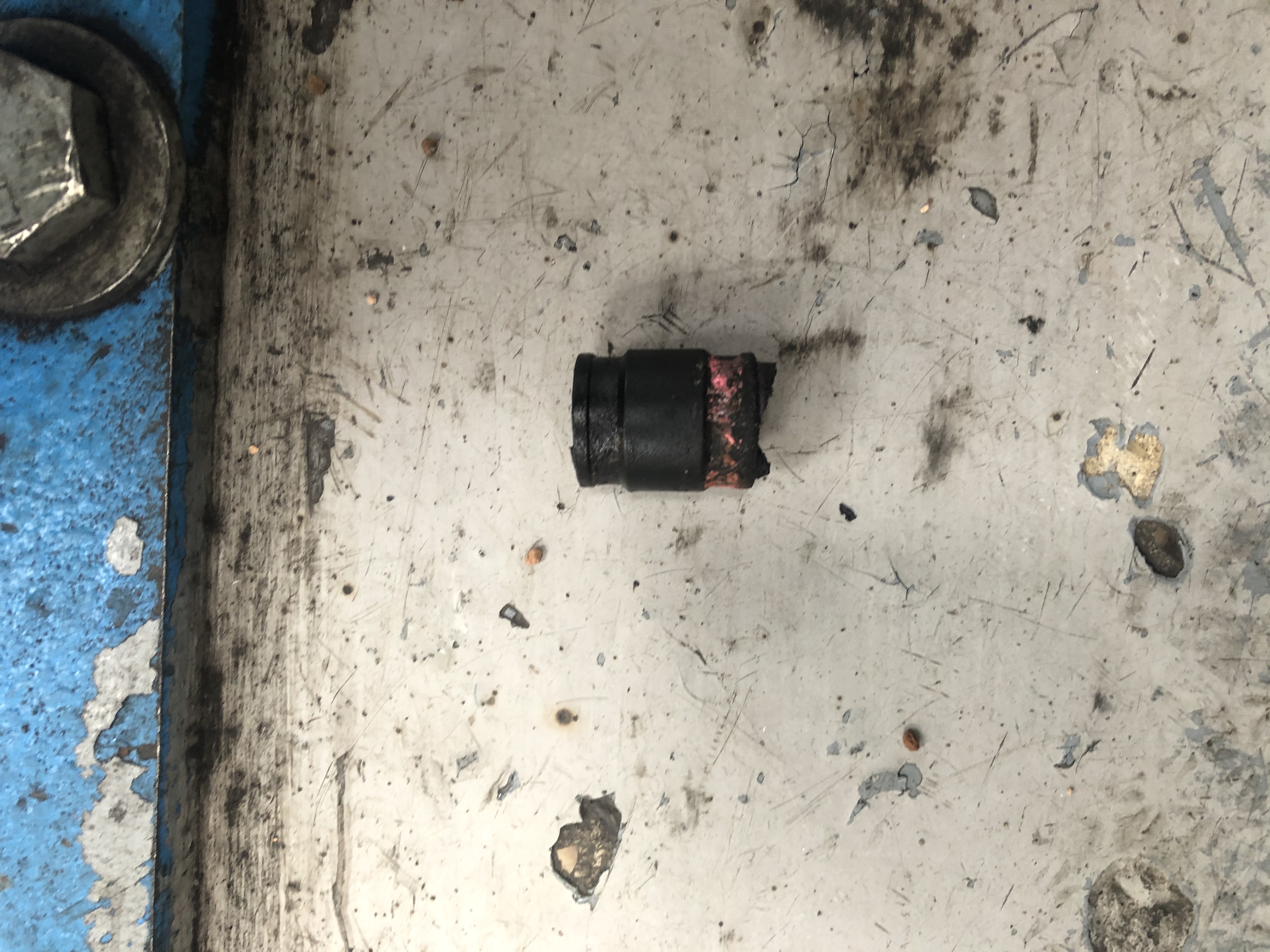

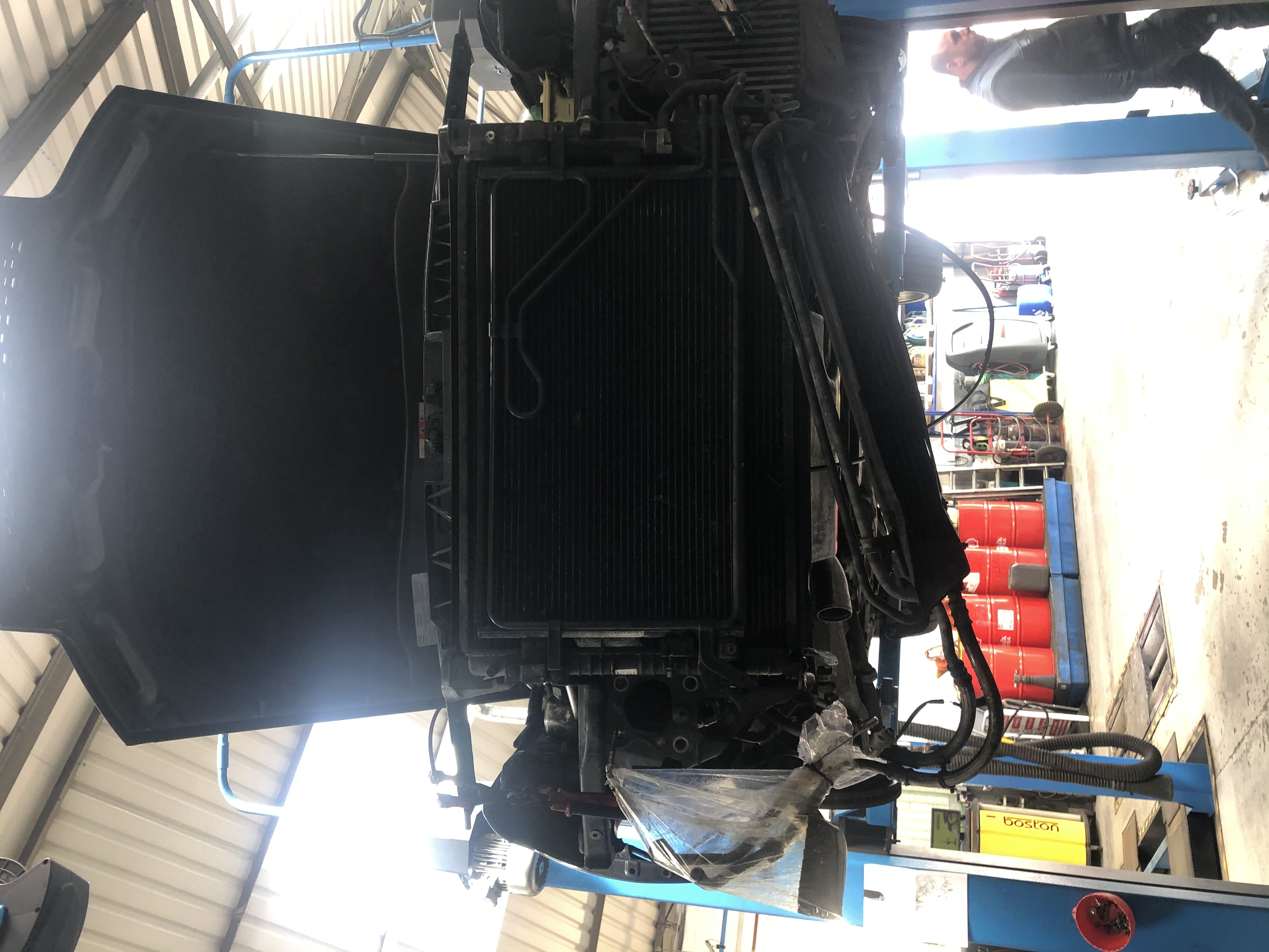

Just found a couple of pics when we were doing the job
