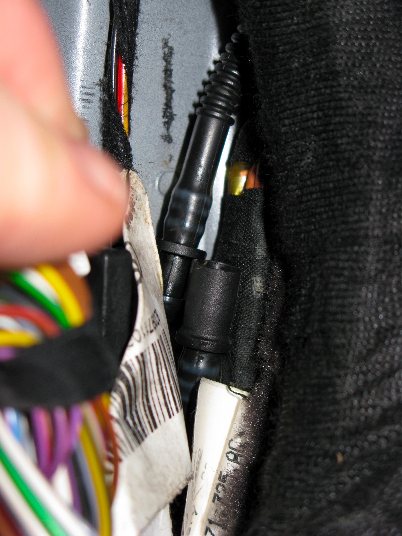

Okay A few pics for you and a short description.
Step one.
Remove the kick panel at the side of the passengers foot well, an easy job as it's just two philips self tappers holding it on.
Step two.
Once the panel is removed you'll see a mass of wires but pull them aside and in the corner you should find the black ribbed hose that feeds the rear wiper. The hose comes in sections and as you can see from the picture there is a join in the foot well. Obviously with the cold weather my rear washer has frozen up, by actuating the pump the pressure has built up and popped the two sections apart.
Step three.
I popped the two sections back together then to make sure they'd stay connected in future I used three zip-ties to pull the two sections together, a rough but 'hopefully' permanent fix.
Step four.
Keep the screen wash/ anti freeze concentration high in the washer bottle. Resist the temptation to use the rear wash wipe in sub zero temps.
Hope this helps
Gregor
Remove the kick panel (two philips screws) to reveal a mass of wires.
The separated sections, tucked away at the back
Pulling the two sections together with zip ties, hopefully will stop them popping apart again.

Bugger, photos have gone up in reverse, I'm sure you get the idea though.

Just had the kick panel off and couldn't find the mentioned pipe or any dampness. Where else could I look?

I've read that there's another join in the engine compartment, press your rear wiper and see if any water drops out under the engine.

I did check under the engine after using the wipers but doesn't seem to be leaking there either

I found this thread and had noticed my rear wash wipe stopped a week or 2 ago. Sure enough, water is leaking but it's dripping from the rear wheel arch. Seems to be running around the inside of the wheel arch and dripping where the arch meets the bumper.
I've had the wheel off but can't get access to the pipes and no joy on the interior so far either.
