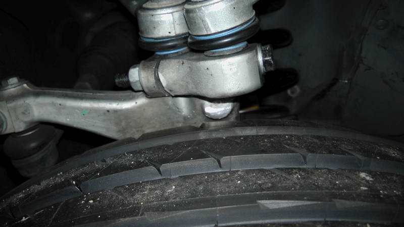

From memory I felt that the knob was too close to the tyre and at speed there is always some growth so I knocked a bit off the top. This is the space on mine with a bit missing, standard size tyres and OE rims.Human Joist wrote: ↑Tue Oct 27, 2020 11:13 pmThe super sports don’t run so I’m hoping they will be ok. Anyone else answer this

Cheers. I’ve a high power industrial style dremel so may as well nip a bit off. But will follow the advice and only a bit and leave it smooth after

My Dremel is 1980, so I was wondering what you were talking about when you said you would use one. Mine is for tiny work, intricate molds at one end and watch mechanisms at the other. The internet has since educated me to the availability of larger versions.Human Joist wrote: ↑Wed Oct 28, 2020 12:12 amCheers. I’ve a high power industrial style dremel so may as well nip a bit off. But will follow the advice and only a bit and leave it smooth after
The picture was just a trial fit, the finished product was a bit more professional.

10mm Spacers just make the car look "right" - the wheels fill the arches nicely then. And you don't need to worry about el nobbo either.

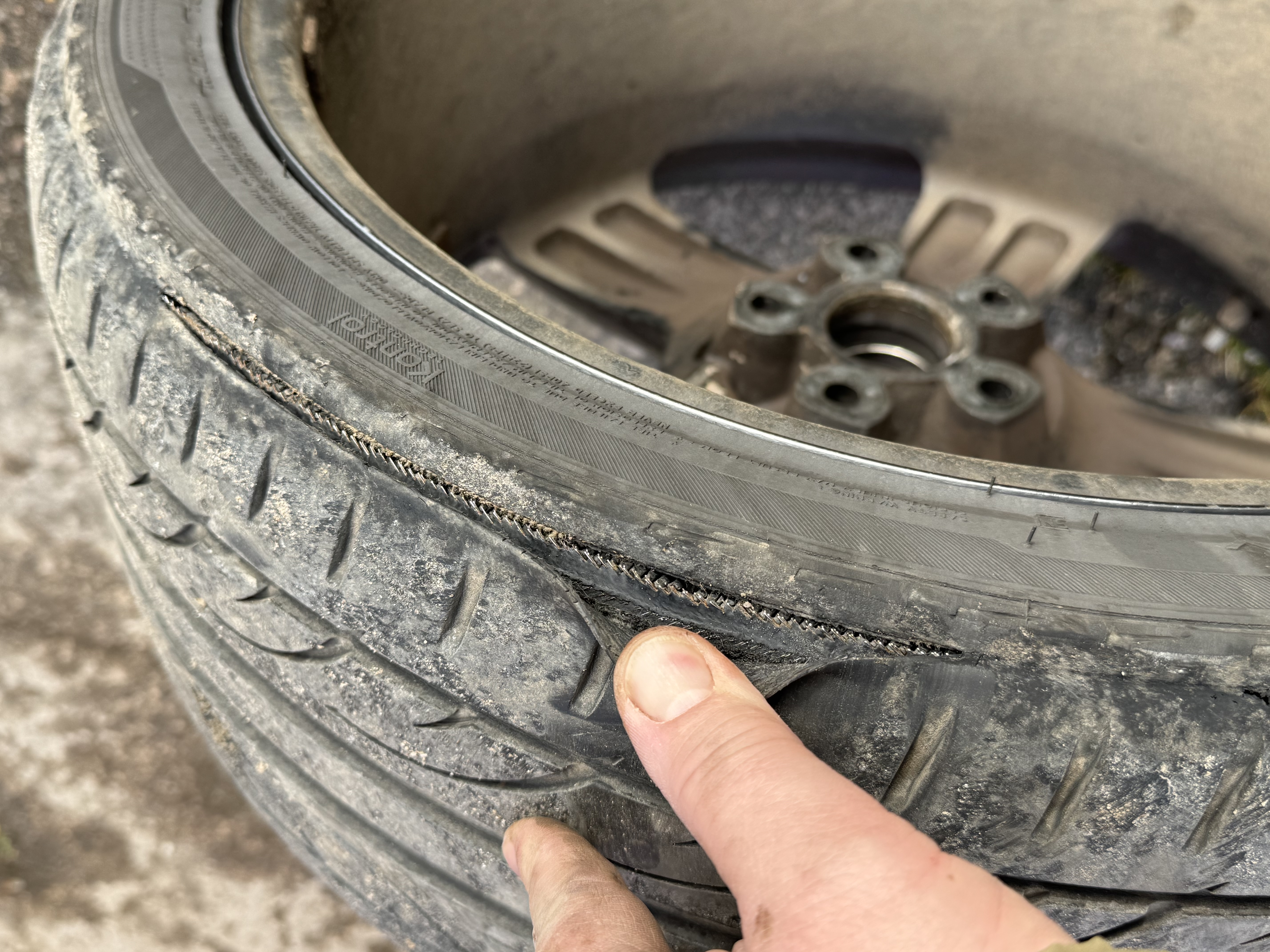

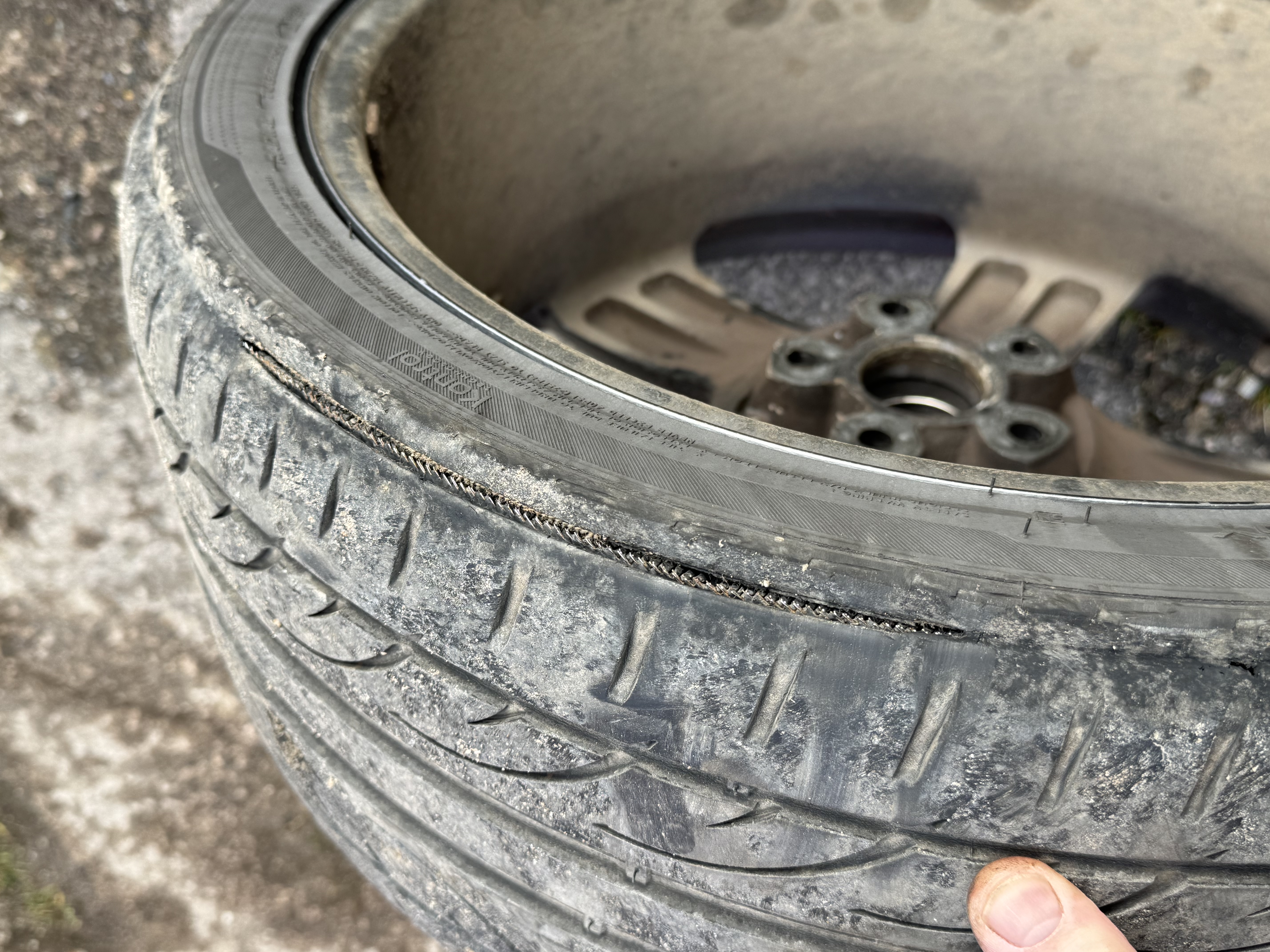

Found my tyre like this when I removed it this morning, luckily I took them off to take them to get refurbed or I wouldn’t have known about it until it was too late

FFS. Knobbly strikes again.
Re: RS6 Tyre Fitment (please contribute)
Is it worth adding a small spacer when they all go back on to make sure this can't happen again?
