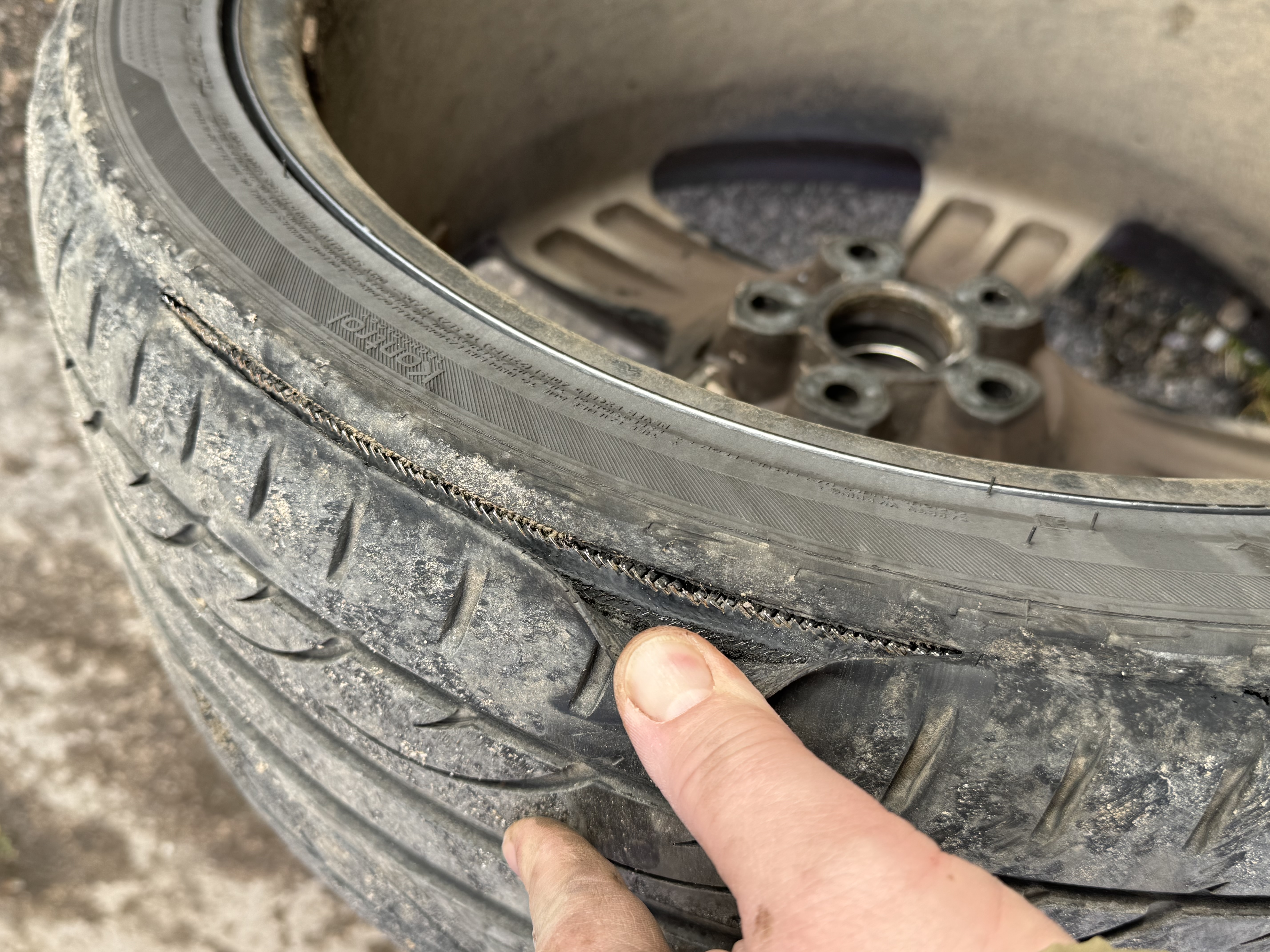

Post by Varks » Sat Feb 15, 2025 7:03 pm
Found my tyre like this when I removed it this morning, luckily I took them off to take them to get refurbed or I wouldn’t have known about it until it was too late

Post by Shoppinit » Sat Feb 15, 2025 7:07 pm
FFS. Knobbly strikes again.

Post by srichards » Sun Feb 16, 2025 8:55 am
Is it worth adding a small spacer when they all go back on to make sure this can't happen again?
