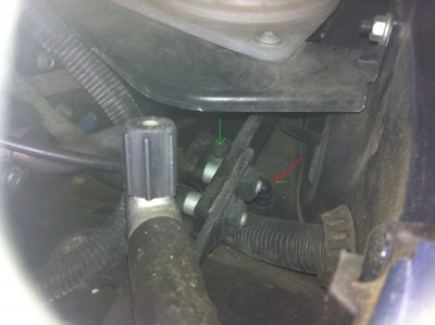

Not really. Check under the expansion tank to start with. There are 4 bolts total, but my mate's was clunking from there.
Re: Clunking noise ...
But im sure its coming from the right, dont know from where the clunk is coming from a loose steeringrack?
Expansiontank? Sorry dont know where its located...
Where you put the coolant in.
Cant seem to find 4 bolts...or am i looking in the wrong area?

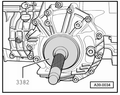

..any tips to get the new seal in properly? using the flange axle as a guide maybe...?
This is the Elsa-way:
- Attachments
- ac.jpg (55.28 KiB) Viewed 937 times

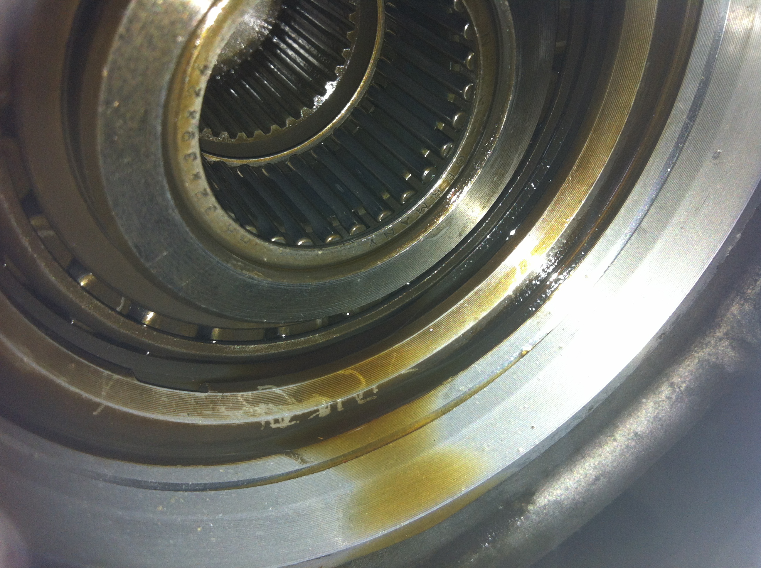

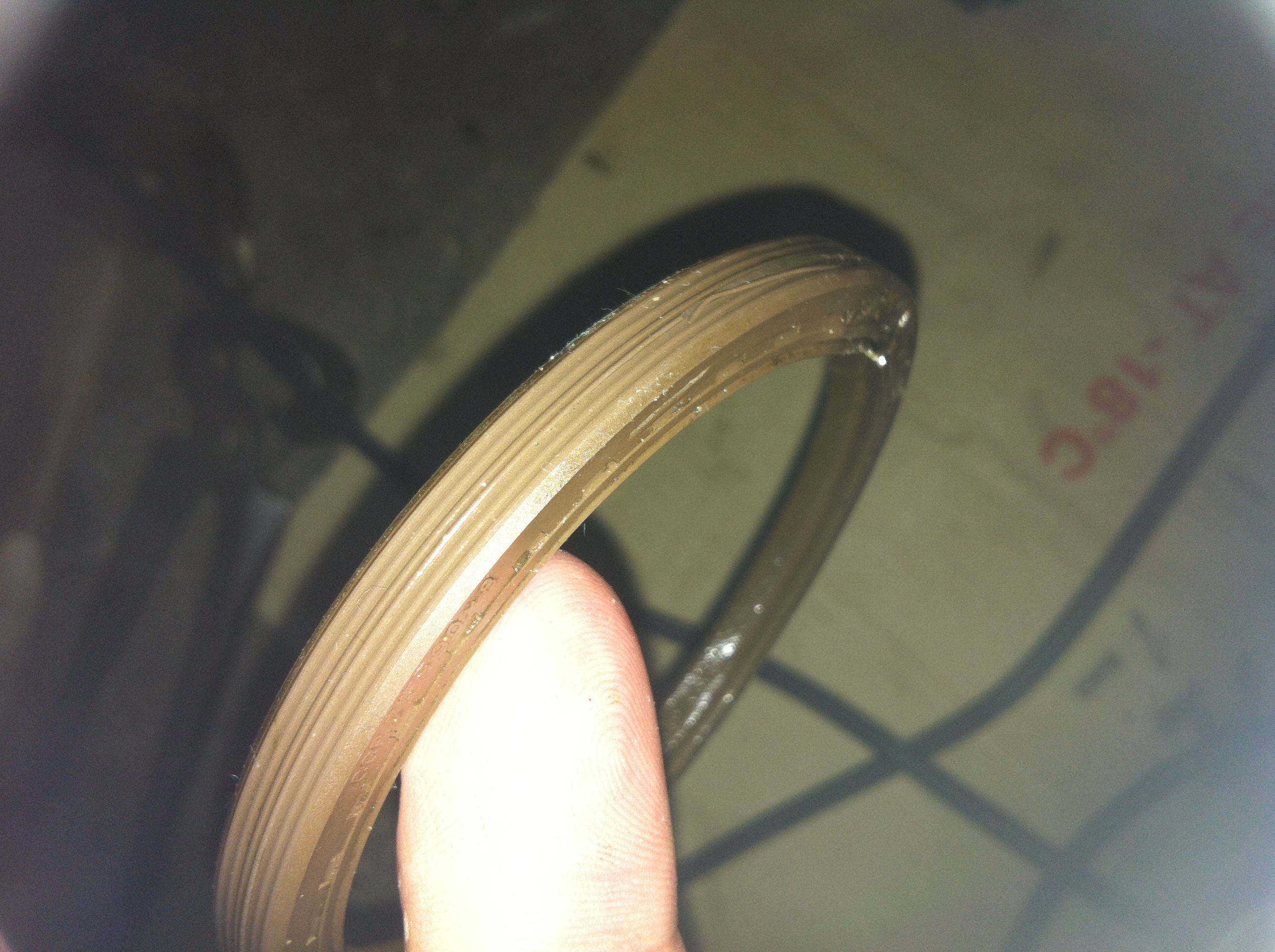

I normally try and find a socket that's got the right diameter. You won't be able to use the flange, you'll need something that is exactly the same diameter as the oil seal.
...need to find some kind of buttplug then.
Hopefully i get the new one in the right way, depth wise. (the one in the pic is the old one...)
By the way, the diff oil, thats terrible smelling stuff...

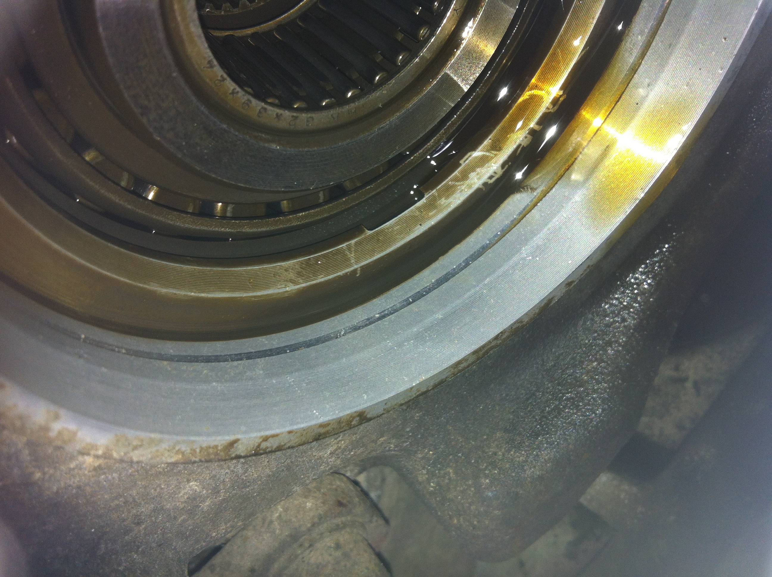

An Audi mechanic adviced me to place the seal at a different depth to avoid it touches the flange at the same spot as the old one, but i doubt it will make a difference. Let alone the seal wont hit the part on which it should be pressed against...

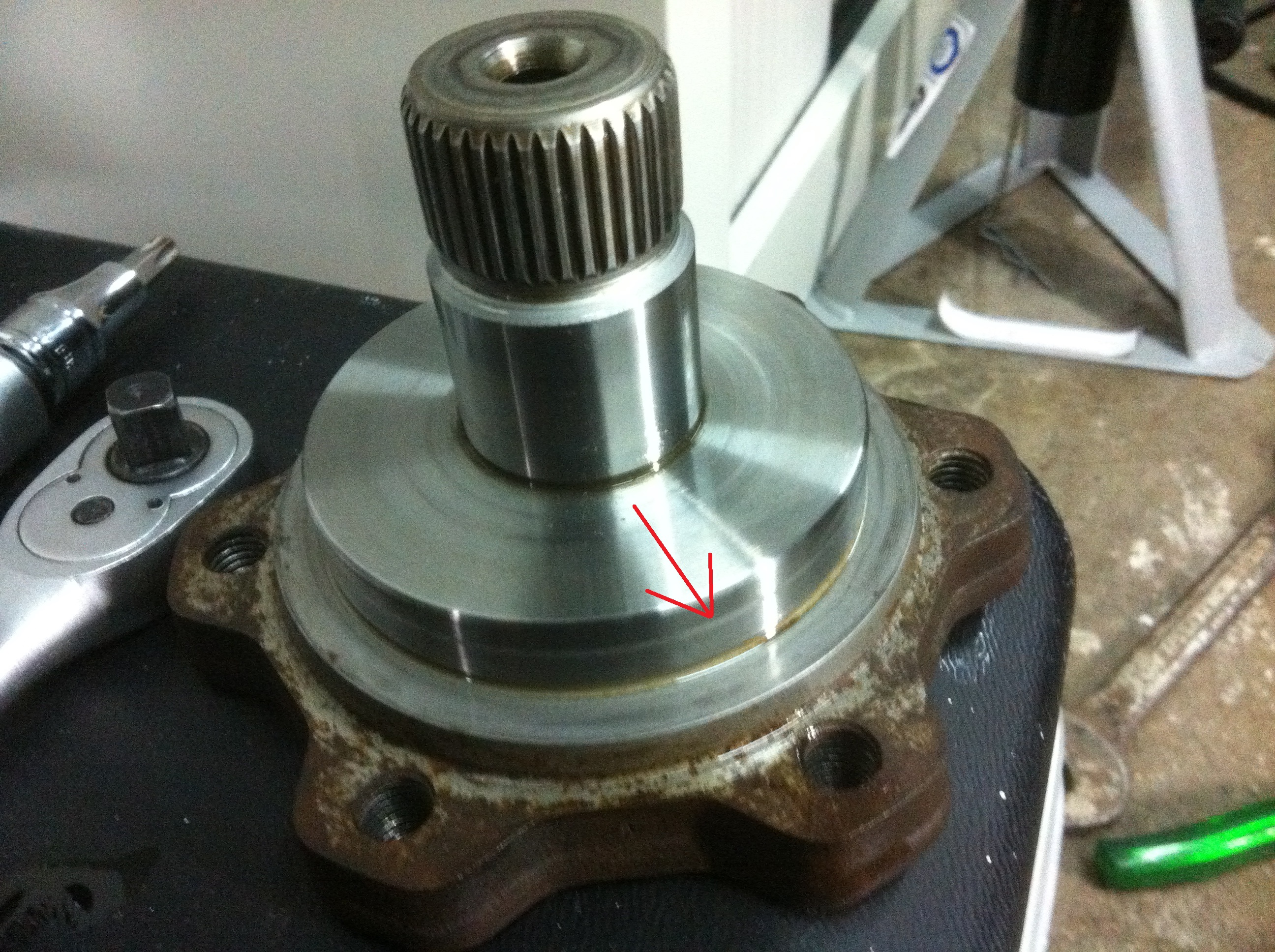

Is that a groove in the face?
...i cant feel there is, probably got polished after friction with the seal part. like on the bearingside on the flange, you can see where it touched the bearings side, but cant feel it (green Arrow)...
