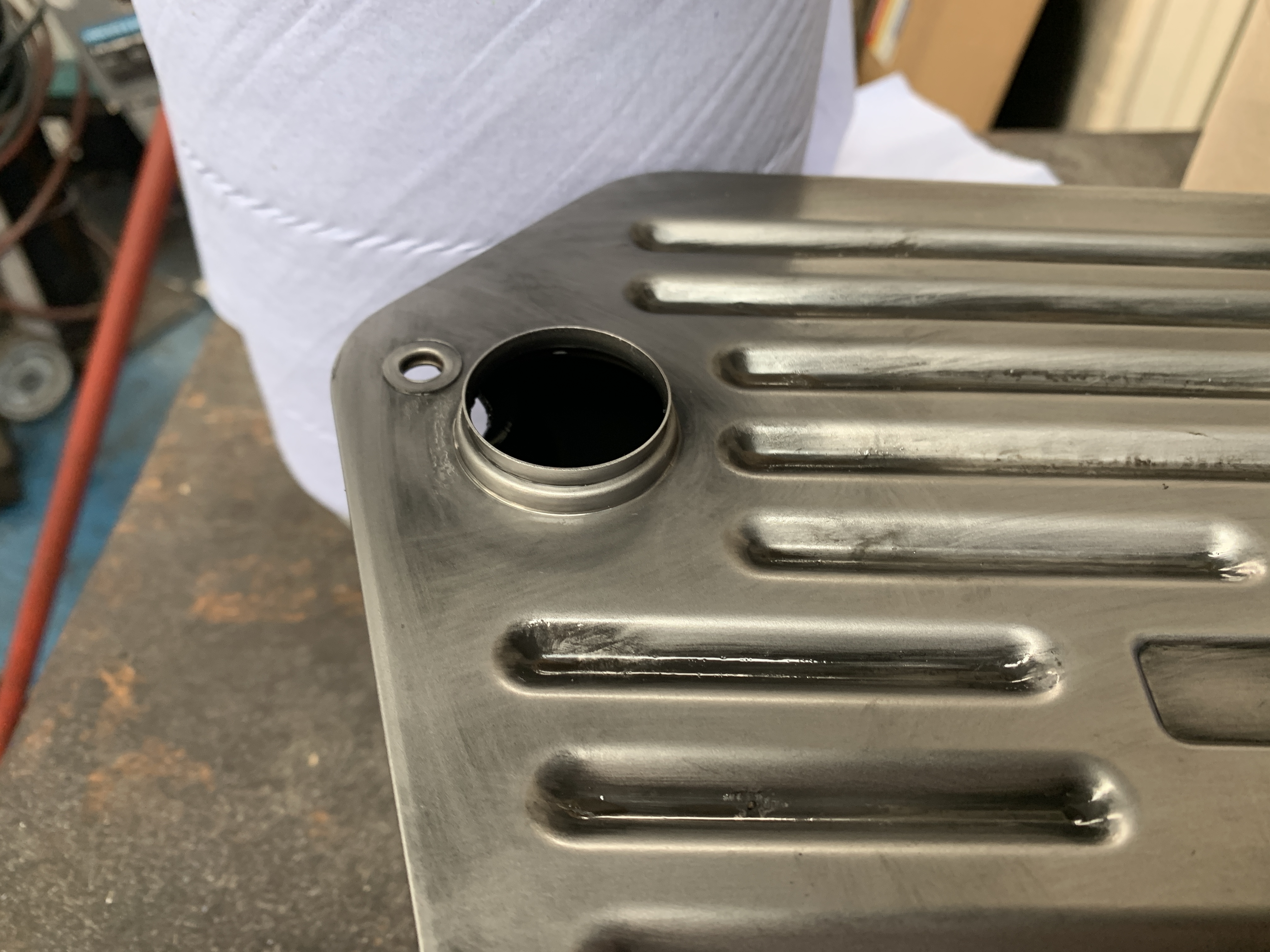

Changed gearbox oil and filter and now gearbox appears to work fine no noises or slipping. I dont know what garage Footers used to change it last time but they cocked up. No O ring on the filter and not enough oil. I drained 4.5 litres but it took just under 7 litres to refill.
