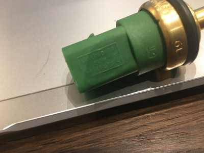

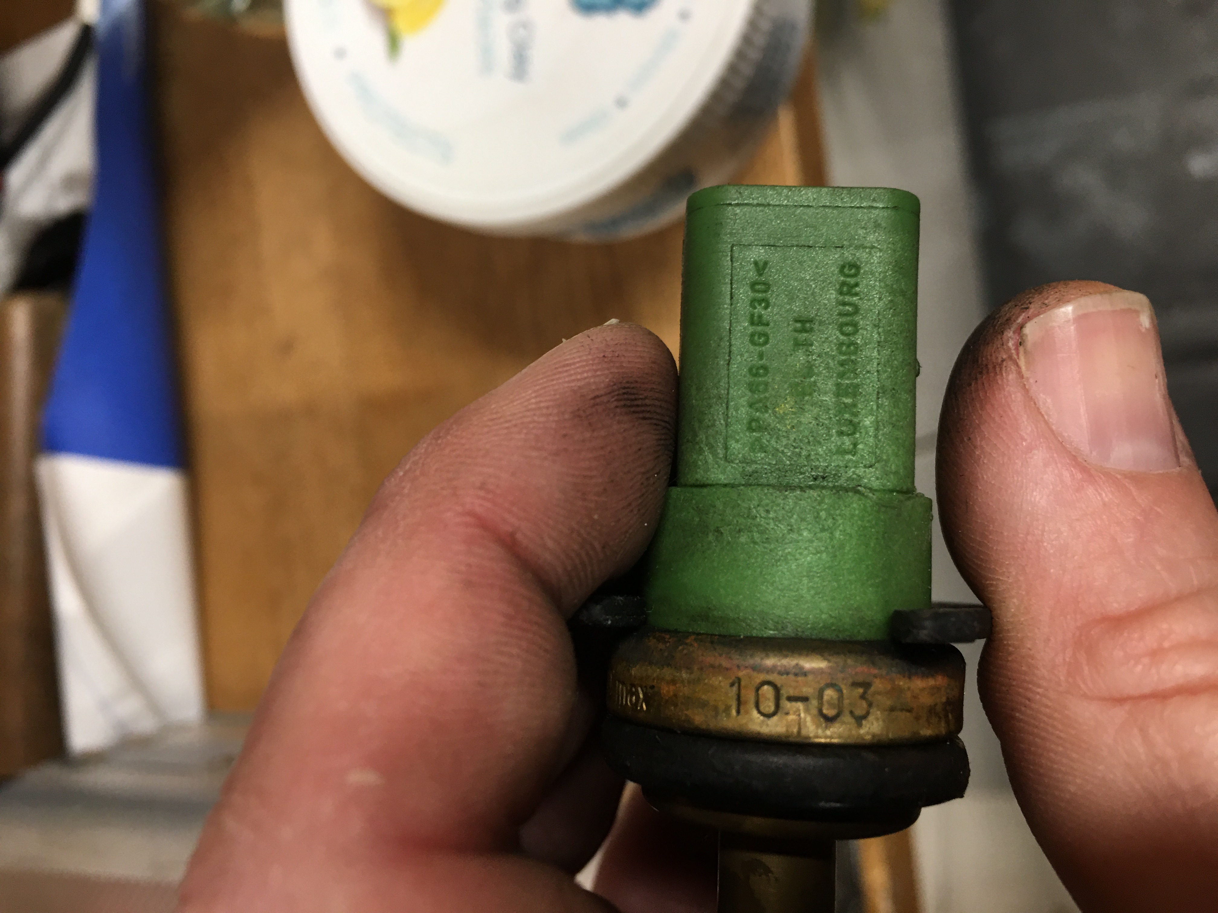

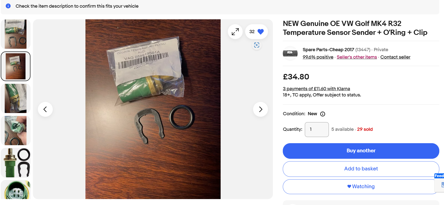

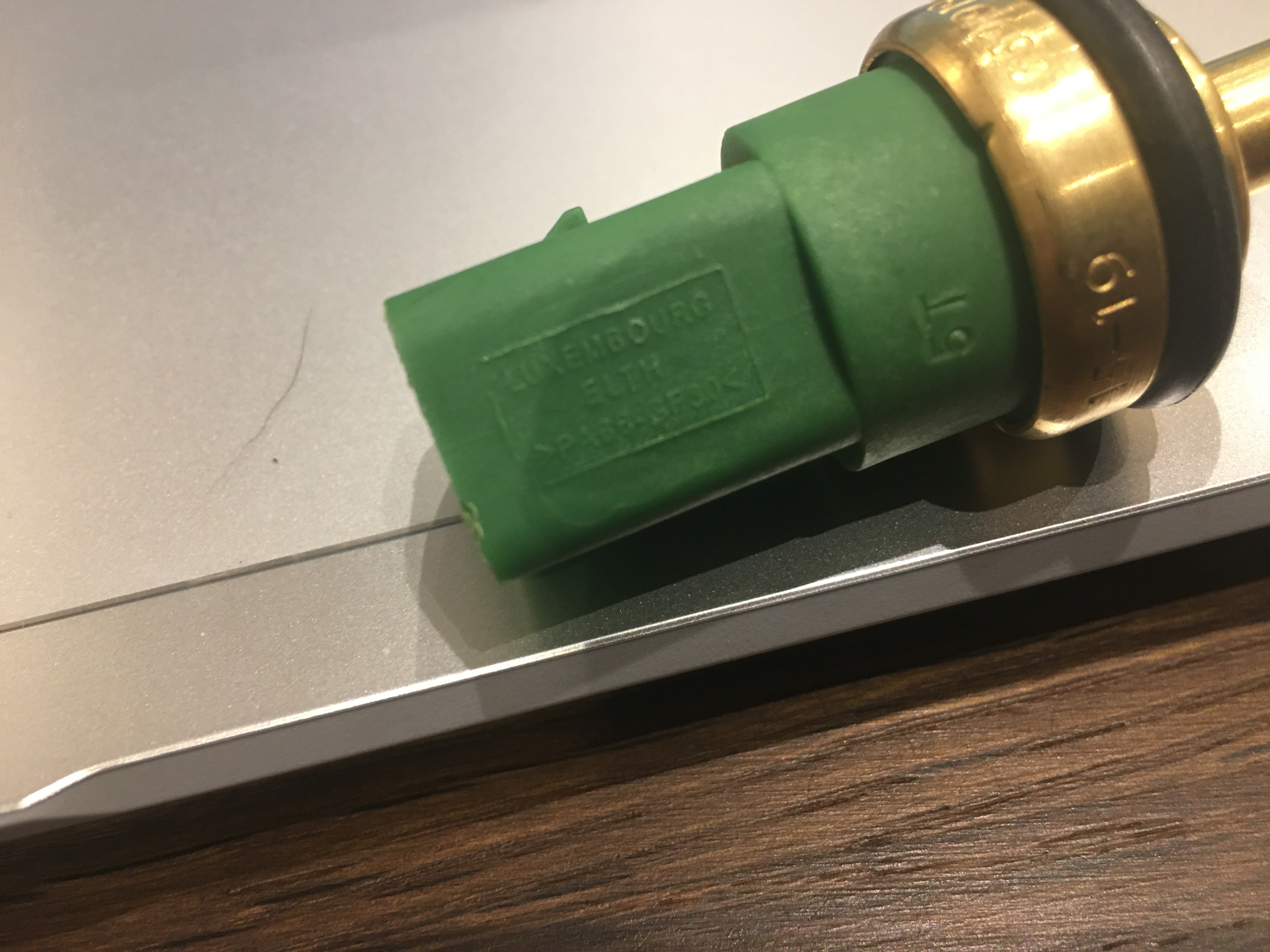

Morning. I bought the sensor through E-Bay as a Genuine OEM. It was listed for a golf R32 but the same part number as ours. It looked legit as it had the audi rings engraved on the brass collar and the part number the same as the one removed, No picture showing the rings and part No. Was in a VW bag listed as Skoda i think. Will dig out an image bag in the garage.
Replacement Sensor
One removed
Hopefully not been sold a dummy!!
Replacement Sensor
One removed

Hmm.
Doesn't mean it's not a legit sensor, but I wouldn't trust a seller that claimed to be private to avoid responsibilities.
I think I would have got this:
https://www.autodoc.co.uk/beru/7515442
Or from a VAG dealer directly. They're not particularly expensive parts.
With 75000 sales?About this seller
Spare Parts-Cheap 2017
99.6% positive Feedback•75K items sold
Joined Oct 2017
Usually responds within 24 hours
Registered as a private seller
Thereby, consumer rights stemming from EU consumer protection law do not apply. eBay buyer protection still applies to most purchases.
Re: Petrol / Help / VCDS
Febi one with the sealing rings
https://www.autodoc.co.uk/febi-bilstein/1888486
It lists the RS6 4.2 engine as a suitable application.
Yeah, Febi is OK. Beru is the king though.

Thanks both will order one from Autodoc or directly from Audi as a spare.

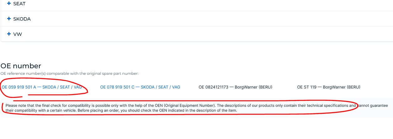

Ben.
Autodoc says the Beru sensor is not compatible for our vehicles.
The Febi sensor shows compatibility

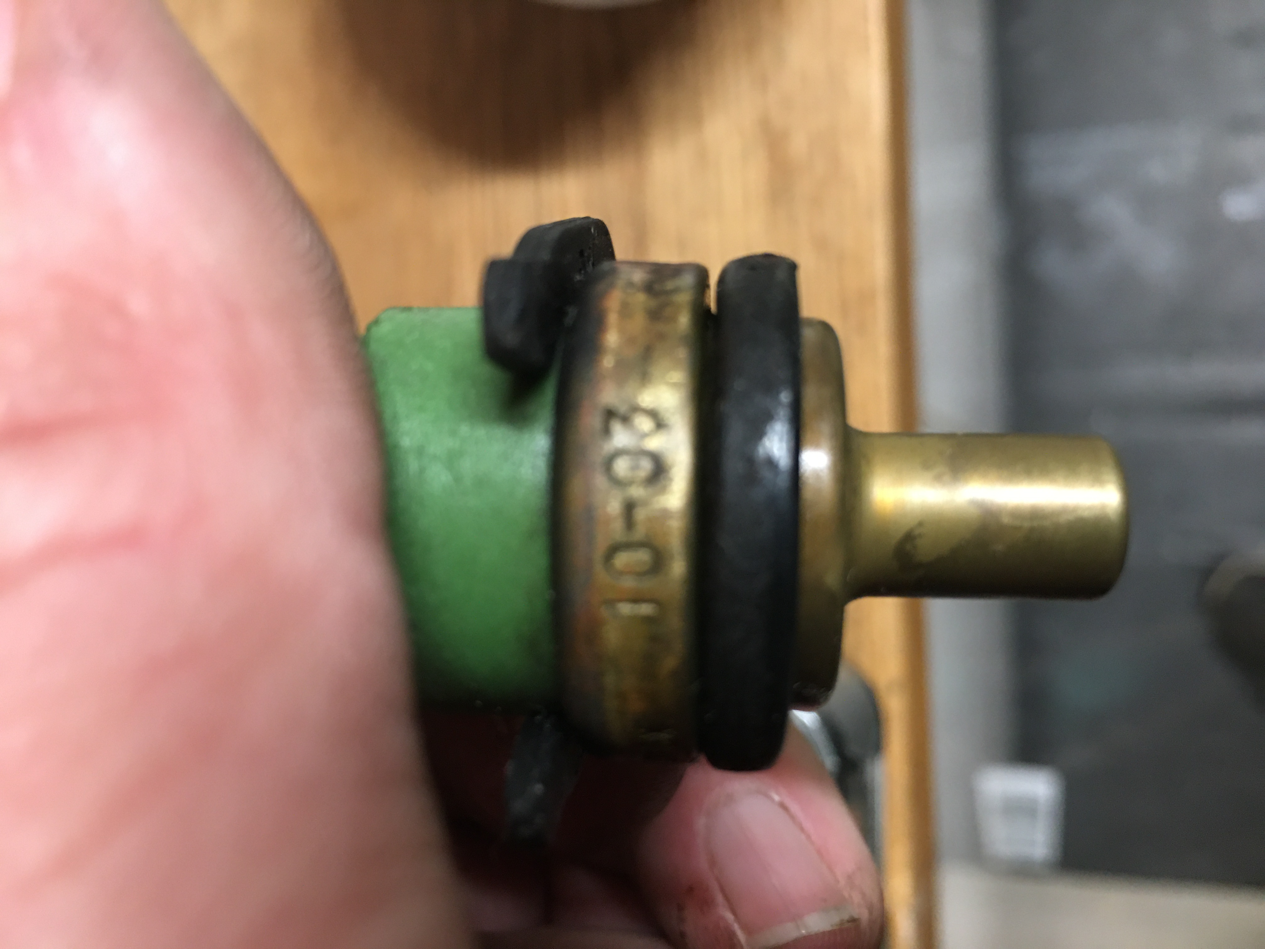

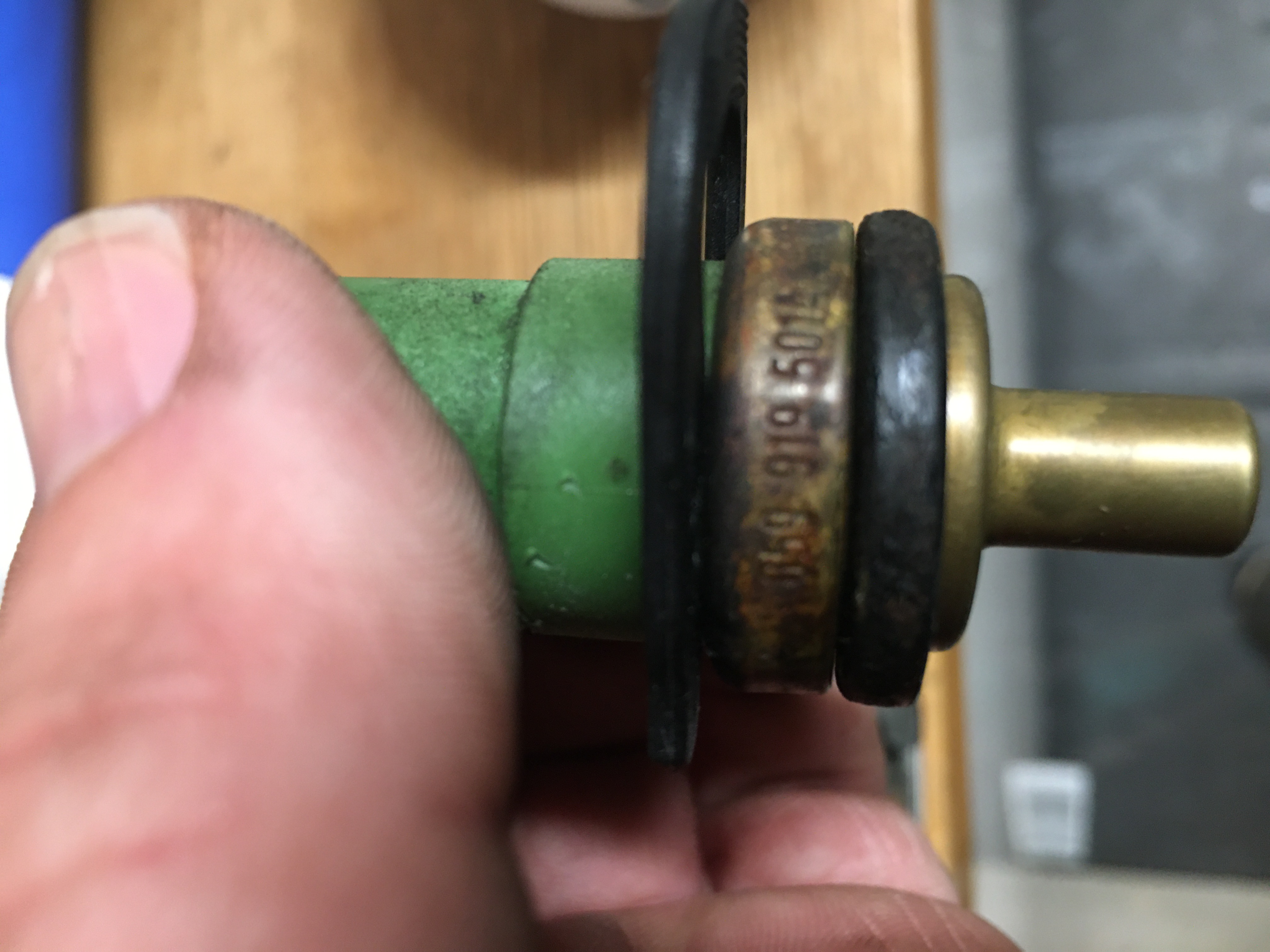

The infamous CTS! That would certainly make the engine run oddly or be difficult to start.
I've replaced quite a few over the years and several have been dodgy even though they appeared 100% genuine. In the end I went to a VW main dealer parts department to get genuine.
If you do that they sell the sensor, ring and clip as 3 separate items!

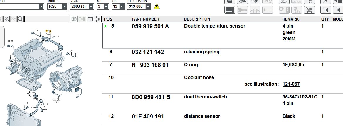

VAG part number 059919501A. Autodoc shows that the Beru part is equivalent.steve2003rs6 wrote: ↑Mon Feb 03, 2025 10:54 amBen.
Steve2003rs6
- Posts: 2967
I just used your above link ?
