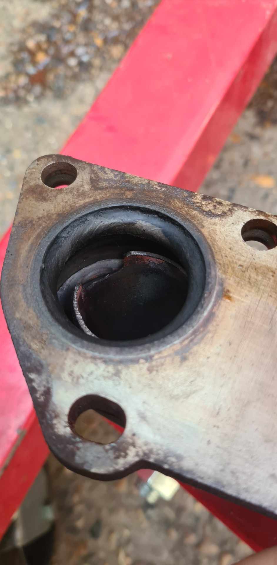

Diagnosis was correct. I suffered the same fate as Sid all them years ago.
Engine now out, manifold and turbo off. Manifold has broken up and is rattling away. So that was my rattle all along! Picture shows it. The missing part off the tube inside the manifold in the picture was found in the turbo and had stalled the turbo. Wouldnt spin forward but would spin backwards then the small part of manifold fell out of the turbo inlet and now the turbo feels fine.
Now to hunter gather for parts!

Wow, is that how the factory manifold is made, not a great design to potentially allow bits to fall off and through the turbo.

No not a great design! Im not the first either apparently. It's also playing on my mind having to fit a second hand manifold with no guarantees it won't happen again in 1000miles.
Turbos were good before the incident, no oil consumption, next to zero oil in the intercoolers ever and zero smoke. Now the piece of metal is out it looks and feels fine. If it wasn't such a ballache to get to the turbos and need engine and box removal I'd be inclined to refit it and see but I'd be an idiot in this case. Turbos will be sent off for stripping and checking and go from there on their recommendations.
I'll do a few other jobs "while the engines out" then put it back together and try to forget the pain haha.

Seems like a good plan.
The manifold break up is still pretty rare. Think you were unlucky.
