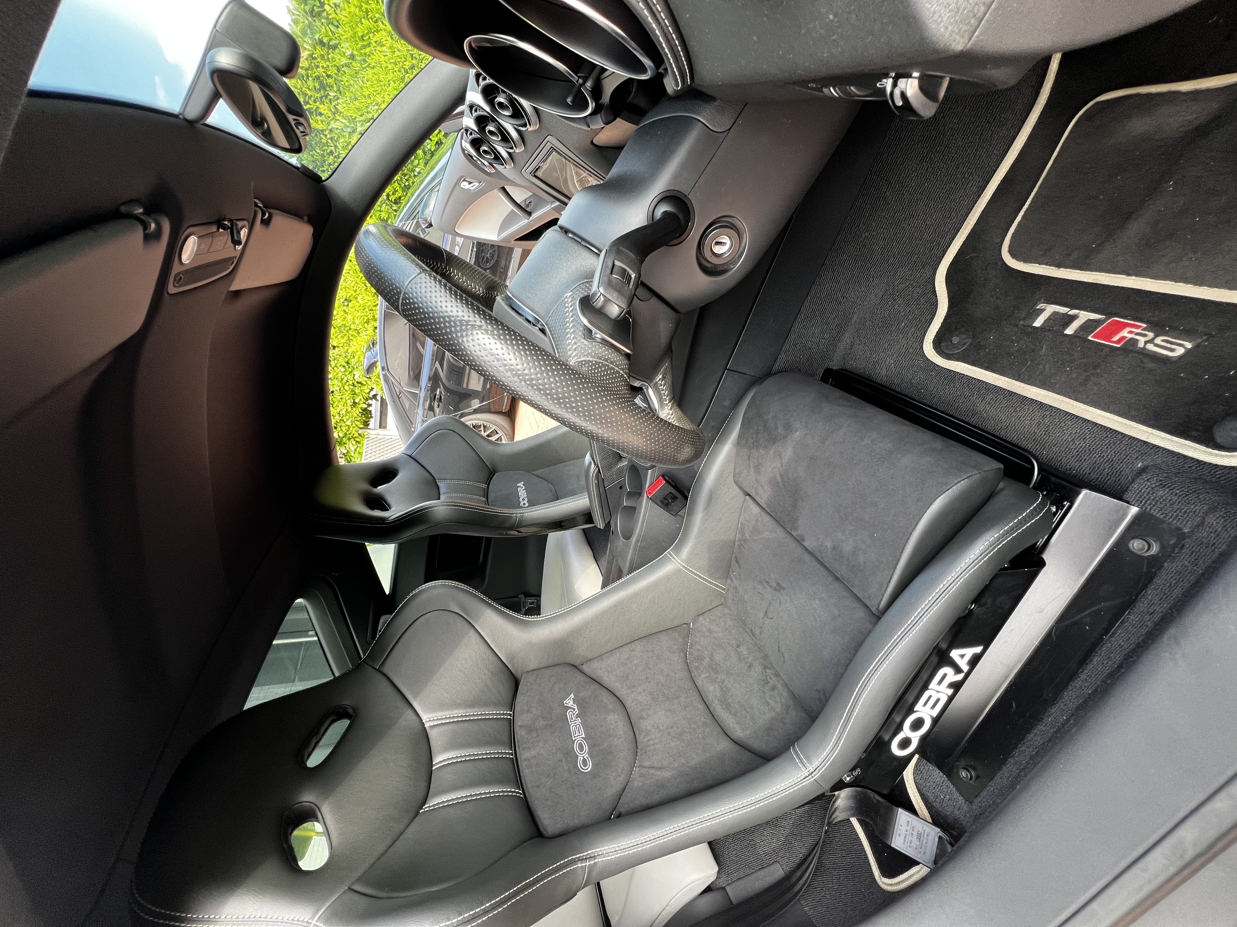

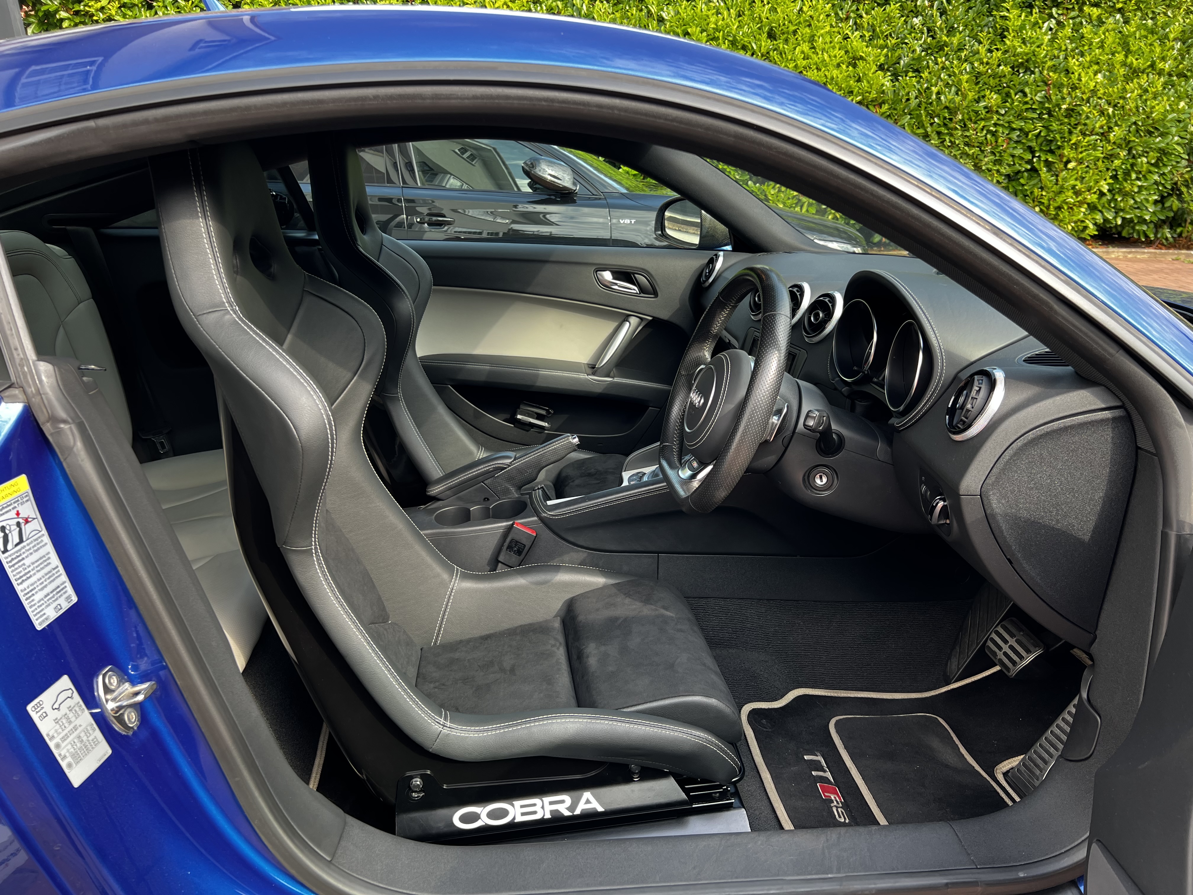

Main change since last outing - got some new seats!

• Seats way more supportive
