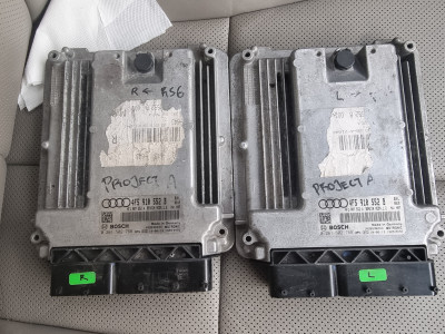

Interesting. The number on my ECU's is 4F5910552B. However there is also another number on the ECU's which is 4F1907552A My car is a 2010 Saloon plus model. Not sure what the difference is between these numbers. Both of which are on both ECU's. Any idea?
Roy

I think I've made this very confusing for which I'm sorry.
From the numbers you've shown on your ECU I think this is actually a set of "hardware" AND "software" part numbers i.e. Pt No 4F5910552B is the for the Hardware (the physical ECU) AND the Software combined, whilst Pt No 4F1907552A is just for the Software thats installed on it (not the ECU itself) - because when I search for that "software" number it only brings up the ECU software files being sold by a whole bunch of chip tuning companies.
Again, sorry to make this so confusing.

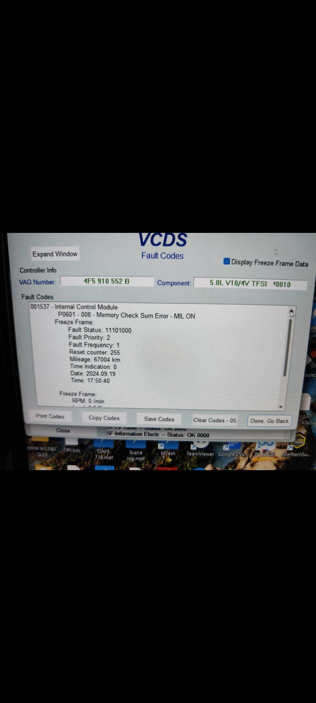

Correct, i'm running stage 3, which maybe contributing to the issues, so it would be good to know if anyone else has experienced something similar. The fault appears as a check sum error code on both ecu's.

Its the check sum error codes that show up, on both ecu's.
Attached is the photo of the error code.
