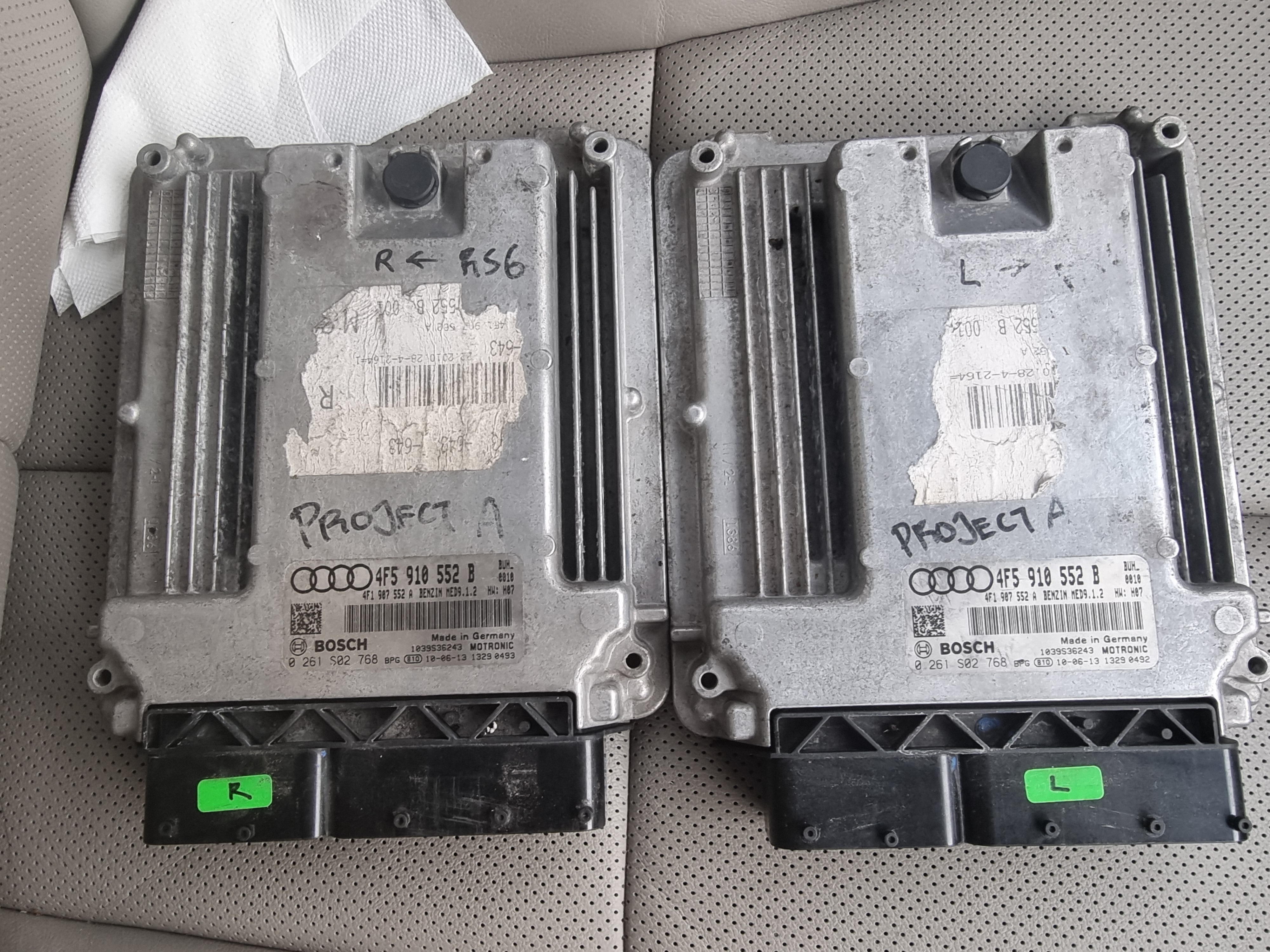

Interesting. The number on my ECU's is 4F5910552B. However there is also another number on the ECU's which is 4F1907552A My car is a 2010 Saloon plus model. Not sure what the difference is between these numbers. Both of which are on both ECU's. Any idea?
Roy

From the numbers you've shown on your ECU I think this is actually a set of "hardware" AND "software" part numbers i.e. Pt No 4F5910552B is the for the Hardware (the physical ECU) AND the Software combined, whilst Pt No 4F1907552A is just for the Software thats installed on it (not the ECU itself) - because when I search for that "software" number it only brings up the ECU software files being sold by a whole bunch of chip tuning companies.
