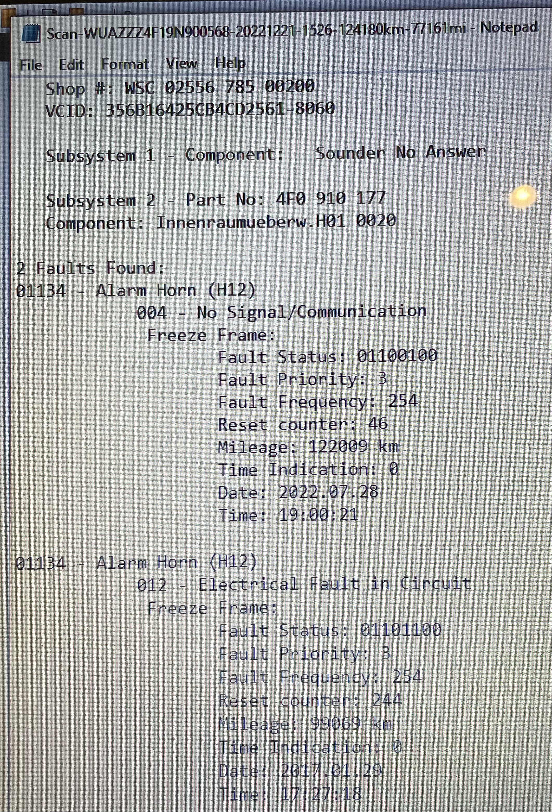

After a little alarm horn fault help
Getting the fault code 01134 Alarm horn H12 no signal on my rs6. I have swapped the alarm unit out under the front scuttle panel and no change.
I have tried looking for a blown fuse but I cant find a labelled alarm horn fuse in the front left and right panels or boot panel. Any ideas where fuse panel f2 is?
Otherwise I’m guessing a wiring fault? Any ideas, experiences or guidance appreciated.

Post by Jim Haseltine » Wed May 15, 2024 5:40 pm
As far as I can decipher the nightmare that is the current flow diagrams in ELSAWin, on the Avant the alarm horn fuse is number 8 in the black fuse holder in the boot. Looking at my car I'm pretty certain the fuses are numbered bottom to top.

Post by ATinOf » Sat Mar 08, 2025 3:09 pm
from my search today the H12 alarm horn itself is from Fuse 7 on ST2 guys which goes to terminal 3 on the horn, but its also connected to J393 convenience unit in the boot (at terminal 1 on the horn), J393 presumably drives the output or monitors for the diagnostics or both.
ST2 is in the boot offside behind the cubby hole
Noteworthy J393 itself has a couple of Fused feeds supplying itself, its a very busy controller!
If you have power at the horn on Terminal 3 and a good ground on Terminal 2, its pointing to an issue from J393
