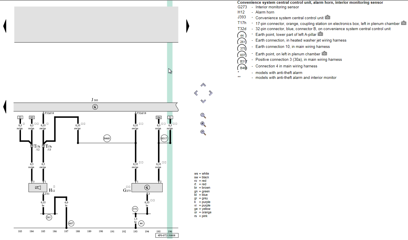

As far as I can decipher the nightmare that is the current flow diagrams in ELSAWin, on the Avant the alarm horn fuse is number 8 in the black fuse holder in the boot. Looking at my car I'm pretty certain the fuses are numbered bottom to top.

from my search today the H12 alarm horn itself is from Fuse 7 on ST2 guys which goes to terminal 3 on the horn, but its also connected to J393 convenience unit in the boot (at terminal 1 on the horn), J393 presumably drives the output or monitors for the diagnostics or both.
ST2 is in the boot offside behind the cubby hole
Noteworthy J393 itself has a couple of Fused feeds supplying itself, its a very busy controller!
If you have power at the horn on Terminal 3 and a good ground on Terminal 2, its pointing to an issue from J393

Jim - the ELSAWIN circuit diagrams are not that bad, dont know if you realise this but if you click in the box with a number in it (for the horn the '22' for example) it hyperlinks to the circuit with the accompanying link on it (for the horn where the F7 is), and this number relates to the index number at the foot of the circuit page at that destination. Without these hyperlinks it would be a mare as many of the diagrams have the same index numbers on them
