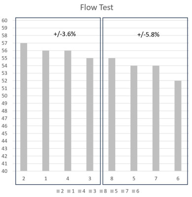

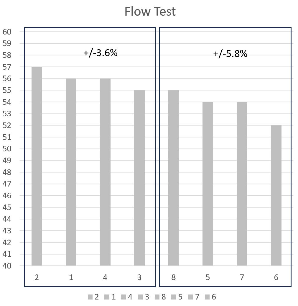

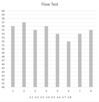

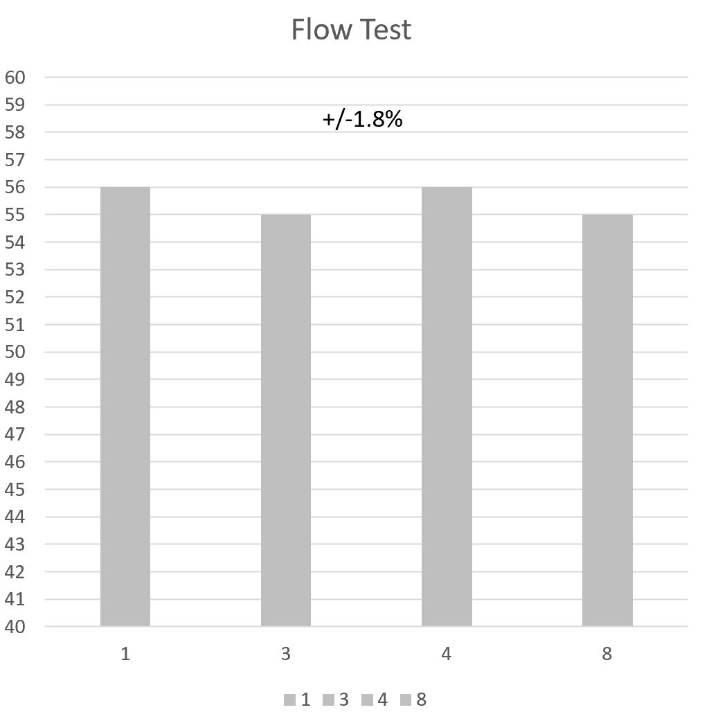

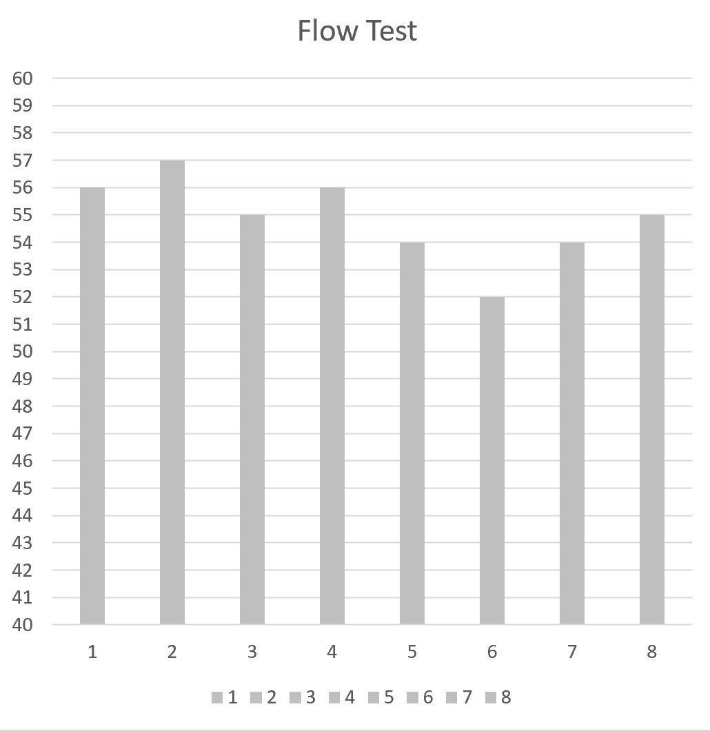

Injector flow testing results back.
Good news, they all passed and my home Ultrasonic cleaning worked as the before / after cleaning results they performed showed no different.
But
With one new injector in the mix, there is a flow tolerance that i am not happy with.
So decision to be made, purchase more new injectors in the most likely....
Wonder if new injectors vs 65k miles flow less and are expect to, or the new part number "AB" vs "D" suffix meant a small change in flow characteistics, or this is just manufacturing tolerances.
I think i will have to use injectors 1, 3, 4, 8 as a good set, then purchase 3 more and make a set of the rest (if luckly).
This is potentially an endless game now, you could buy a whole stock of injectors and not get a good set within 2%....
But as it stands, the best i could match would be this, 4% on first 4 and 6% on the other. Not good enough. #2 needs to go. Then it will depend what the new ones come back (with yet more testing costs on top), i wonder how sensitive the car is, why do MRC target 1%? https://mrctuning.com/site/servicing/#injectors

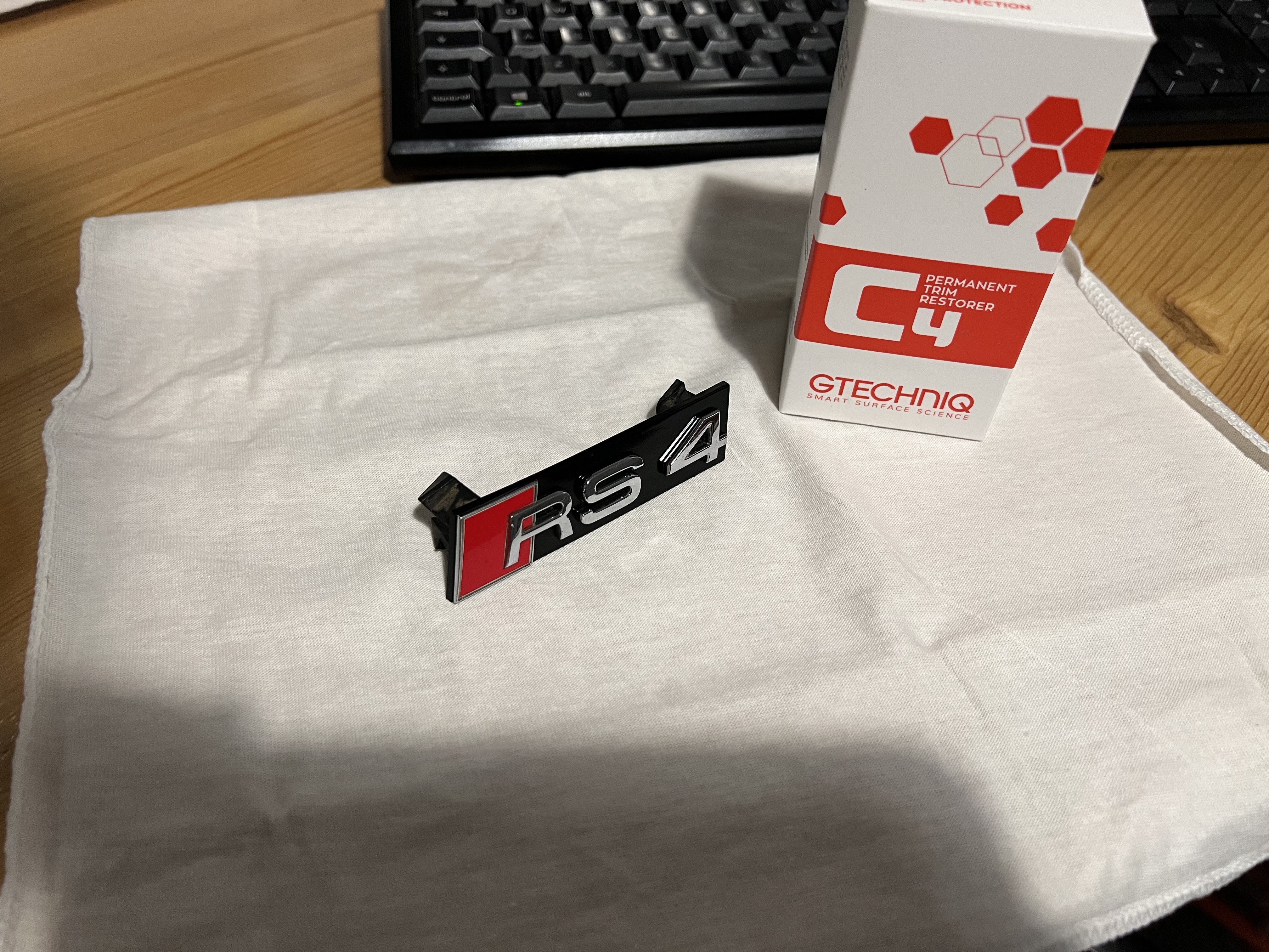

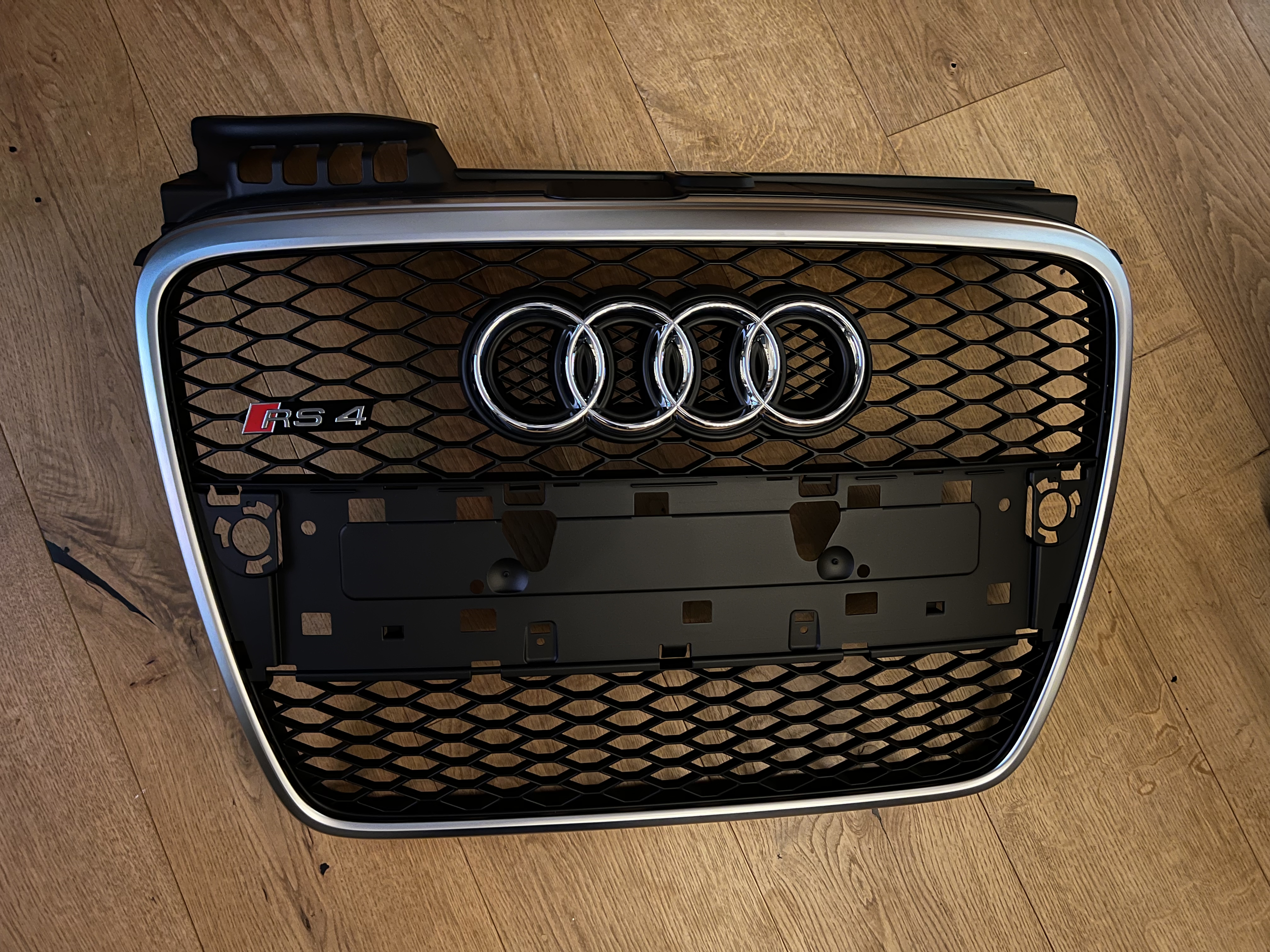

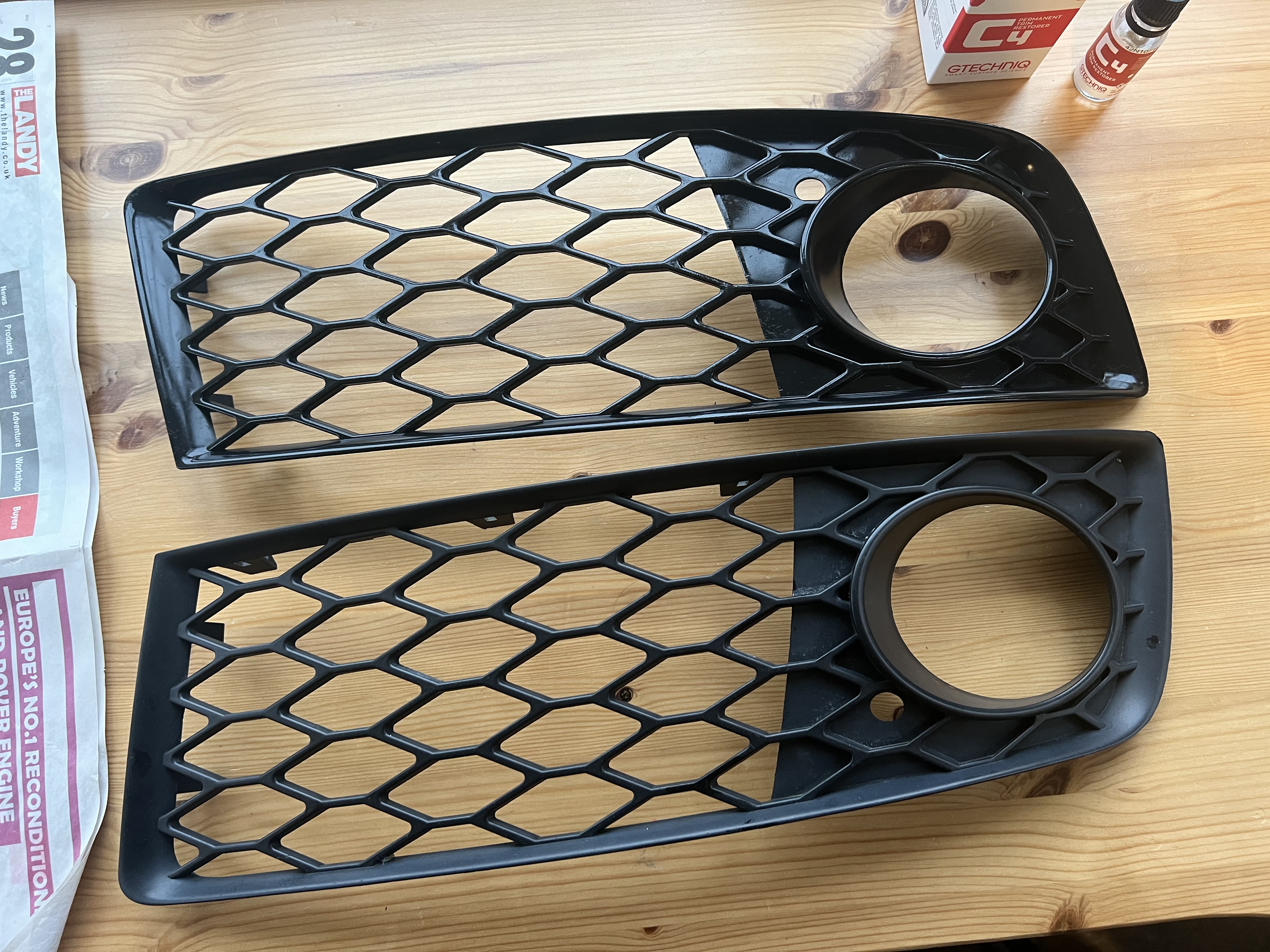

Went for a new front grill, mine was bubbling and ruined the look.
Cleaned and re-used the front badge, this stuff is great for plastic restoration i hear, looks good so far getting the faded plastic back to life.

By pairing them equally I can get both banks to 0.5% of each other if my maths are correct. (1181,1181,1154 in each bank then the final two split into the banks).
Great results.
Ive spoken to a different company to the one i used, it appears back flushing is critical to getting them back in spec, they say it can take several flushes to get them back to a good spec. I dont beleive the co i used did any back flushing.
So i will have to get them re-tested.
The problem i think i will have is the new injector may never match 3 used ones well enough, for reasons of age and batch variation on new injectors.
So safest bet is to purchase 3 more new injectors, and test all 11 to find the best mix, expecting the 4 new ones to make a set.
It is a worry that my used ones came back with a tested flow variation of 6% and the company were happy to send them back like that without further discussion.
Get what you pay for..... Those were tested for £14 each. The next co are looking at £23 with new metal filters fitted, back flushing (Properly) and without changing seals (i already have them).

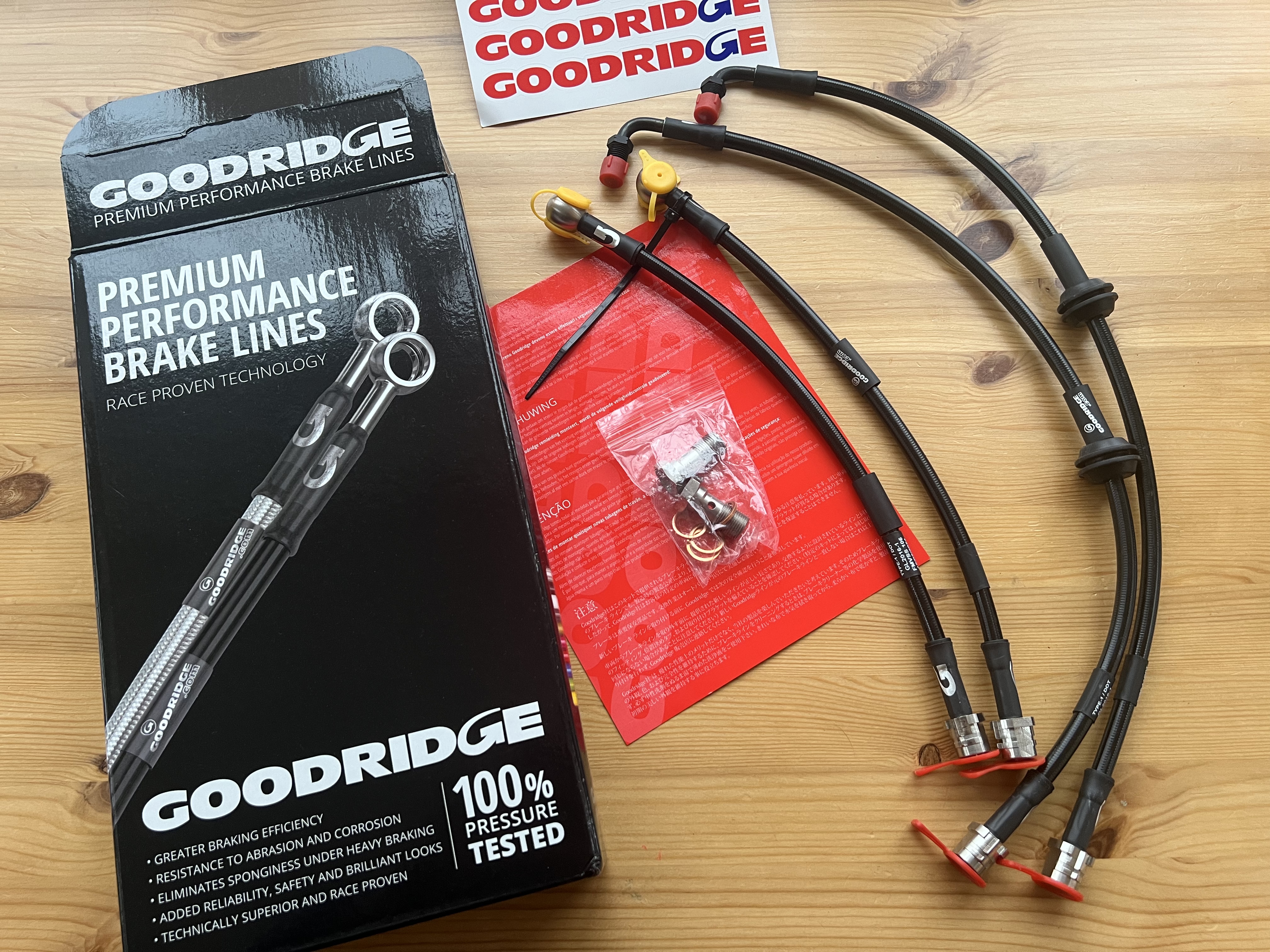

Goodridge braided hoses getting added as well now, and some MOTUL RBF600 fluid.

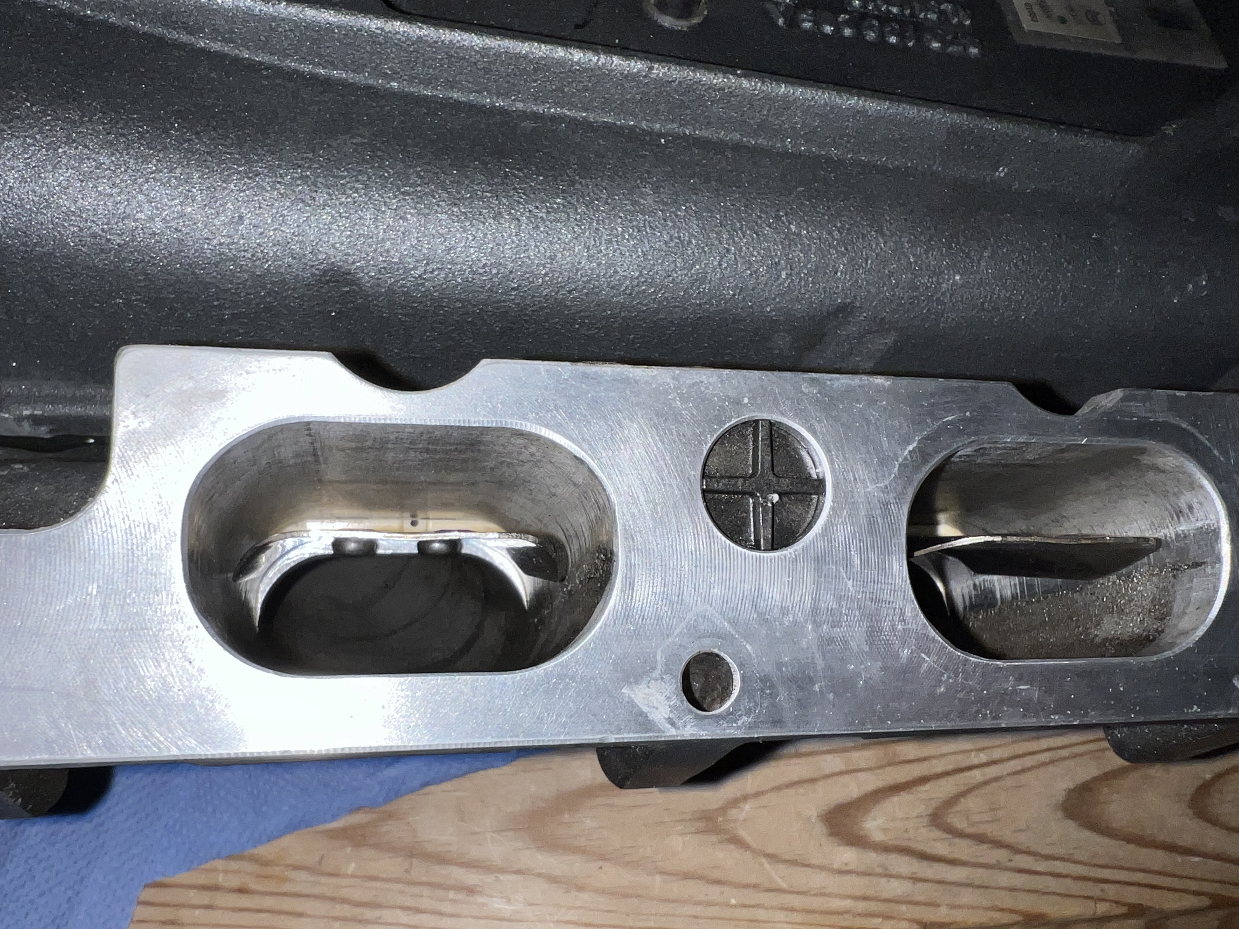

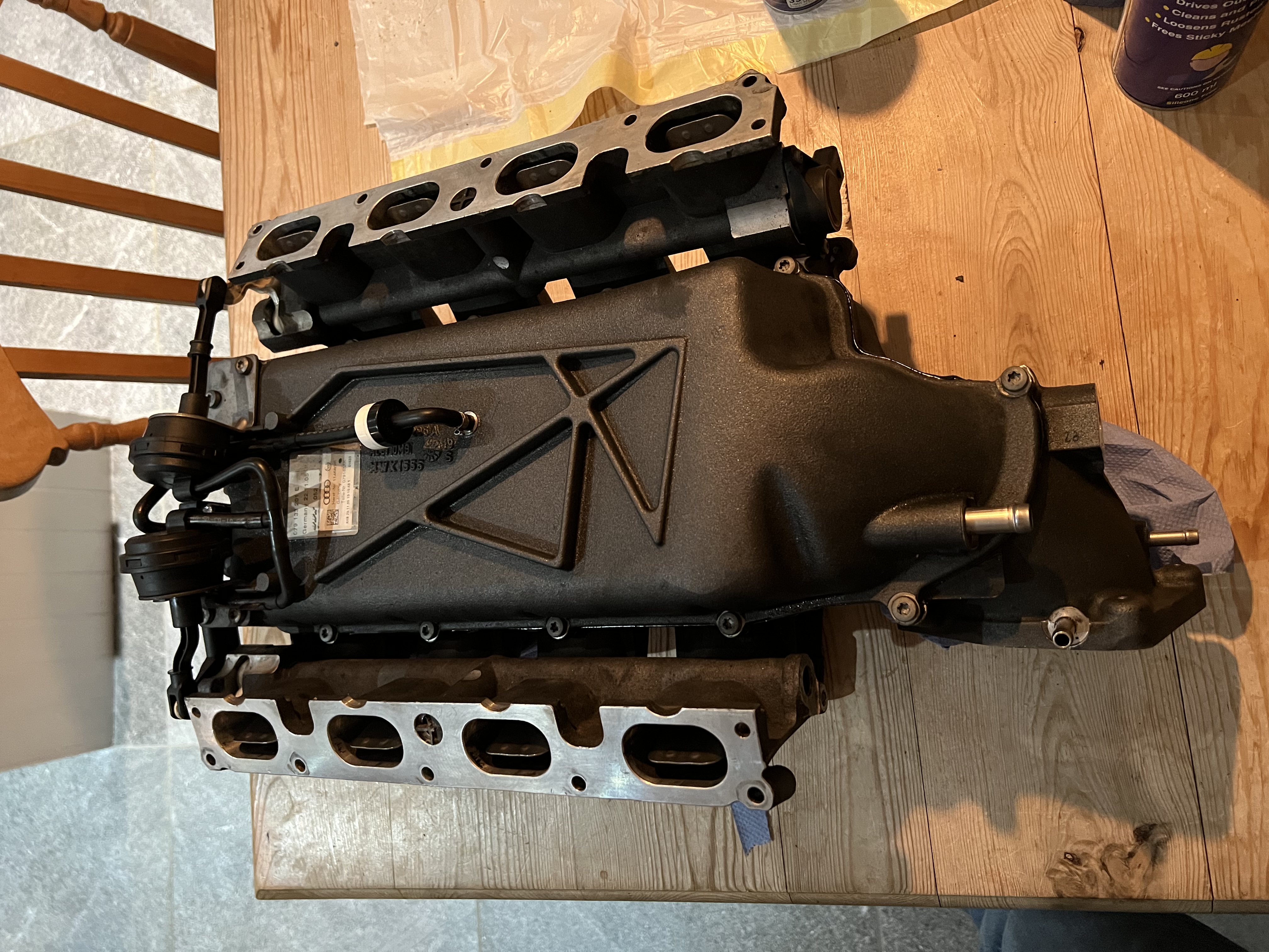

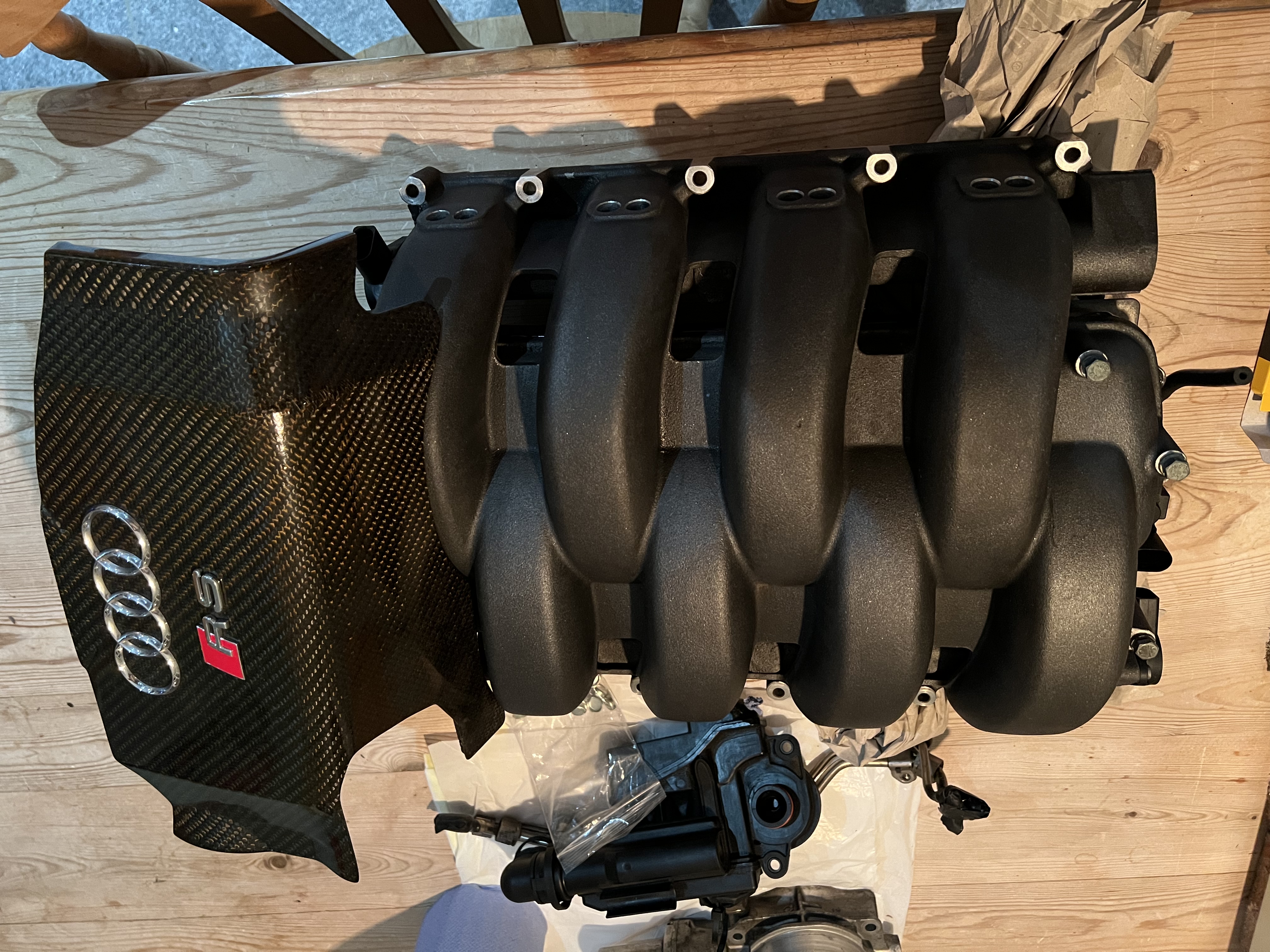

Manifold rebuild complete:

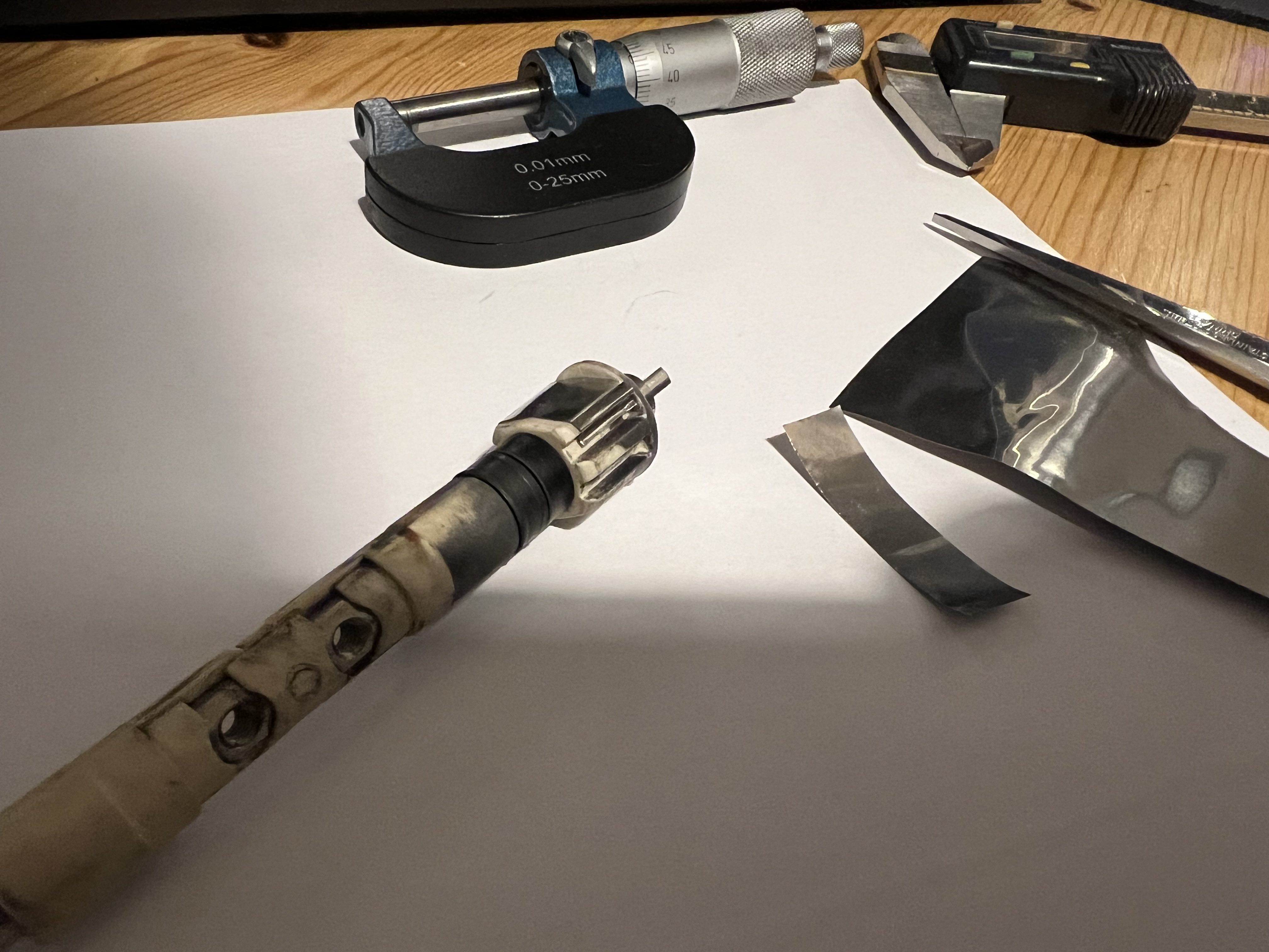

First, i did decide to take the play out of one of the shaft arms, one was tight so wanted them the same.
0.002" shim cut and secured onto the shaft with adhesive to stop it sliding out. Perfect fit and took all the play out.
You can see it here, on the top of the shaft sprocket. placed here it takes the play out evenly in both directions of travel.

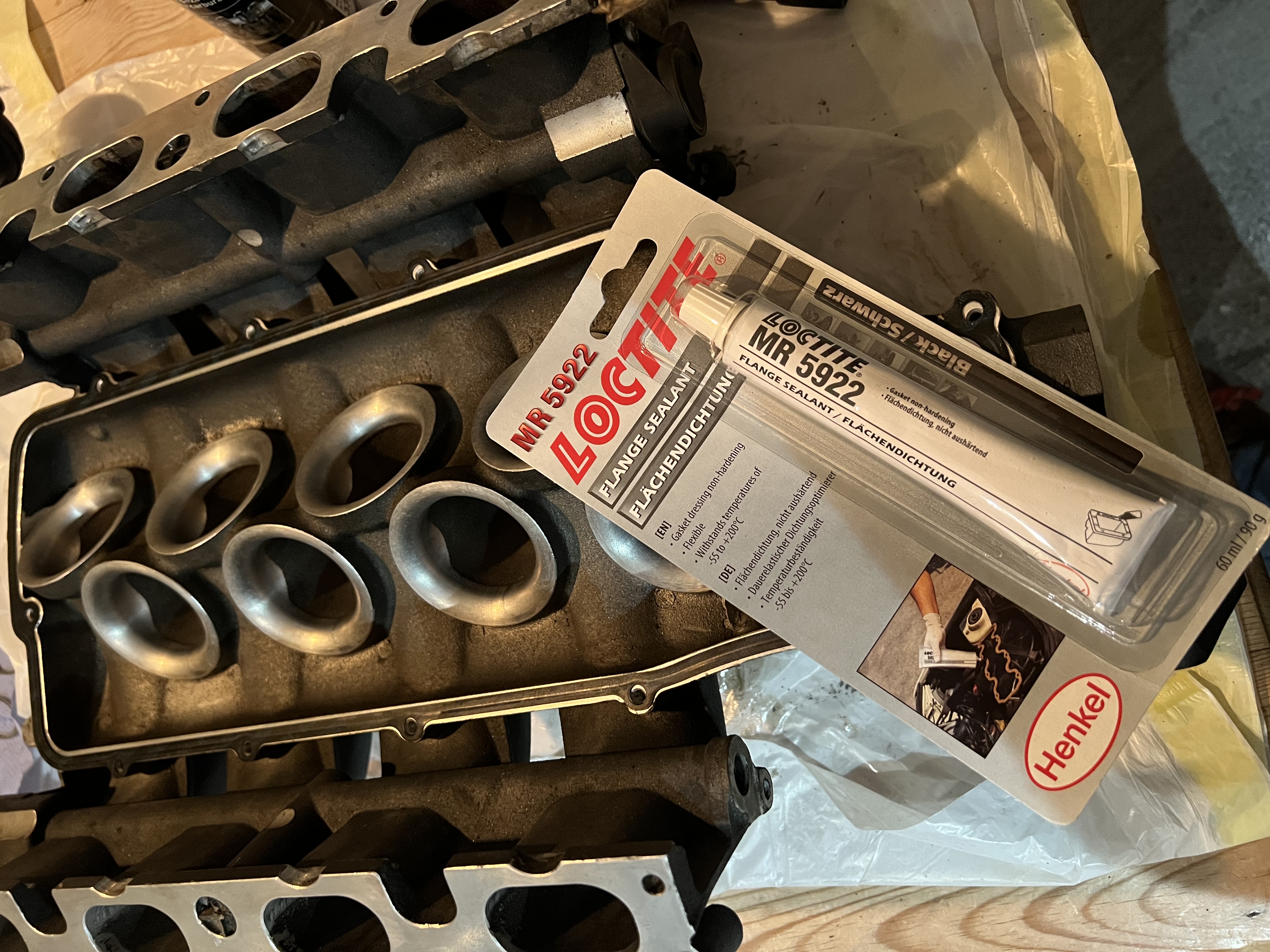

Added some flange sealant to the bottom gasket, its metal so in good condition, but cant hurt to make a perfect seal:

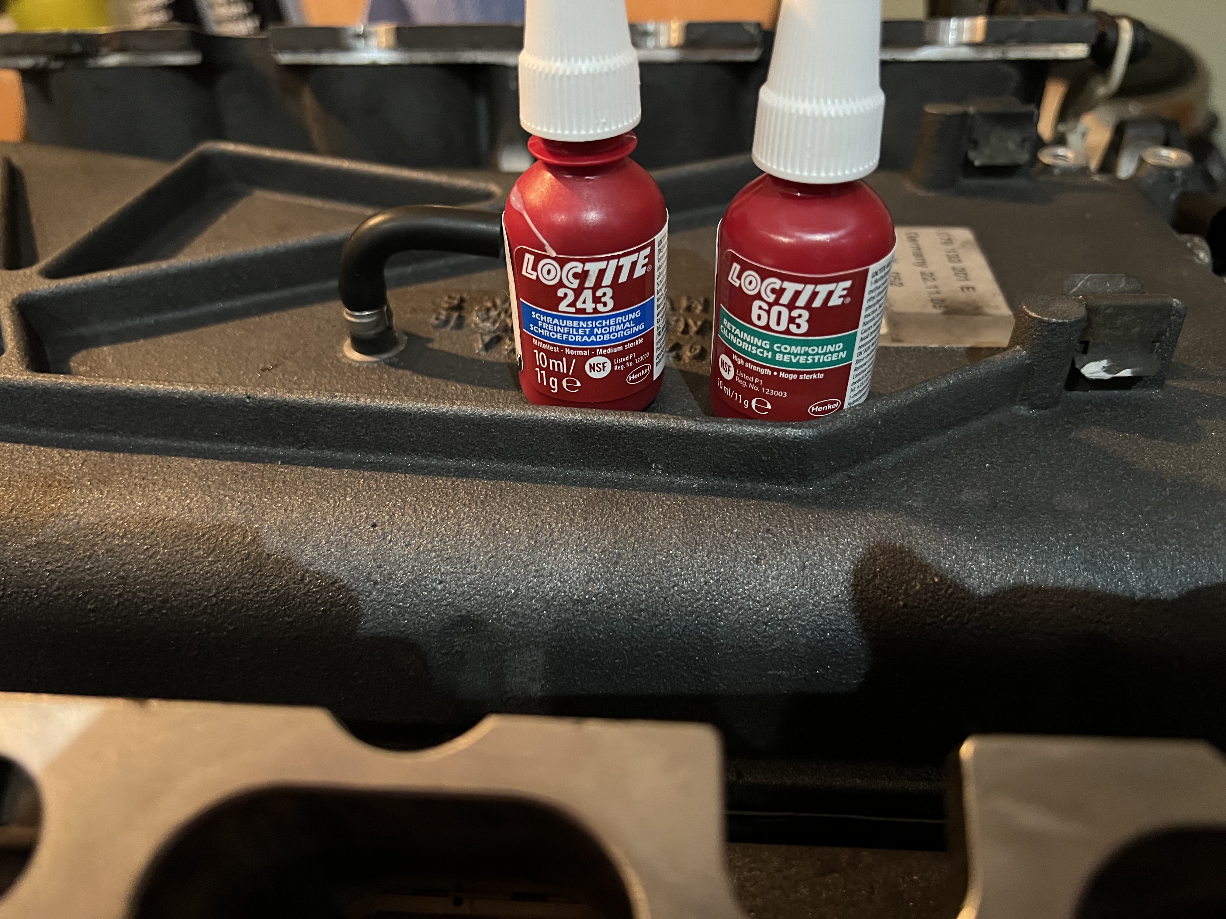

Flap screws loctite 243, core plugs 603 high strength:
