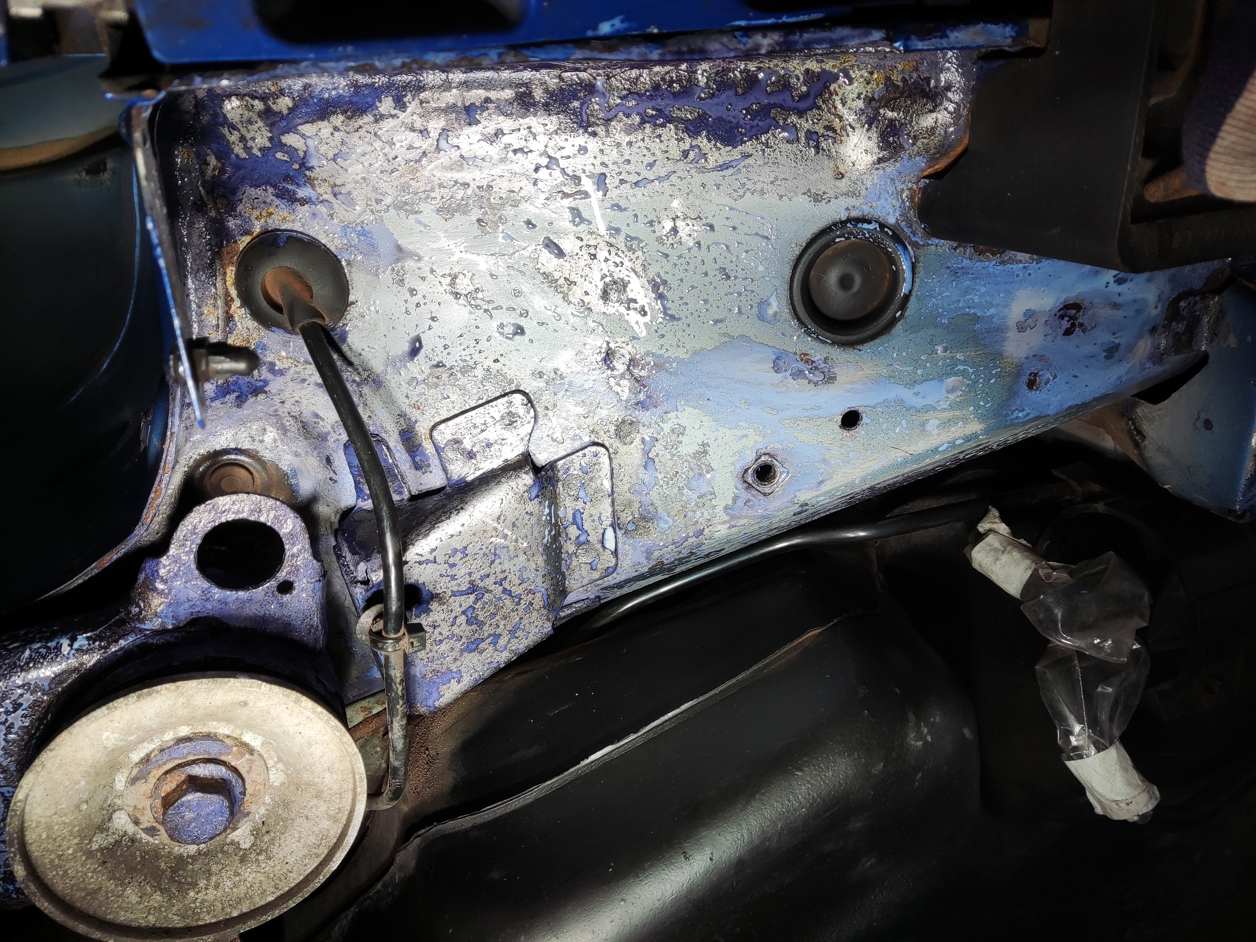

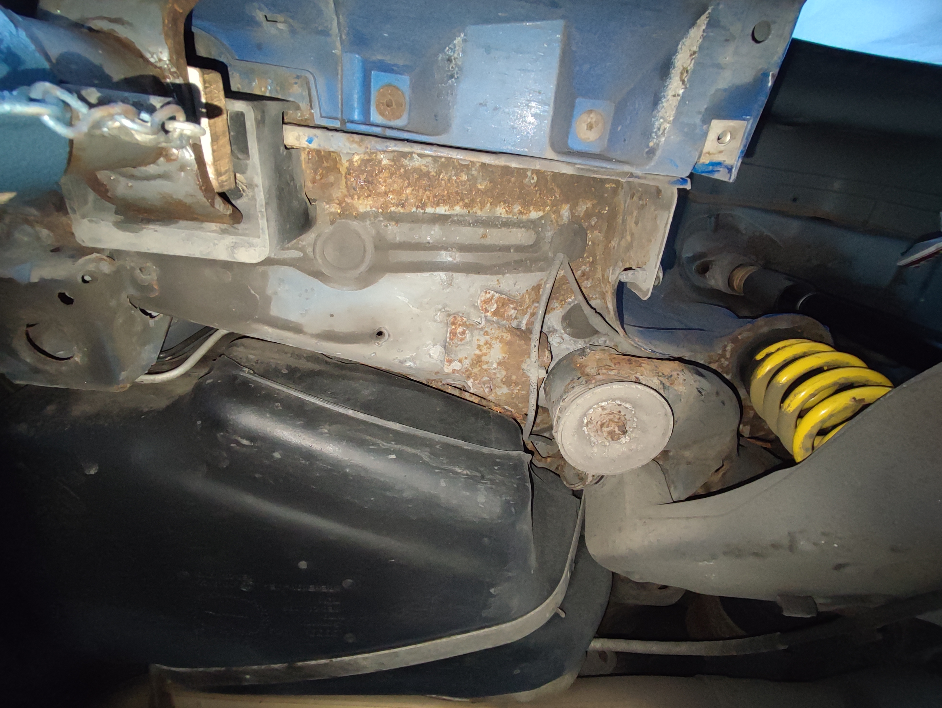

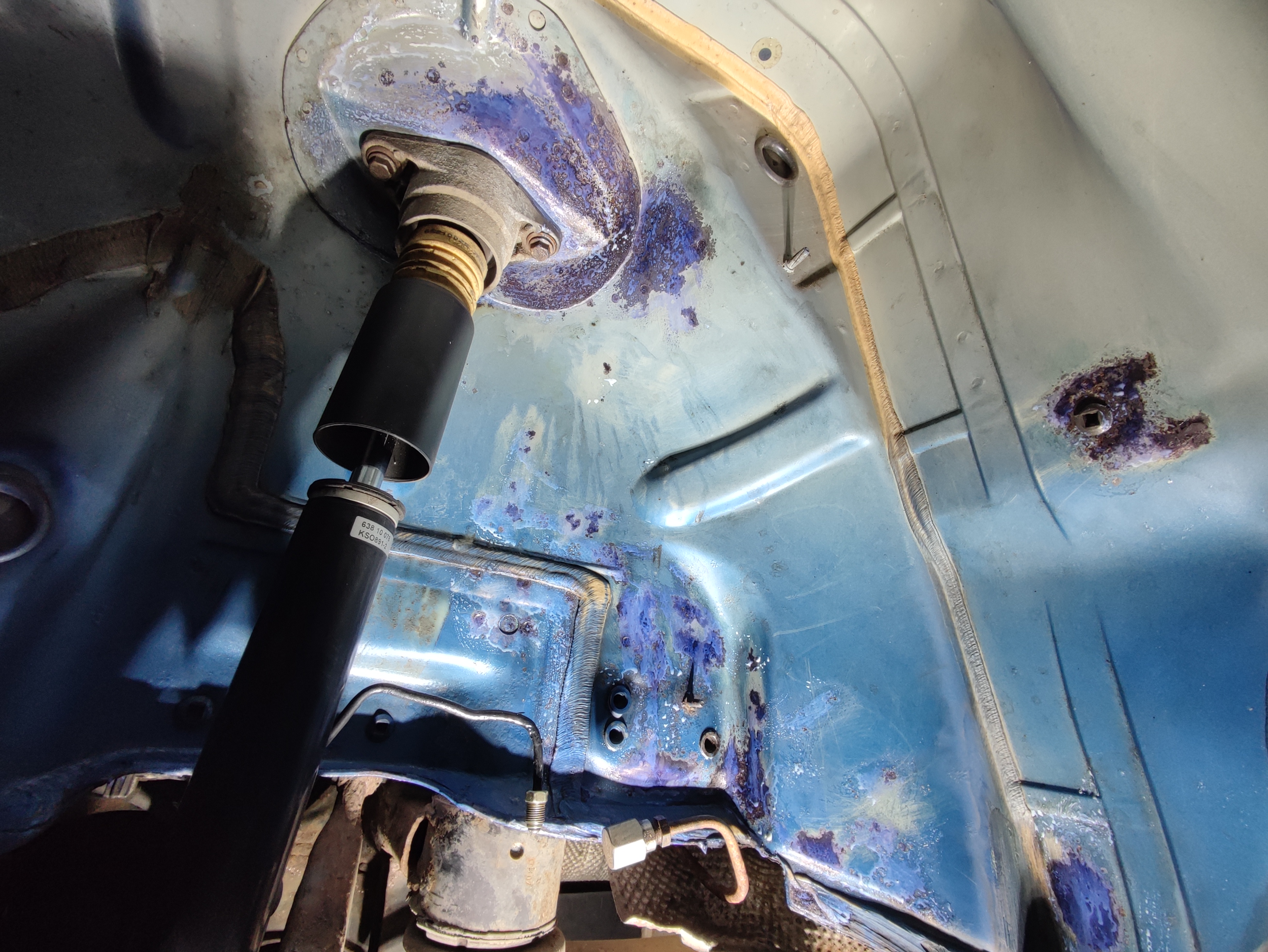

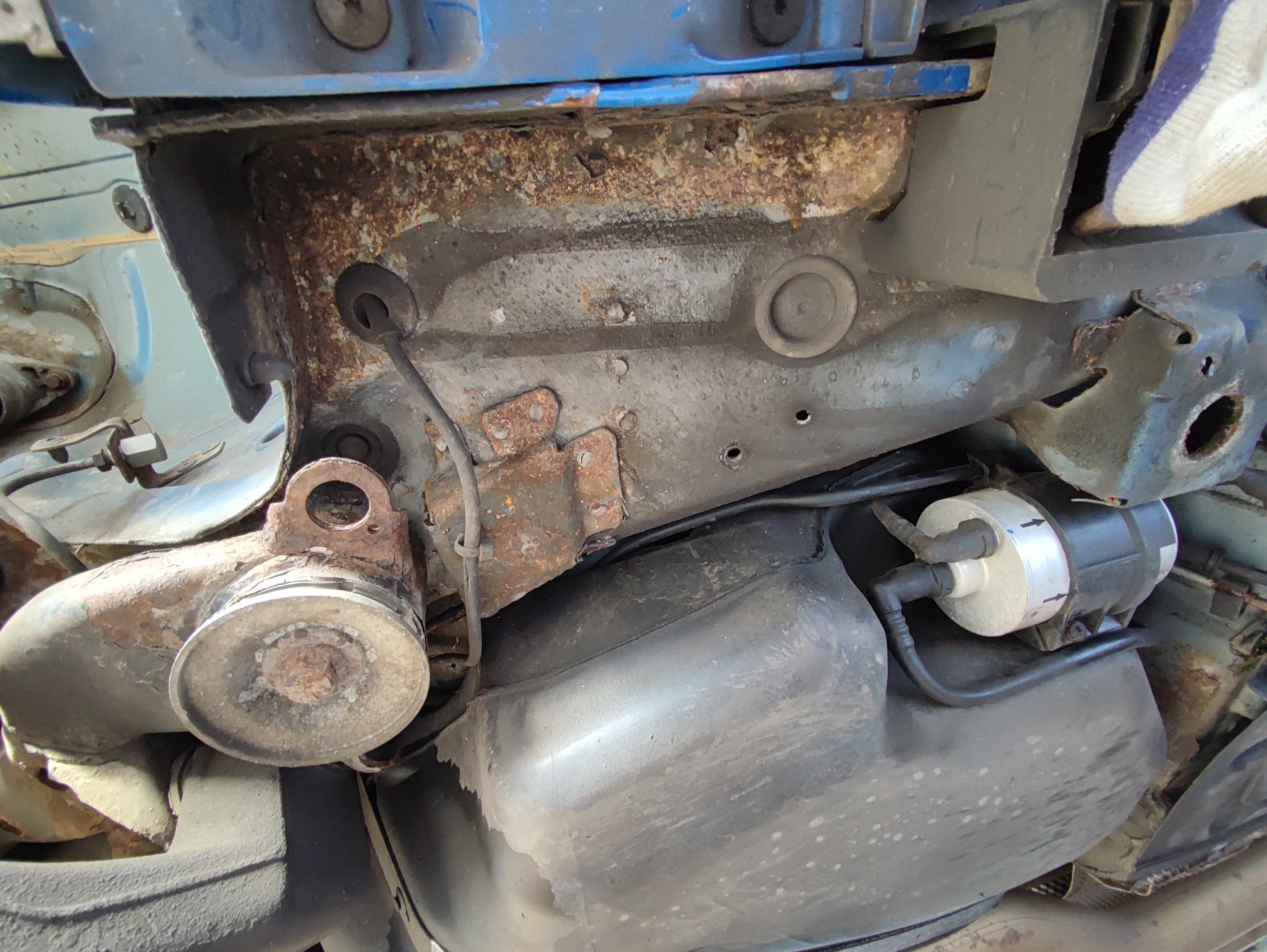

Unfortunately, in the process got to see some nice surface rust / corrosion issues going on in the rear wheel arches..
To boot - whilst tackling the Fuel Filter - which requires removing panels (I removed both sides) I got another nice surprise:
From what I've seen and read, the above is very common on our RS4's .. and obviously I need to tackle it now before it gets any worse :thumbsdown:

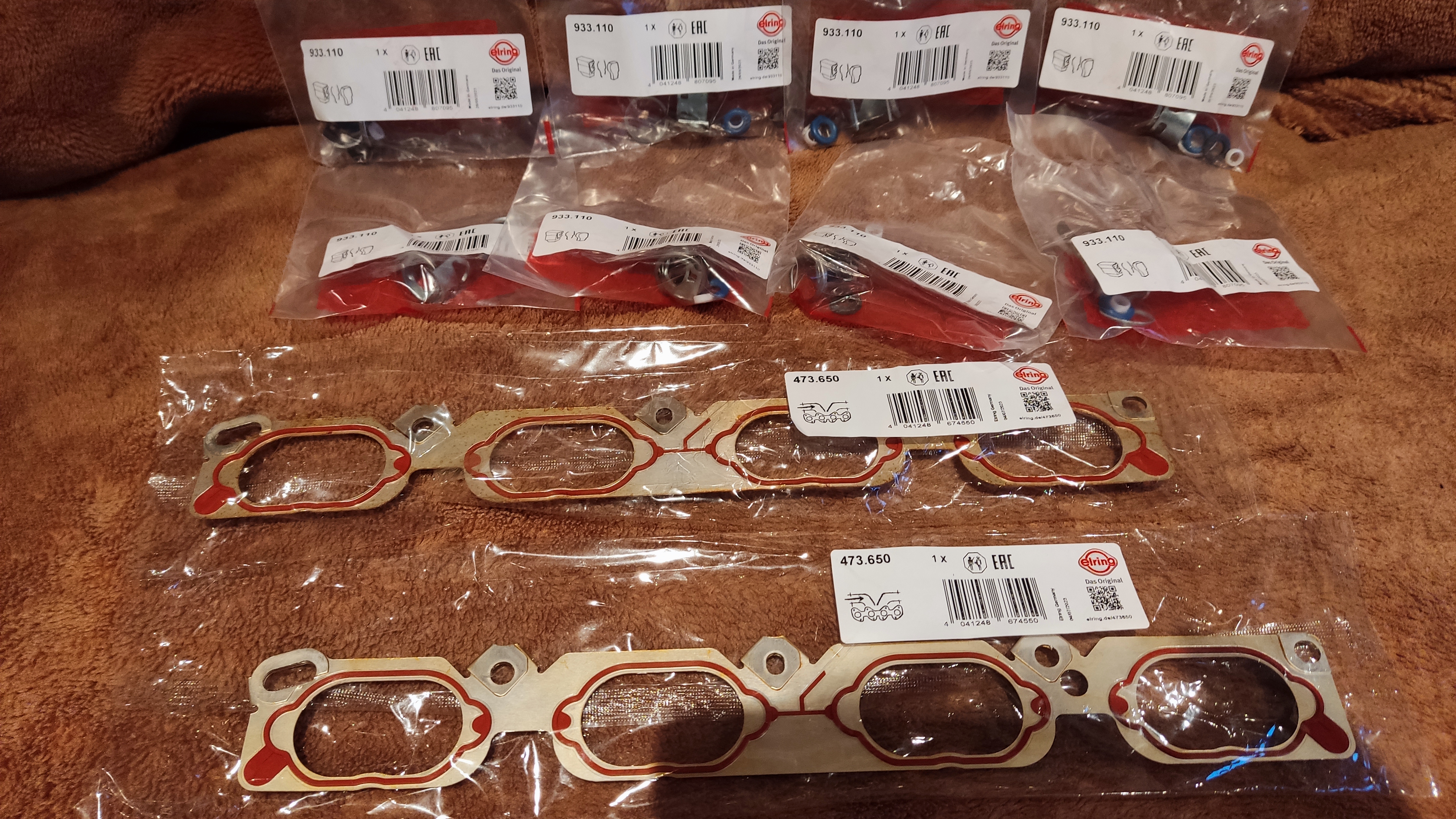

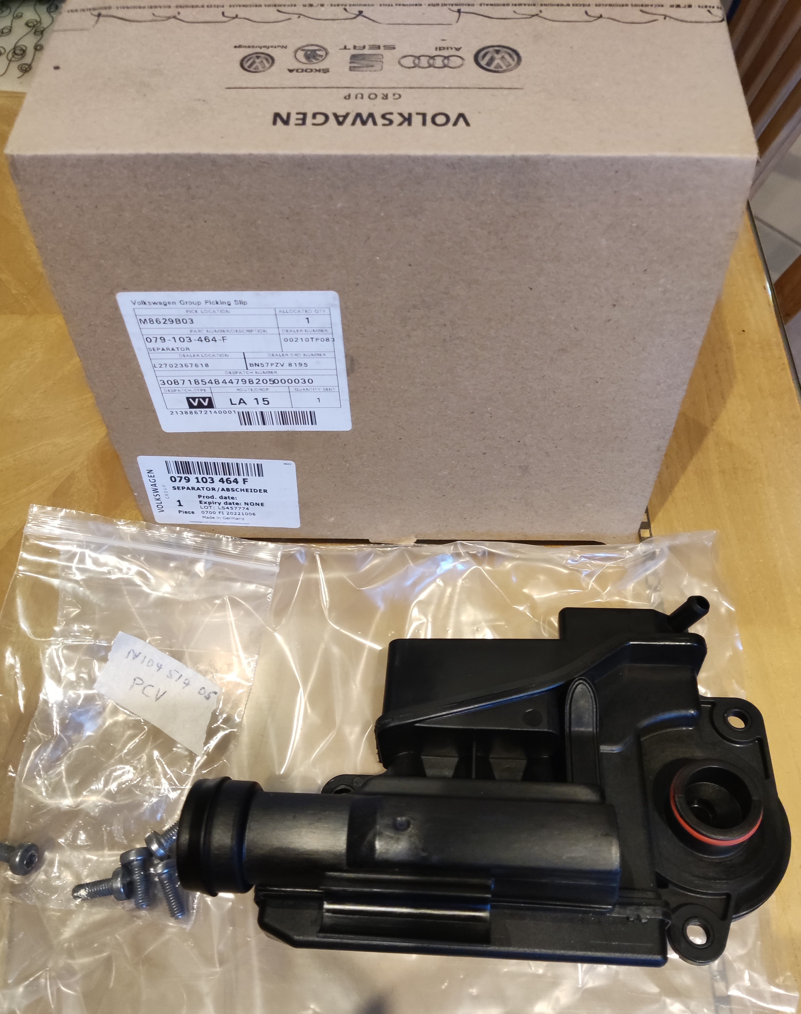

Its nice to see your progress, its a shame we are finding rust as we go, ive yet to take to a body Shop for the roof and front wings, wonding what else i will find.
Love the new injectors, i see you also purchased the Elring seal kits, did the new injectors not come with seals? Crazy.
I cant wait to get it back on the road with the full refresh.
My PCV oil separator looks in good order, i can move the valves by hand and they all feel in good order so going to wash it out and keep it. Saving another £220....

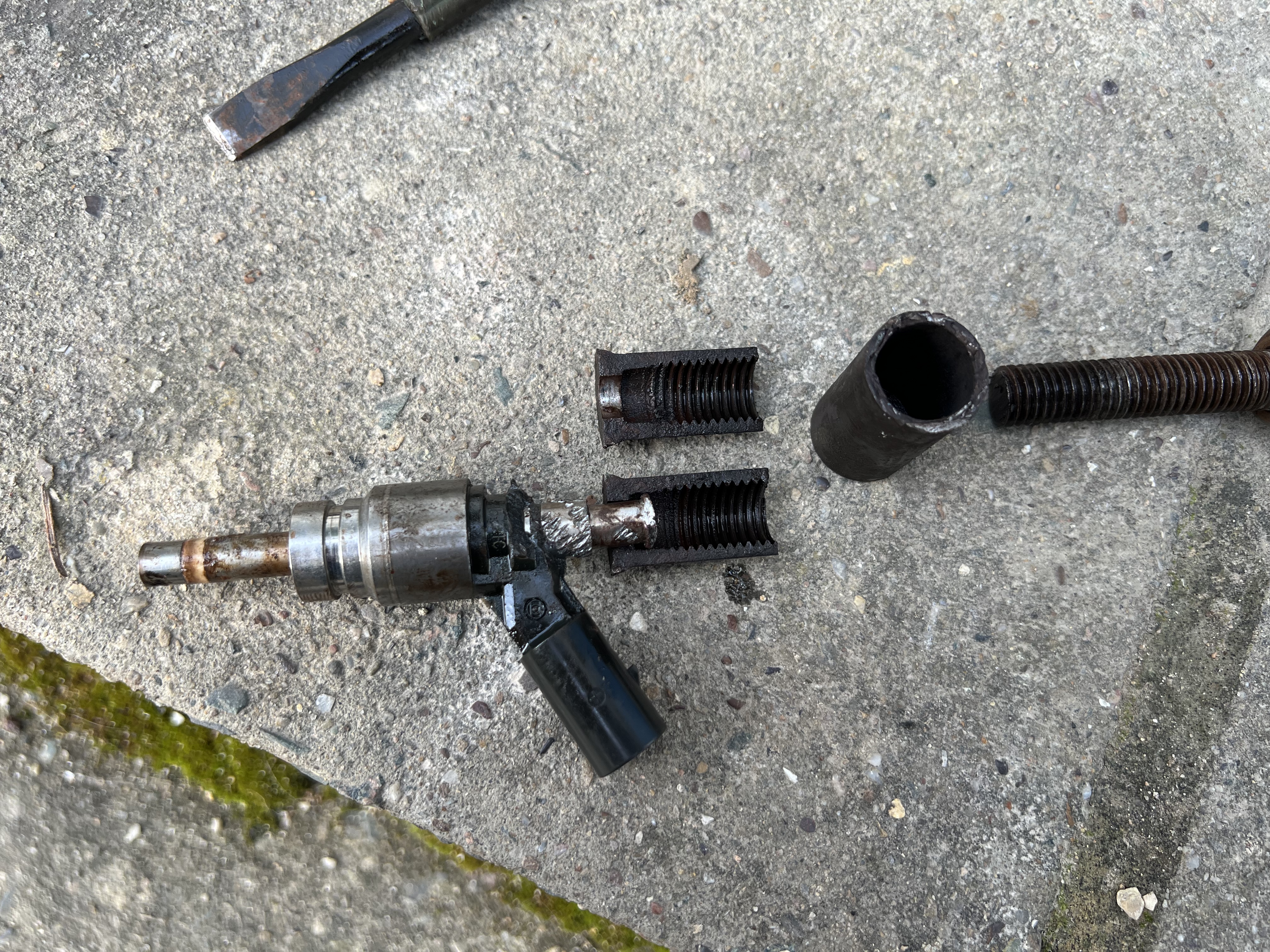

Pulled the 77k Fuel Injectors.. 2 of which were seized in there really nice .. and got out eventually.. but cracked :roll:
Mine isn’t coming out, slide tool just broke the plastic off and isn’t gripping the metal lip. Any tips on how you got them out?
06 - B7 RS4 Saloon - Milltek Non-Res Valved. BMC Filter.
lugars4
Posts: 320
Joined: Tue Apr 27, 2010 3:34 pm
Re: All comes at once - DIY: SAI, DRC, Oil cooler, Carbon clean, Fan, Tyres, Paint Corrosion, Injector Service
Post by lugars4 » Sat Jan 27, 2024 4:24 pm
Coulnt let that ruin my day.

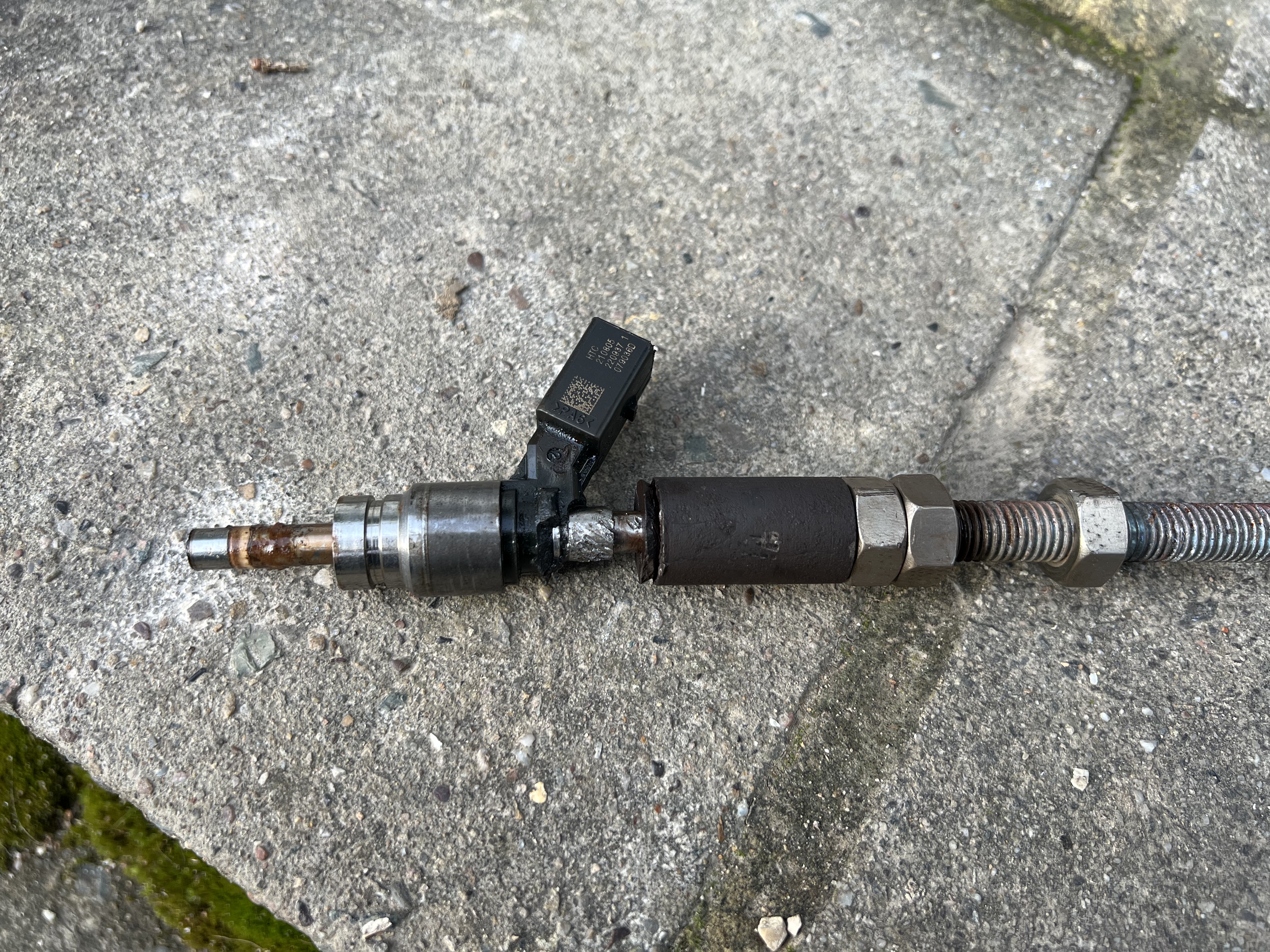

The tool kit i purchased from ebay, pretty useless, only part i will get value from is the bore cleaning brush and cone / mandrel for fitting teflon seals.
As far as removing the injector, no point using the kits tool for gripping on the plastic, thats never going leave you with a working injector if its stuck fast. Brittle, old, heat cycled plastic.
Needs to be gripped on the top metal lip, dont try levering either - ive seen many images of snapped injectors being drilled out of the head.
I had already mangled mine with pliers, but still had enough for an old home made tool i had to grip it. I forgot i made this years ago to remove stuck glow plugs from my land rover.
The other problem with cheap kits is the slide hammer travel, 100mm isnt enough, its pathetic.
Home made tool came right out. New injector needed sadly. Will test the other 7 to see if i feel any others need replacing after clean and flow test.

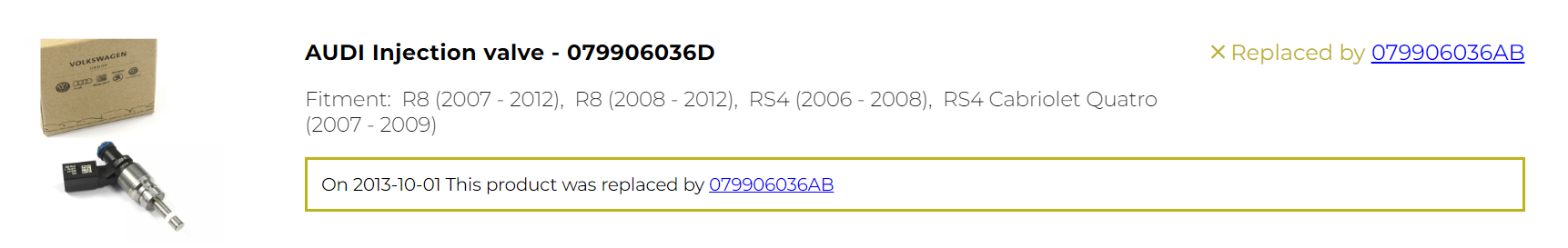

Where did you buy the injectors? I note there is a part number change.

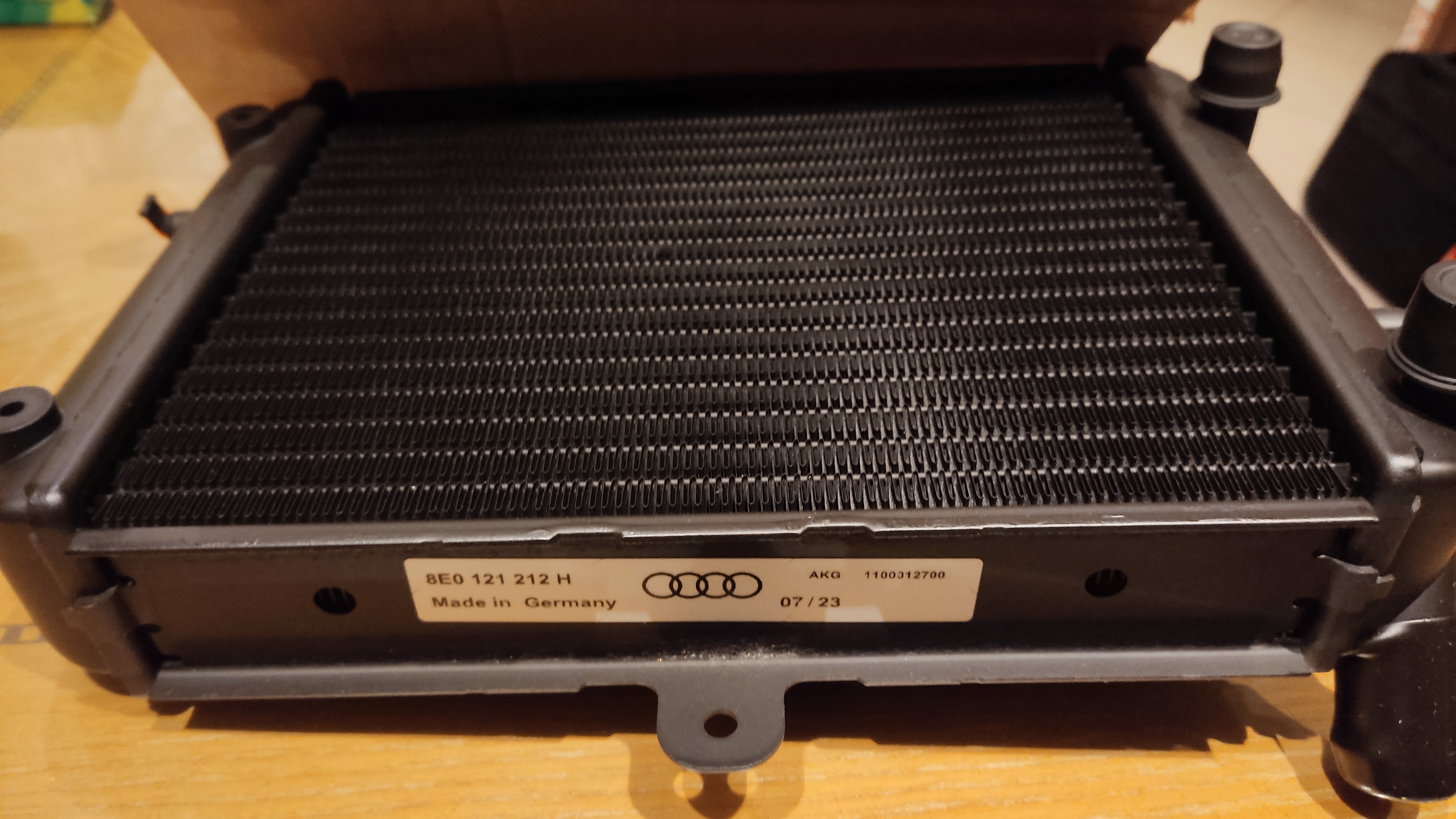

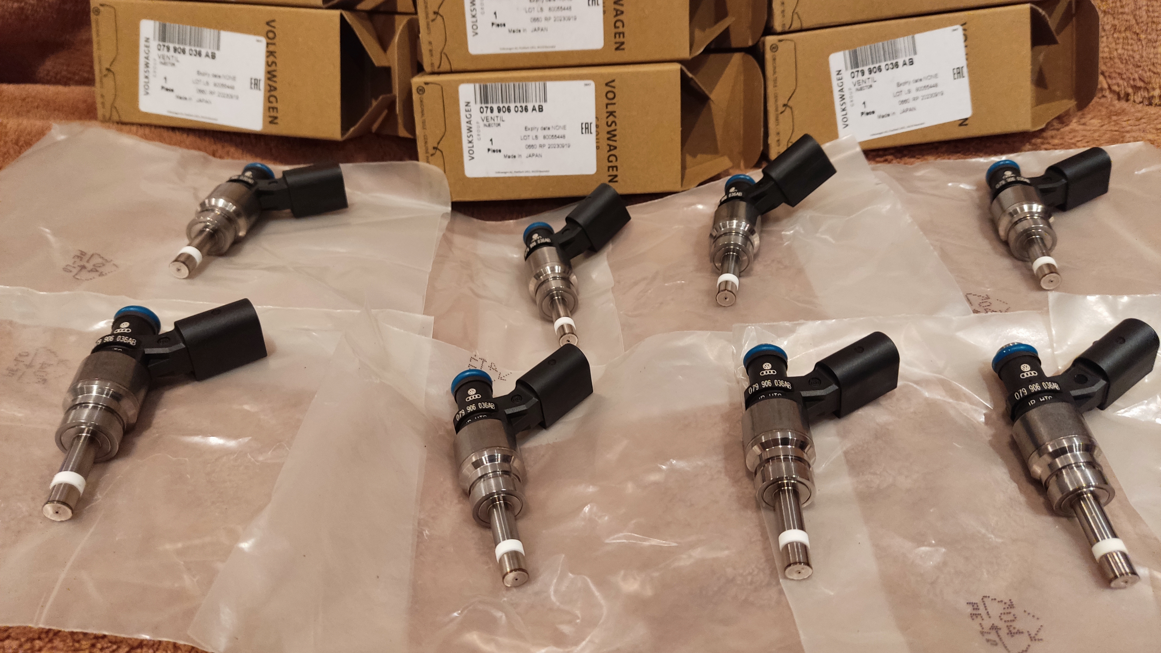

Yep, that's right - the revised OE Audi [Hitachi] Injectors are:
079 906 036 AB

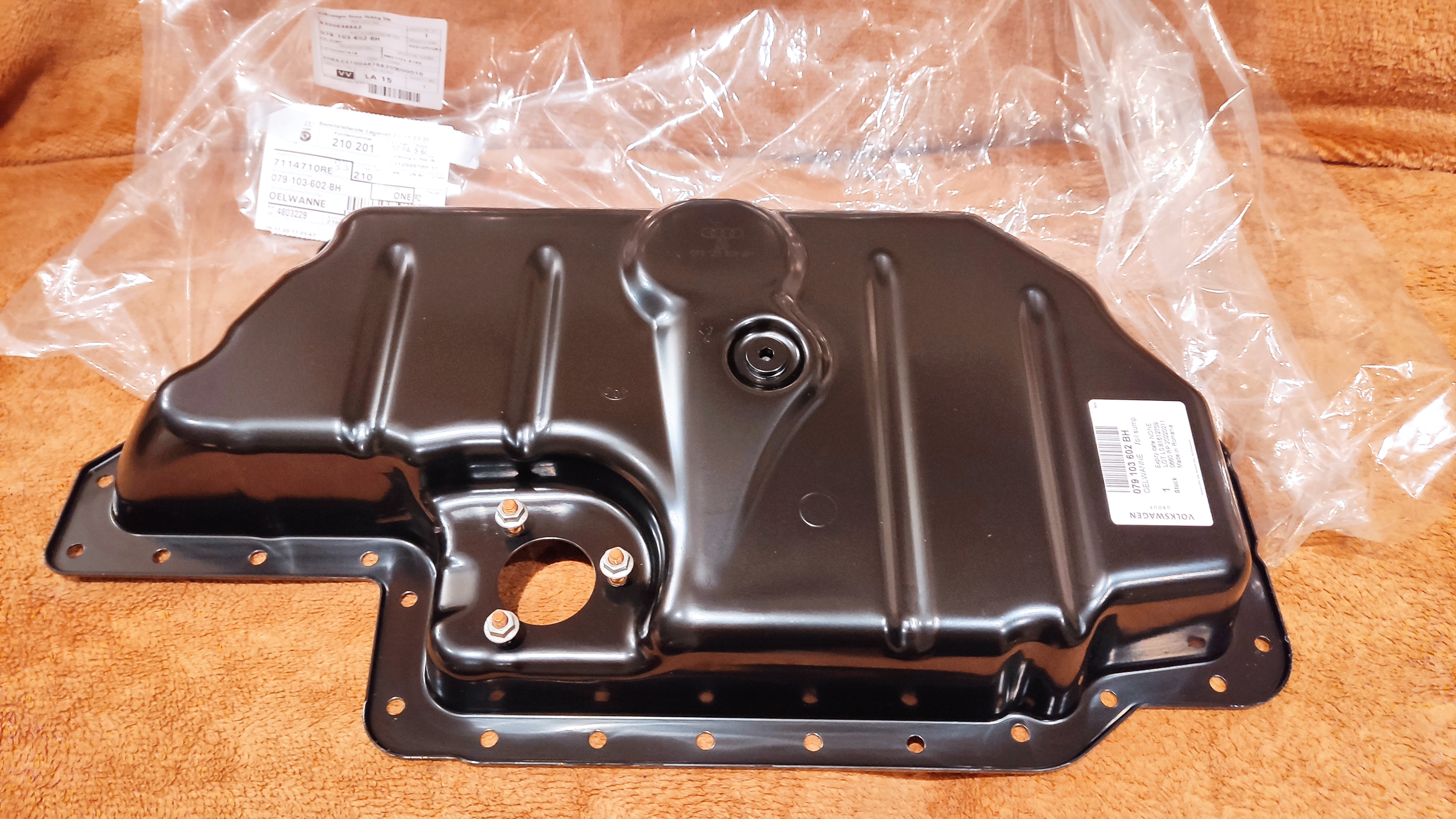

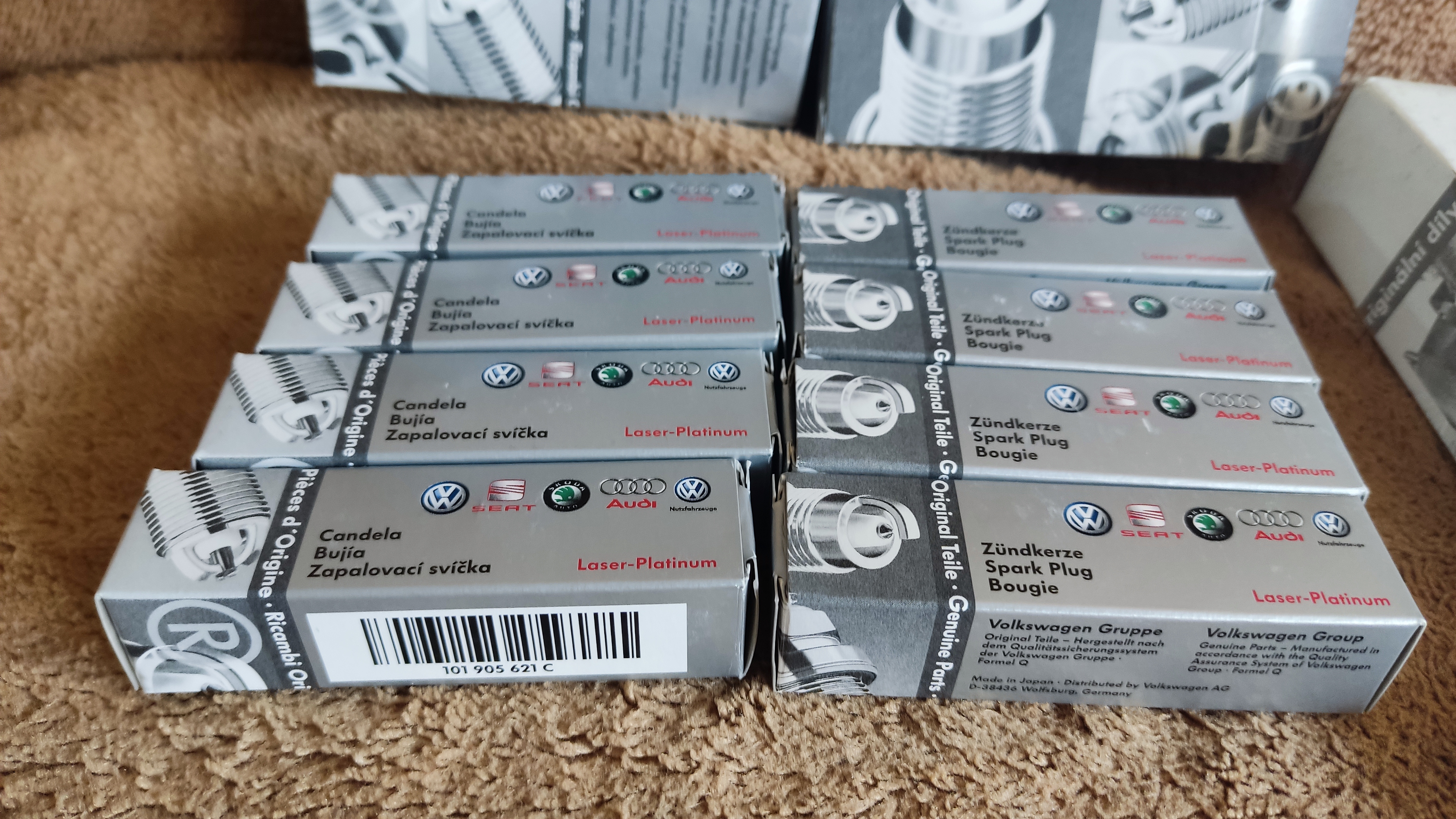

Got those and a whole load of parts from TPS .. total bill around ~ £2.6k :drink:
including new PCV separator, aux rad, sump, sparks etc..

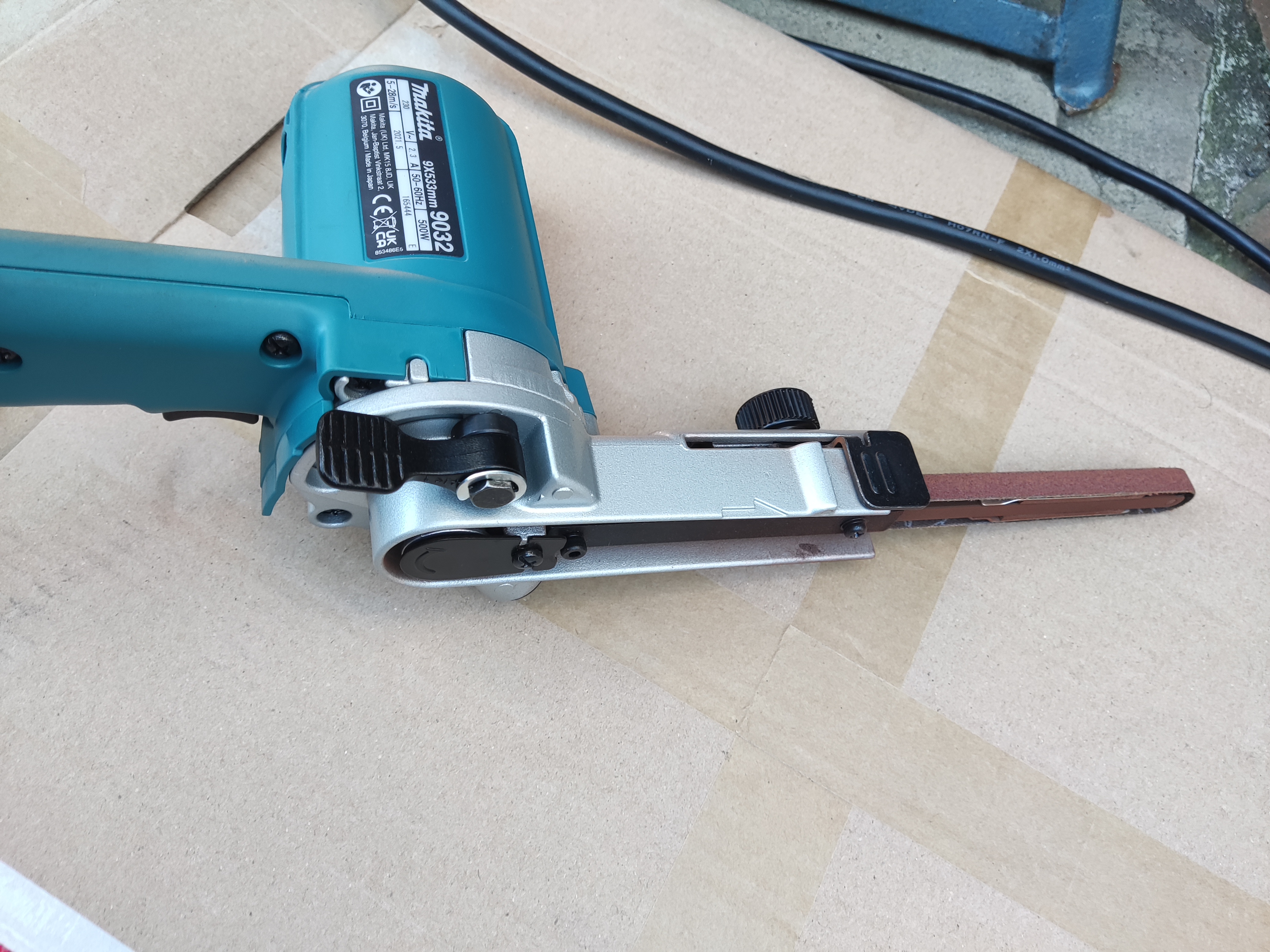

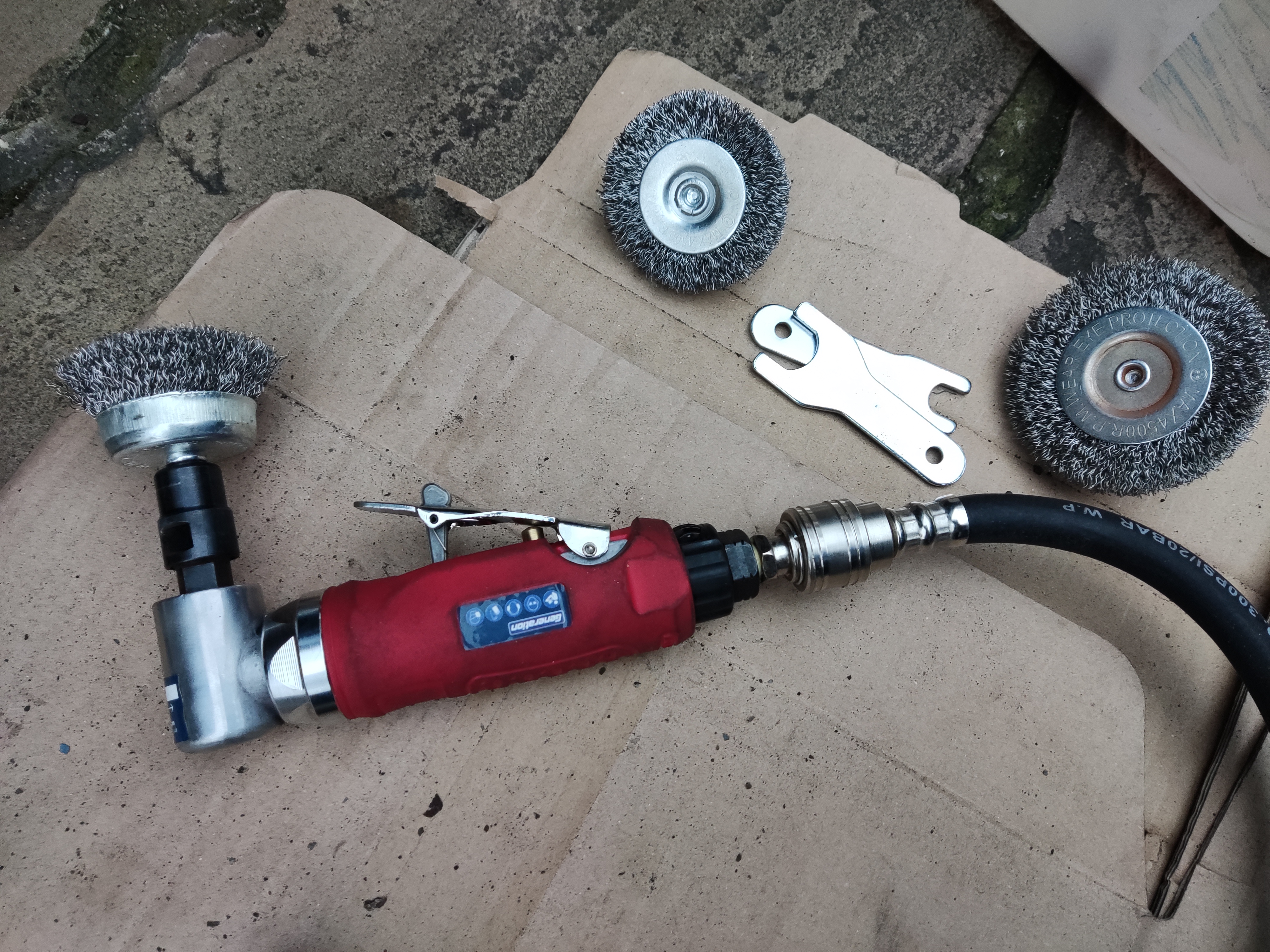

Sanding areas previously mentioned back to bare metal and applying a some Hammerite Kurust
A few of the tools I'm using:
First time I'm using the Makita file sander - cannot recommend enough, absolutely brilliant tool.
Also, manged to bend and flare the rear brake lines (not easy as quite hard stainless steel) ready for new HEL brake lines.

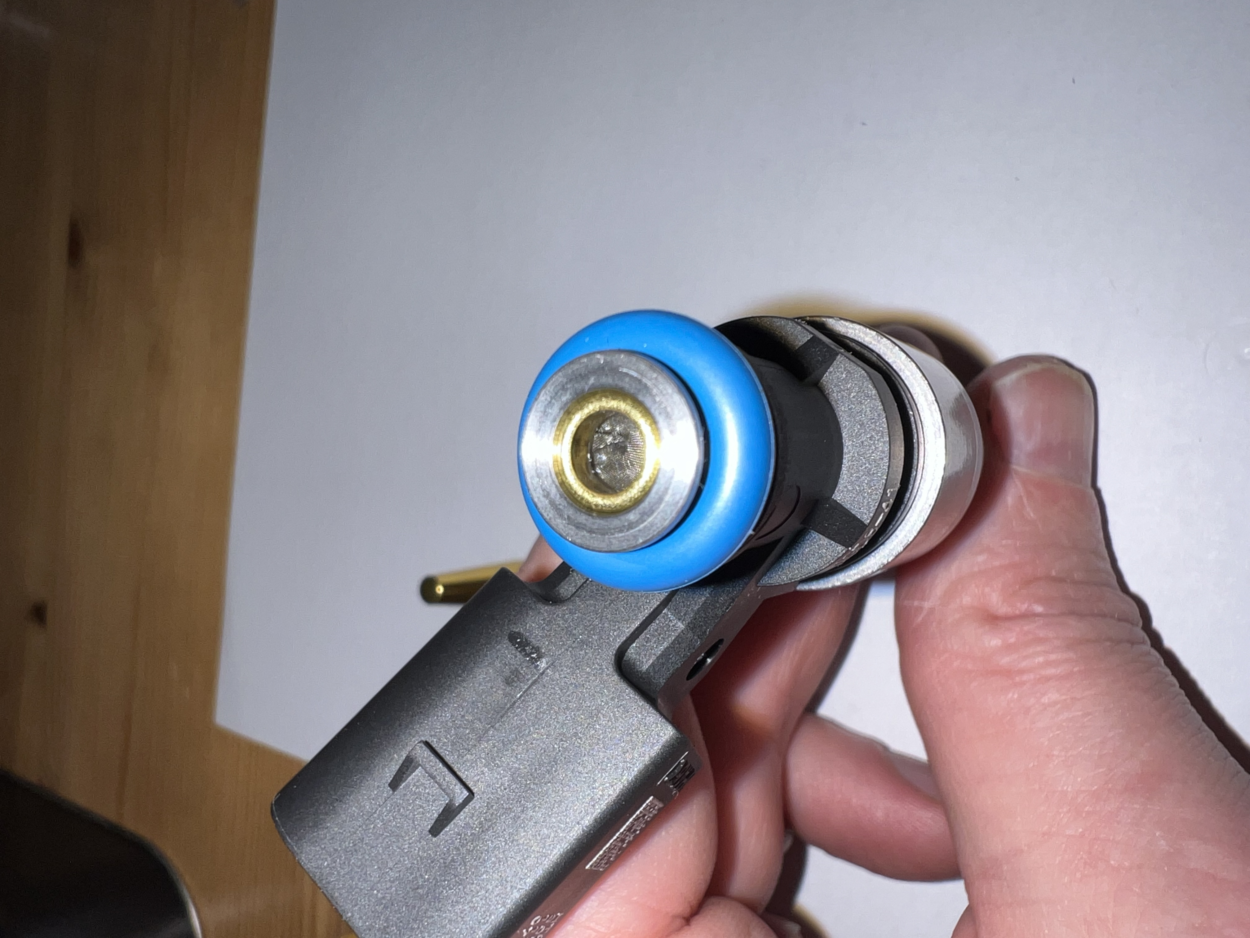

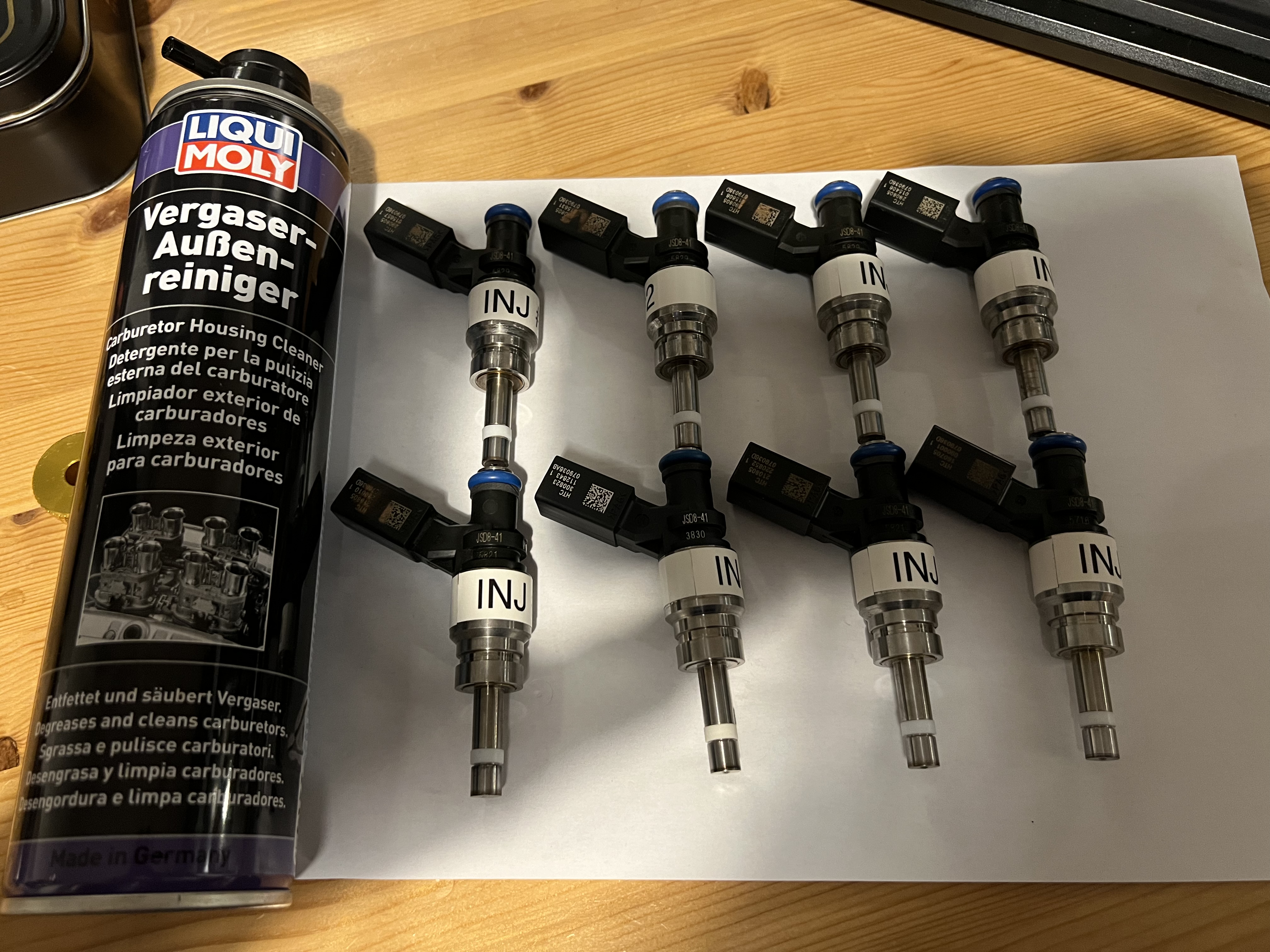

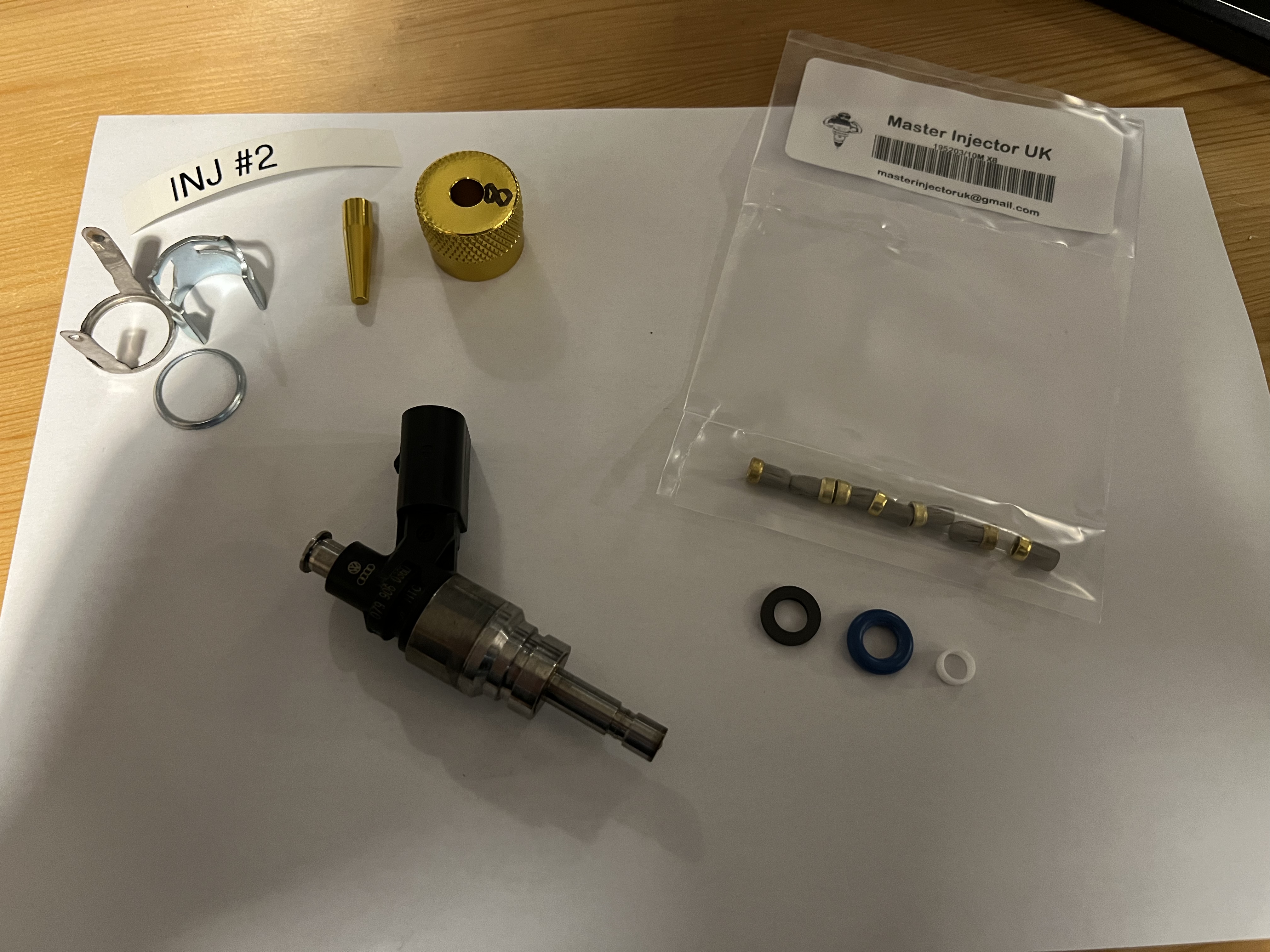

Interesting observation, the latest injectors from audi have the metal filters.
Injectors (and the new one) ready for flow testing with seal kits fitted and fresh filters. (Oh and my favourite carbon cleaning product, best of many i tried when doing carbon clean).

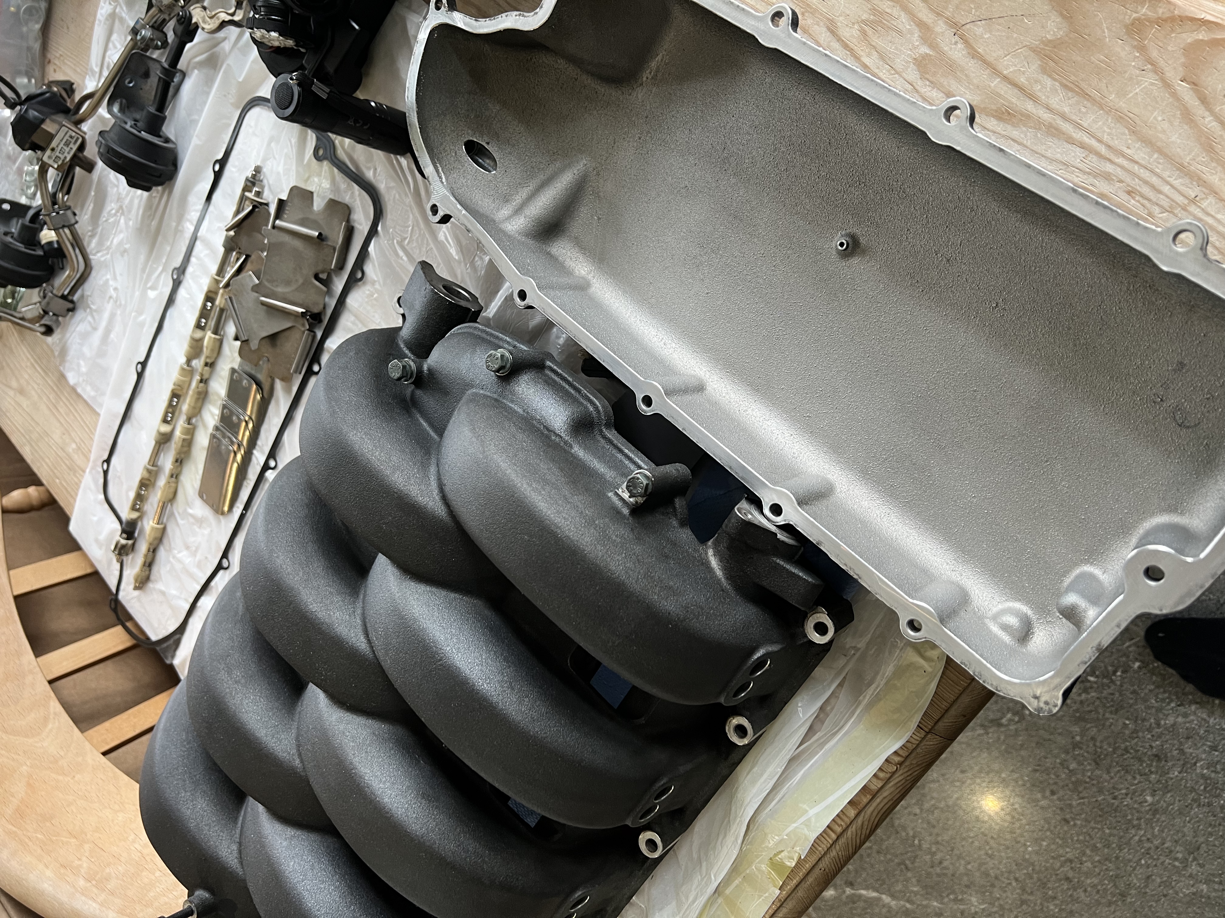

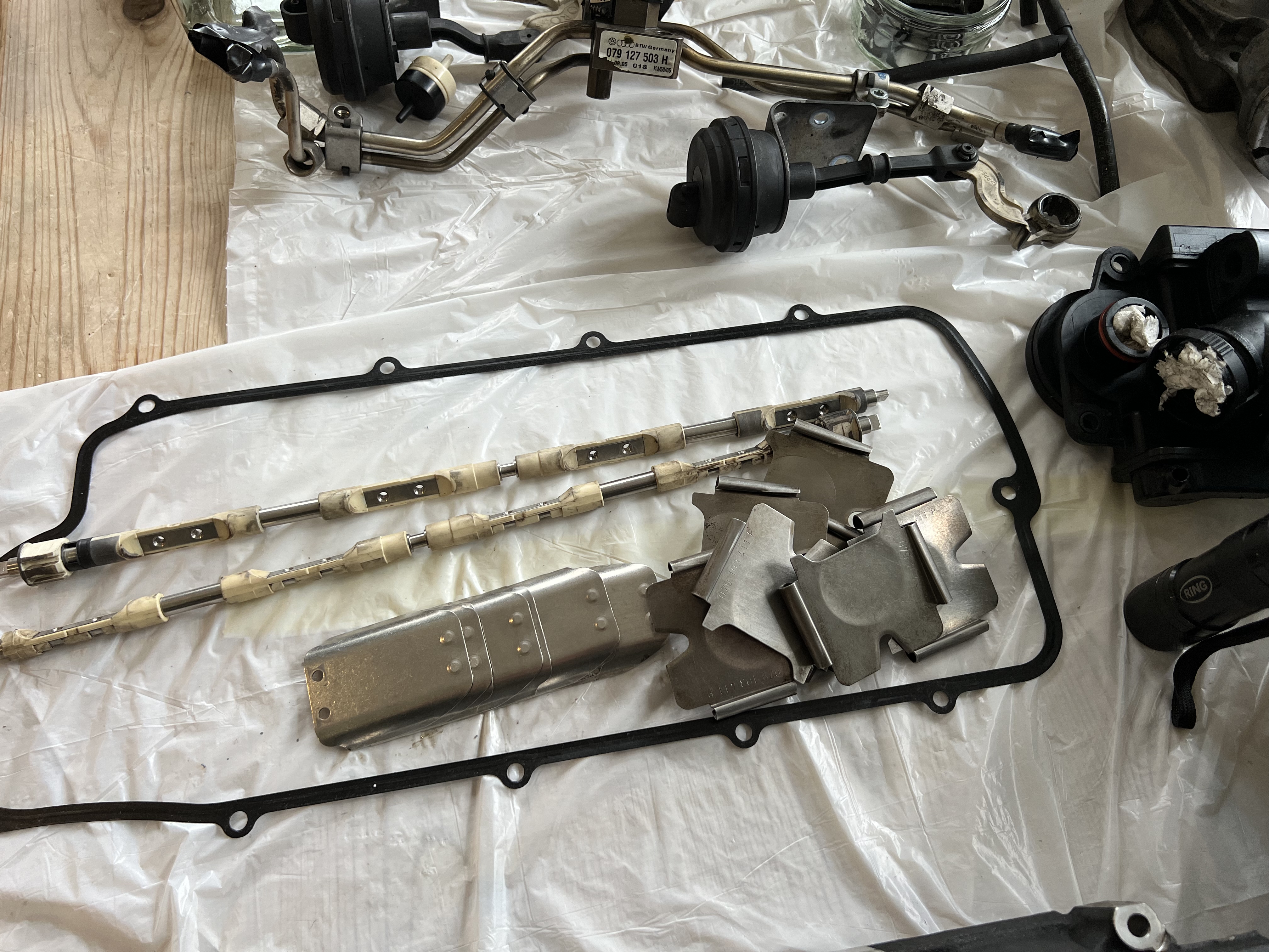

I'm doing another carbon clean in a few weeks. How are you using that Carb cleaner in the process?
lugars4
Posts: 320
Post by lugars4 » Sat Feb 03, 2024 11:12 am
I actually found this method best for me, contrary to many ideas of soak first.
I found soaking and digging about made a hugh gunky mess, harder to extract.
These were great, long picks. https://www.amazon.co.uk/gp/product/B07 ... UTF8&psc=1
  • Pick the heavy carbon off, dry, and hoover / blow it out. Gets maybe 50% off. Big chunks on mine.
  • Spray and pick / scrub with the Liqui Moly spray, gets its looking much better.
  • Blast with walnut shells. On inspection, there will be small areas that need a final spray / pick / blast.
  • Fishing off with a wash down with spray.
  • I walnut shell blasted all the metal flaps and even the inlet manifold internals (stripped down). Again finished with a wash down with spray.
  • The shafts from the inlet manifold cleaned up real easy with the Liqui Moly, its great stuff.

Post by JamesBaby » Mon Feb 05, 2024 10:24 am
Good work cleaning up the shafts. I detailed a similar procedure in my thread when I did my CC last January. By cleaning the shafts I removed the play that was in them so they functioned correctly. I also added the 034 Motorsport billet intake arms.
However I loctited the screws for the flaps in and the inlet plugs, so on my next carbon clean in a few weeks I won't be undoing them. I will get a chance to inspect the screws and flaps however to ensure they are firm etc.
