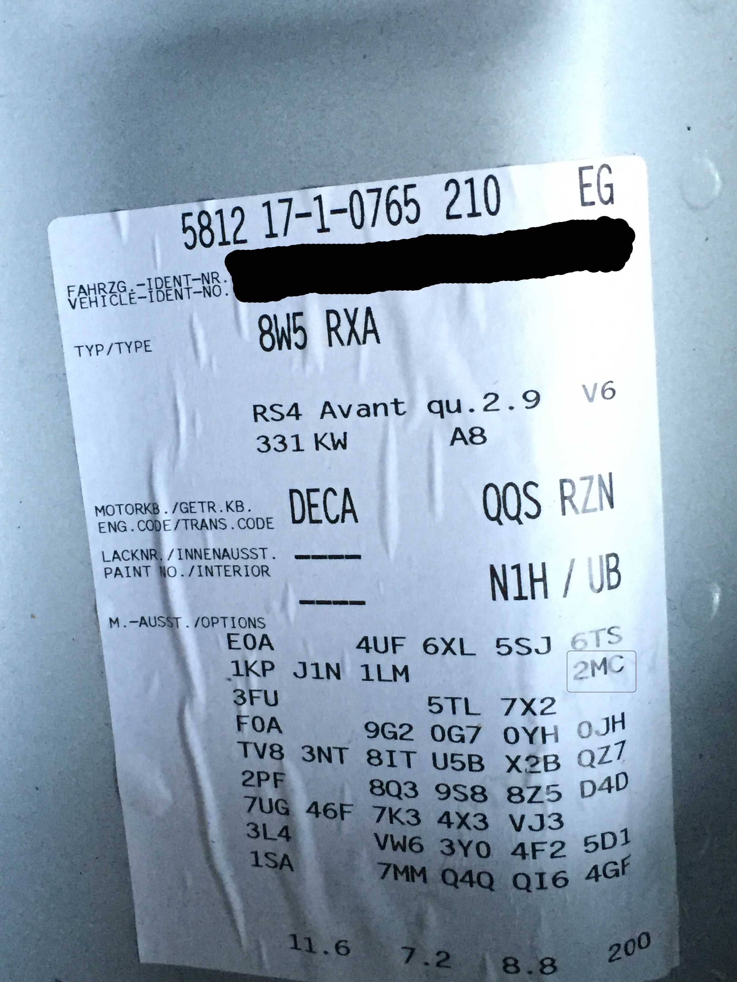

How would you identify a DECA engine?

To my knowledge all B9 & B9.5 6V twin turbo RS4's are DECA engines.
Check your build label found either in your handbook or in the boot under the floor tray.

So obviously I do have a DECA engine… having looked on the production label. I’ve also looked at a few YouTube videos on the early rocker arm issue that makes grim viewing.

If you ask Audi they should be able to tell you what type of rocker arms you have on your engine following back the info on the build record
Worth a try
