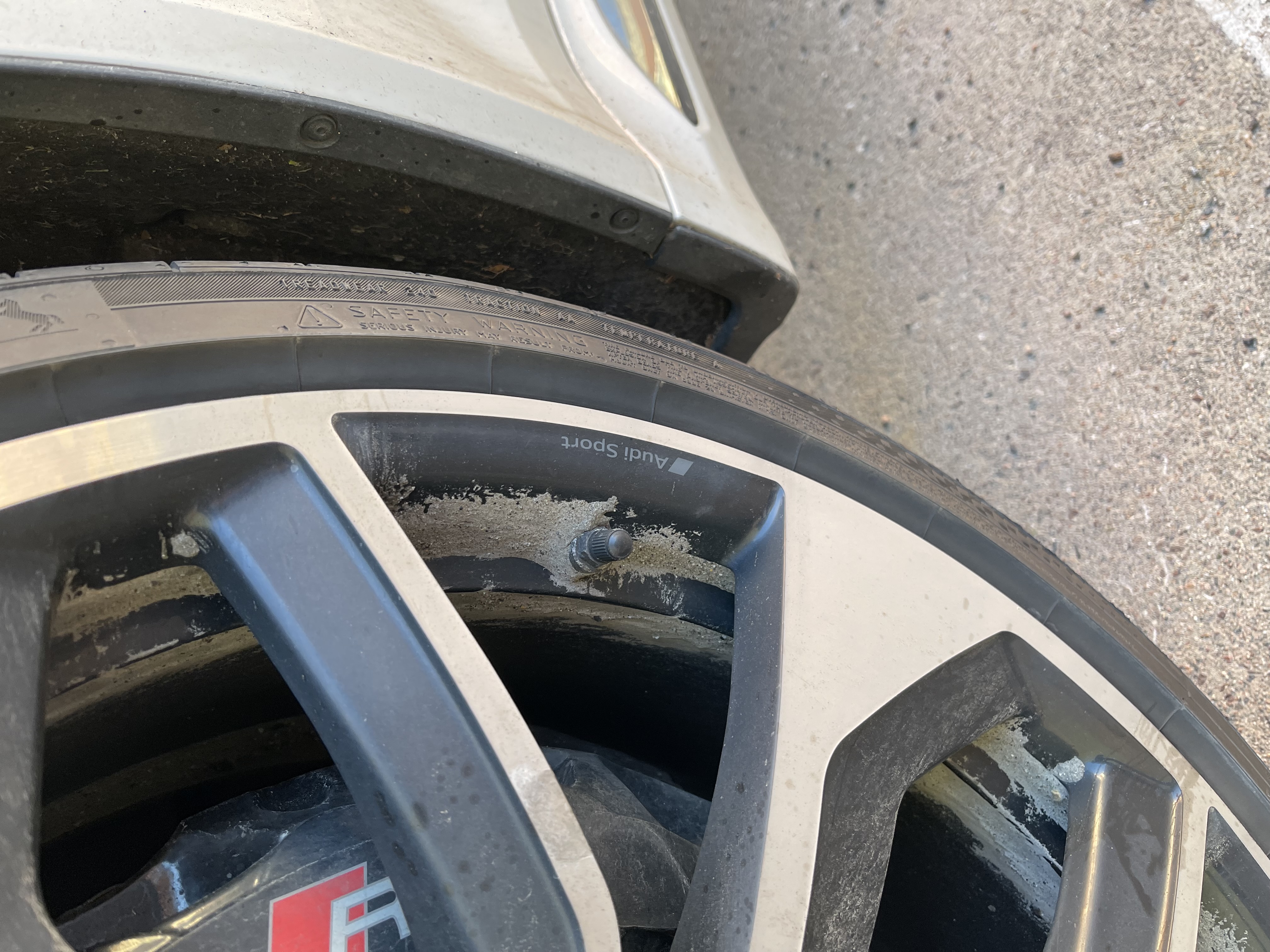

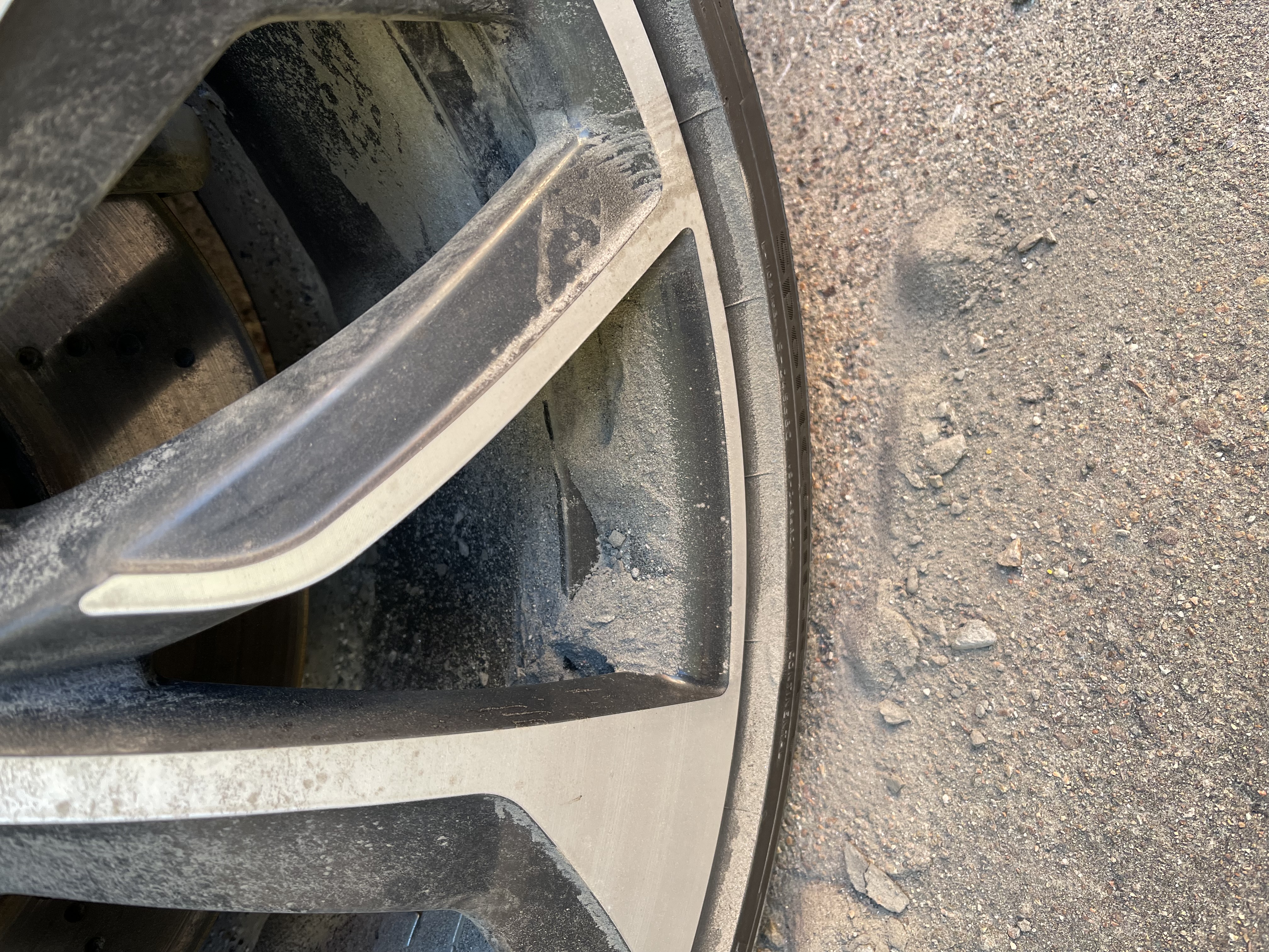

I've recently come back from a 5000 mile road trip up through europe to Norway and Sweden.
At one point on the way back I notice a wheel wobble that resonated at 80mph (130kph) at which point I thought I had lost a wheel weight, no biggie.
Any how when we stop at our hotel for the night I check the wheels and find I've not lost a wheel weight but have got a build up of very fine road dirt stuck in the groove behind the spokes of the wheels. Also a ring of the same around the inner edge of the barrel of the wheels too.
I brushed the offending dirt build up off the wheels and the following day the wobble disappeared!

How bizarre. What was it?

The amount of unequal build up of dirt, mainly around the valves was throwing the wheels out of balance!

Looks a bit like cement or something, to be sticking like that. Might be worth a look under the car as well if you can.

Yep, that will do it. Did it come of easy enough without staining wheel

We did drive through a number of road works, it was not cement dust but a very fine road dust that ended up as a light coloured mud that stuck itself unevenly to the wheel rims as it dried.
It all brushed off with a little effort.
