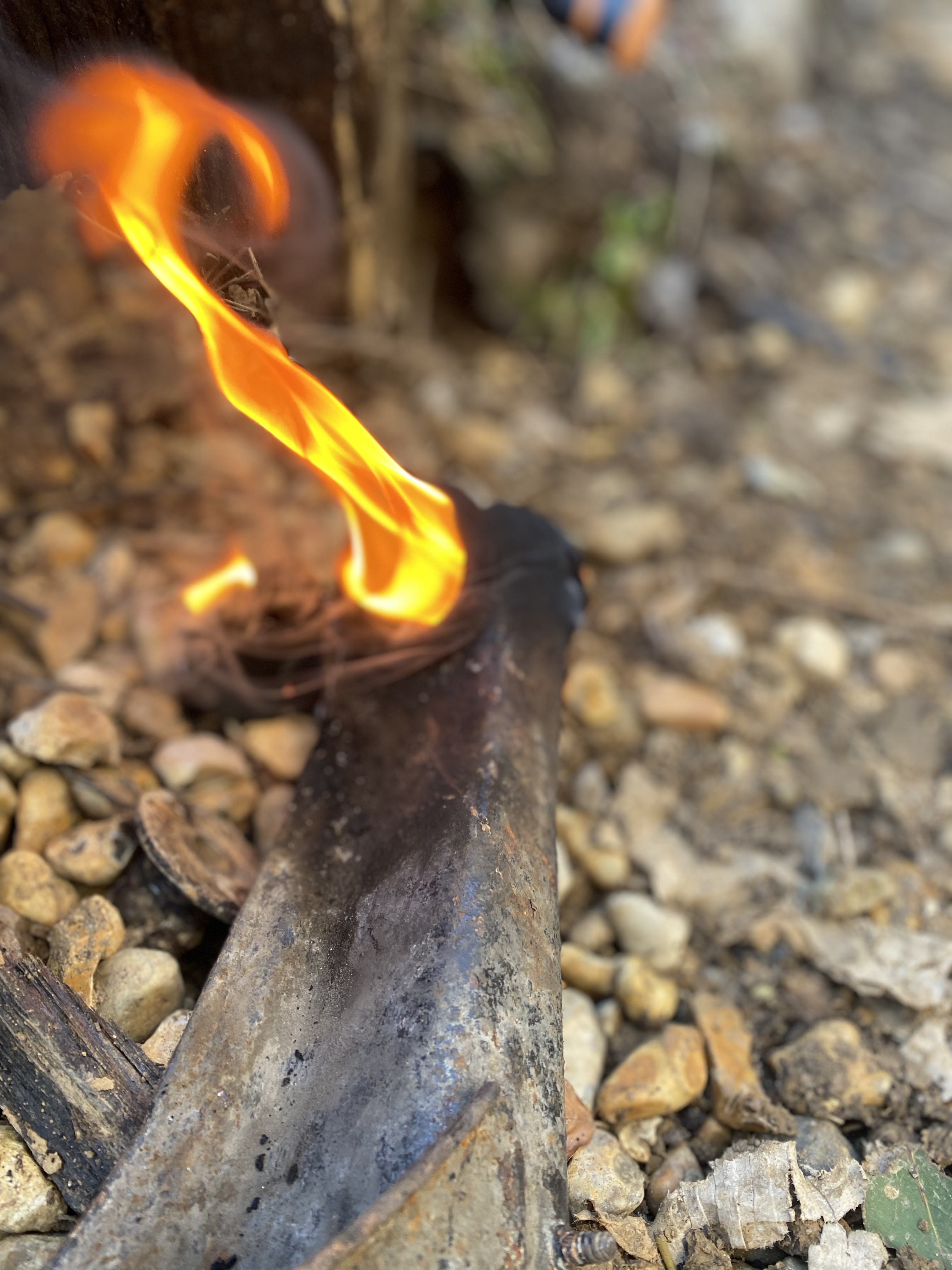

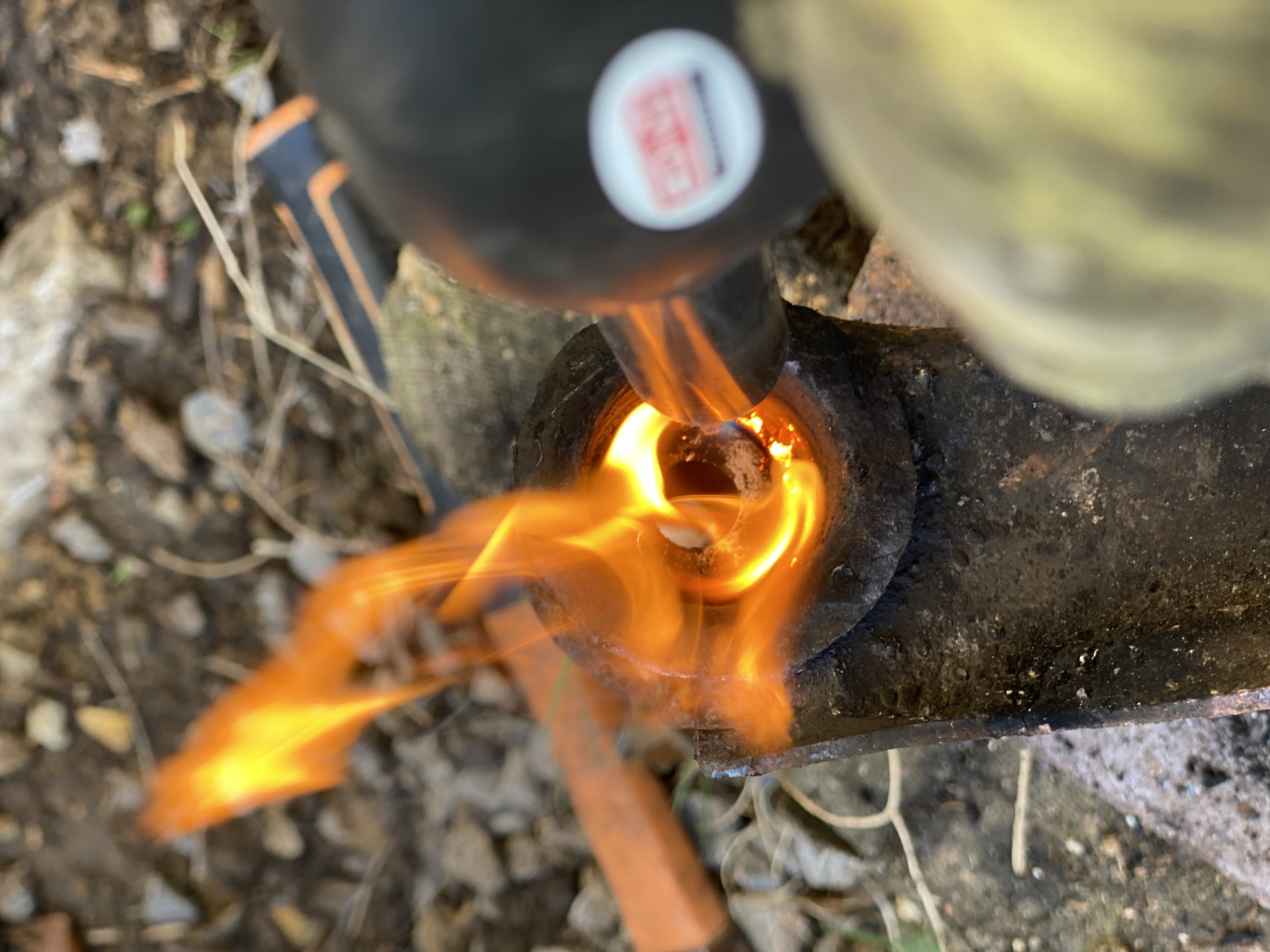

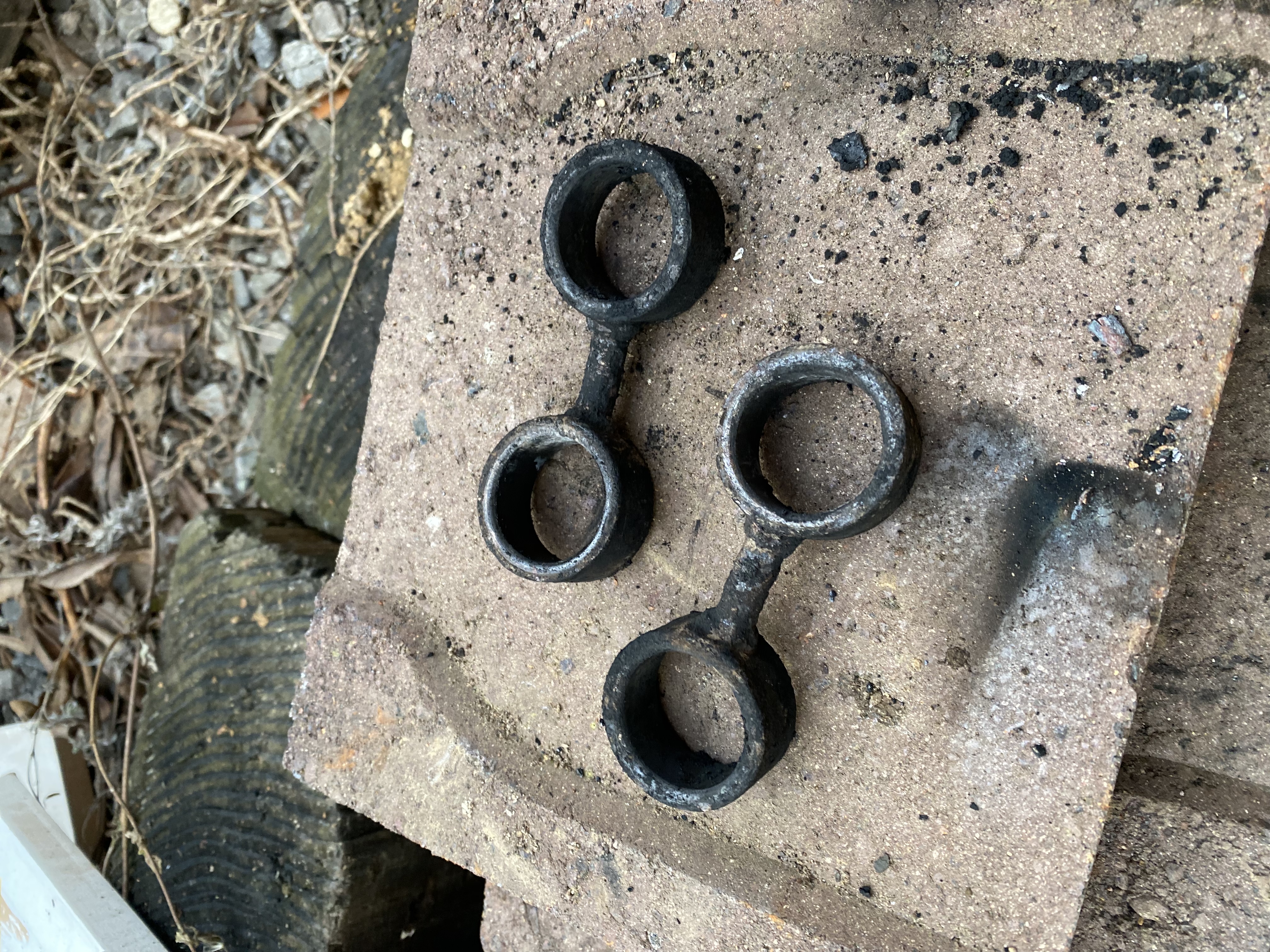

I made a little more progress finally removing all the bushes from the upper and lower control arms along with the ARB links. Big thanks to Matt who has been reply to my texts asking for help. 👊

It's not often I get an opportunity to tell people to "burn it with fire"
ChrisA
Posts: 810
Re: Rear end suspension rebuild
Post by ChrisA » Sun Feb 26, 2023 7:42 pm
You were very enthusiastic with you encouragement to perform said tast. 🤣
Mɐʇʇ
Posts: 2727
Post by Mɐʇʇ » Sun Feb 26, 2023 7:44 pm
Made even better by the fact that I was telling a fireman to burn it with fire.

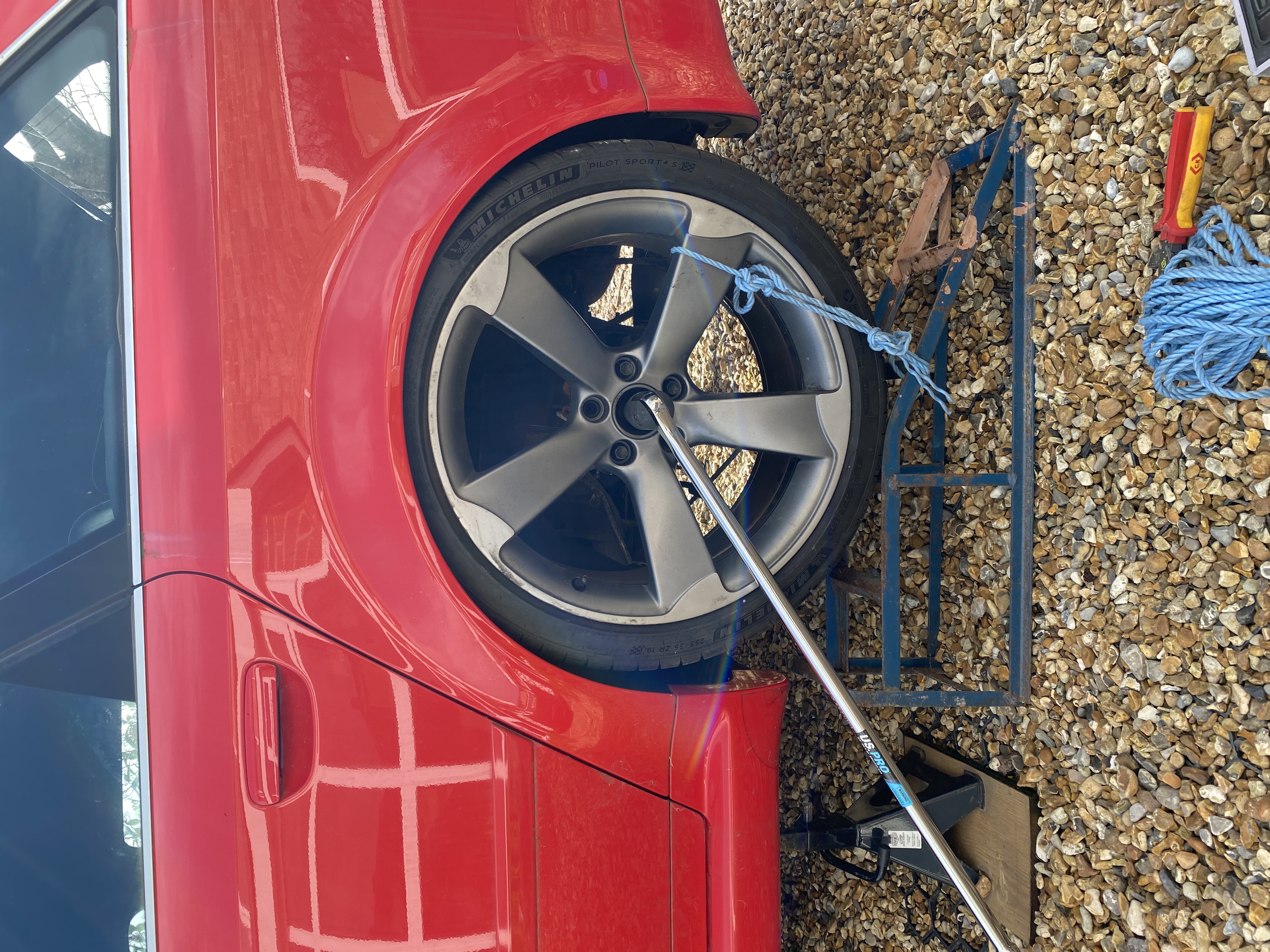

When your refurb goes further than you intended and you realise you should have to loosened the collar before taking the coilovers and control arms off. Improvise, adapt, overcome!
Big thanks again to Matt!!! 👊
