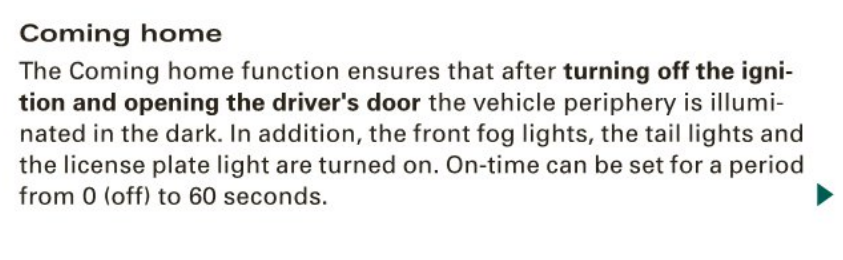

Having checked owners manual I beg to differ Ian....

Post by ATinOf » Thu Jan 19, 2023 9:46 pm
So does this feature still work with the TRUPS mod?

Post by Jim Haseltine » Thu Jan 19, 2023 11:24 pm
A closer look. It was both the fogs and the DRLs at the front but appeared to be low intensity. I also noticed that the lights were triggered by either of the front doors opening.

Post by IanH755 » Thu Jan 19, 2023 11:48 pm
Jim - I suppose mine could be different after the Trups mod but mine are definitely the headlights, not fogs, for the courtesy lights.
EDIT - Talking rubbish Ian, it IS the fogs which light up!
