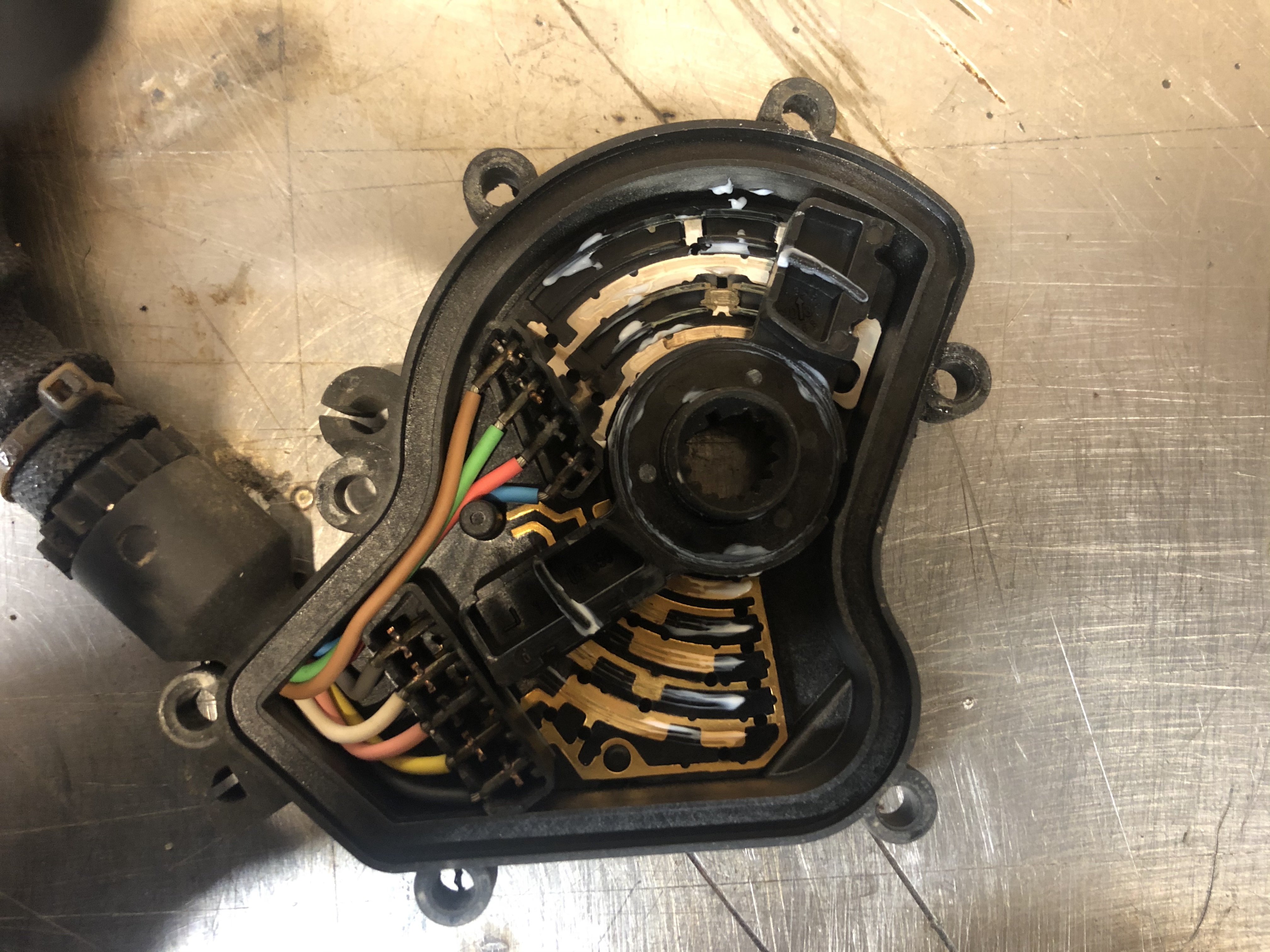

Here's the inside of my failed one, too. I assumed it was pin 8 that was causing the error?
Did consider cleaning it up & refitting - but the cost of the the switch compared to the aggro of replacing it wasn't worth it.
