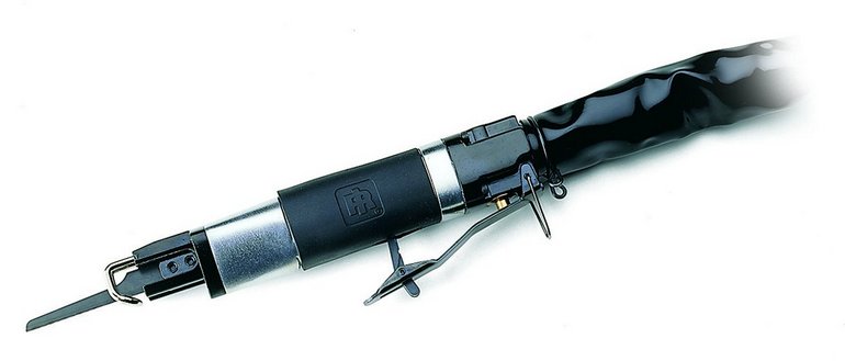

I fired up my air hacksaw:
...and carved off a goodly chunk of the 'wing'.

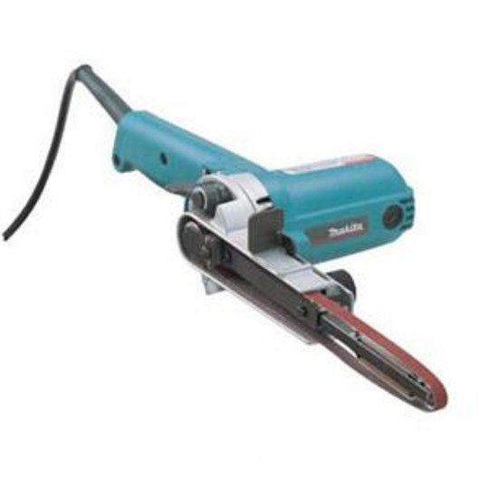

I then tidied up the raw edges and removed more material with my electric power file:
I undid the two Torx bolts holding the switch onto the transmission, and after a bit more strategic grinding of the bracket, it wriggled out quite easily.
