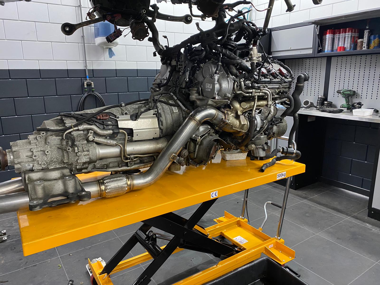

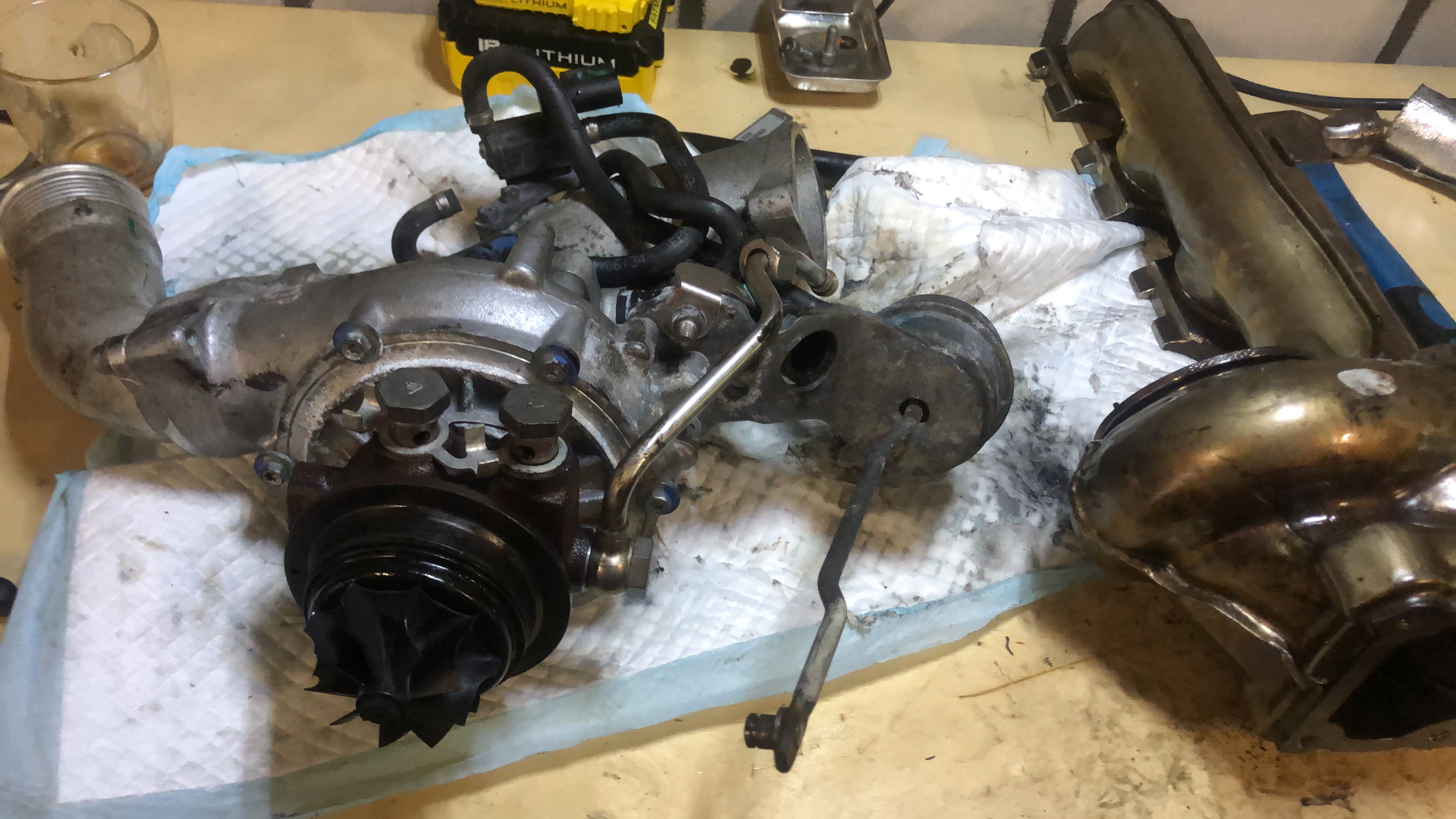

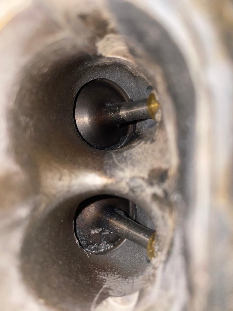

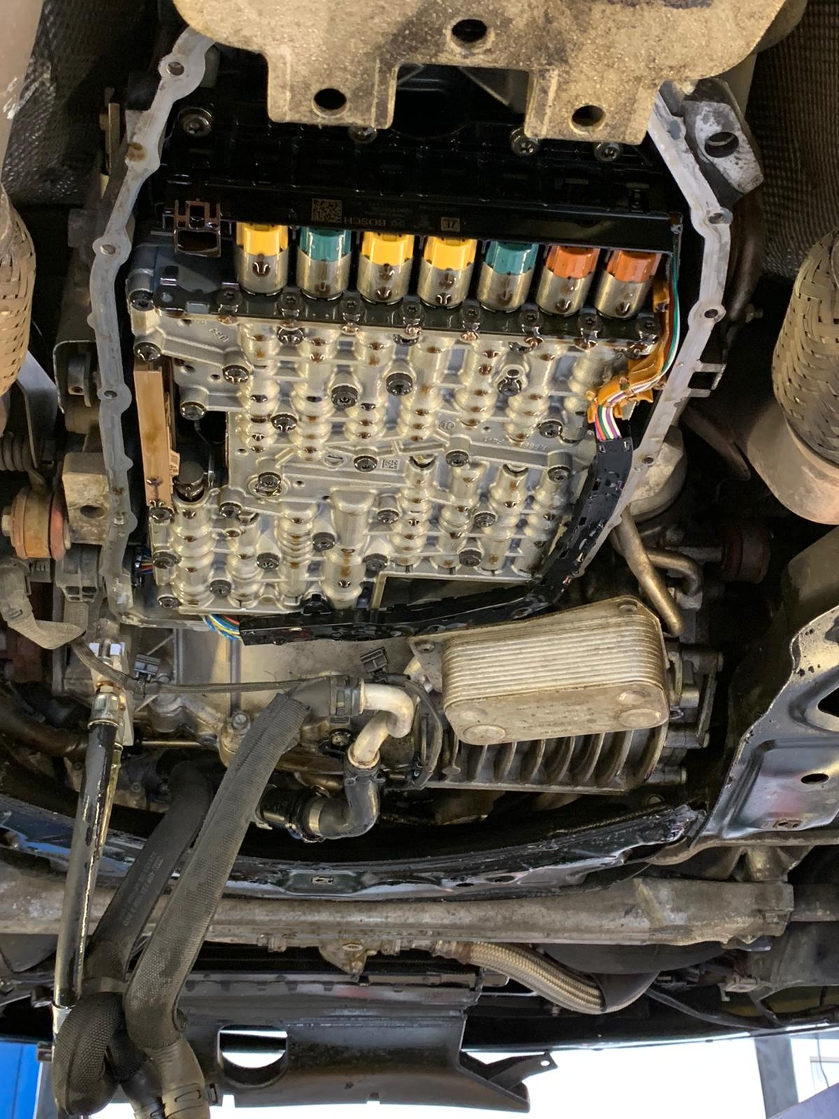

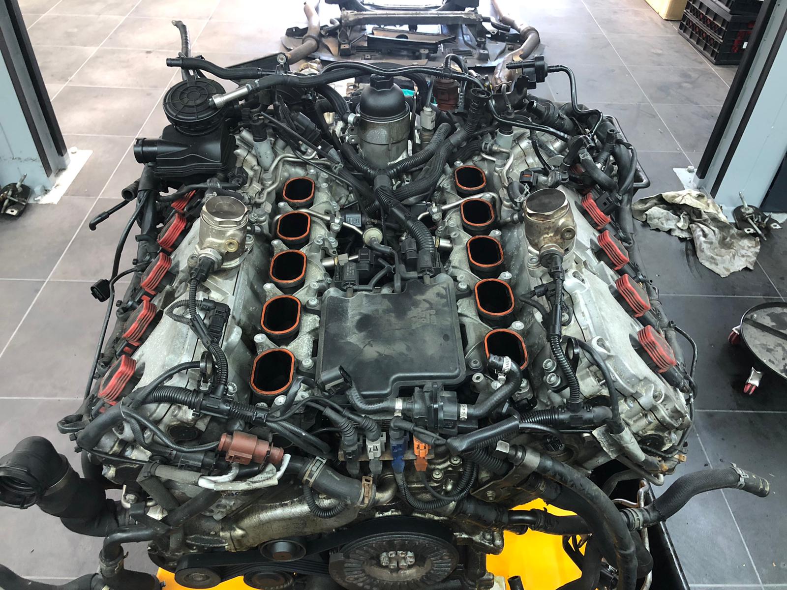

Hi and welcome to the C6 family! Compression test is a serious good idea, outer cilinders are fragile to overheating and cause piston ring/cilinder wall damage. Also check if the PCV is in 100% working order (some hoses can break or leak). I worked on one engine with a broken off PCV hose, just before the collector and this caused catastrophic failure since they just kept driving with it. If car has ceramics, check the ceramic wear indicators on the disks to see how far they have worn out. (Check google for images). Also just the pads - if ceramic will set your back 1100+ dollars for all 4 if they needs replacement original Audi.VaudiGR wrote: ↑Sun Jul 18, 2021 8:52 amHello group!
After owning an audi rs2 (tribute) for more than 15years ending up knowing the ins and outs of the car, mapping It myself and producing around 500hp I'm going to make the leap to the C6 scene.
After reading through gently about the car, I have a few options locally, from a genuine stock car to a few modded mtm versions.
I'm either considering a stock version with around 100 to 140k km on the clock and then going for wagner ICs and a map OR get a 730hp mtm version.
Questions.
Would an already modded mtm version have already overstressed the turbos and therefore might not be a good idea?
Other than the usual culprits oil gasket leak, smoking turbos, is there anything else to look out for?
I plan obviously a full inspection and compression test before buying.
Many thanks
Vas
Please also peek into the “V” of the 10 cilinder, between pipes of the air intake to see if there is oil on top there. Just like the o-ring, the head oil cooler also has rings that can dry out. I would recommend taking into consideration that almost all C6 need engine out jobs eventually, if this has not been done before with proof in form of pictures and invoices. Some have minor-minor leaks, some mayor - just like the dentist the chair is inevitable. Cheers from Holland! - oh and some pictures.
