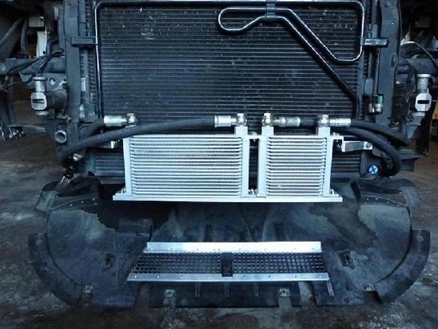

I have seen the single dual cooler replaced with a pair of generic mocal or similar coolers. There's a couple of variations on the packaging, but this is one example (albeit not the actual one I was looking for). I reckon you could learn from this install and probably do a mk2 version that's a little cleaner.
If/when my oil cooler actually gives up the ghost, I'll probably do something like this.

I had mine done like that when I was replacing engine

I emailed Audi today and cooler is available albeit from factory on back order so no idea when I would get it but no hoses available now from Audi. Checked else where and only one that comes up is the hard pipe along the lower front, everything else is unavailable so only option will be to either make the hoses up myself or find a company who can make them for me, it's never easy. Or, I like the other options listed, Viper, am I correct in thinking you have already fitted the option that you've posted and if so do you have any detail on the coolers and hoses? Has this set up affected the engine temperature as it blocks a fare bit of the radiator although I appreciate the air will go through the oil coolers it will warm the air or has it made no difference to temperature? Has anyone else got any detail on the upgrade options shown in the post?

I'm afraid I don't have much details on the cooler and hoses - the guy doing it in Poland put this together. I'll see if I can dig something out.
Been driving it now for 3 years with this setup - no problems with temps at all, even in the hottest days.

I can see that photo was from before they swaged the ends on. Torques UK will have field assembly fittings that can fit all those coolers so would be easy to DIY.

That install V!per has is very clean. I suspect the guys in Poland clamped the hoses together near the bottom with a nice clamp/seperator too and it'll be spot on.

Got some more pics on how it's put together - bit of welding of the brackets by the guys themselves. Not much more details about the coolers I'm afraid. I can give you the size of one of the coolers - 5cm Deep, 14cm long and 30 cm high(that's one )
You can se there is 2nd cross bar mounted close to the bottom of the coolers.

I’d replace those fasteners with stainless ASAP.

First thing I thought when I actually saw it today :biggrin3: :biggrin3:
