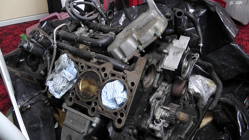

I'm in a happy place where my RS6 requires no work..at all! I have had a spare complete AZR engine for the RS4 since 2015 and it's about time it was refurbished and waiting to be used. It ingested a foreign object in the PO car and did a piston and lightly scored the bore of No 6.
A quick strip down. Very lucky to have all the more unusual tools to hand so it was a very easy task. Surprisingly the bearings exhibited a little wear which is a bit unusual but the crank was perfect.

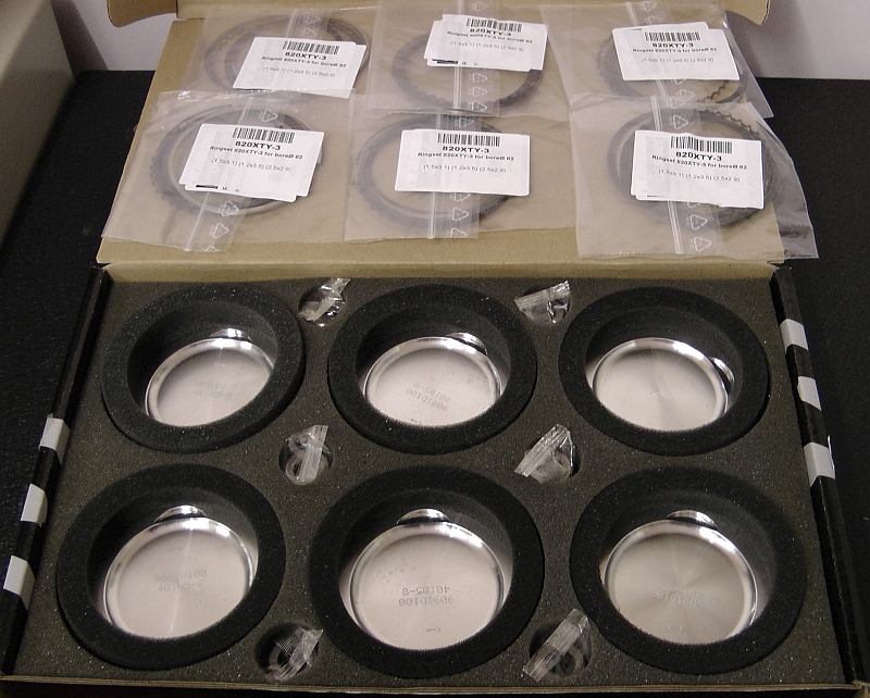

The block is now ready to head off for machining. I'm have 82mm Woessner pistons ready to go. All expectations are that machining will remove the score and other superficial damage. I have most parts for the rebuild, bearings, full set of ARP studs, new turbos, new heads, loba cams, most seals and gaskets, tube manifolds and so on. Just a matter of joining the various queues for machining etc.

Woessner 82mm pistons
