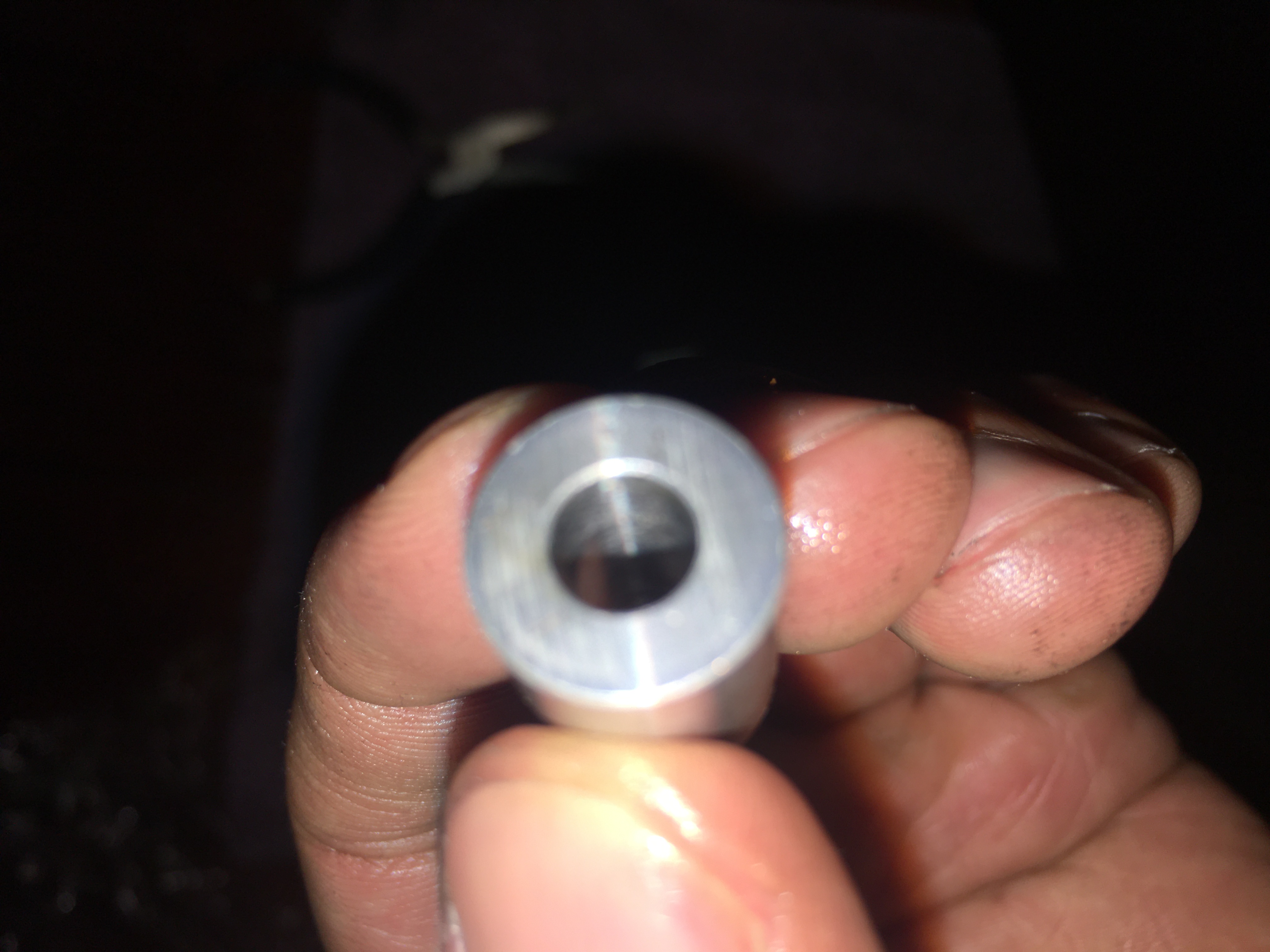

I used a little pick to get the rubber tubes out like the ones you use for oil filter seals works fine just be careful no to scratch the bores!
