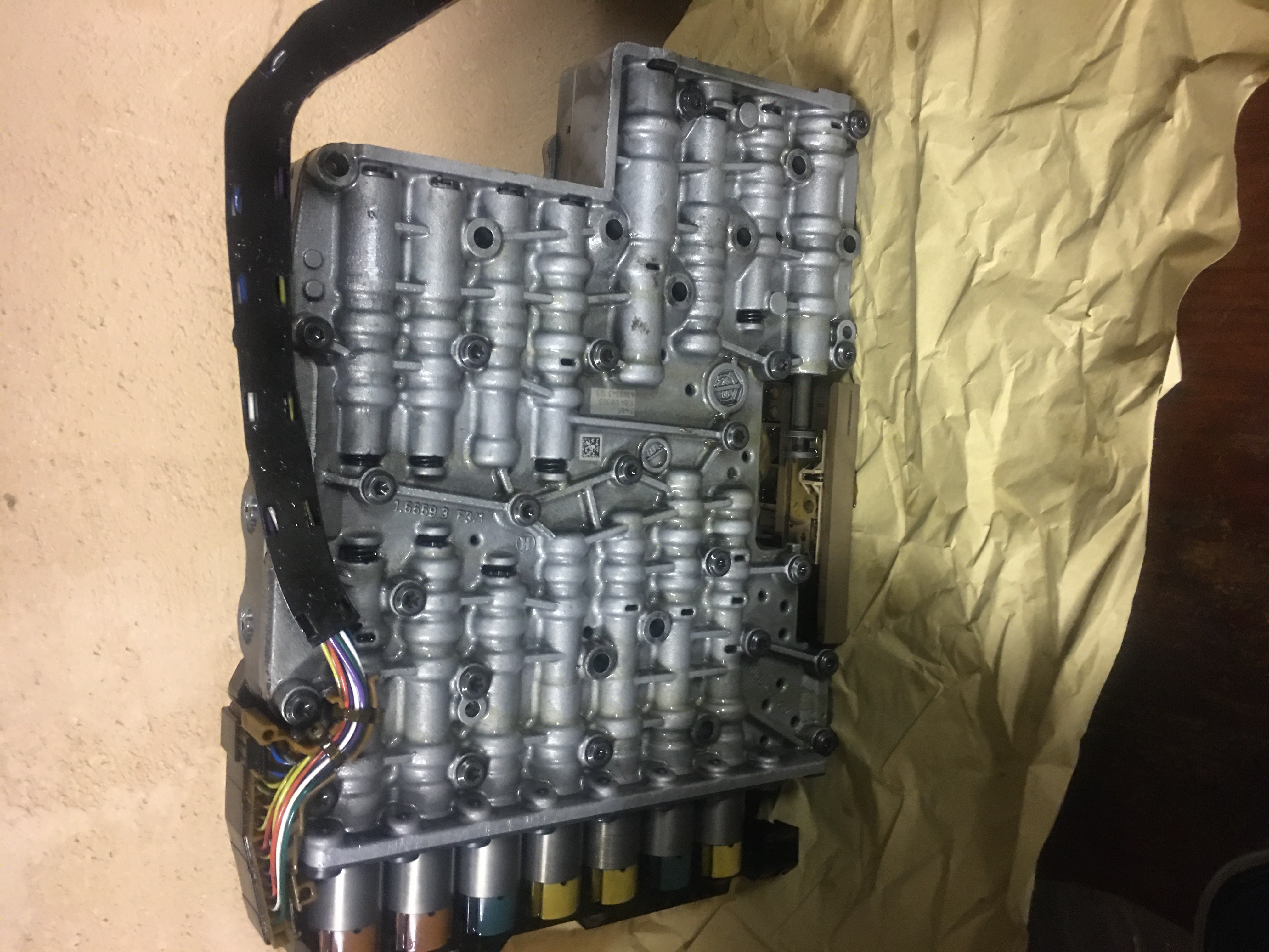

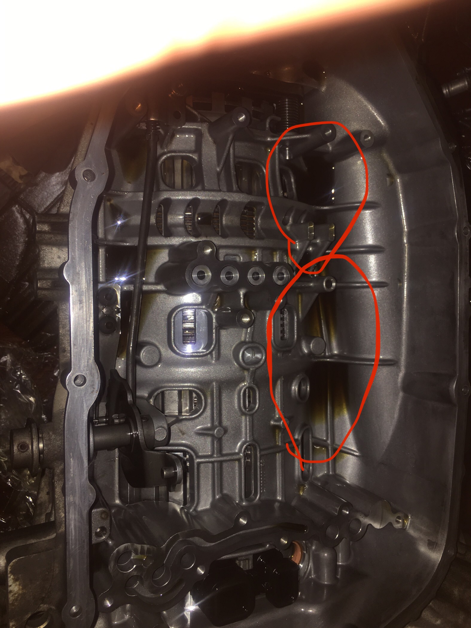

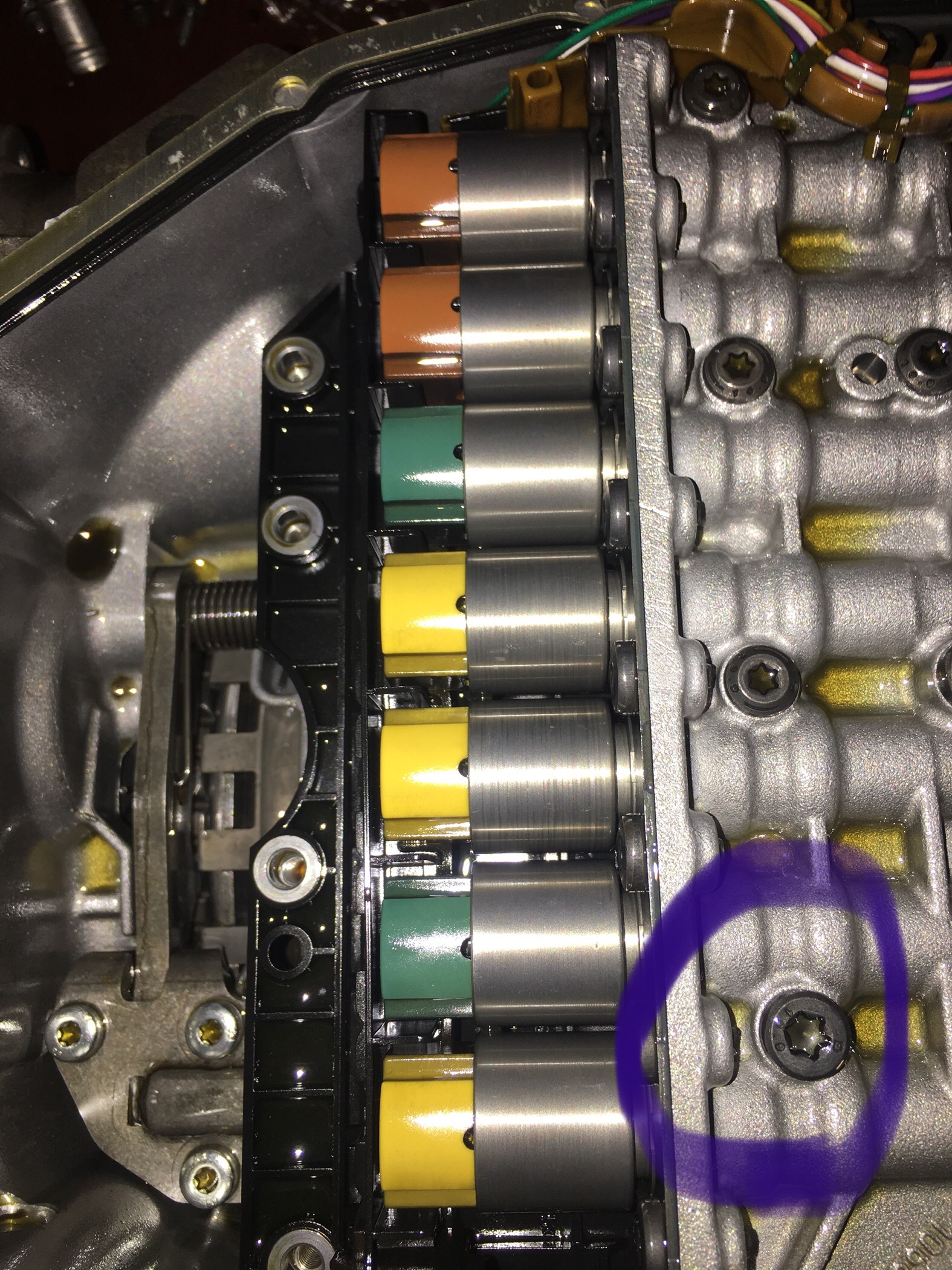

Above I said the mechatronic unit wouldn’t come out as I thought it was catching on selector I was wrong it was just stupid me left one bolt 😂
RS_BROKE
Posts: 59
Joined: Wed Feb 14, 2018 12:10 pm
Re: Gearbox Teardown & Refurbish - 6HP28A61
Post by RS_BROKE » Tue Dec 01, 2020 10:50 pm
As At said make sure not to scratch the mating surfaces I used some bubble wrap.

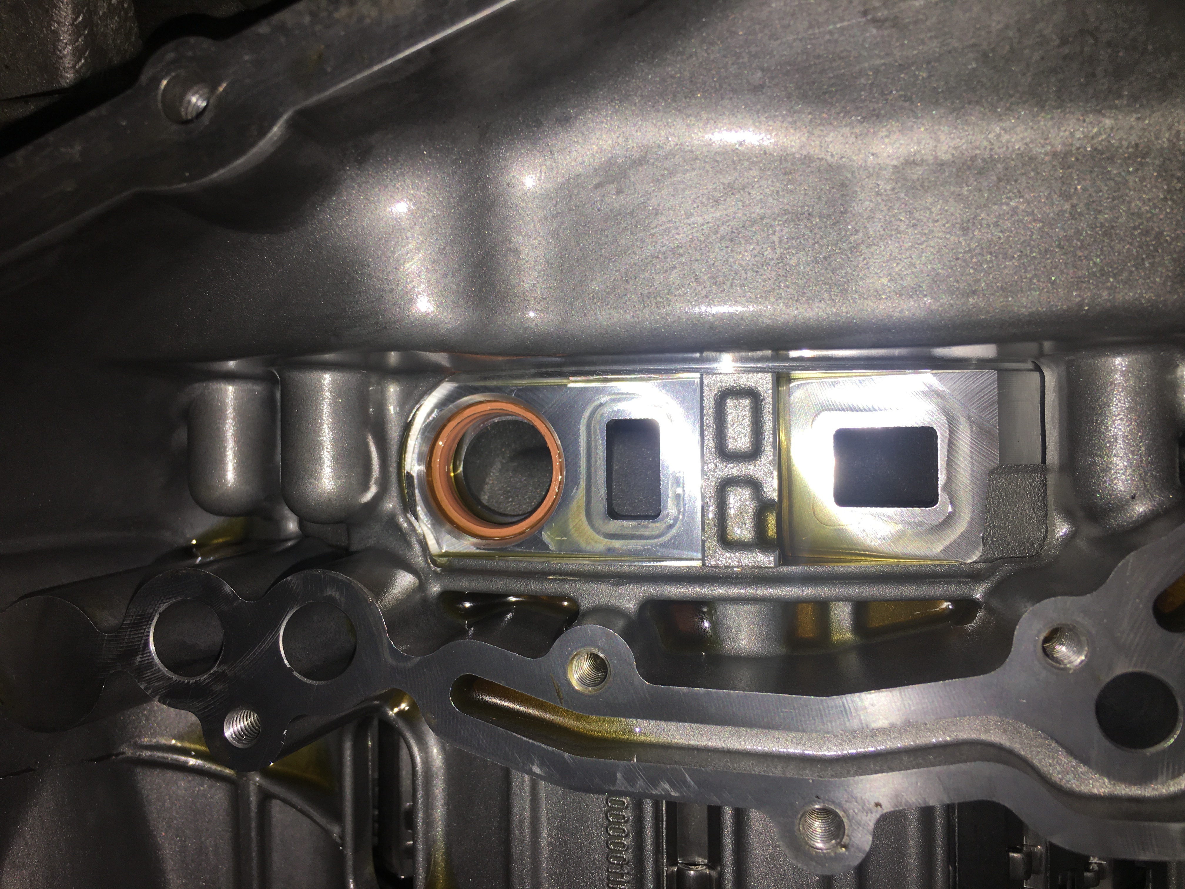

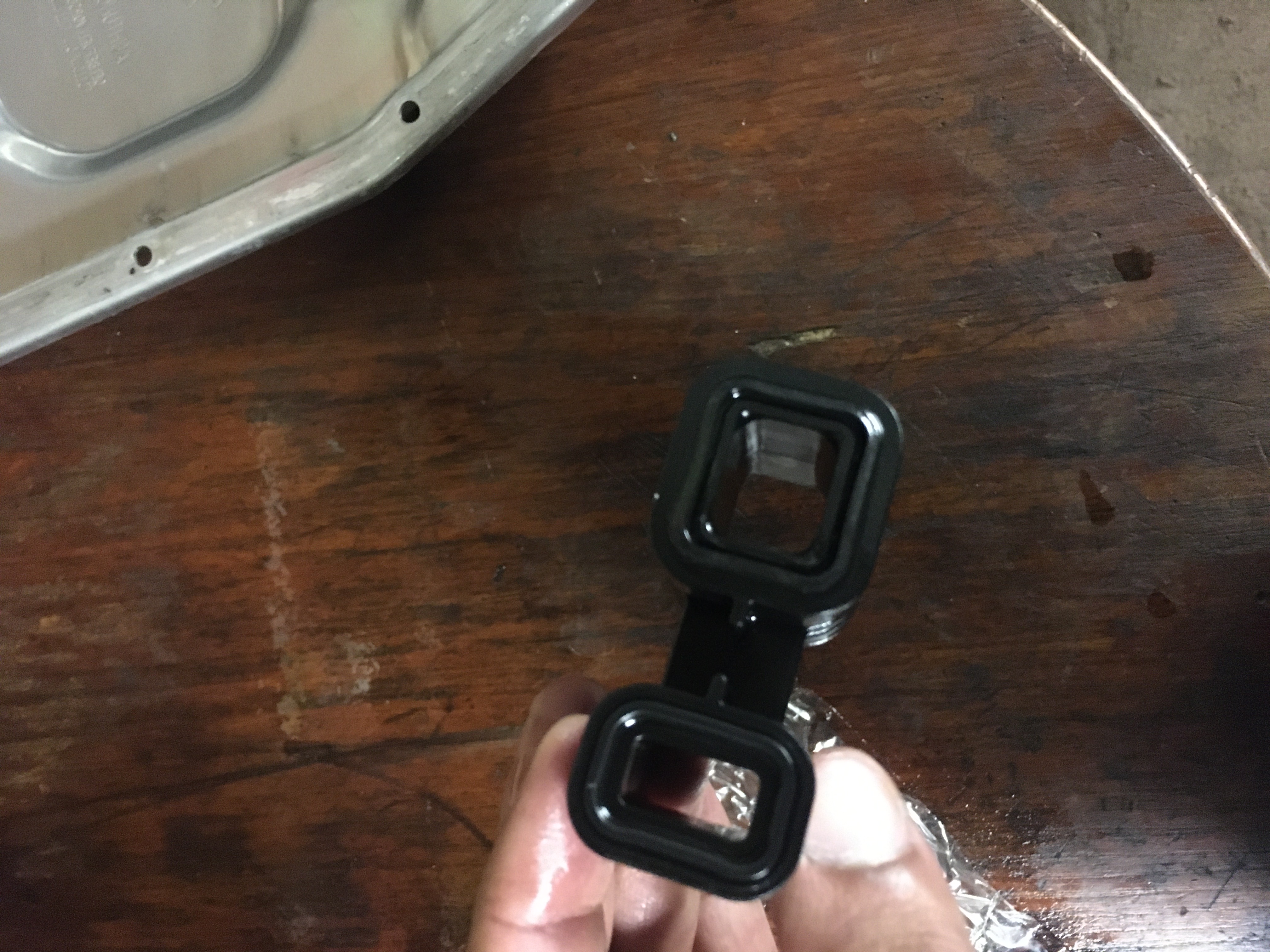

Post by RS_BROKE » Fri Dec 04, 2020 10:39 pm
Double oil seal looks good

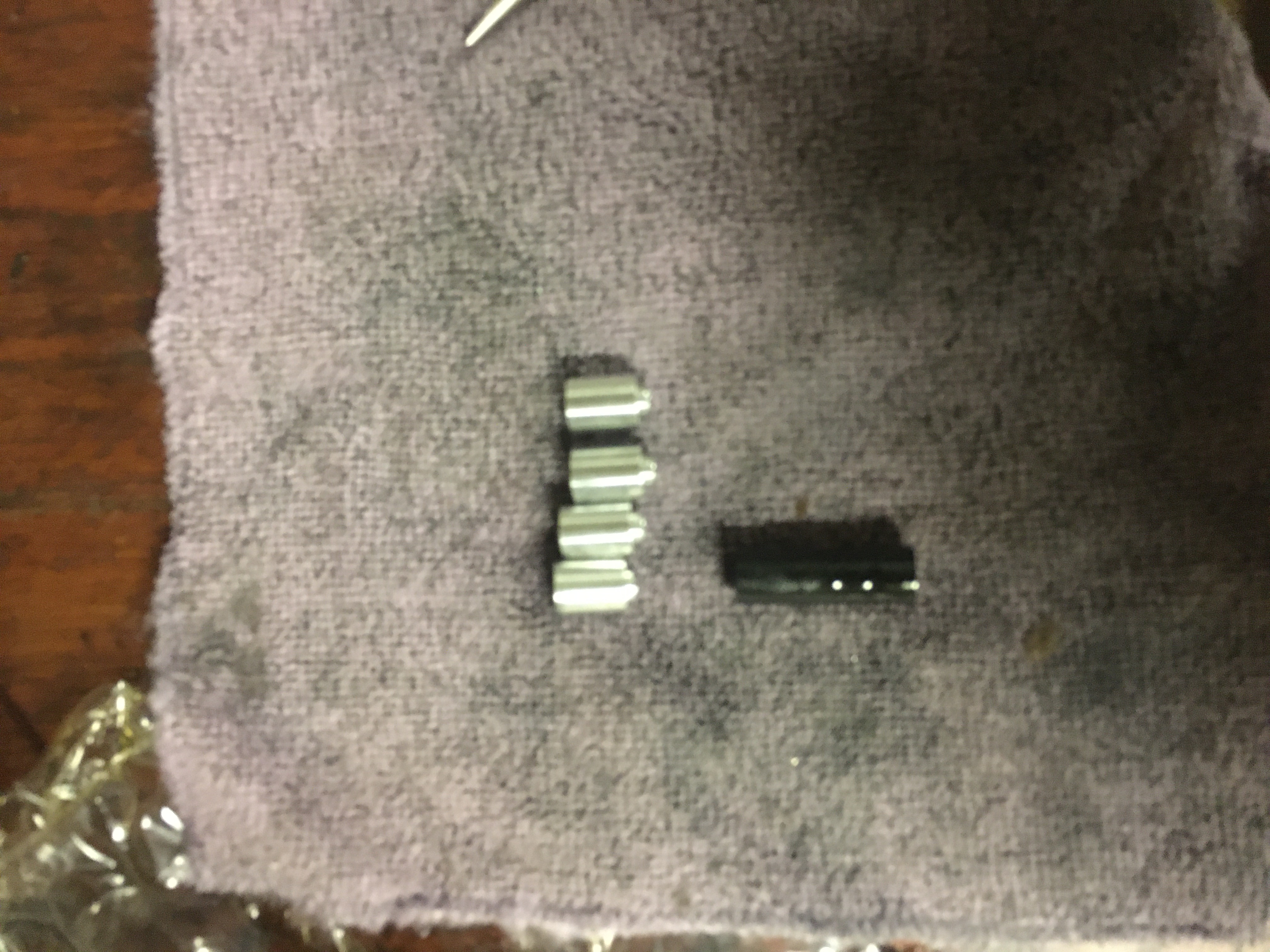

Post by RS_BROKE » Fri Dec 04, 2020 10:40 pm
These do look scored inside and the top

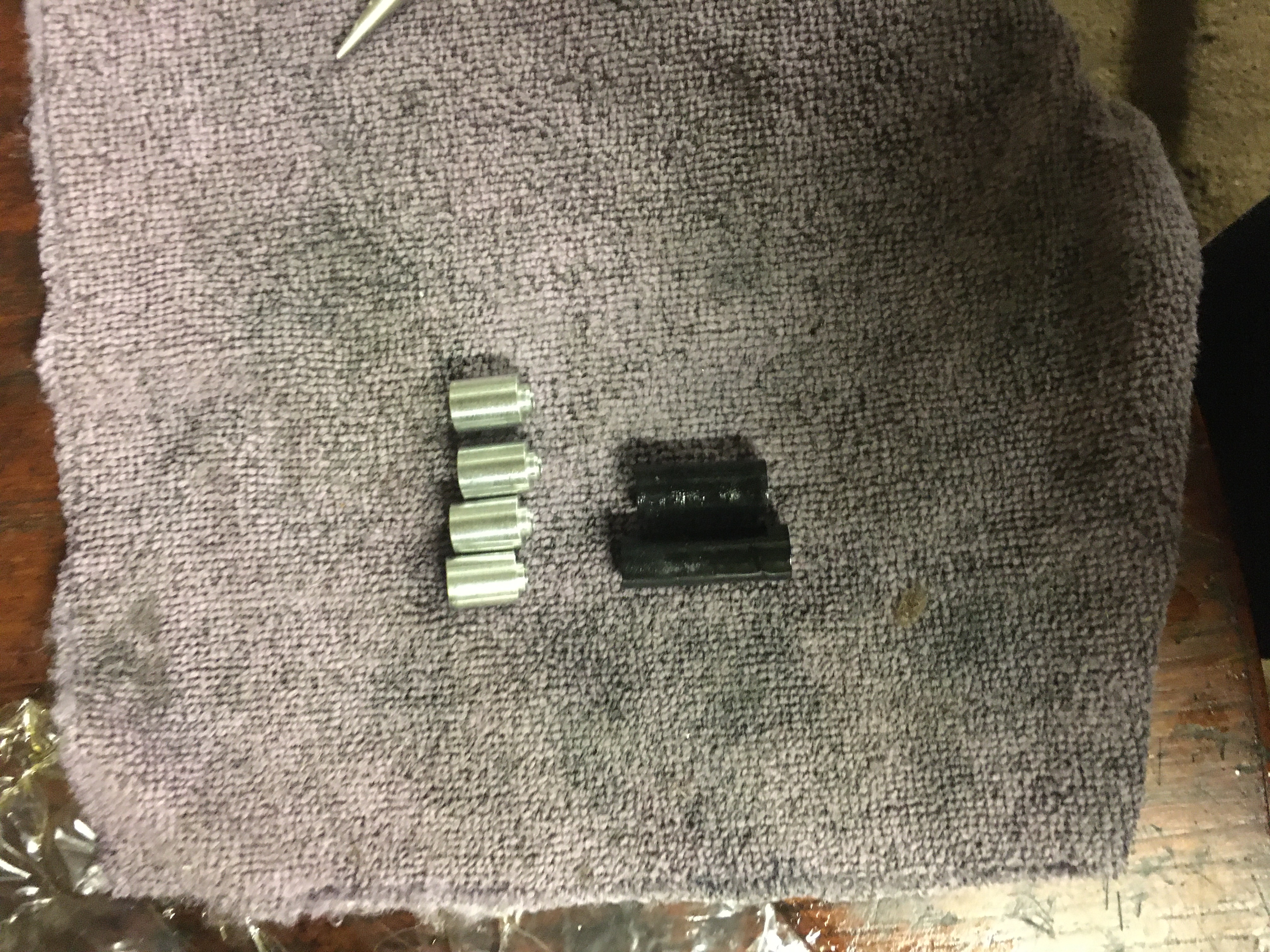

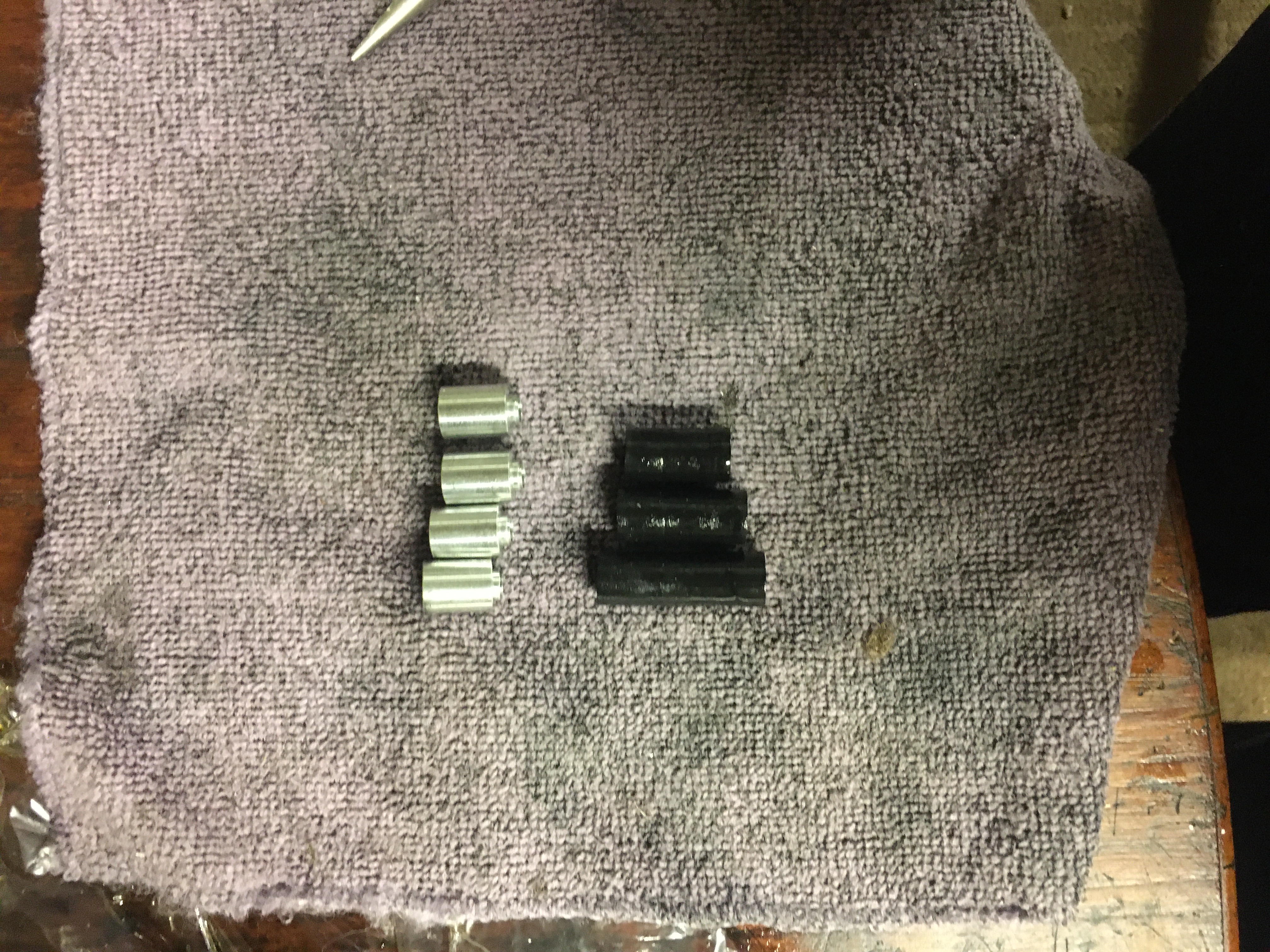

Post by RS_BROKE » Fri Dec 04, 2020 10:42 pm
These are all different sizes, this is starting from the opposite side to the front diff

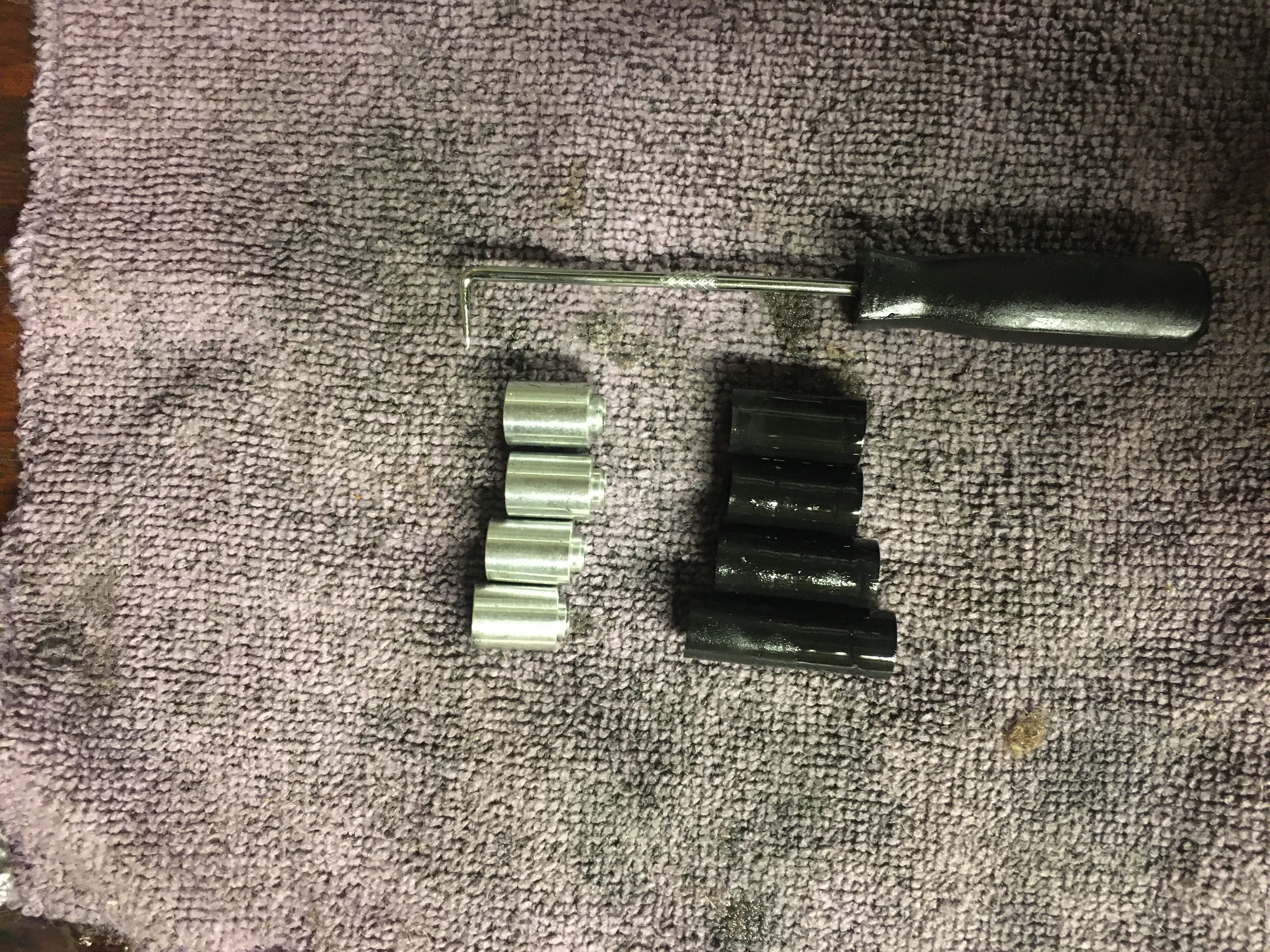

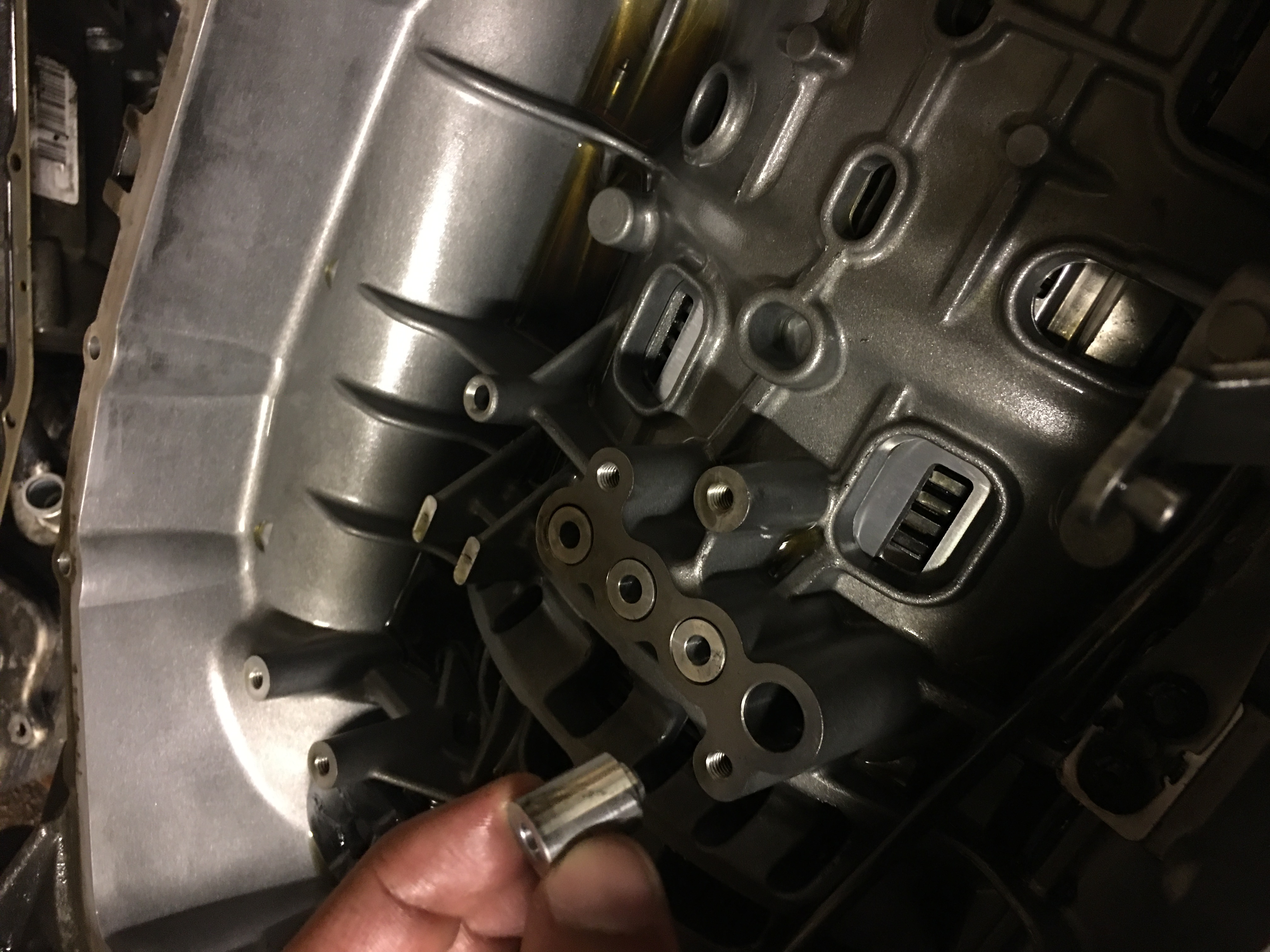

Post by RS_BROKE » Fri Dec 04, 2020 10:43 pm
I used a little pick to get the rubber tubes out like the ones you use for oil filter seals works fine just be careful no to scratch the bores!

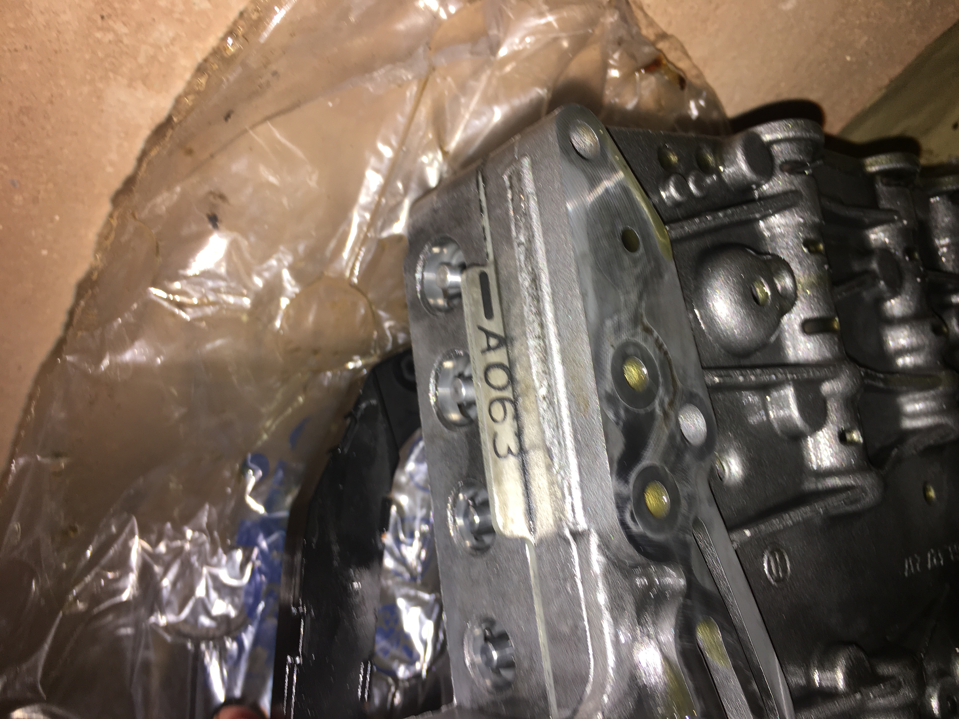

Post by RS_BROKE » Fri Dec 04, 2020 10:44 pm
My valve body seal number is also ao63

welwynnick
Posts: 573
Post by welwynnick » Sun Dec 06, 2020 3:47 pm
That double oil seal is probably responsible for most 6HP problems. It's a no-brainer to replace it, but watch out, there are two different sizes / heights.
