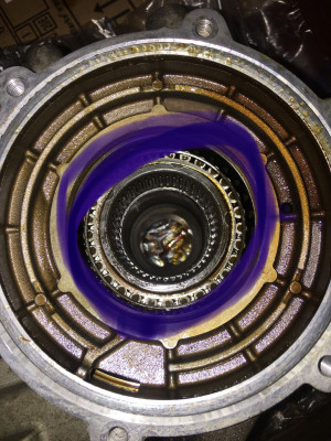

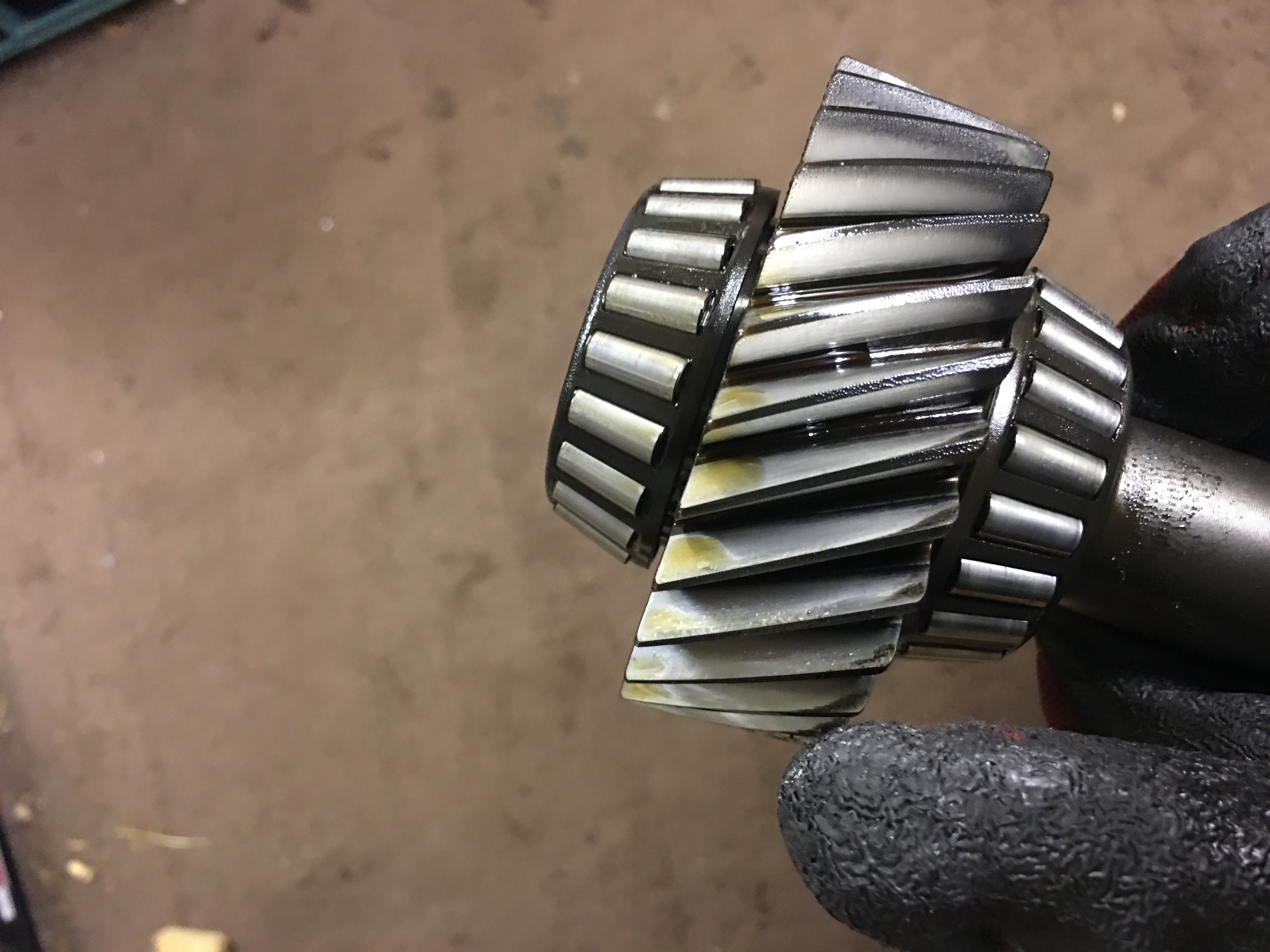

Intermediate output shaft
RS_BROKE
Posts: 59
Joined: Wed Feb 14, 2018 12:10 pm
Re: Gearbox Teardown & Refurbish - 6HP28A61
Post by RS_BROKE » Sat Nov 28, 2020 7:55 pm
Good condition

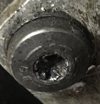

... and I can confirm these are a ball ache to remove stripped every single one on both coolers😂 got most off but two one in each remaining the gearbox coolers are recessed which doesn’t help when using little torx keys yes I know but a wrench was just making it worse ps don’t use little torx keys you will hit your fingers against the coolers and cut your them!

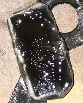

Post by RS_BROKE » Sat Nov 28, 2020 8:04 pm

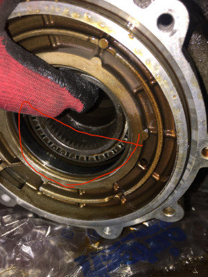

Transfer case magnet
The bearing in the transfer case seems to have lot of play when the output shaft is out maybe this is normal 🤔maybe At can comment on this.

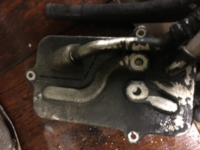

Post by RS_BROKE » Sun Nov 29, 2020 7:55 pm
Finally got the oil coolers off by making a t30 fit in a t25😎

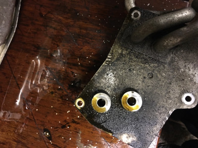

Does anyone know what these two are for front diff? Next to the oil coolers

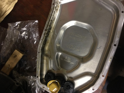

Post by RS_BROKE » Mon Nov 30, 2020 8:40 pm
Sump looks clean but then again it had oil and filter to see if it would fix it remember to inspect the magnets

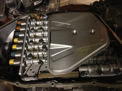

Post by RS_BROKE » Mon Nov 30, 2020 8:43 pm
Got the sump off everything looks clean At has two blue solenoids and I have two green ?
