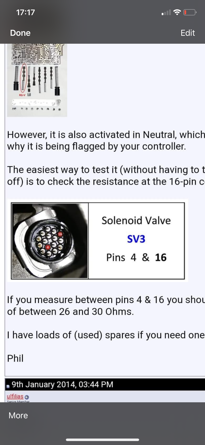

I measured the resistance on the harness at the front that’s known to corrode because of the seals
And it was fine. Used contact cleaner and reconnected. I haven’t been able to find a spare TCU to try out I live in Canada and there’s not many of these here

Post by Shoppinit » Mon Nov 09, 2020 10:49 pm
Plug it back in and unplug from the TCU to check the resistances.

Measure between pins:
52 & 53
33 & 52
33 & 34
32 & 52
32 & 34
Ignition off.

Post by Hixrs6 » Mon Nov 09, 2020 11:55 pm
Thank you very much I’ll try that tonight.
Testing the pins attached to the harness that you pull out of the TCU correct?

Post by Hixrs6 » Tue Nov 10, 2020 5:01 pm
52 & 53 nothing
33 & 52 28 ohms
33 & 34 nothing
32 & 52 27.7 ohms
32 & 34 nothing
Couldn’t do the logs because I can’t get it out of limp mode right now even after clearing codes etc.

When you say nothing do you mean zero or infinity?
Hixrs6
Posts: 34
Joined: Tue Jul 03, 2018 6:02 pm
Re: TCU
Post by Hixrs6 » Tue Nov 10, 2020 6:53 pm
Shoppinit wrote:
Tue Nov 10, 2020 6:01 pm
It says “1.” on the screen when it’s on but you’re not using it and when I test between those three pins, the screen doesn’t change
Posts: 20345
Re: TCU
Post by Shoppinit » Tue Nov 10, 2020 7:01 pm
OK. Then infinity.
So what you measured is all as I would expect it to be.
That would suggest it's not the 16 pin connector and not the solenoids. So maybe a bad TCU.
