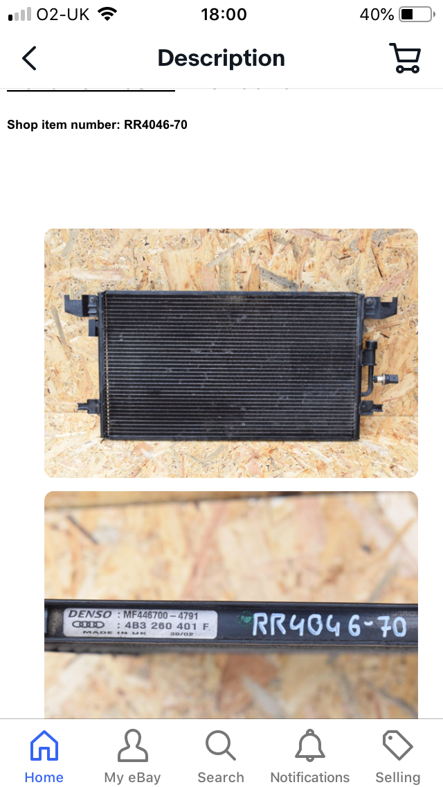

Is this the right one guys.

Post by Puggie » Thu Aug 20, 2020 7:23 pm
That is the aircon condenser.

Steve2003rs6
Posts: 2970
Re: New radiator
Post by Steve2003rs6 » Thu Aug 20, 2020 9:23 pm
Cheers puggie.
