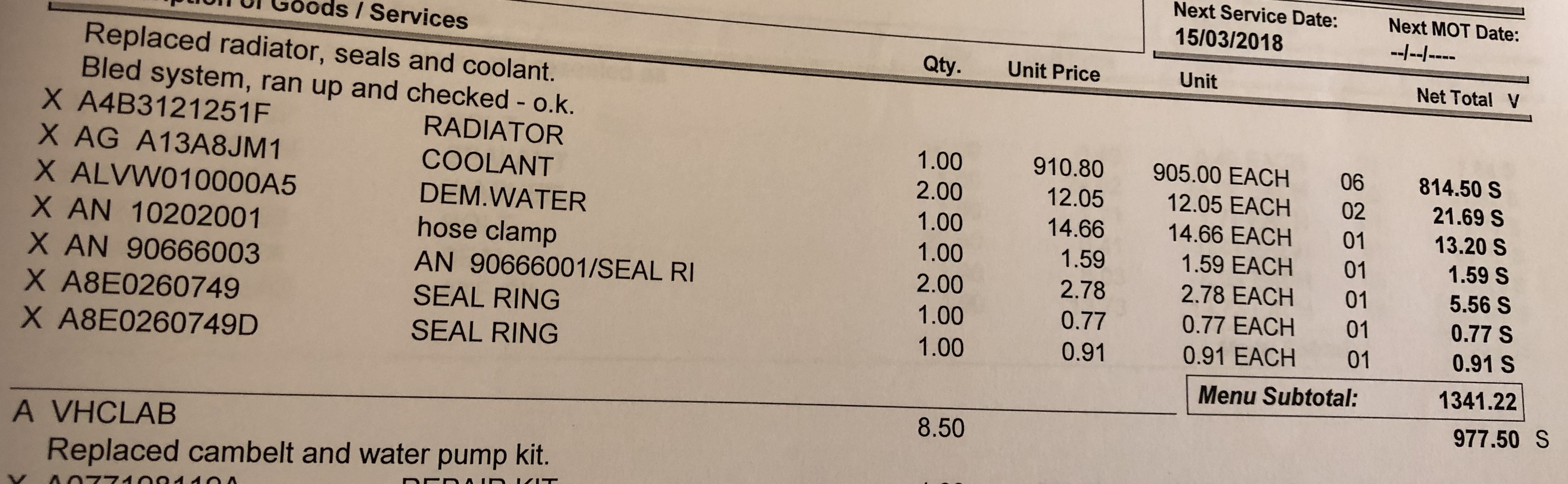

I was rummaging through some of the invoices from my car to see if there were any signs of the car being chipped, no joy, and came across this. It’s from November 2017 at Audi, I don’t know if this is of any use to you Steve?steve2003rs6 wrote: ↑Sat Aug 15, 2020 10:15 amCame across a new radiator at on line car parts for £1300. Unfortunately nil on stock.
Will try contacting them to see if they are getting any more in.

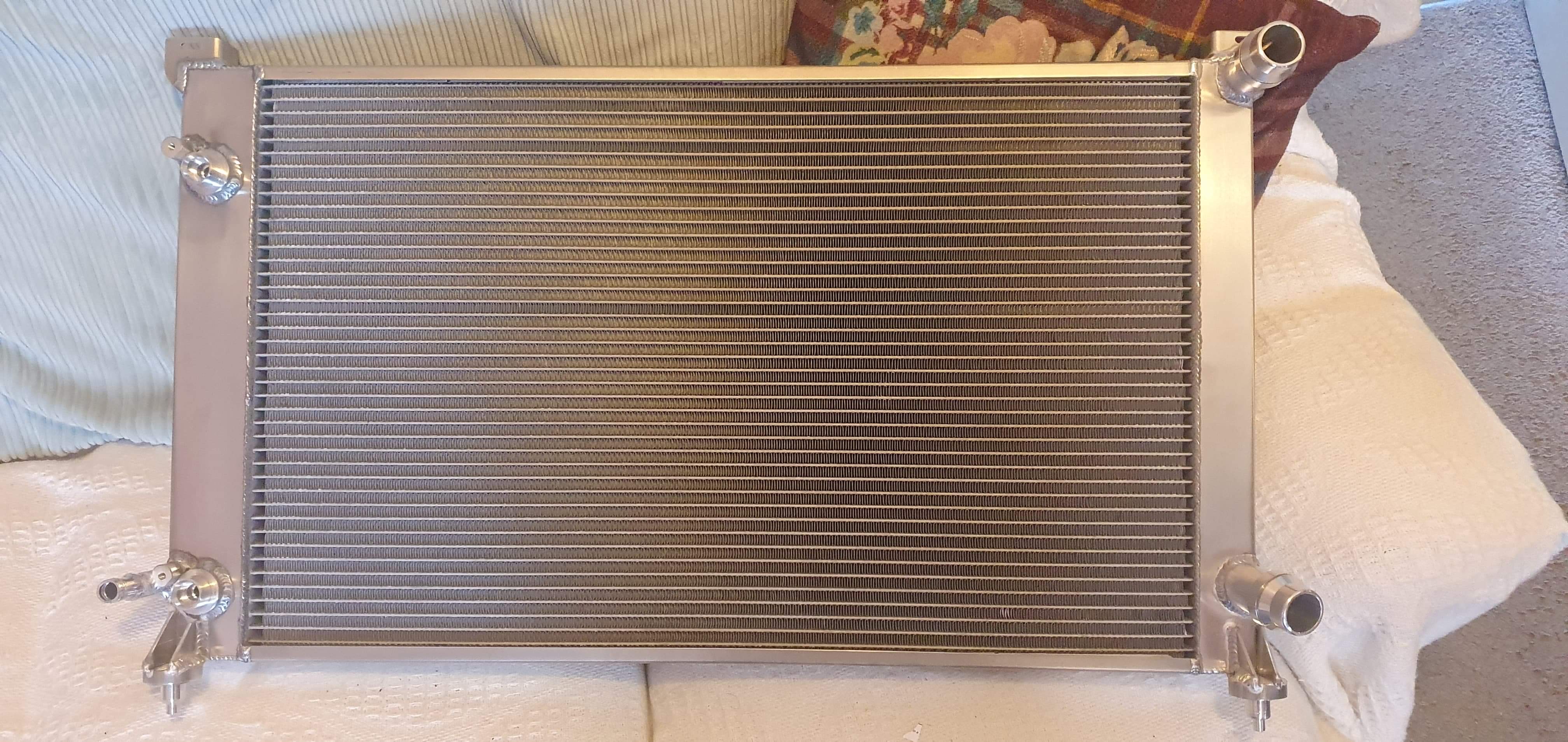

Re: New radiator
Hi Steve,steve2003rs6 wrote: ↑Sat Aug 08, 2020 1:26 pmThank you Puggie. I See what you mean. Just checked doofus’s picture on other thread.
I was Close but no cigar.
Thought it was too good to be true.
I got mine last weekend from Serck. Took about 7 weeks or so but they did a great job.
They have kept the CAD designs from mine, as I mentioned about letting others on the group know. I basically sent mine to them and they made me one from that. Looks amazing and they have done a great job. I’m having it fitted this coming weekend.
It was £900 inc vat, but that was still cheaper than factory which is still OOS any way!
Hope that helps you abit anyway
Steve2003rs6
- Posts: 2970
Re: New radiator
That’s great news buddy. I am sure there will be members on here breathing a sigh of relief including me.
Mine has stopped leaking but nice to know of a company that can produce them and at a very reasonable cost.
Nice one.
Nice one.
