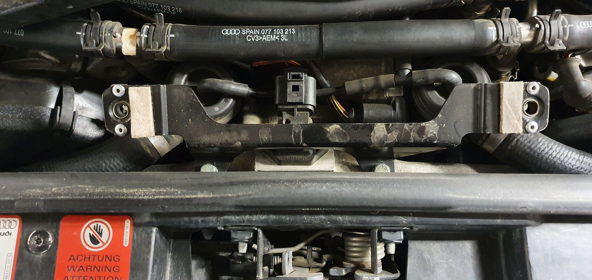

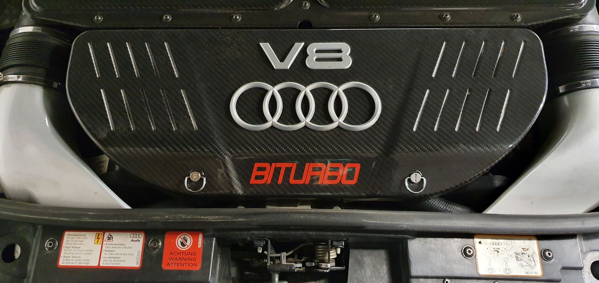

Made up the missing front CF engine panel clips. Easy enough, if I still had access to a lathe then it would look a lot more professional but hand tools only for this one.
A few 1/4 - 3/8 BSP gas fittings, two 3/8 bsp male-male joiners, two 1/4 bsp lock nuts plus the pressed metal nuts that I slotted previously.
All the parts needed modifying, basically shortened and then screwed together and assembled in the bracket. This is the detail.
Finished product ready to be re-installed. Test run worked perfectly.
These won't be going anywhere, a bit of loctite and set for life.

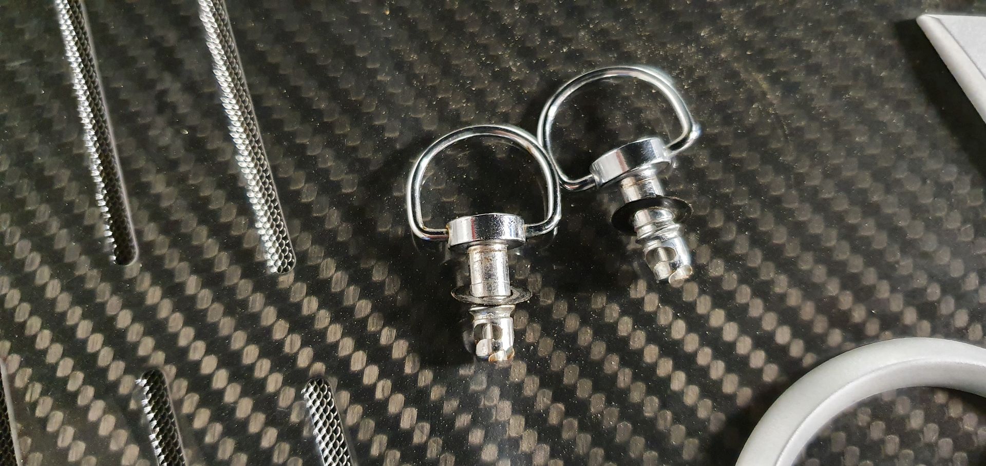

I had to replace mine a few years back, i ended up with these dzus fasteners,
Used them for my race bike fairings and had a bunch left over. Just rivet in the backing plate and these pop in with a 1/4 turn.Image

Dzus, perfect solution. I had some years ago for my bike but they've wandered off over time and getting just a few can be more trouble than it's worth.

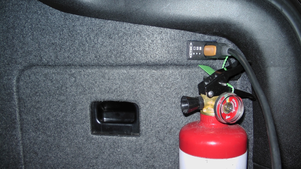

Re the battery, I've fitted the extension and no mucking around now, just plug and play. I didn't really expect much from the LED lights, what I really wanted was a panel fit socket that I could just plug into. That's been achieved.
What it did do was to bring to my attention how quickly the battery voltage drops. I really wasn't expecting that so now I'm a little more prepared. I'll have to go through a set of checks to see where it's going but in the meantime I'll be preventing a flat battery.

Start with the alarm horn in the boot / bumper. Proper piece of poo, that.
That plug does look tidy. :thumbs: Might have to get one!
