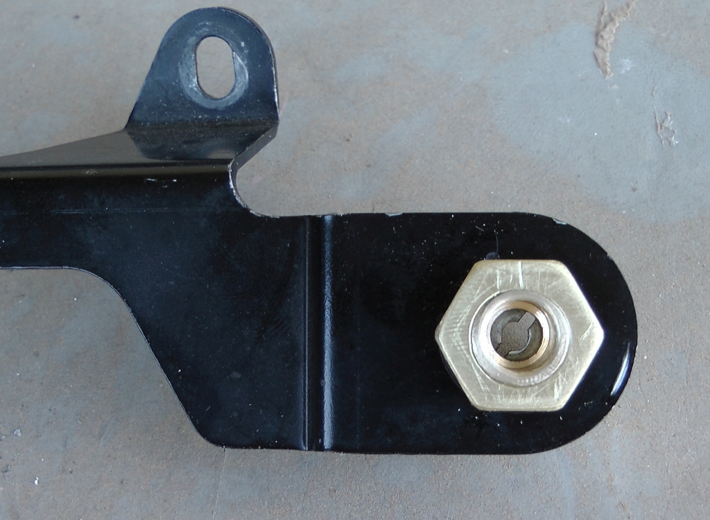

Made up the missing front CF engine panel clips. Easy enough, if I still had access to a lathe then it would look a lot more professional but hand tools only for this one.
A few 1/4 - 3/8 BSP gas fittings, two 3/8 bsp male-male joiners, two 1/4 bsp lock nuts plus the pressed metal nuts that I slotted previously.
All the parts needed modifying, basically shortened and then screwed together and assembled in the bracket. This is the detail.
Finished product ready to be re-installed. Test run worked perfectly.
These won't be going anywhere, a bit of loctite and set for life.
Posts: 20345
Re: DIY Solutions
Post by Shoppinit » Sat Dec 07, 2019 1:32 pm
Satisfying.
