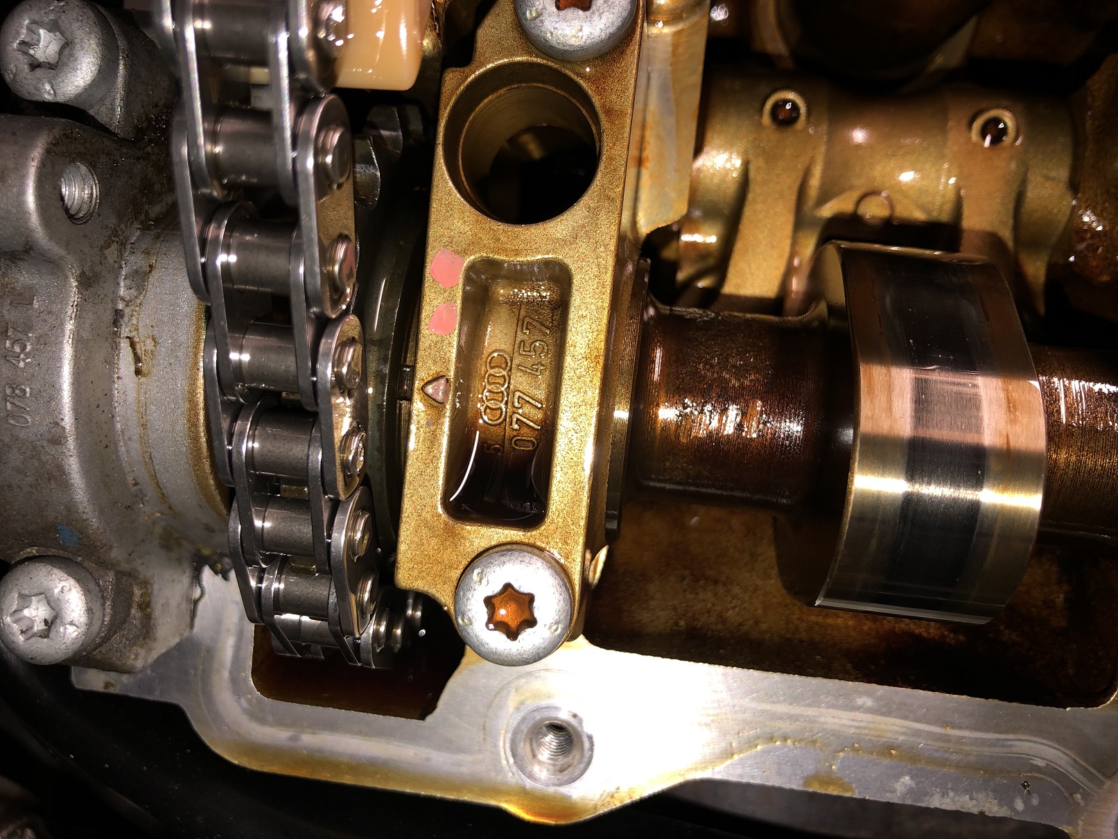

Post by Mɐʇʇ » Sat Jan 04, 2020 8:08 pm
I reset the cambelt timing based on eyeballing the exhaust timing marks, plus locked with cam bar and crank pin in.
You can see both intake and exhaust are pretty well aligned. I primarily tried to get the exhaust aligned - think I did OK?
However, Bank 2 is still marginal. So I guess it's either the hall sensor or the cam phaser that's off - but, intake on bank 2 looks good in the pics - so maybe it's doing something when the oil pressure comes up? I dunno. Will have a look at the hall sensor later to check that's on correctly (am sure it is) and then probably put the old dephaser back in bank 2 with it's new shoes on - I've got the gasket it needs on order already.
Bank 1 Exhaust:
Bank 1 Intake:
Bank 2 Exhaust:
Bank 2 Intake:
And the new timing results:
No SAI and the water pipe mode does make it easy to work on the OS (Bank 1) though, which is good:

Noice. What was it?
