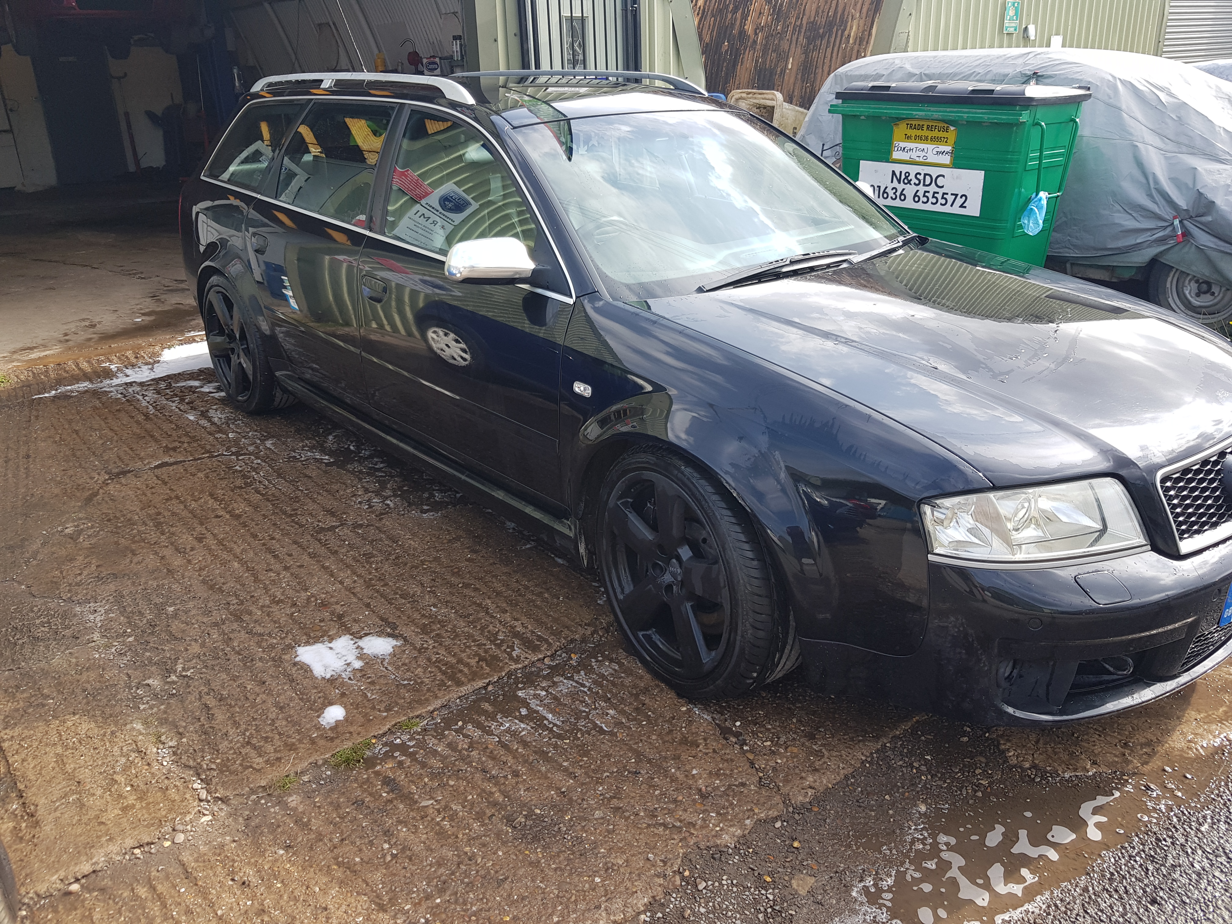

so I purchased this car with bottom end failure for a very good price!
I soon set about dropping the engine and gearbox and stripped the engine. now just a case of organising machine work for the block and finding a good crank.

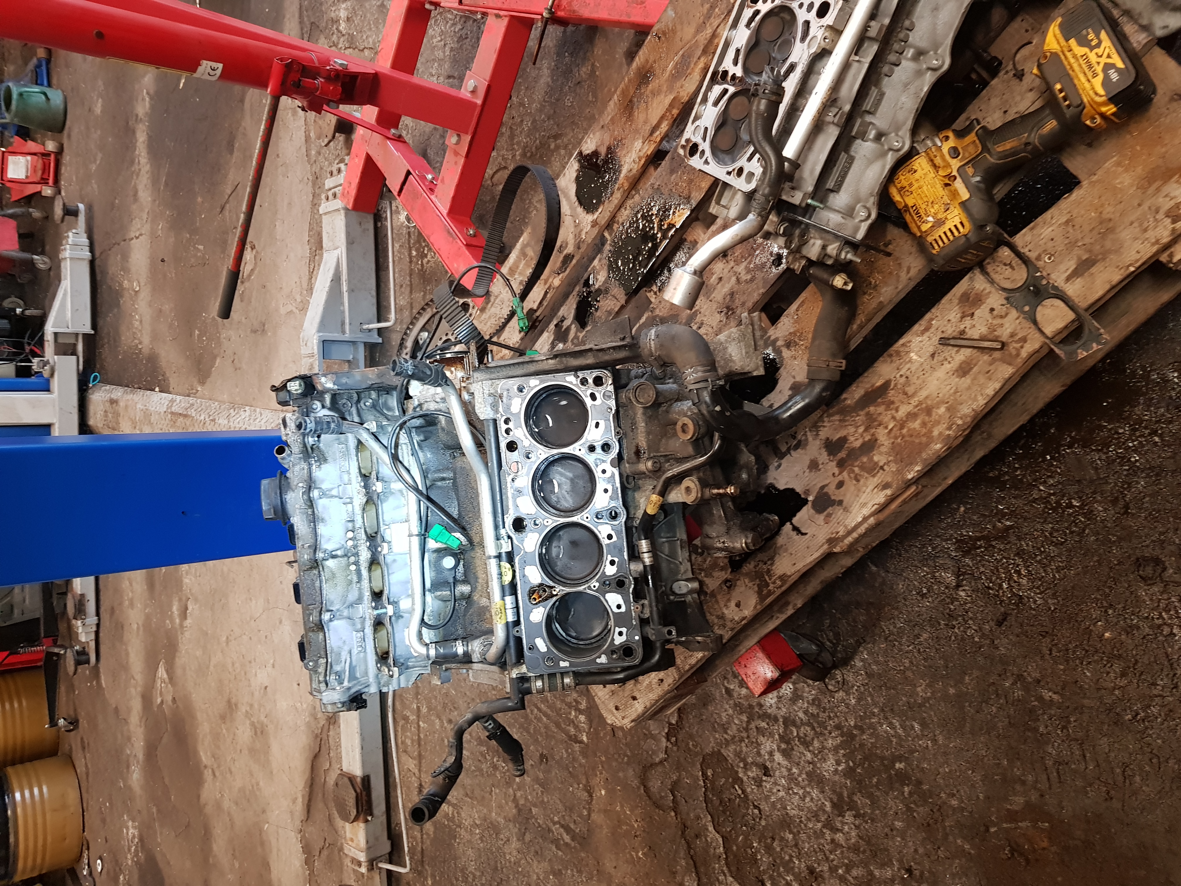

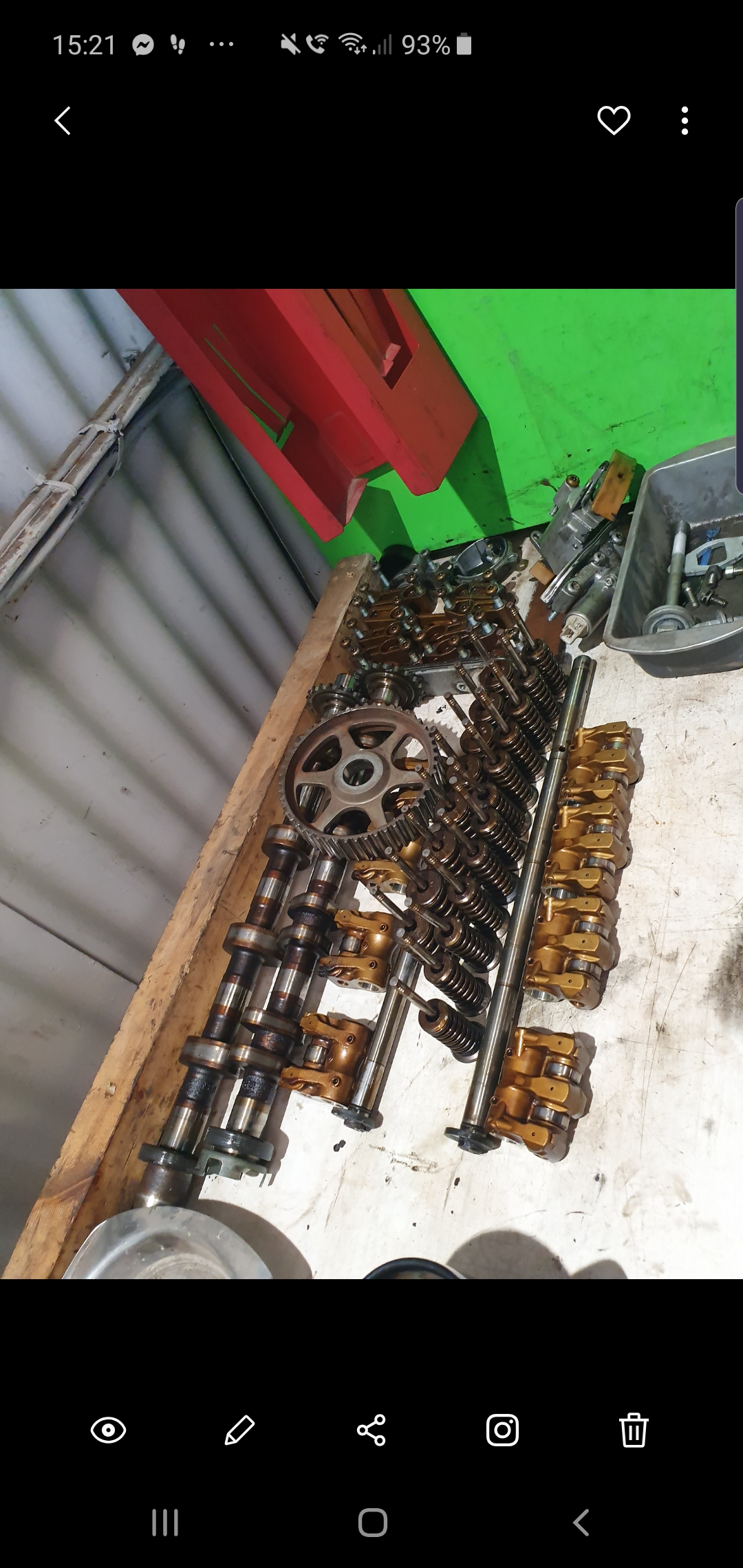

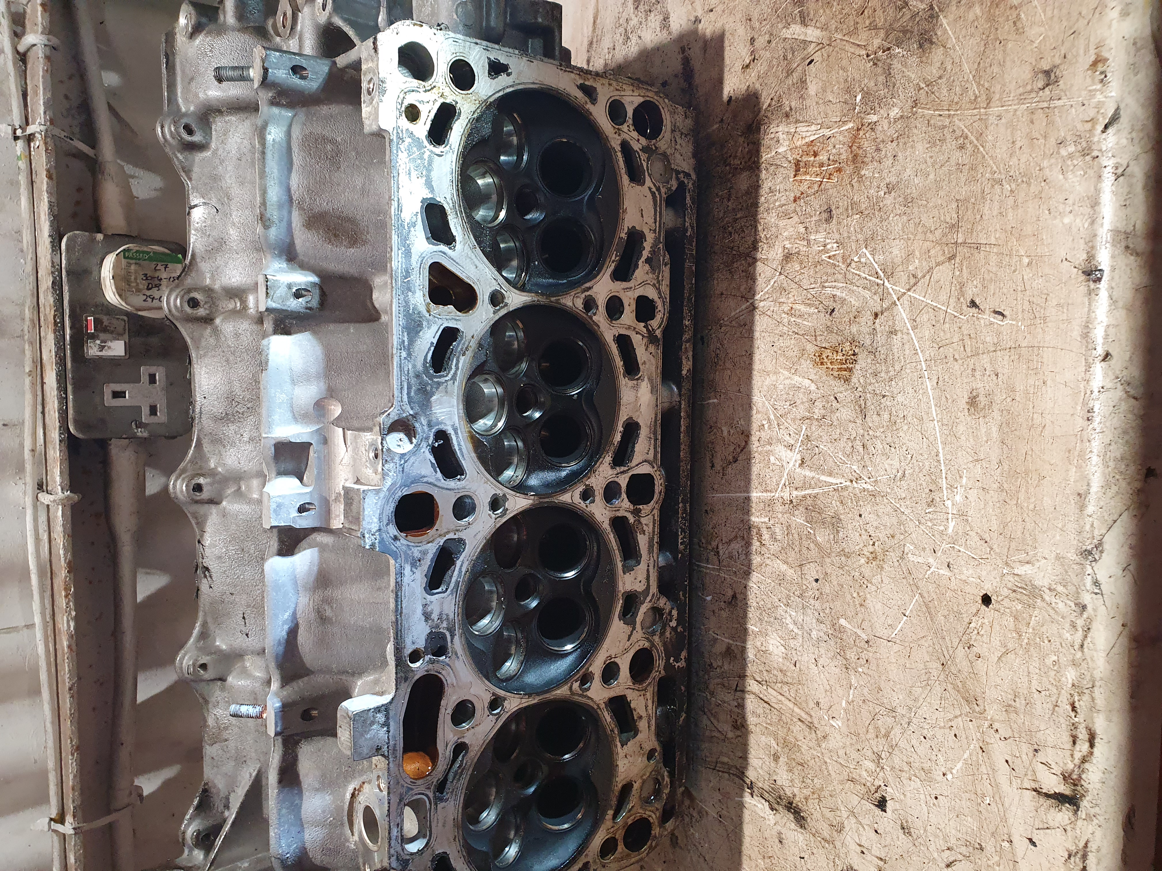

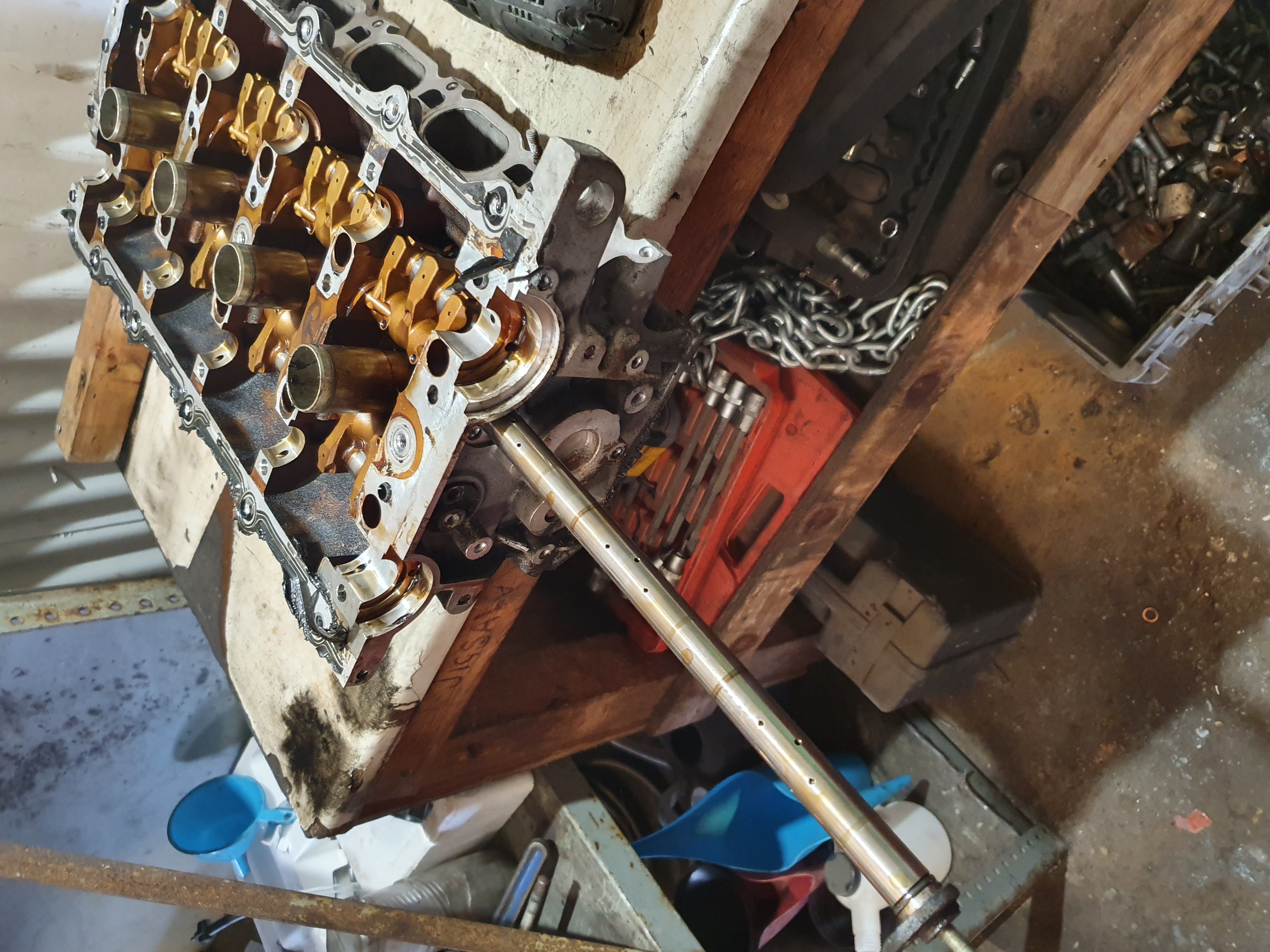

bit of a update ended up bagging a complete engine for a bargain price that had been removed for being down on compression on 1 cylinder ( was bought for parts) and turns out it only needs a valve bottom end is in perfect condition!
work has started to clean and refurb the heads and during this week will strip gearbox as a precaution and have a peek inside to see if needs anything.

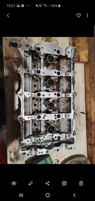

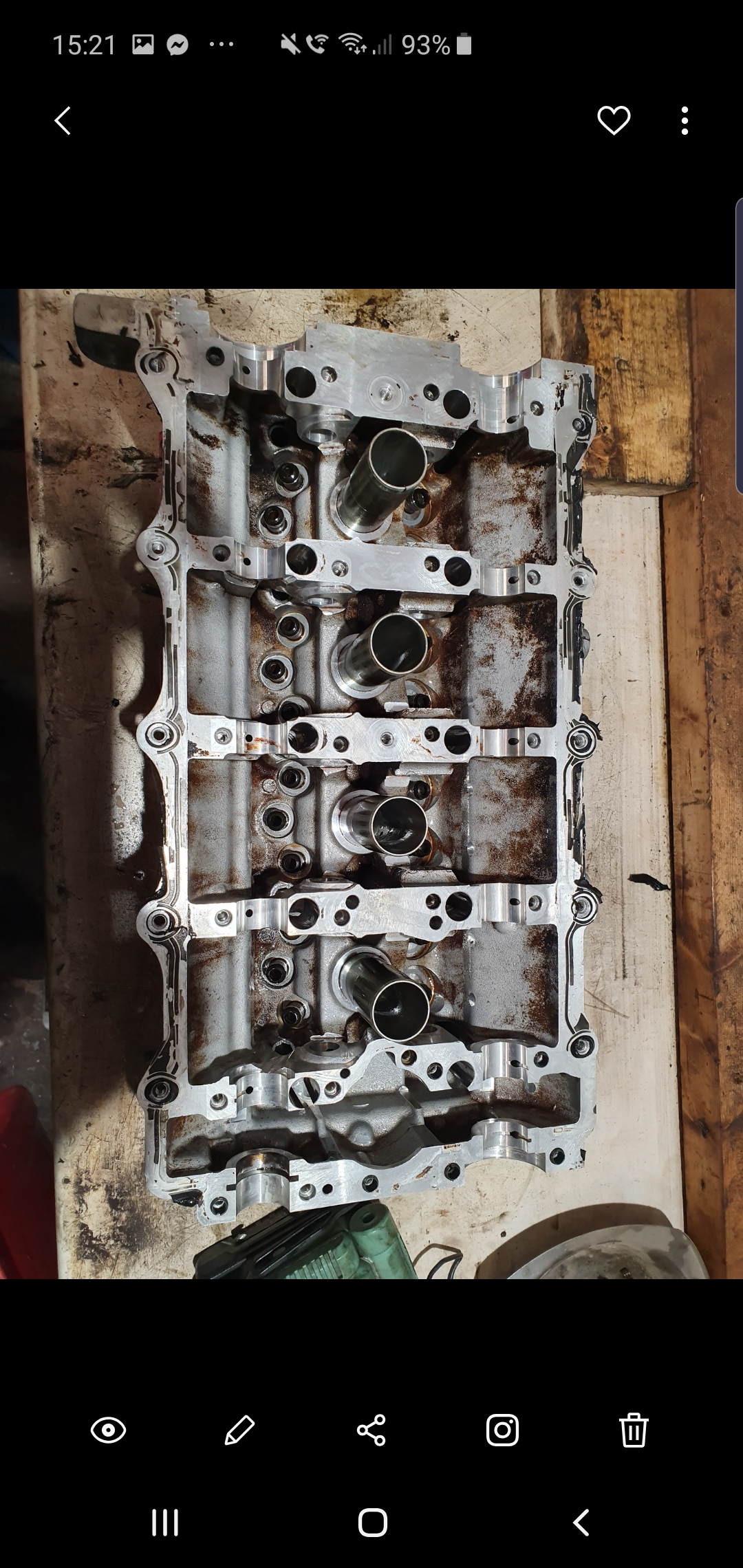

heads 1 stripped and quick clean ready for work
